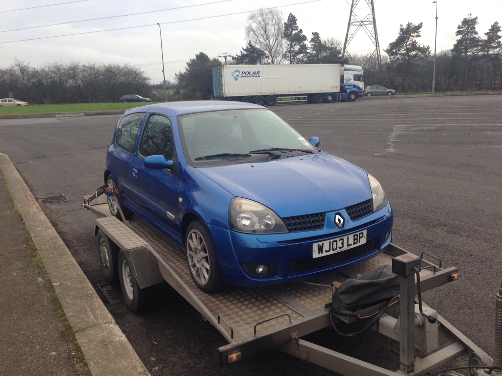

Here is my cup. Purchased for a bargain price, with a known bottom end fault. Woke the girlfriend up at 3am to make the journey to Lincoln. Got there, loaded it up onto the trailer and returned home.
Observations:

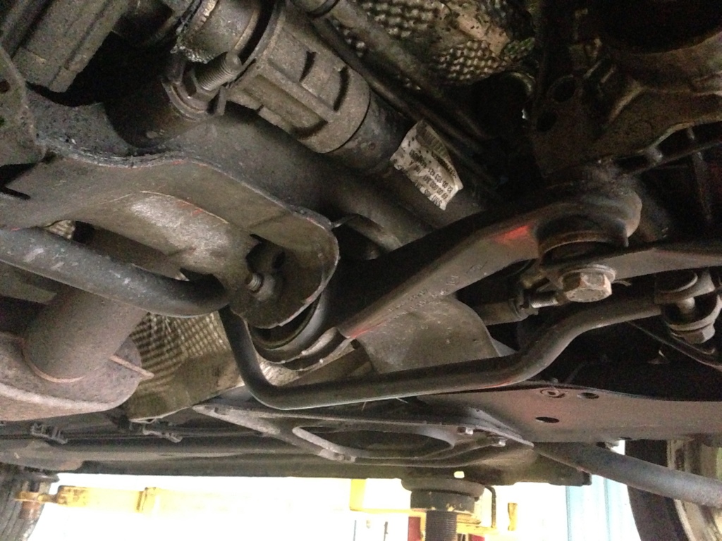

charging fault, worn aux belt, cracked rear disc, bodged gearbox, incorrect rear dog bone mount, numerous bolts missing.

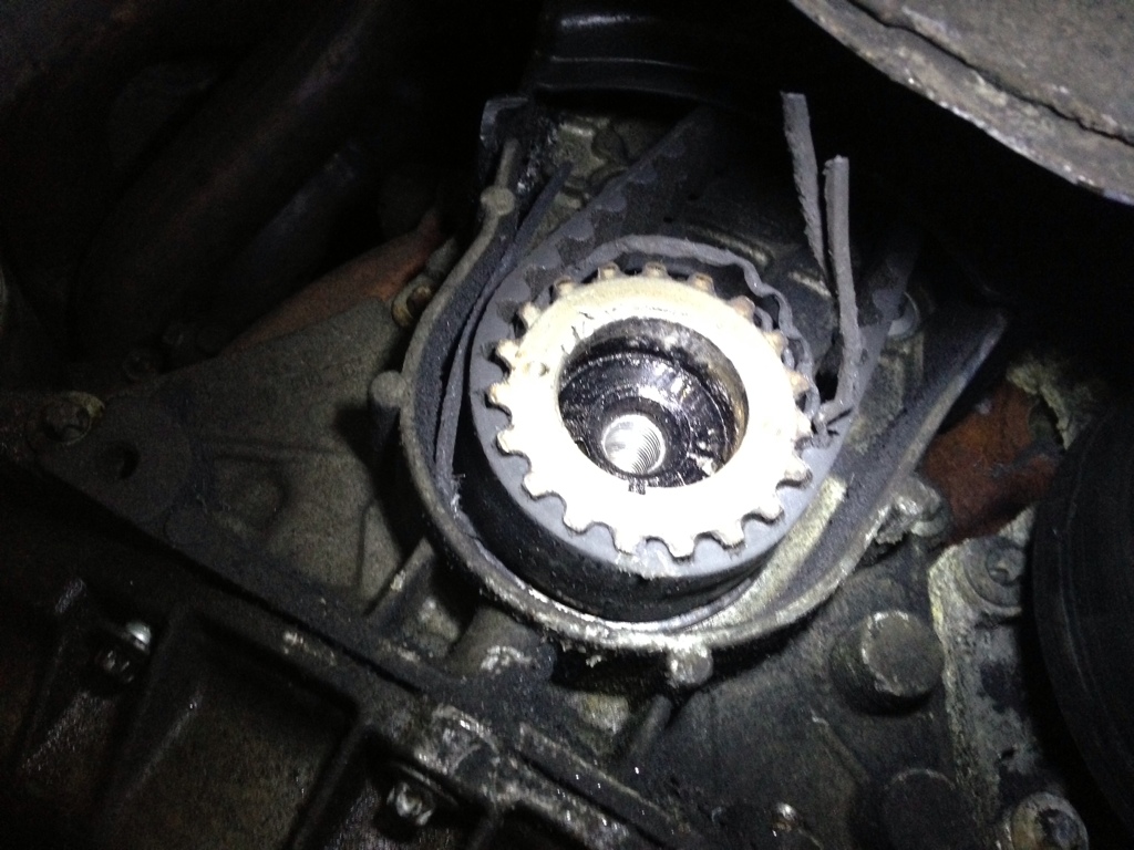

I shouldn't have tempted fate. Charging fault I diagnosed as the alt, so got one from spray shack. When it was delivered I had a new belt on order and was due with in the hour so thought I'd crack on with it. Started it up and went to move the Monaco out the way, as I was walking away I heard a rattle/clatter then it cut out. I thought the worst, so pushed it into the garage and got it on the ramp. And my fears were confirmed.
The aux belt that I knew was a risk let go, fraying and getting caught in the crank pulley and jumped the cambelt. All it had to do was last 30 seconds :(

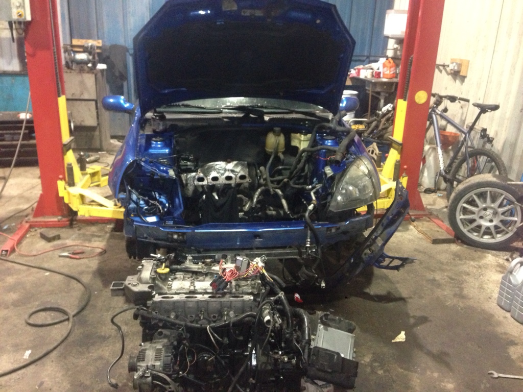

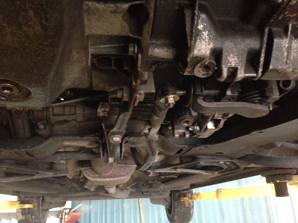

So today had a fairly slow day so wheeled the cup in and proceeded with removing the fucked engine and stripping it down. And tbh I'm a little fucked off with what I have found to be wrong. Summary of it is that it has been worked on by who can only be described as retards. A list of what I have found so far.
Gearbox is shagged due to the driveshaft being broken and dropping the needle bearings into it. The diff bearings have practically siezed up due to this.

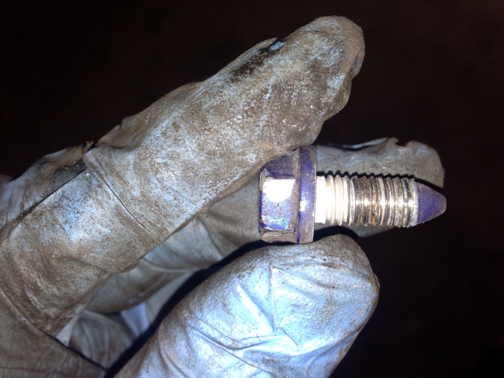

Missing bolts galore:
Missing mount and loom bolts
Missing engine mount bolt and nut
Cross threaded slam panel bolt

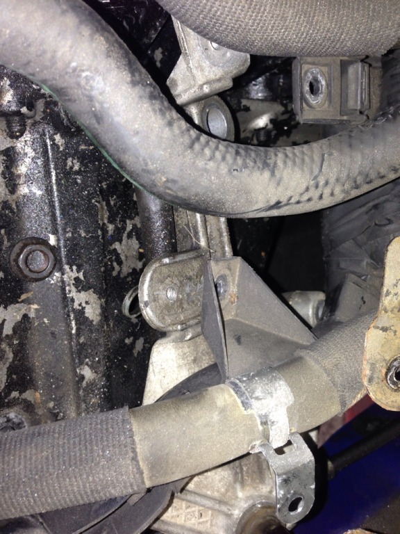

Incorrect rear mount
Missing boot and nylon spacer on the gear linkage

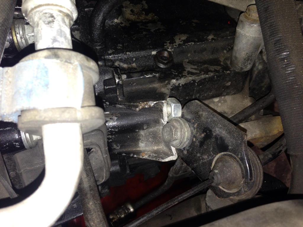

And the grand finale...

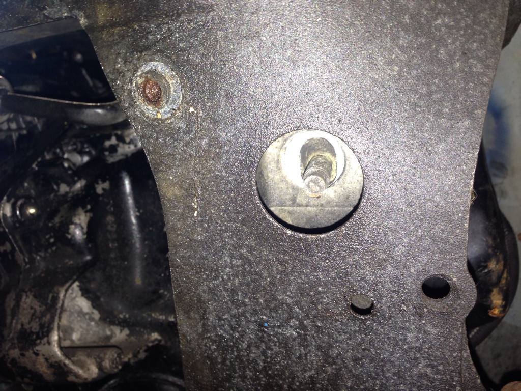

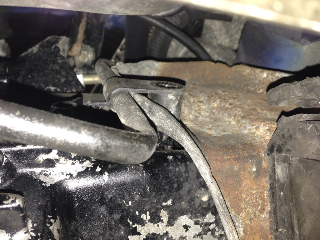

They have broken the eyelet on the gearbox where the clutch cable bracket goes, to fix this, they have BOLTED through it into the bell housing. And because of this not getting it to be at the correct angle they have wedged a nut in there!!
All in all really pissed tbh. But it's only when you delve this deep into a car you discover such 'workmanship'.
All will be sorted within a few weeks. I have a new bottom end en route, I need to replace 4 inlet valves that have bent. Bolt the head on and we're away.

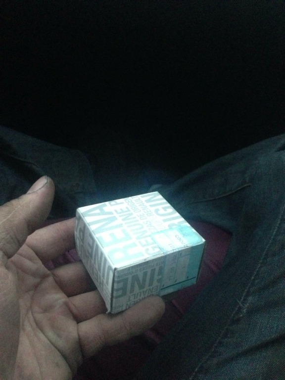

Cup wheeled in, rebuild in anger commenced. 4 inlets lapped in record time. Head gasket and bolts arrived from a local supplier. Head bolted on, timed up. It was at this point I realised I hadn't kept the clutch release bearing, expecting to be putting on a new clutch in the rebuild. I then remembered chip had ordered one for his turbo and hadnt fitted it. A quick text to India, followed by a reply of "I'll get Lesley on it as soon as she's home from work" then about 20 minutes later saying she had it! Epic!
Went over to Taunton with my mate who was just being a general dogs body for the night. Collected the new release bearing and headed back. At this point it was about 930pm.

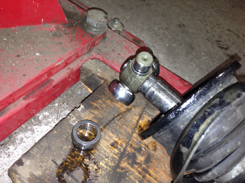

Removed the passenger side shaft to replace the tripod, took the tripod off and sent Vikki over to Taunton, to chips to see if he had a spare I could have. Which he did! Perfect!

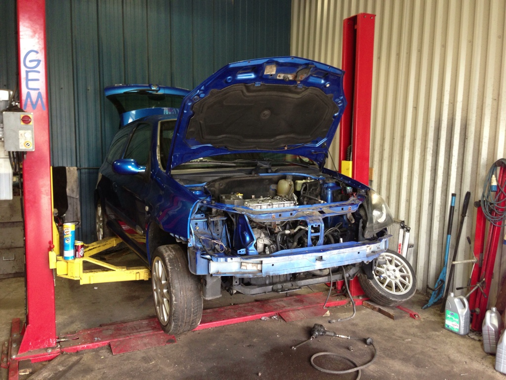

Well end of project.
Looked like this last night.
Then today:

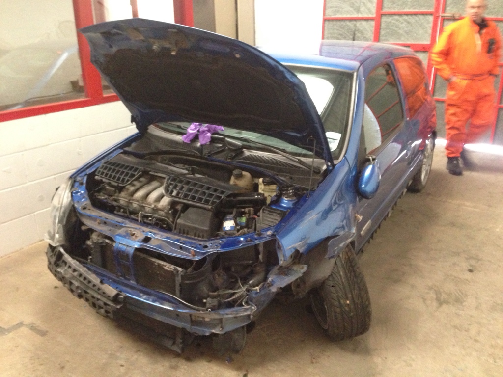

got collected by a c**t in a BMW who had a big ego. Cut a few of us up, lost it infront of me, off to the grass, I saw him get it straight so throttled on again, except he did the same and spun. Came across, hit the front of me and put me Into the barrier with him.
