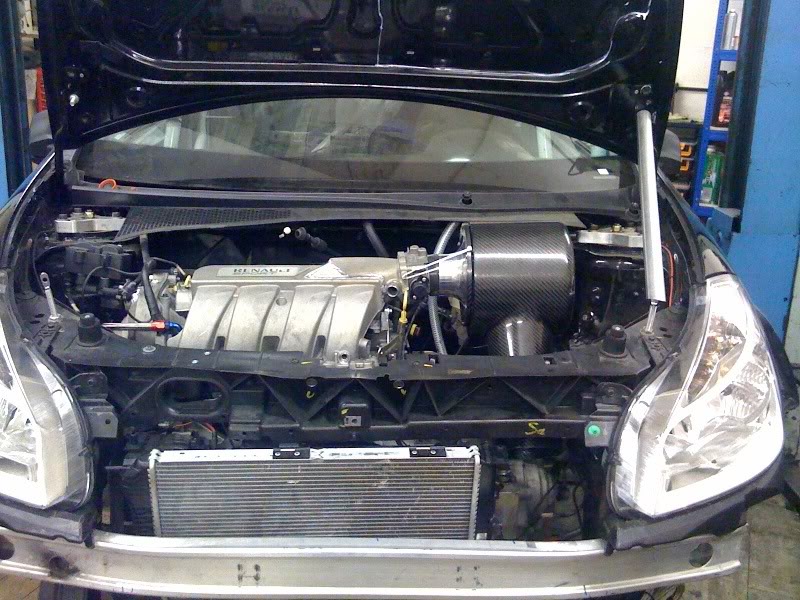

We've just done a new one for the BPM X85 SE prototype using an ITG AB80 airbox, modified inlet manifold to relocate the throttle body position and a induction point (i.e. nostril) mounted on the nose. Don't think you'll get much better than that but it does involve chopping and welding bits of your car ;-)

Icarus, very interested on the throttle body mod. did you just rotate it round so it was more at 90degrees to the engine, rather than pointing to the back of the car?

Icarus, got any pics of this setup on your x85 then? :p

Same as X-85 Clio Cup. They're aren't the best solution by a long, long way. The location of the airbox inlet directly behind the headlight creates a 'bit' of a restriction.
If you hack the front off the box it works quite a bit better! The loss in filter shielding is more than made up for by the increase in bulk flow - however you do also need to chop the inner arch out as per the X85 in order to ensure sufficent ambient air supply.
Or you can fabricate a complete new induction/filtration setup - ours does involve having some shiney carbon fibre sticking through the bonnet skin though! Here's a pic during development which shows it pretty well.

Matt, That reloceted TB would work well with mine mate!
