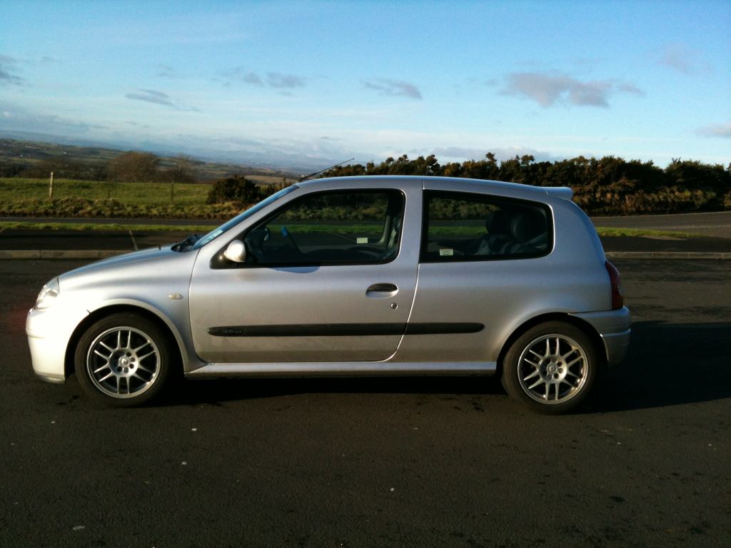

I think im just going to go for standard but all new apart from eibachs, anyone got pics of how it stands? Not a fan at the moment of how the back is quite high up :/
Plenty of pics in the suspension/Clio Media section. They still sit with the back higher than the front when lowered.
  225 Cup & Williams
My ph1 172 on brand new 172 cup shocks and Eibach sportlines.
  BG Clio 182 - Recaro
Yes I suspected as it's a even 30mm drop if I'm right?
Just the front is okay but the back is pretty high, I don't mind the stance just along as it's lower
