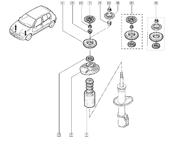

Looking to do a suspension refresh on the front shocks. Replace the wishbones, track rod ends, ball joints etc and all bolts at the same time.
Can someone post up the dialogs page with the parts for a clio 182 ff

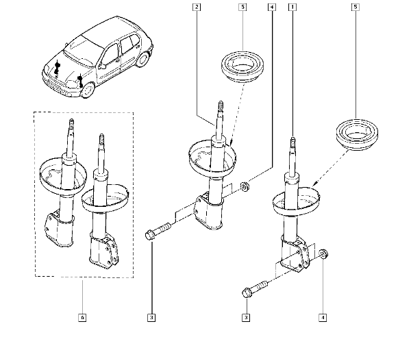

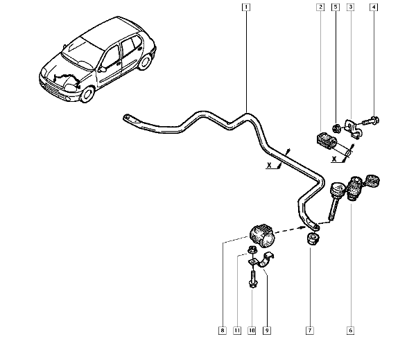

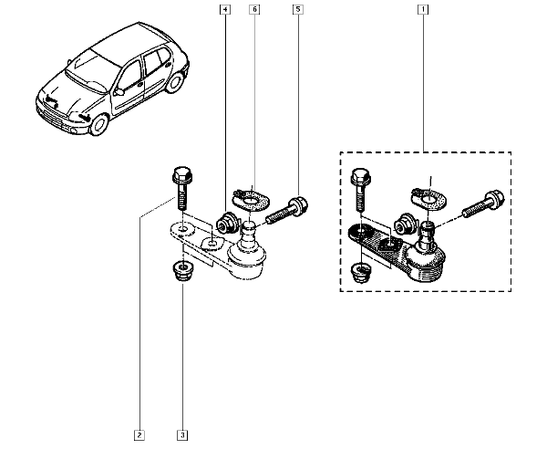

Thats a break down of a 182 FF from renaults catalogue. Tell me what picture you looking at and part indication number and I'll try and supplier you a dealer number.
  182
Hi mate,
Could you tell me what 5 is called in the second from last picture please?
