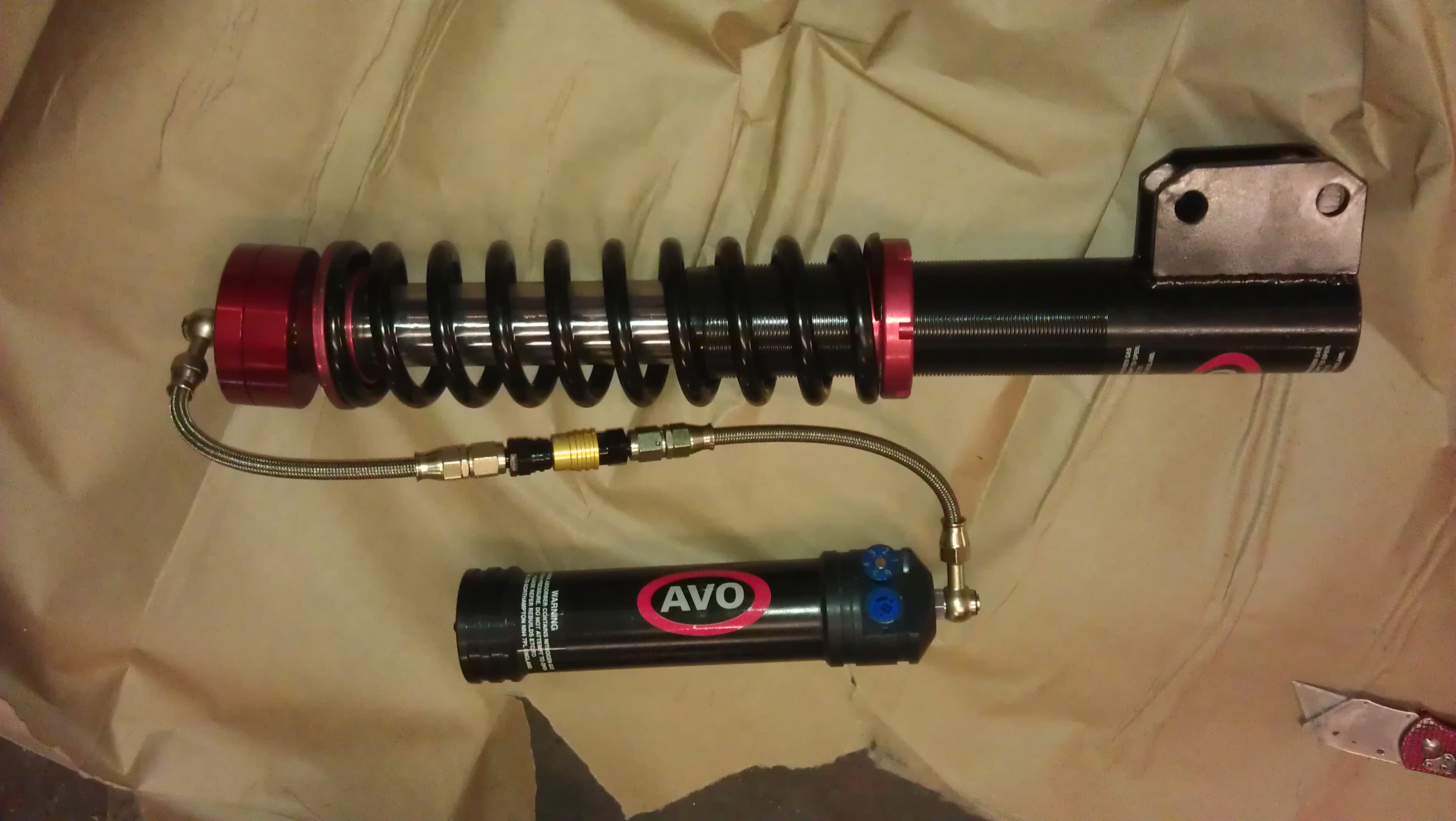

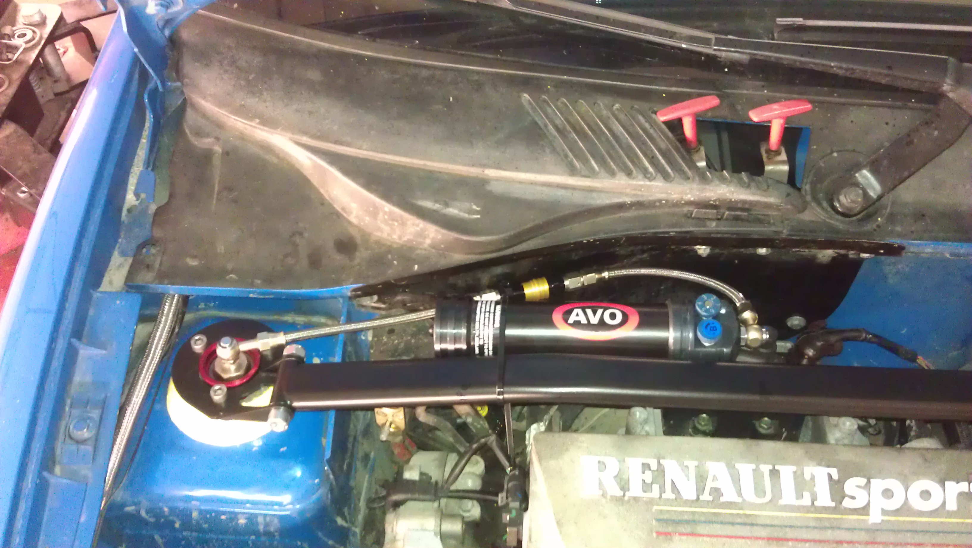

They look lovely! where do you put the external res? just by the turret?

Yeah its a tough world we live in haha! no not really mate, yeah same boat with me regarding ASTs [emoji16]
