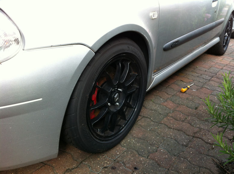

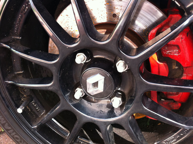

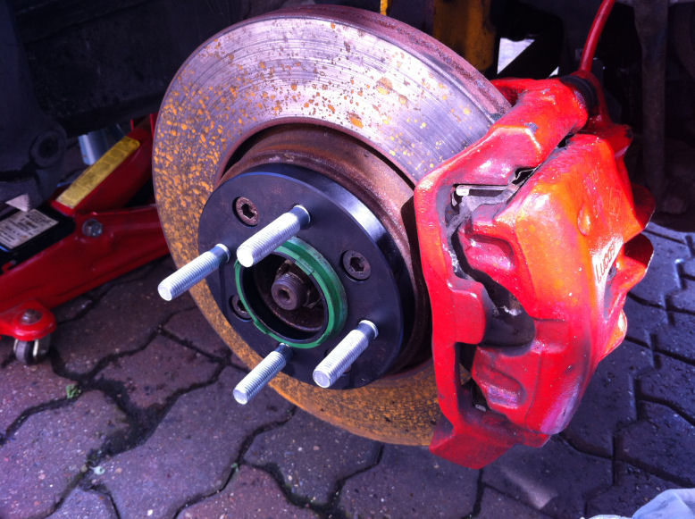

Please tell me this is correct!
I'm not sure how you're supposed to torque up the spacers with an 8mm allen key. I just did them as tight as possible by hand.
I used Loctite 2700 on both the studs and the allen key bolts.
The studs are a bit too long but I can't see this being a problem other than taking ages to get the nuts off?
Really pleased with the spacers. 15mm is perfect. Glad I didn't go for more
  Lotus Elise
Personally I wouldn't screw the studs into the spacer I'd screw them into the hub as its steel and less likely to come loose or pull the threads.
