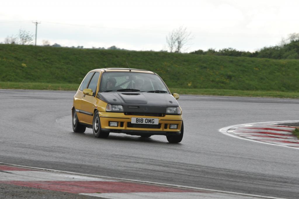

This is my mk1 cornering really hard, it doesnt really lean at all.
thats with the roll centre correction kit and Nitron coilovers
