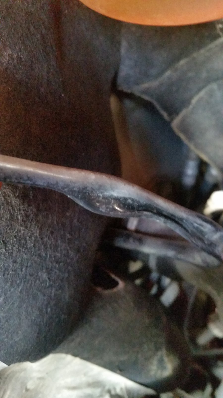

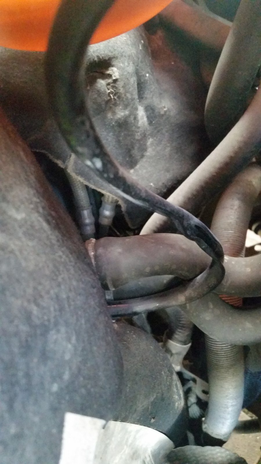

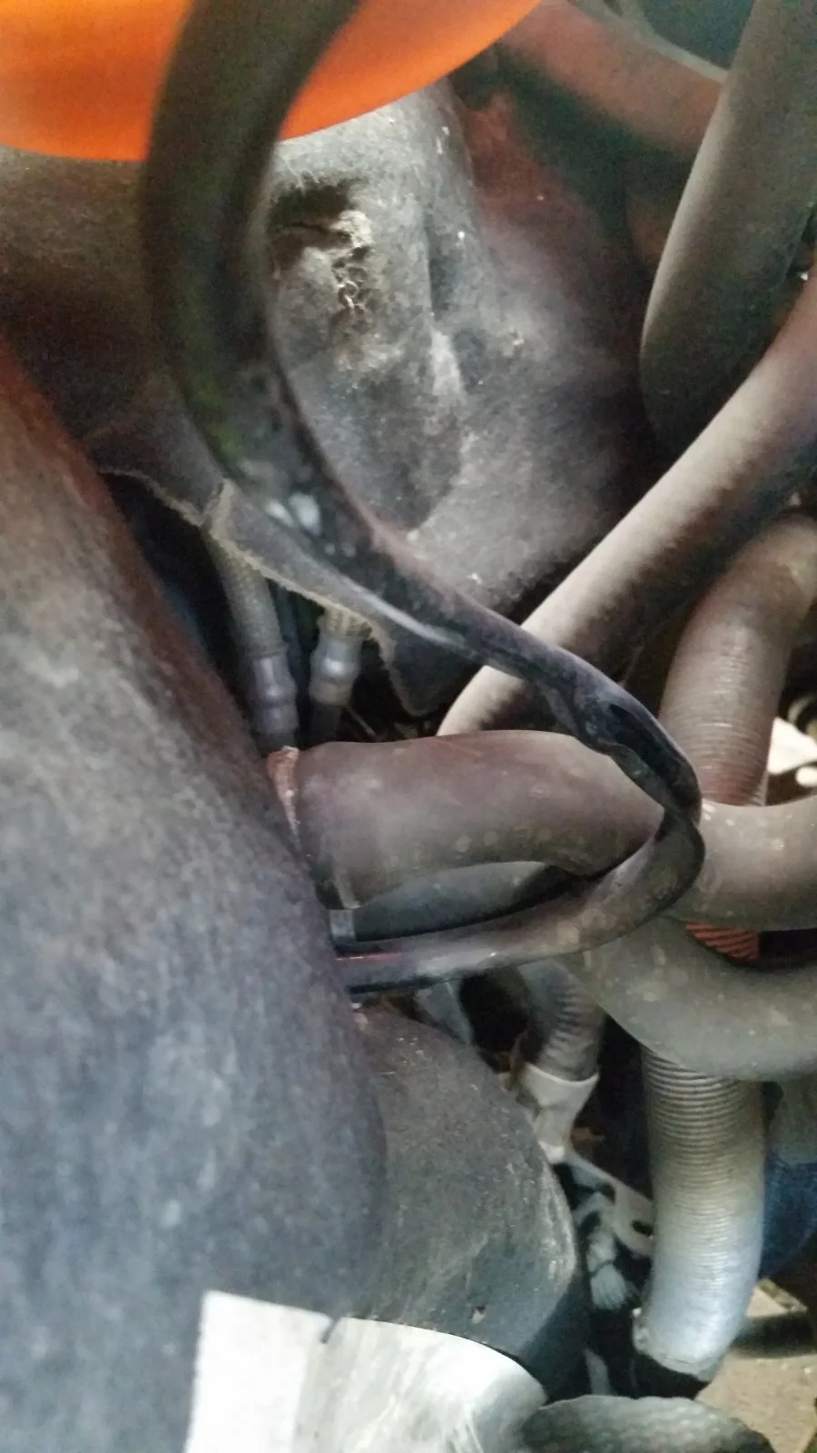

incy-spider
I have had a few where the vacuum pipe has melted from the heat off the manifold, happens on MOTs when trying to get through cat tests. Might be worth a look, can sometimes be hard to spot as the pipe sorta implodes on itself - usaully just down from where it connects to the inlet.
  350z, Subaru Legacy
Ok cheers, I'll check the pipe later in the week when I have a chance - try to see if it's anything obvious.
  182
bit of a bump....
just had my car mot and this has happend to mine.just spotted the pipe imploding...
any ideas of how to sort this out.??or a part for it..
  182
I managed to sort it out by joining some better hose.it will be a temp fix until I get a new part..... I must say it's a s**t place to put it...
Thank god for this forum.i would of been hunting for the problem for a while..
