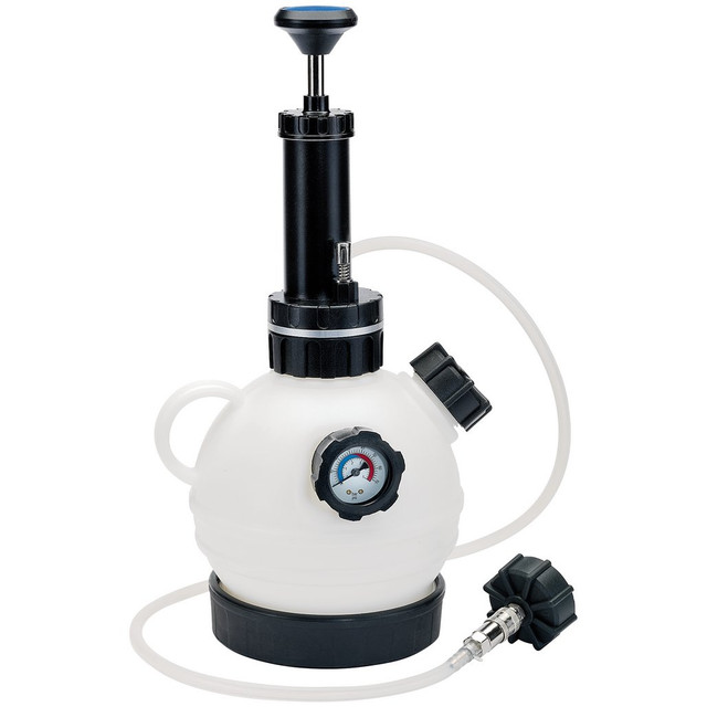

I was going to get a pressure bleeder too, the £20 Eezibleed one. Good idea or waste of time?
I bought one of those recently and it's an absolute game changer. It makes bleeding brakes ridiculously easy and I don't think I've managed to get a firmer pedal even manually bleeding them.
I would advise getting a syringe though as it fills the reservoir completely, so some fluid needs to be removed before putting the cap back on, unless you want brake fluid everywhere 👍🏻
I found this style one to be best. Certainly for some ABS units, you want to keep the pressure at 10-12psi when bleeding, to properly get all the air out.

Eezibleed is what I use. A good bit of kit for the price.

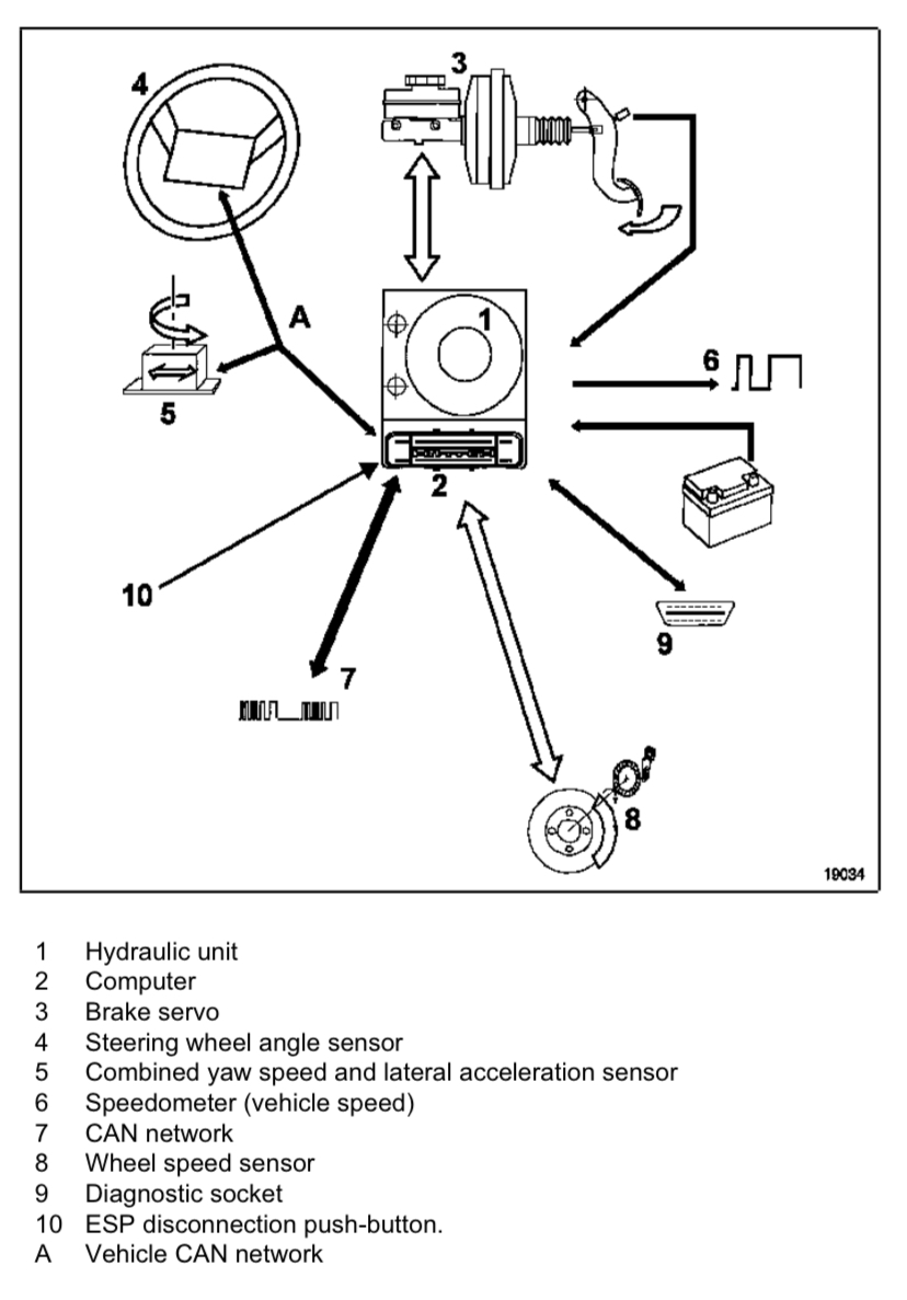

From the manual:
The ESP system consists of: ● a brake servo assembly, ● a pump unit consisting of:
● a hydraulic pump,
● a pressure modulation unit (twelve solenoid valves), ● a computer,
● a pressure sensor,
● a steering wheel angle sensor,
● a combined yaw speed and lateral acceleration sensor, ● four wheel speed sensors,
● an ESP disconnection push-button.
So any remaining air, especially on a car where the system has been left to run dry, will reveal itself as everything begins to move again.

Was it the esp light on the dash? the abs/non esp cars dont even have the yaw sensor. Mines disconnected and esp button removed and light turned off on dash, abs light works as it should and no faults stored. Had no choice getting rid as was never going to work with standalone engine ecu.
Yeah had both ESP/ABS lights on. The ABS light will have come on because the giro in the sensor couldn't figure out what the hell was going on.
