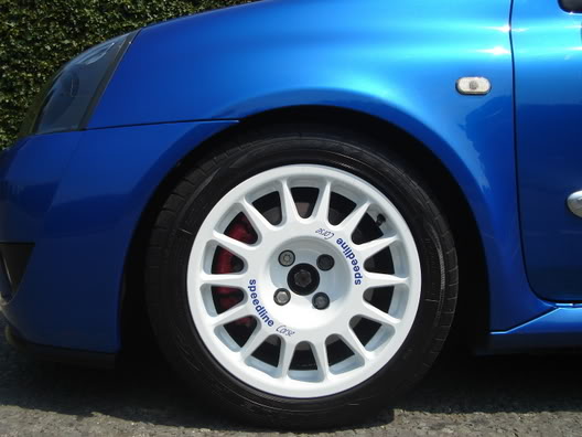

Looking at getting 15x7 2118's for the cup. It's currently sitting on a H&R Mark Fish Setup, Yoz has suggested going for offset of ET43 as it's lowered as usual offset is ET38, can anyone explain why this is the case? I don't doubt what he's said all, just want to see what others have done and there reasoning and choice behind this.

Well the cup has a wider track due to the wheels (ET38.5, Normal 172's are ET43 or 45 i cant remember) if you increase the offset it gives you more wheel travel within the arch to avoid rubbing and other related issues. Especially when lowering.
  182 FF & 306 Rallye

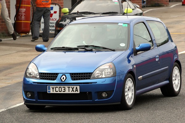

I recently bought a set in 15x7 ET38. I'm using 205/50/15 Toyo R888s and when lowered on Bilstein B14 coilovers (as below) there is very slight rubbing under very hard cornering until the rear part-arch liners were removed, and a small section of front liner removed and the bumper bracket moved/cut/adjusted. I imagine 195s might not have those issues. Regardless, just buy them. They look fantastic imo :D
  Lionel Richie
thats why we suggest the 43 offset because on very low cars you can get scrubbing
and you can always add 5mm spacers all round which will = ET38
so best of both worlds!

So Fred, with my H&R setup, think its wound all the way down on the rear (50mm) and around 35mm on the front, et43 sounds fine? It won't cause me any issues for opting for these over the et38?
Gaz_
  Extreme mode
i had ET38 on mine last year, 195/50/15's No scrubbing, pretty low, on H&R's too!!!
