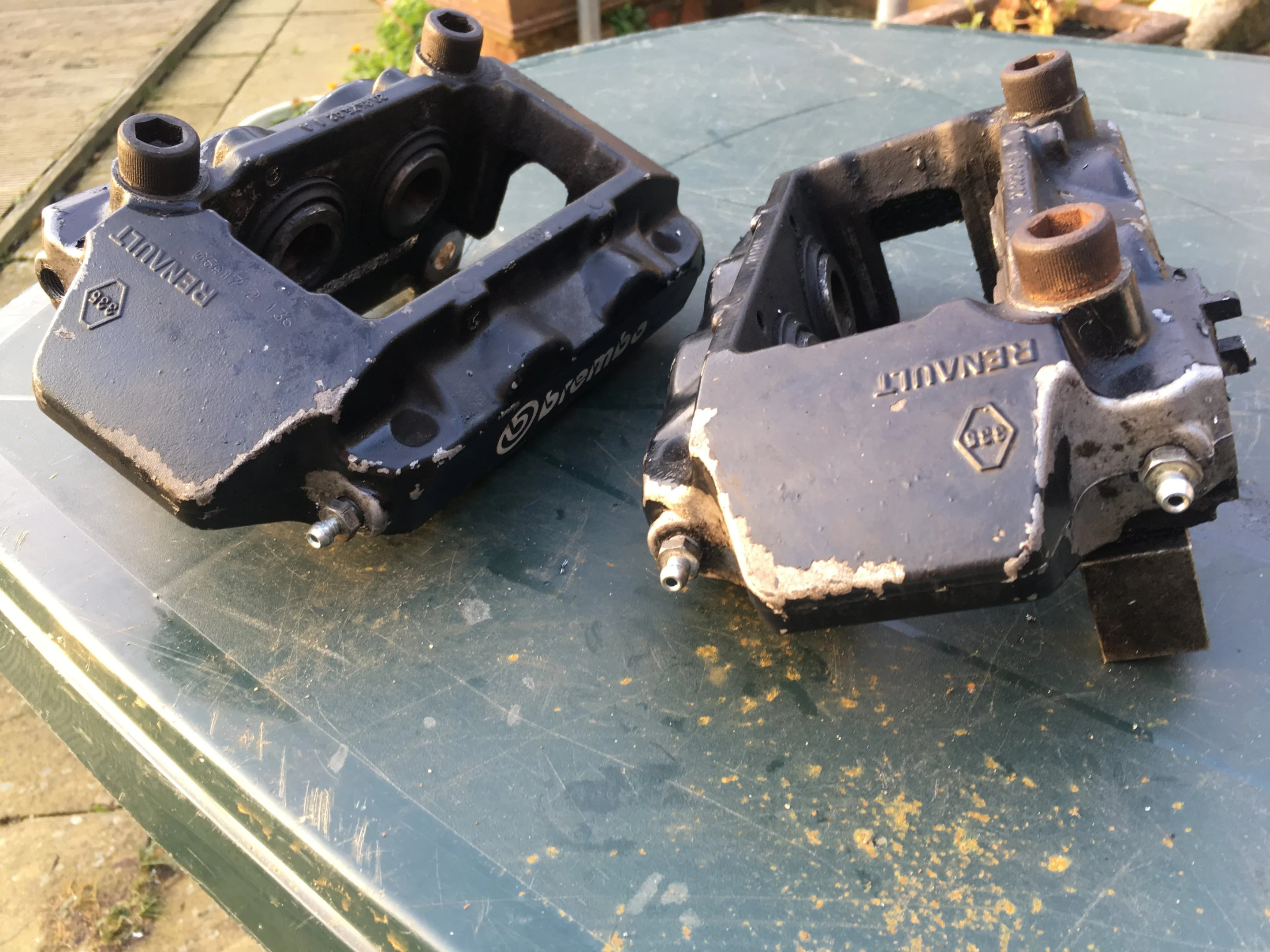

Snapped bleed screws in Brembos (3/4 snapped)

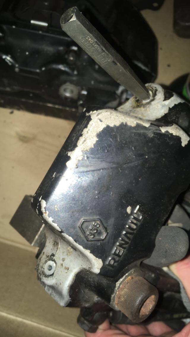

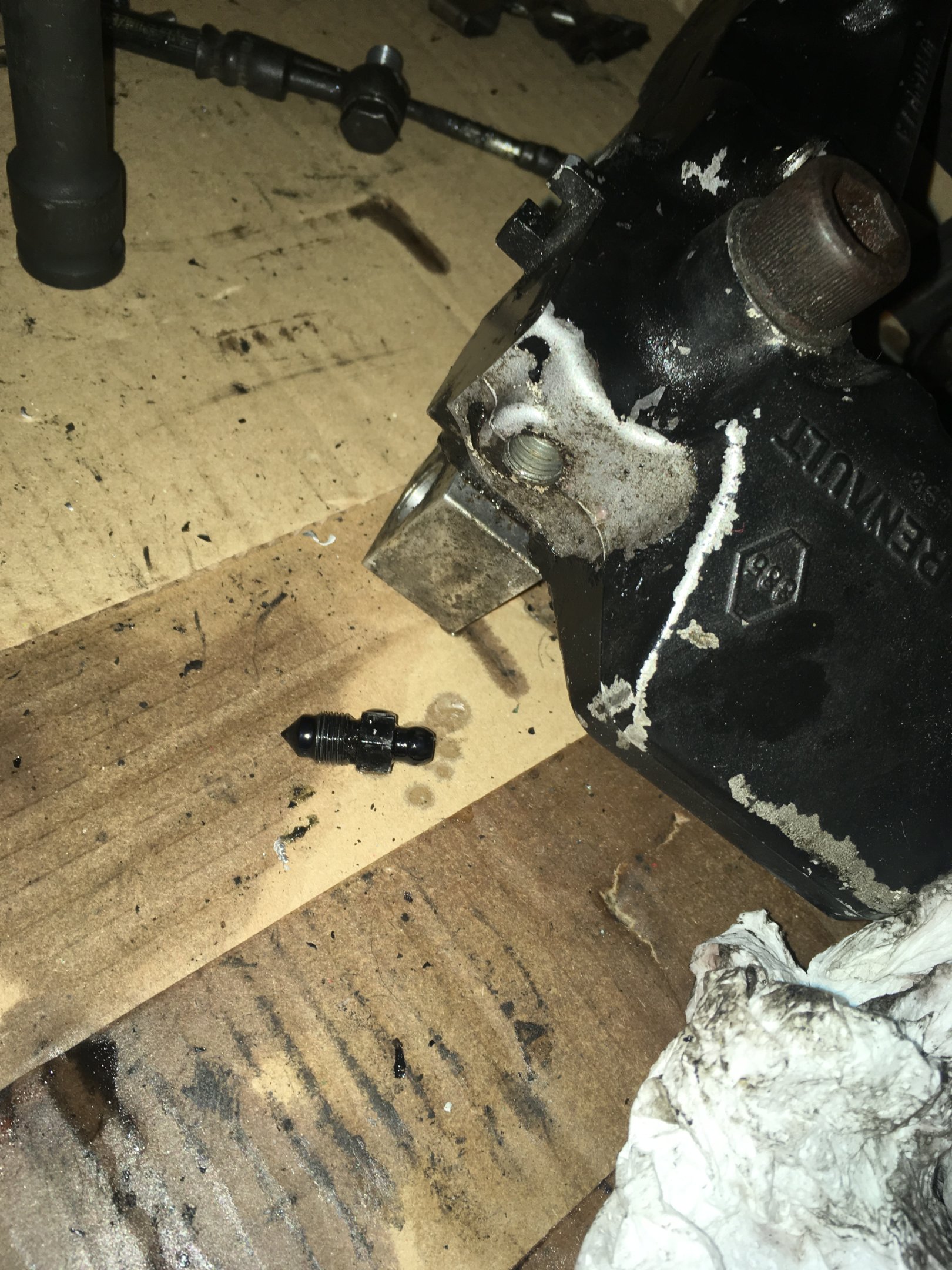

Im really stuck now, I got a extraction tool set, drilled out the bore a bit more but it wont budge, I heated them up but I only have small hand held thing which its still pretty hot but not blazing. I was standing on the caliper and the clamp and it just loosens the clamp..

soak them in 50/50 acetone and atf for a couple of days, then drill them with a left handed drill bit, hopefully they will pick up and wind out. if not you can get a propper repair kit for them with a stainless insert for the nipple to sit in.

Will get that stuff right away though whats atf, transmission fluid? I have renault d2 oil thats the stuff? Do you mean just dunked in but make sure to not touch the seals?

yeah, transmission fluid. doesn't matter if it gets on the seals. i just mix it and use it in a trigger spray bottle. give it a spray a couple of times a day for a couple of days.

Did two on my brother's Meg 250 calipers (which are the same size bleed nipple i think M10x1.0)
Didn't have any left hand drill bits, but if you do it'll be so easy. Think i went up to an 8mm bit and that thinned the sidewall of the nipple out enough that it practically fell out.

normally find when they are buggered enough to snap the head when you do get it out it tends to bring the thread with it as well.

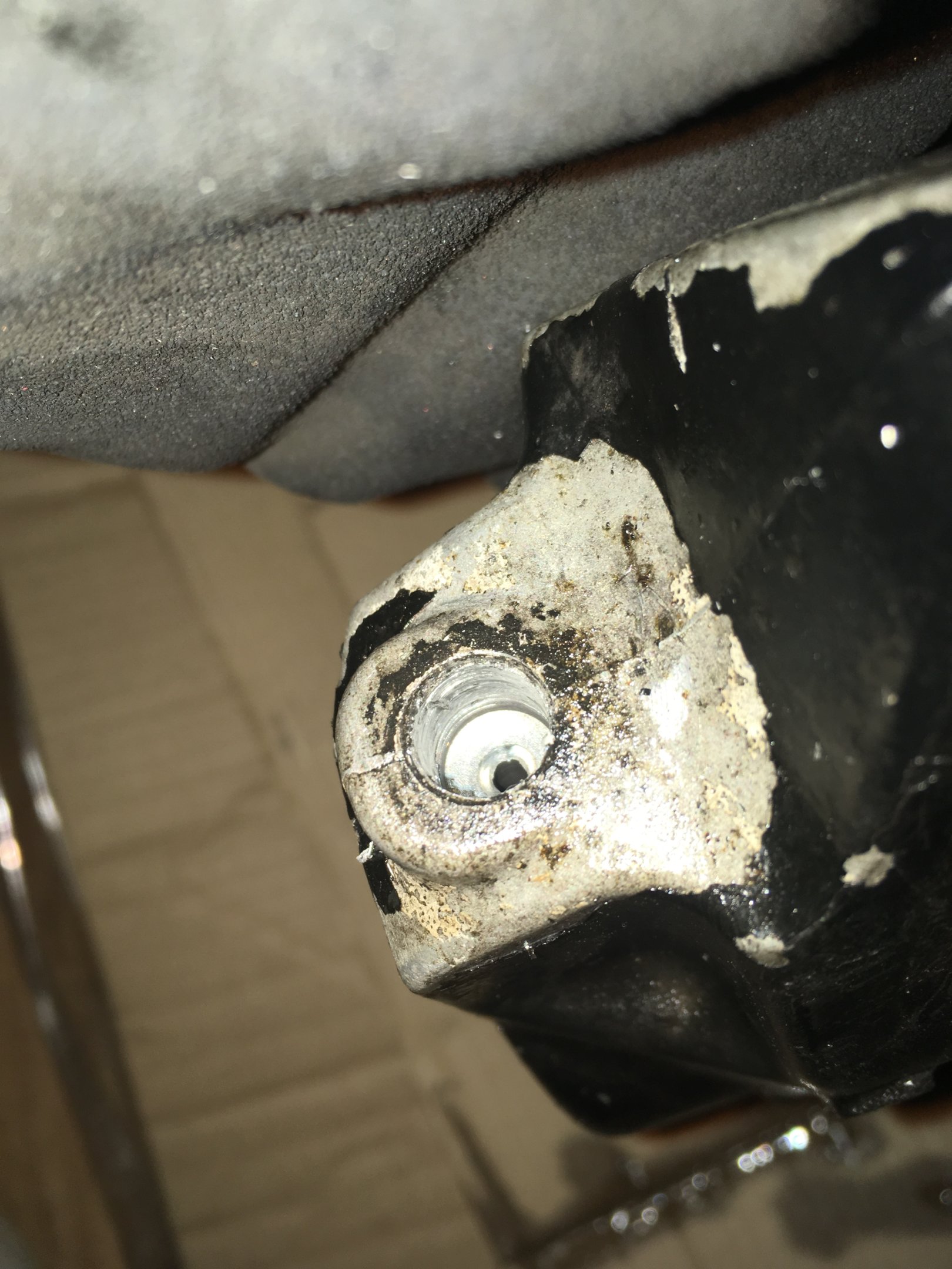

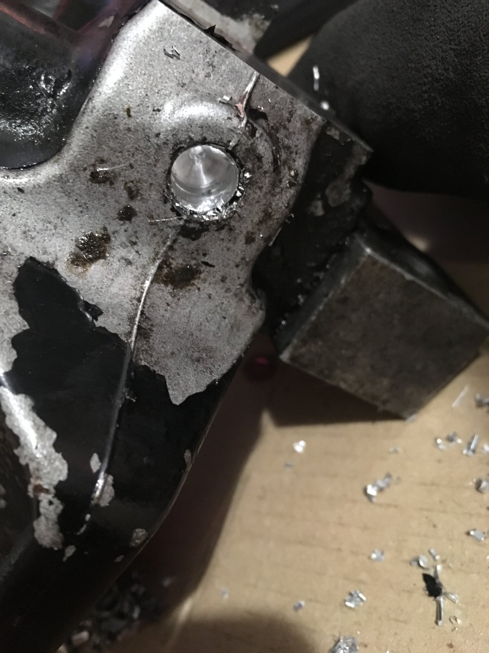

Is it fucked? 8mm bit did nothing
Although the only screw still in 1 piece came out easy

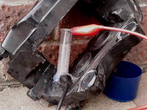

You can burn them out with battery acid but it takes a while - I had to do it with my Pug ones when the pad slider bolts were siezed in:

@JamesBryan Yes mate, I used a 6.4, then an 8mm but it just made the hole bigger. The thread is 10mm so I dont want to go to 8.7mm. Bit lost now!

It won't touch the alloy, just eat the steel nipple out, it takes about a day per nipple though even with power running through to speed it up (IIRC I used about 1 amp)

Are they? That seems like a pretty daft idea if they are, every brembo I've seen have been steel or brass.
PhillipM
  406 V6, Race Buggy
You won't pick up the right spot for the start of the thread.
I'd either try to get a pick in there and fold the thin wall inwards if you can, or if not, maybe just drill it out and tap it to take one of the Wilwood 2-piece brake nipples (big brass fitting with steel nipple in the centre for bleeding) - they're only about 15 quid for a full set - then you can just put the brass piece in with thread sealant, and use the steel nipple to bleed. You'll obviously still have to helicoil back to 10x1 or similar though.

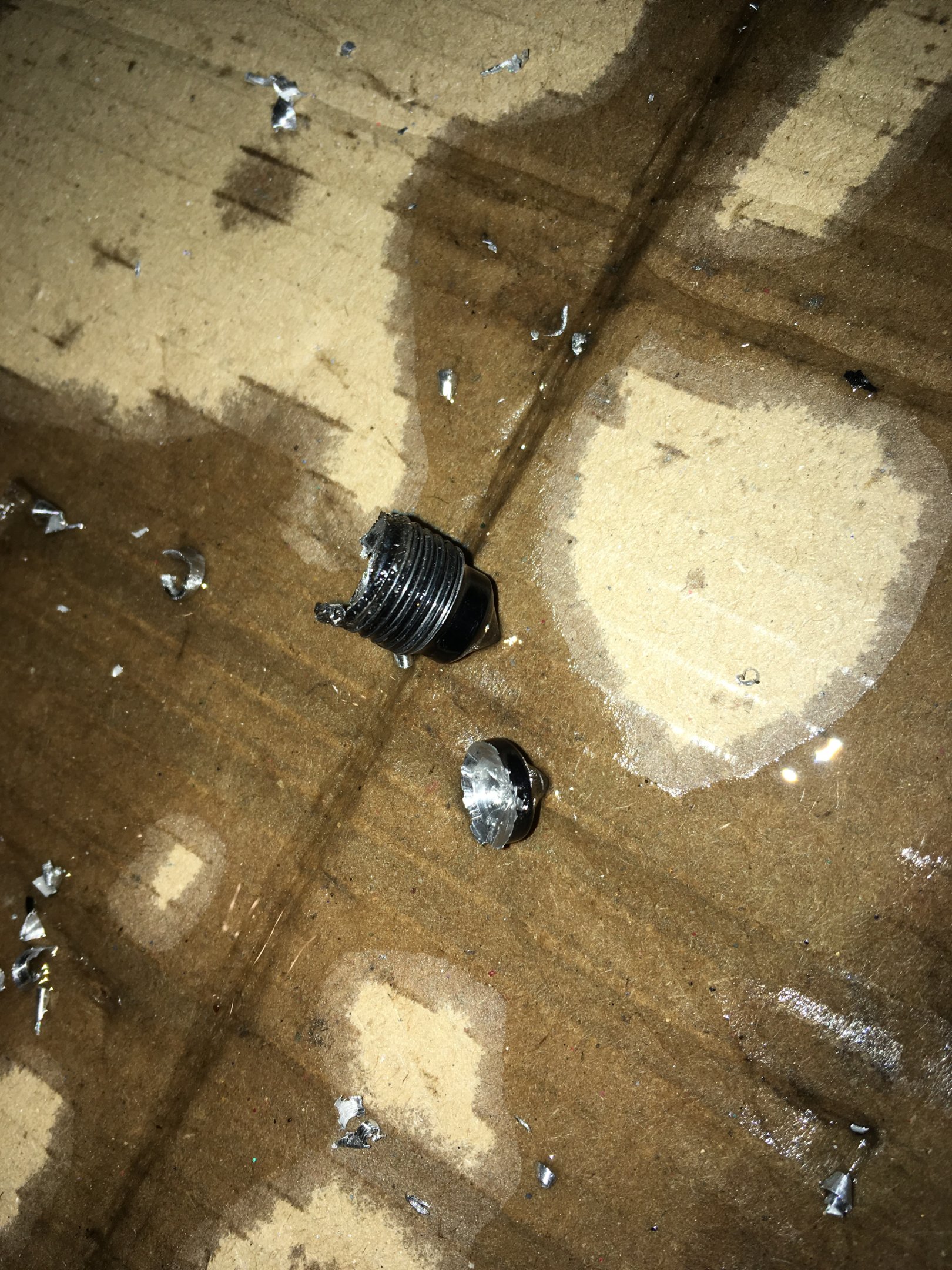

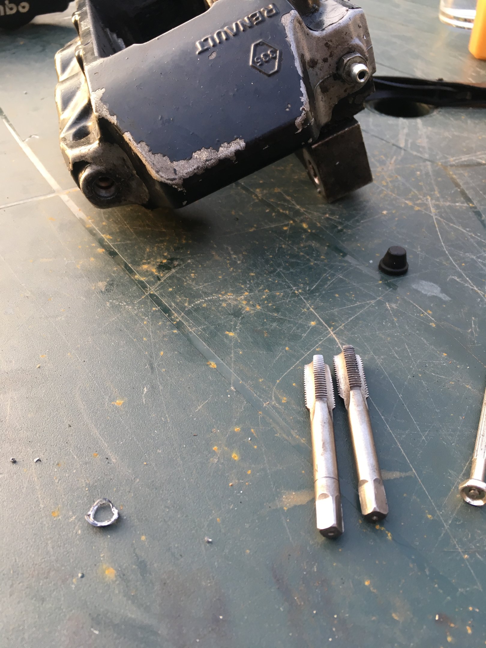

Did just luck out though.. 3/4 completely out, I tried the 8.7 bit and it snagged them. One of them got snapped but the thread stayed in, I think I could save it with a helicoil if I drill it out completely. The rest are fine though now, tested a bleed screw and they are all good.
