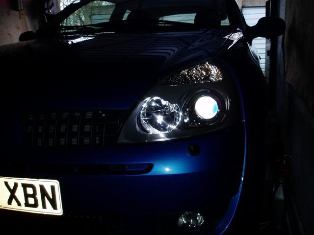

easy enough to do all. i found that piaa do a brilliant range of bulbs to match xenons but they are pricey. sidelights are around 10-15 pounds but they finish it off.
  S4 Avant
i swapped mine over last night, pictures in my project thread.
used the LED sidelights from halfords, and look much better than the standard ones.

I fitted some LED ones from halfrauds, were cheap, but the 'white' set have a slight blue tinge, ideal if you have xenons.........look a little odd on mine, having normal orange-y dipped and full beam (albiet Osram night breakers)....but not too bad.

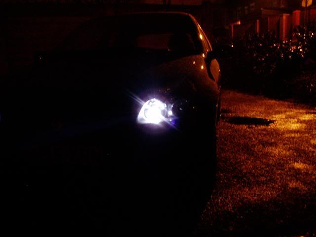

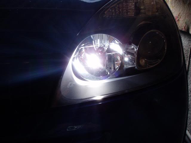

I have something similar to these . I bought mine from ultraleds but they don't sell them anymore for some reason . Been running mine for over 2 years now with no problems .
http://cgi.ebay.co.uk/ws/eBayISAPI.dll?ViewItem&ssPageName=STRK:MEWAX:IT&item=150298542870
These are mine .

Well i've ordered some white LED's from eBay, so i'm hoping they have the same look as yours :)
Don't blame me if they go titsup after a few weeks . You can get good quality LEDS that will last and poor quality ones . But for the price it's worth risking it i suppose .

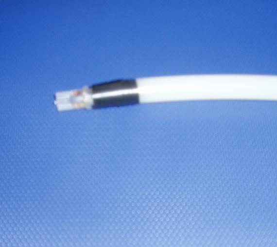

A bit of a tip . It's hard to change the drivers side LED due to the aircon . I used a bit of 10mm tubing with a split in and taped up to push in the LED with my right hand while i held the bulb holder with my left hand .
Hope this pics gives you a rough idea .Without the tubing i'd never have managed to change mine .Unless you have the hands of a small Philipino boy lol .
That's brilliant, thanks
