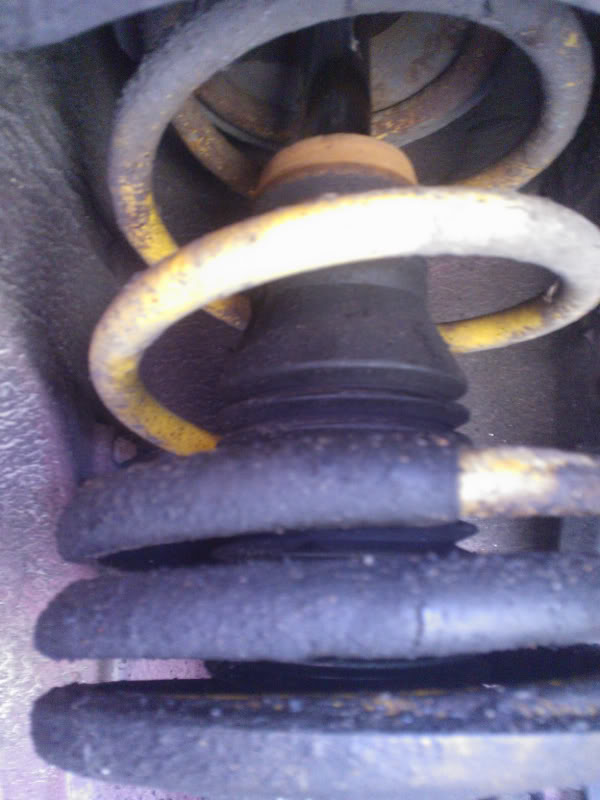

Ok, So.. Ever since i've had the trophy on reasonably tight right hand corners if I'm doing acceptable speeds, it feels like the back ends tail-sliding like some mad rwd car,
Now I know the front dampers are overdue a refurb but surely if the back is kicking out you'd think the rear dampers are shot? It's happened a few times and i've got a few brown pairs of pants,
Cheers.
  FRS
I did wonder why there were shafts going to the rear wheels, in all seriousness it sucks embracing which road surface your going to meet round the next corner, idea's?
  FRS
Checked the rear dampers and springs and both are fine visually, but the fronts are well past a refurbishment, could the fronts really cause such a problem? Cheers.

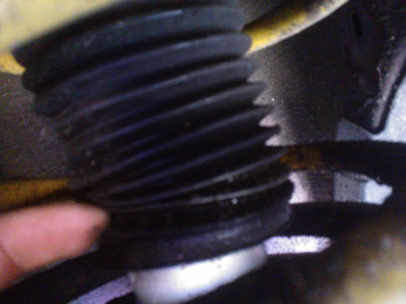

the seal on the front left damper just slides up and down, Covered in old oil/grease.

Sounds like they are all fcuked tbh. The corkscrewing under braking normally means the fronts need a refurb.

Your front dampers are knackered - well known on CT that the 'corkscrewing' is an indication of this. If your issue is on right hand corners, the culprit will be the front left as when its loaded up in the corner it will have no damping properties.
  FRS
Cheers it's always handy getting a response in which i'd hope to hear! Can't wait to get them done, and i think i'll just bite the bullet and buy koni rears also :)
