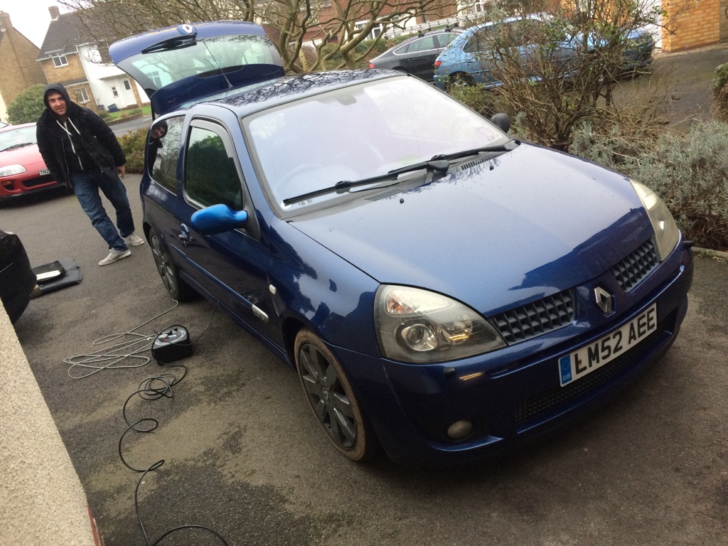

Clio update:

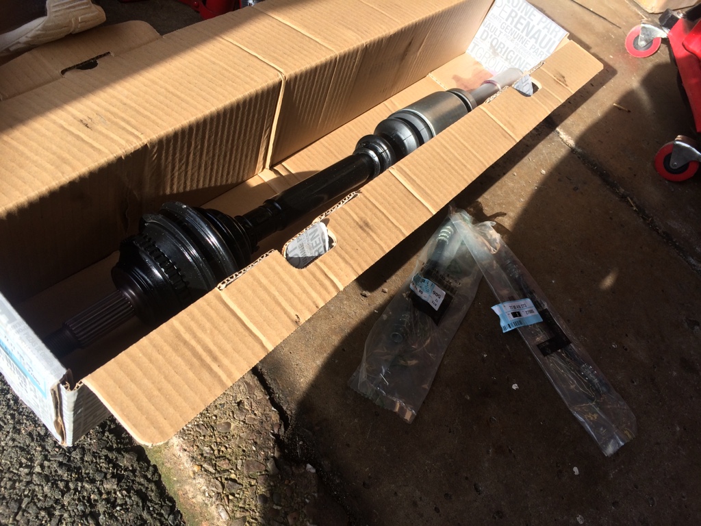

Failed mot :( tester was VERY anal.. Tyres were 2mm and over wear markers but were due a change.. I was hoping not to change them till payday though!
Think he was after the work though as immediately started plucking prices out the air and writing them down and seemed annoyed when I said I would do the work myself

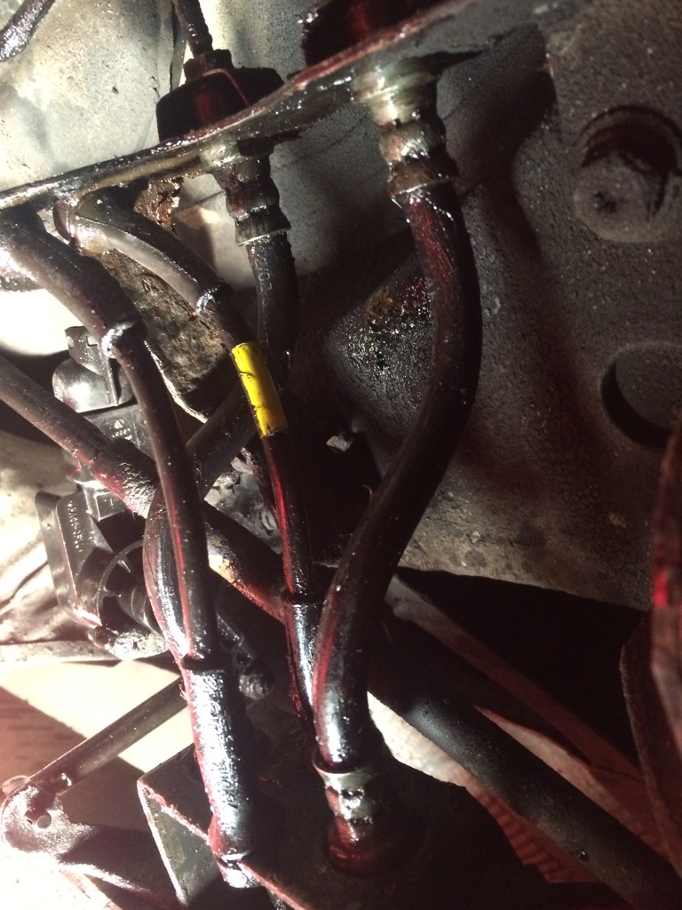

The lines were very very slightly corroded on the rubber fittings but in fairness the Cv did have a slight tear

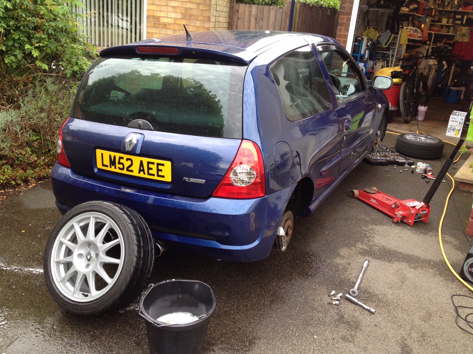

So fitted a new shaft and brake lines from Renault.. And a full set of Yokohama S Drives

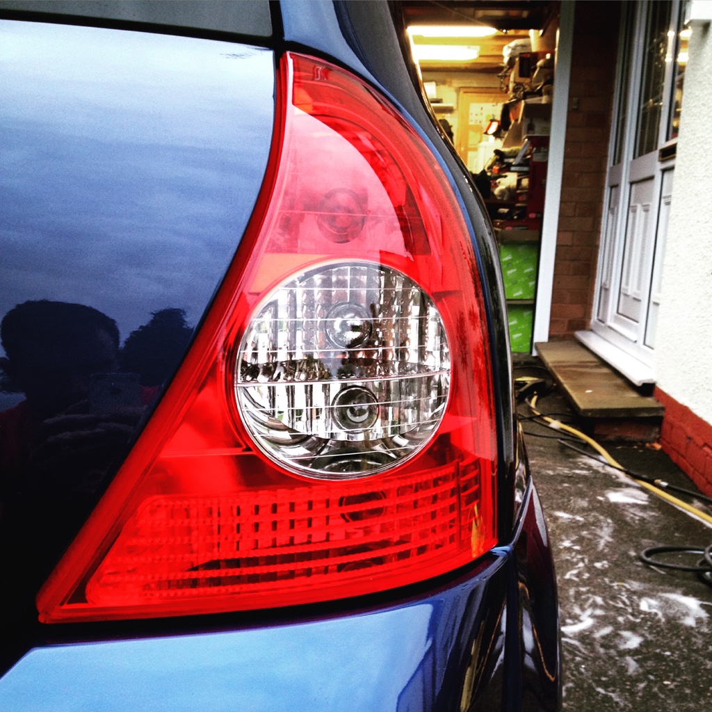

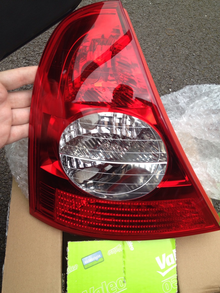

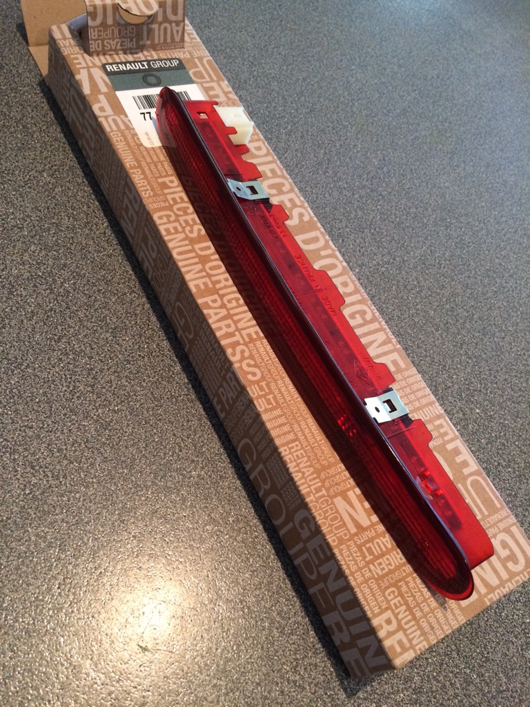

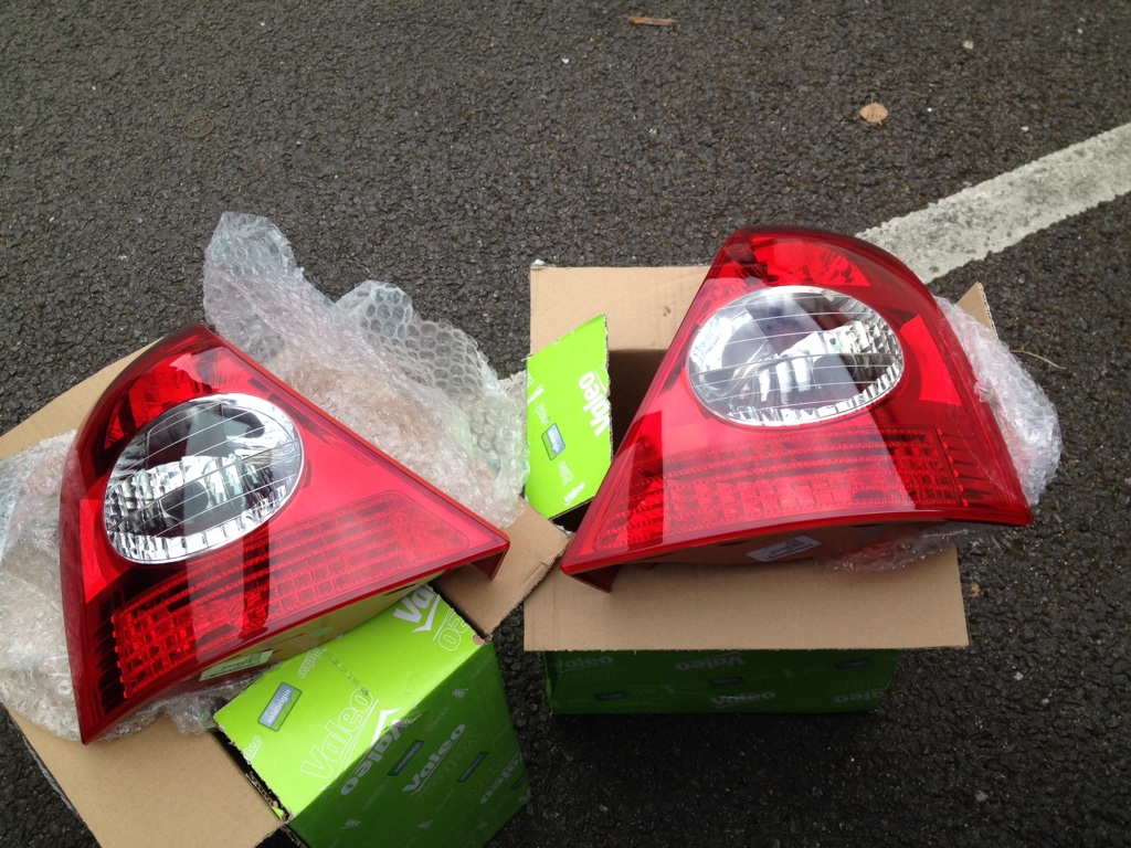

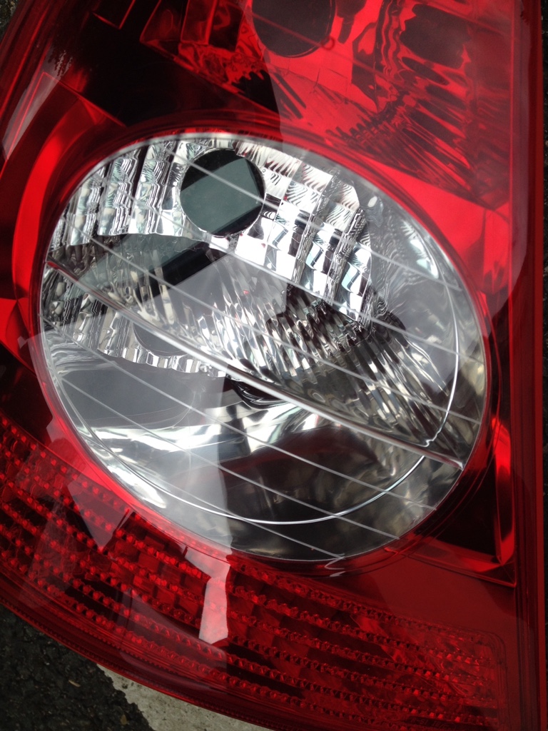

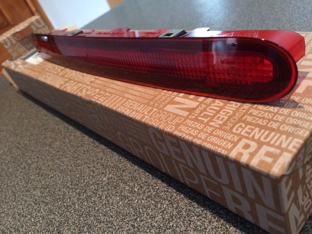

New cup spoiler brake light
Part number 7700429000 for anyone searching...

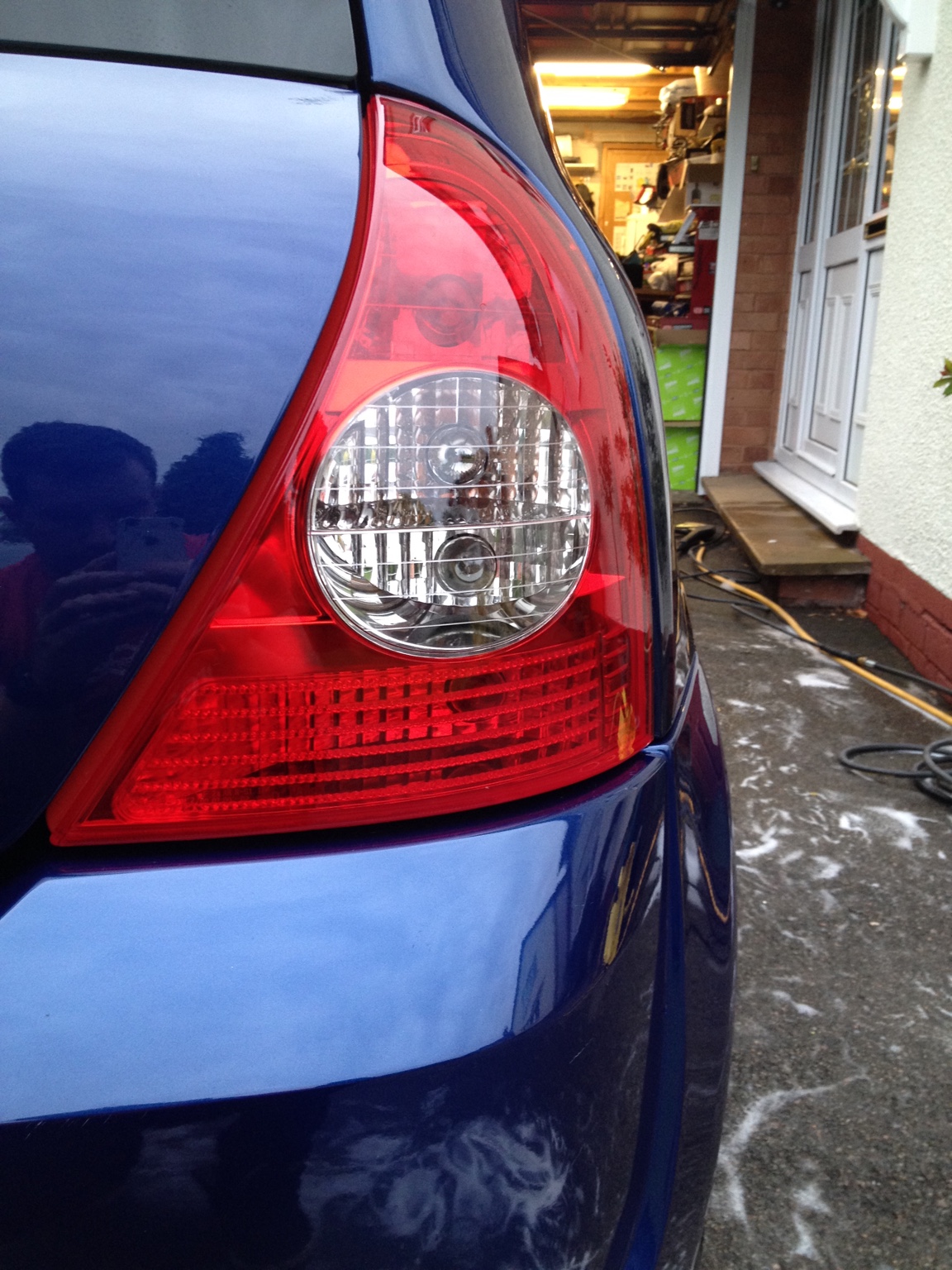

My old one was looking a bit scabby, plus when I was cleaning the earths from an intermittent fault it pretty much fell apart inside! Could have probably resoldered it but it was only £30

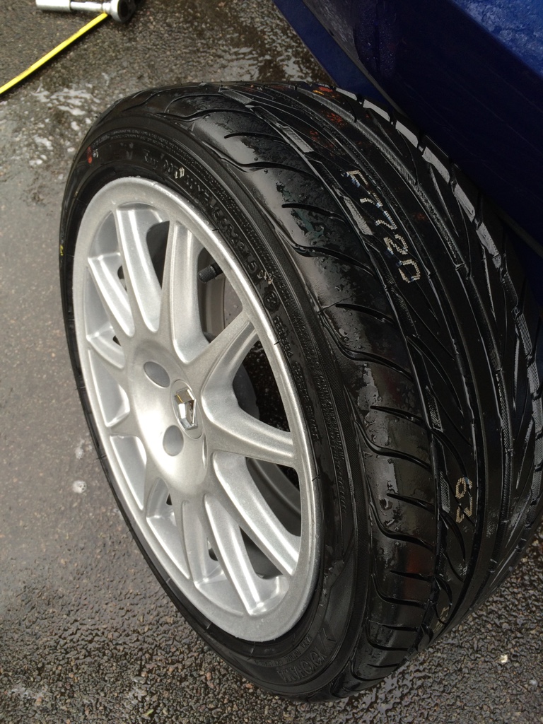

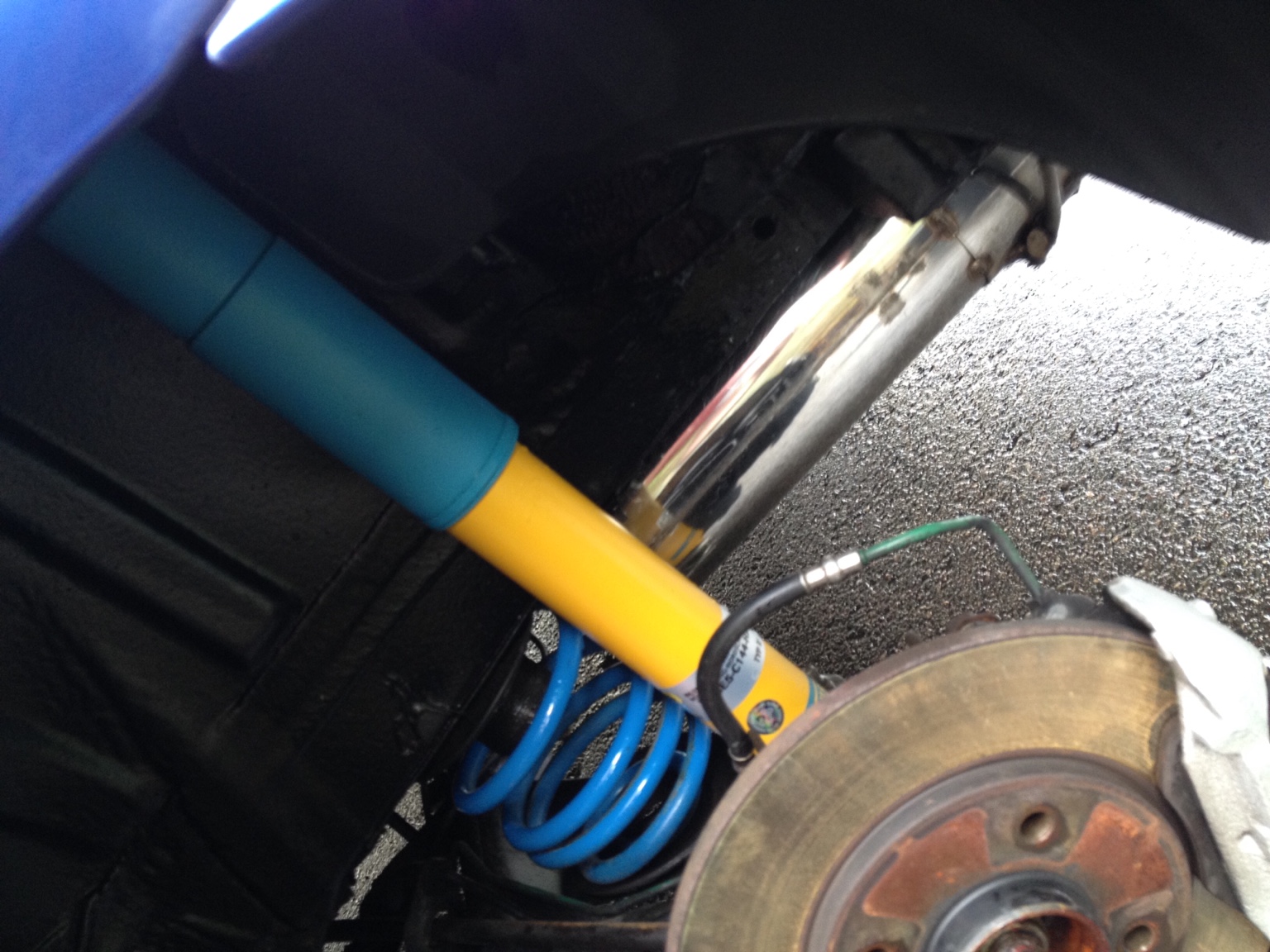

So at the weekend I took the 172 to Wales for a good blast

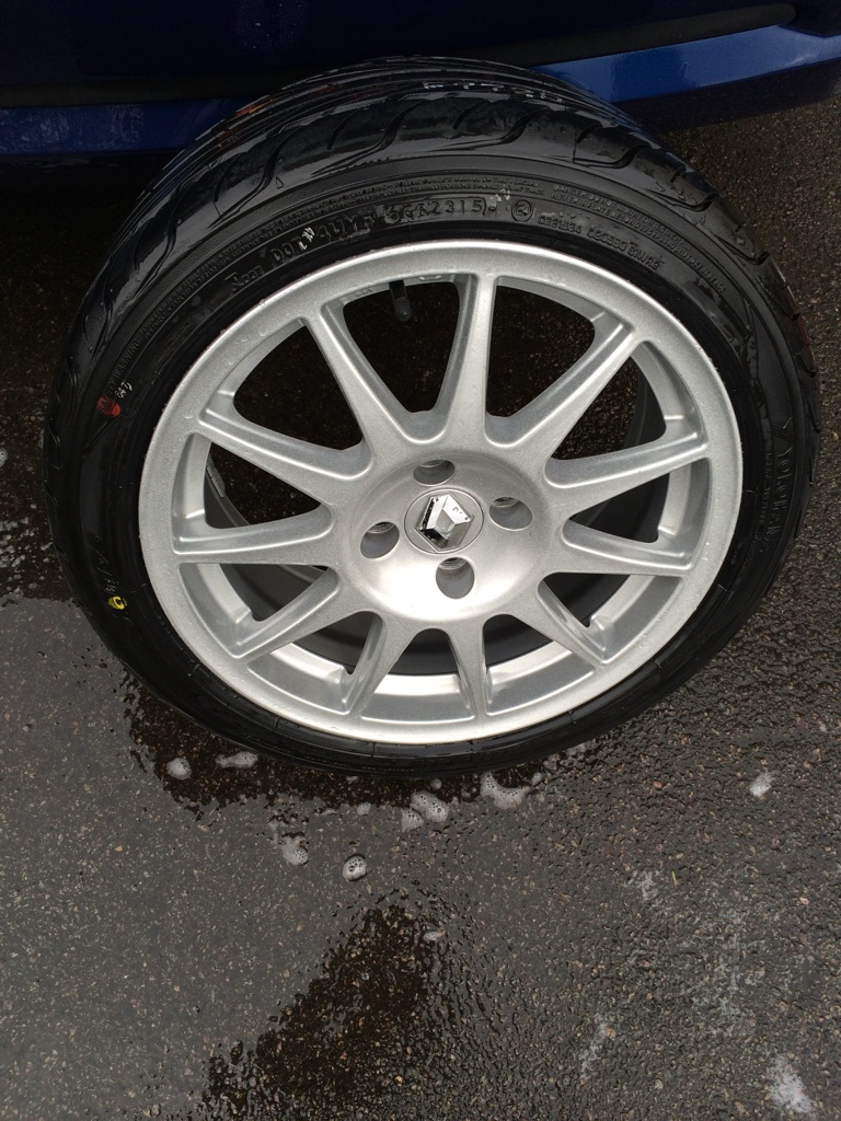

It handles SO much better on the new yokohamas + b14s
the grip even in the wet is brilliant!!! (Being as it rained sideways pretty much all weekend I had plenty of opportunities to test it) and I can honestly say I certainly rate the Yokohama s drives as a good all round tyre!

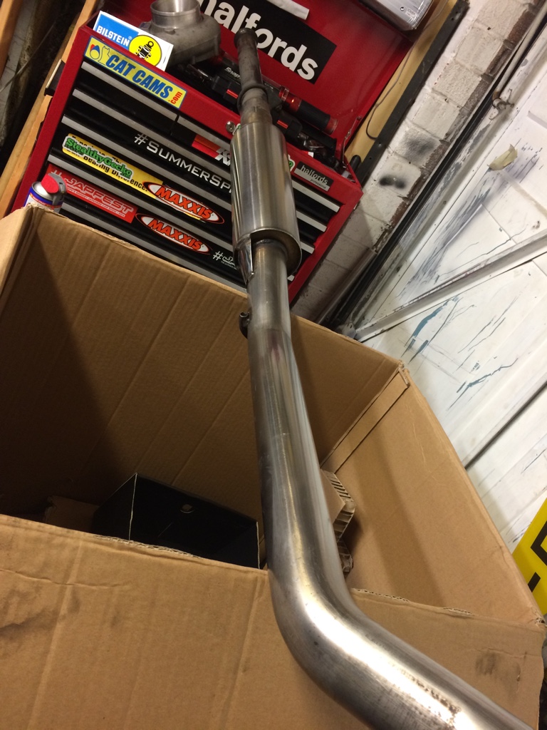

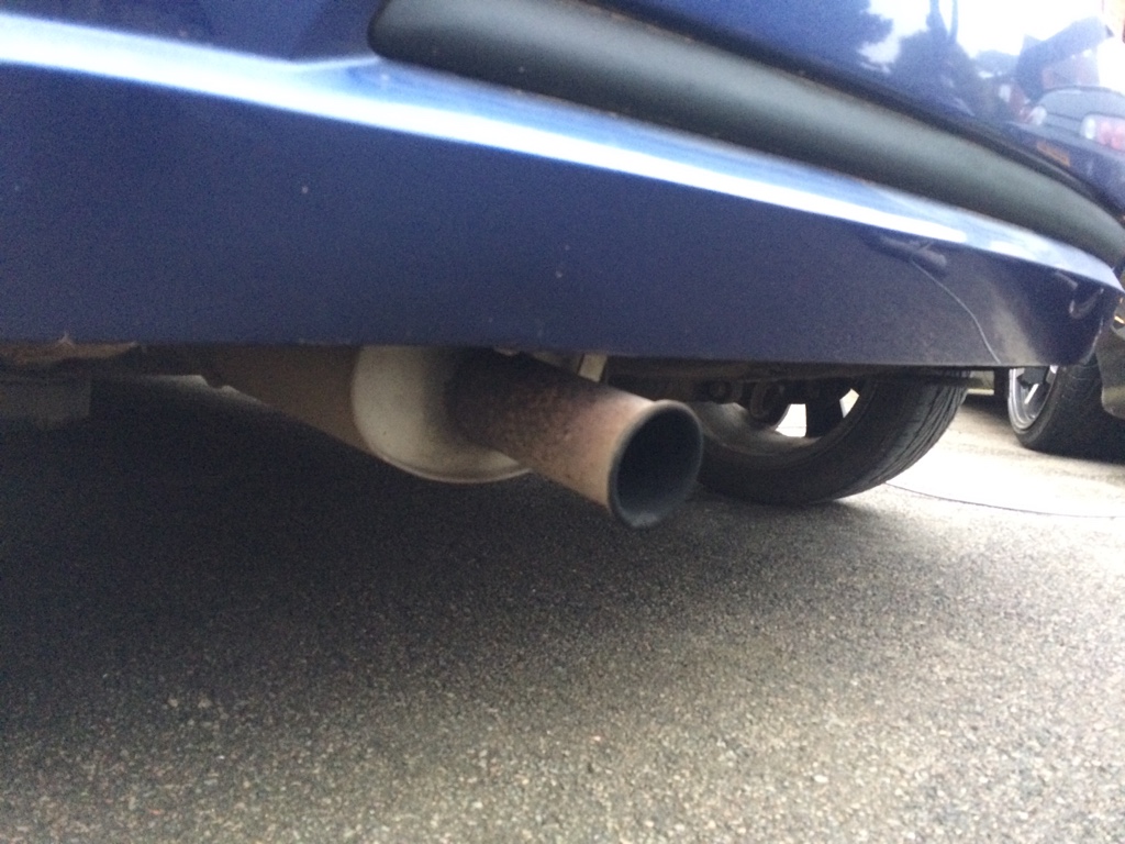

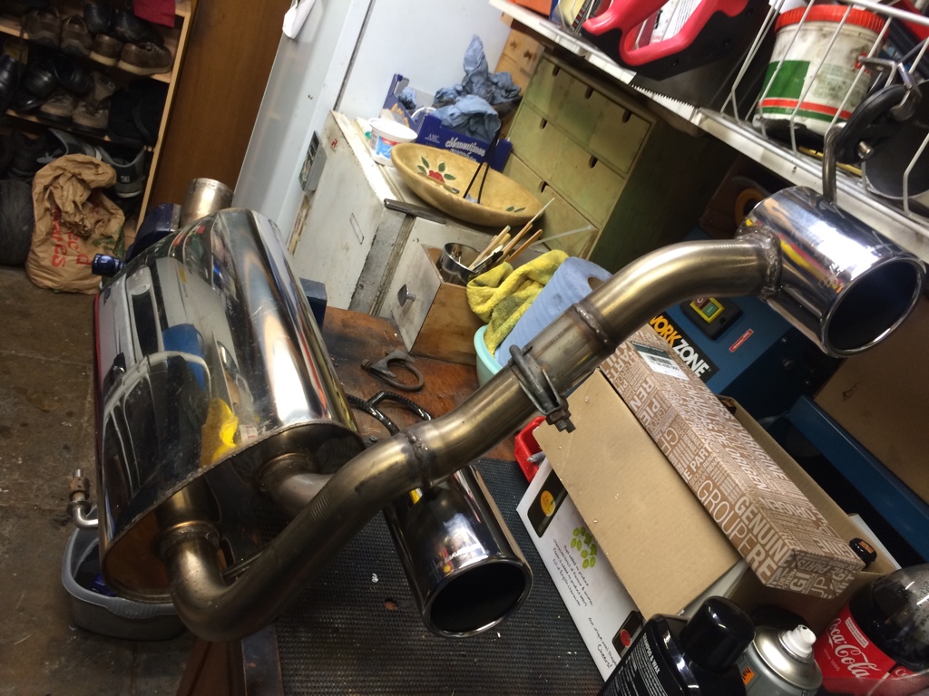

whilst I was out and about I picked up a new system.. Maybe a controversial mod but I don't much care :p
It's a Ktec 182 style system and carbon trims
I think I've missed the twin pipes of my last 182.. Rear Carbon trim is definitely on the cards too like my last one
In my opinion I prefer the 182 rear end with the twin pipes in that it makes the car look that little bit more special and ever so slightly more bonkers..
And I think shoehorning a 2.0 into one of these little plastic sheds is pretty bonkers so why not shout about it..

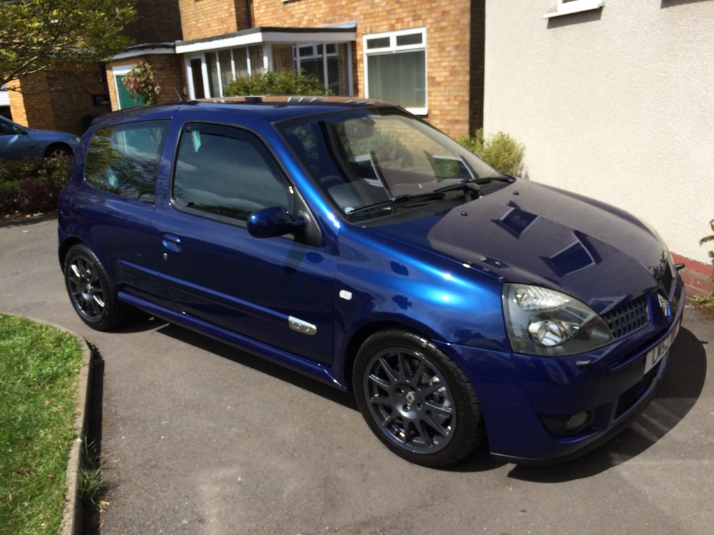

Anyway.. This is it after a clean up :)
RS Tuner is on the way too :)

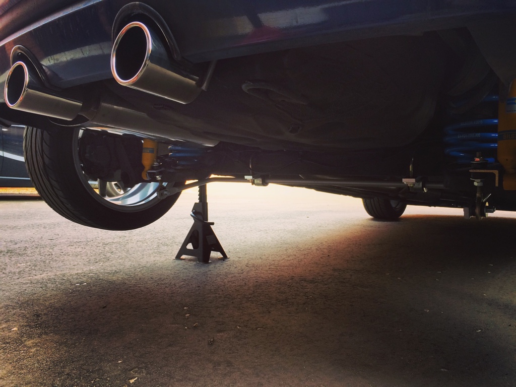

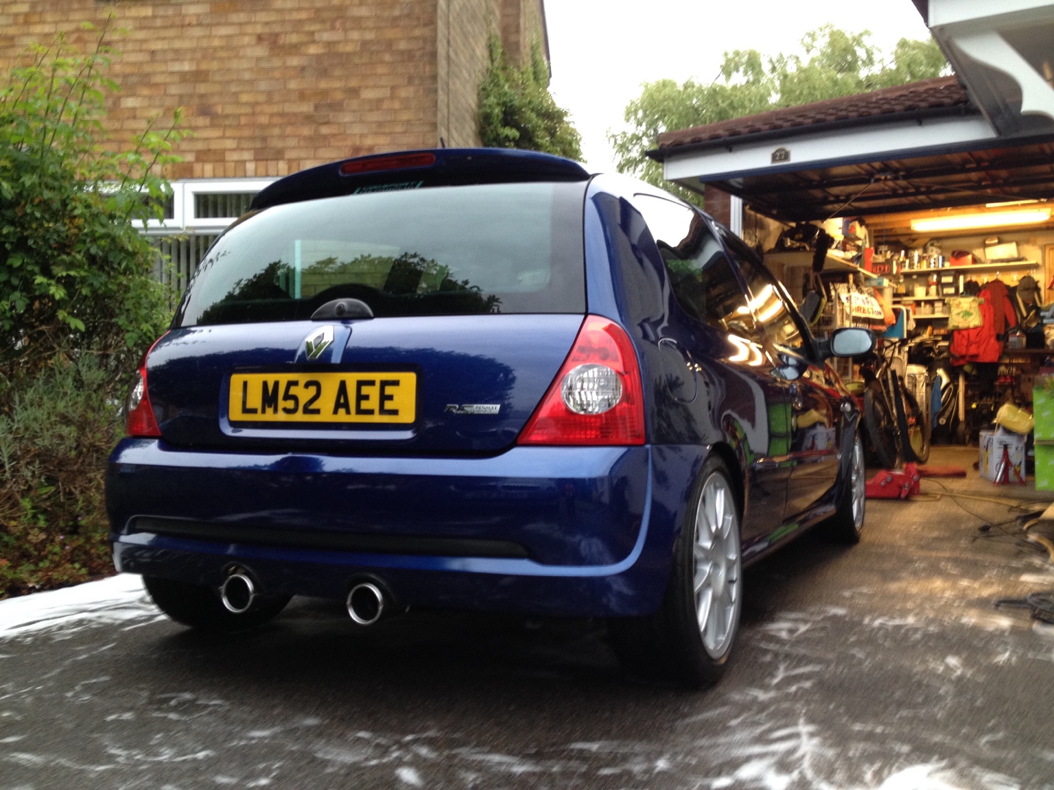

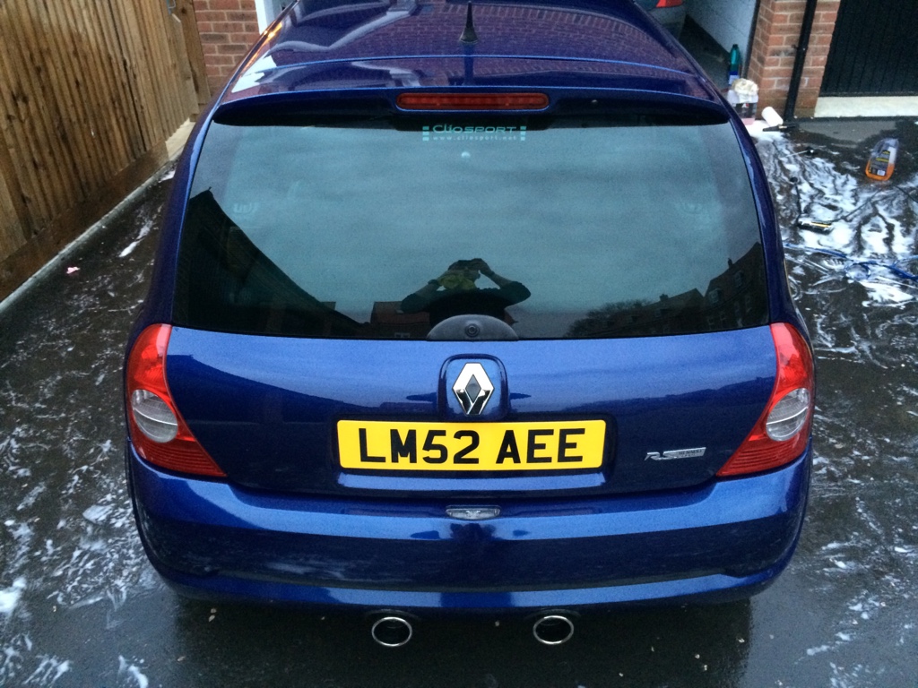

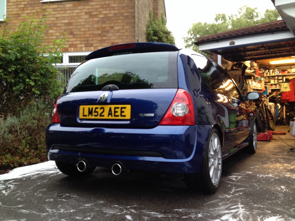

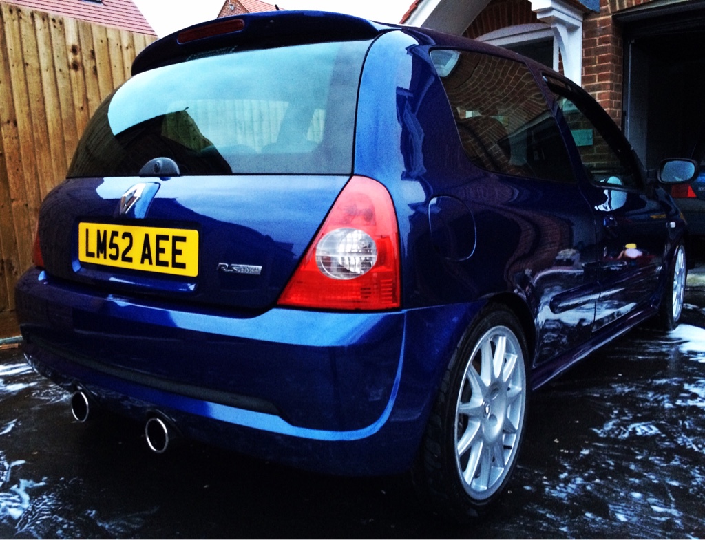

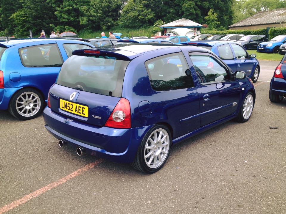

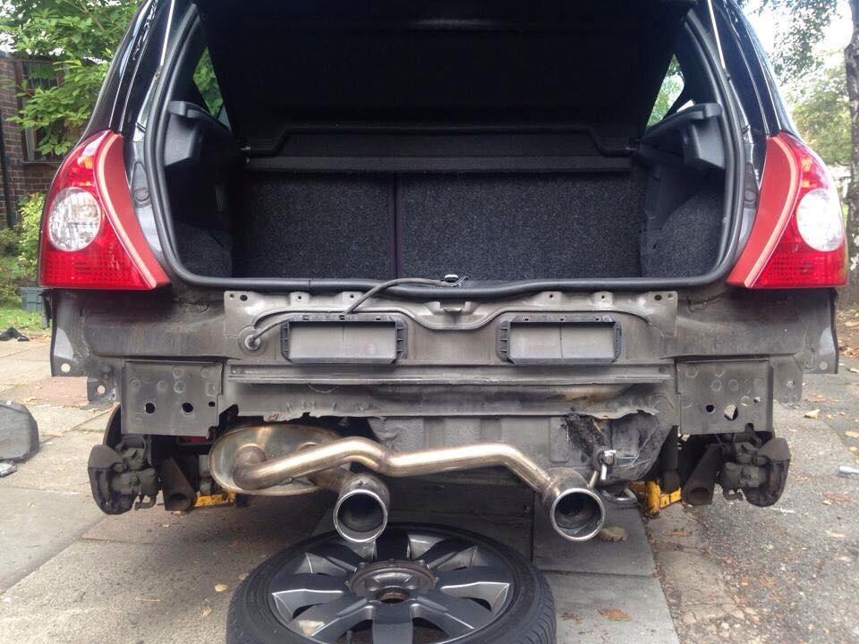

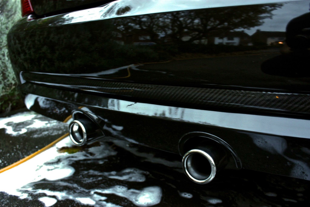

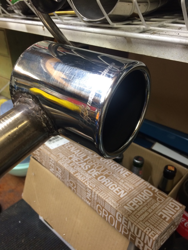

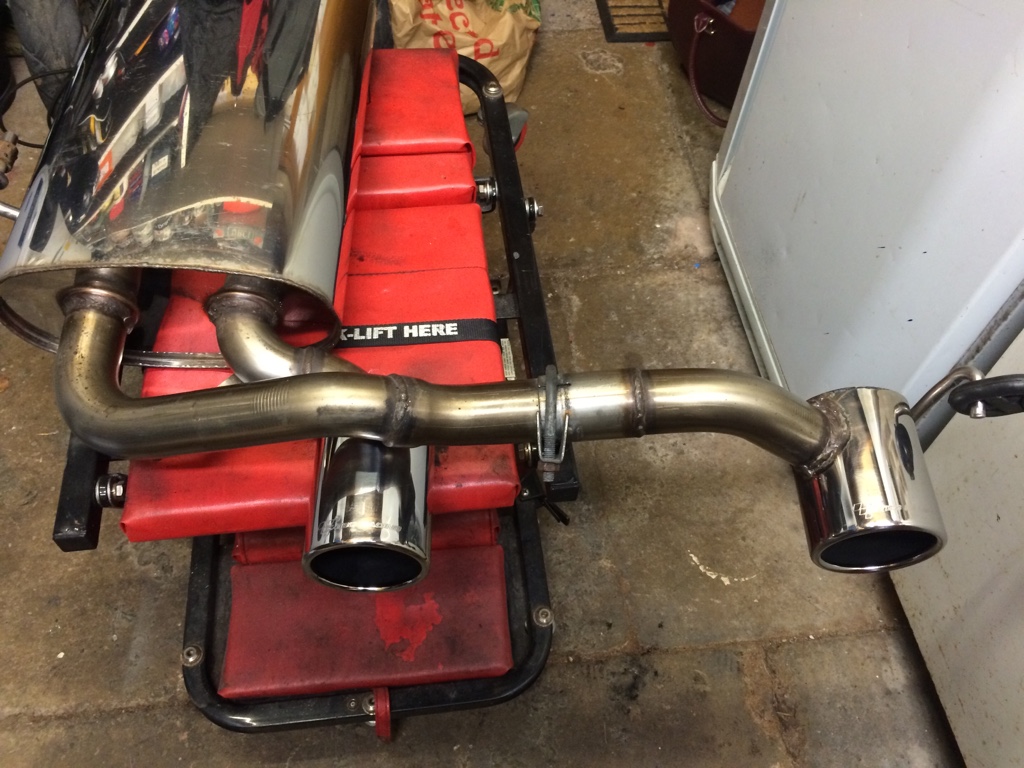

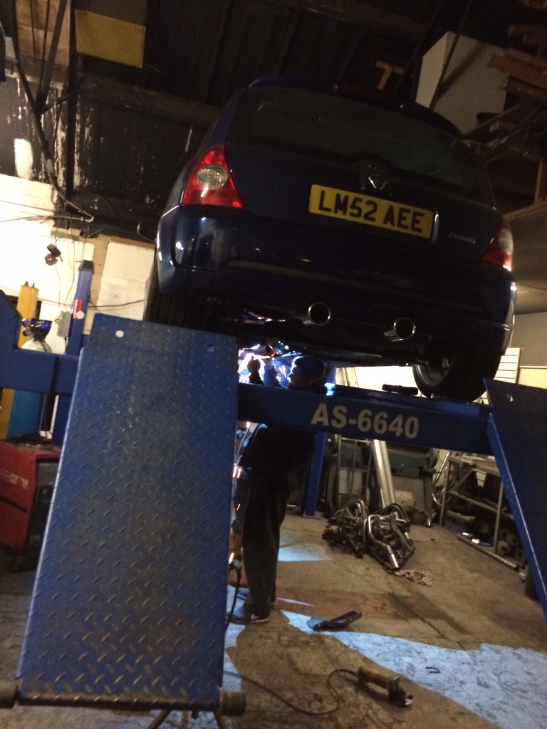

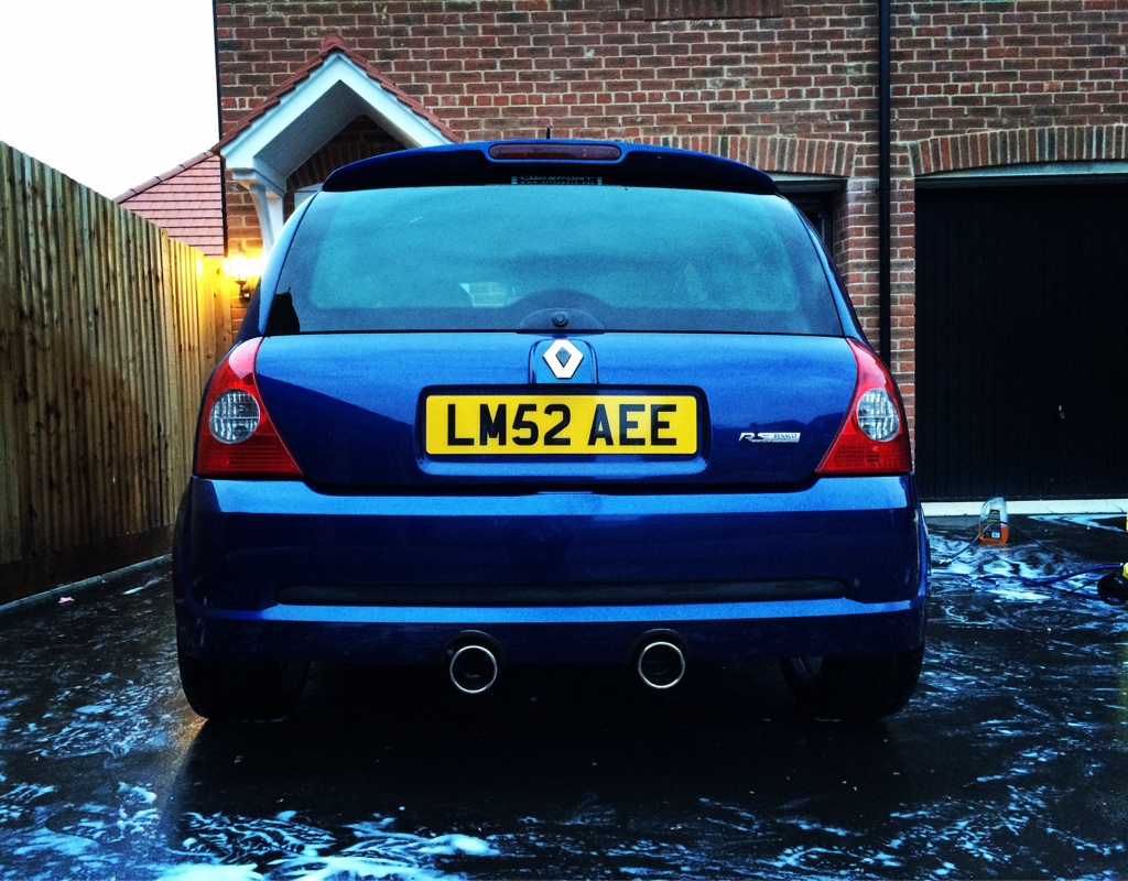

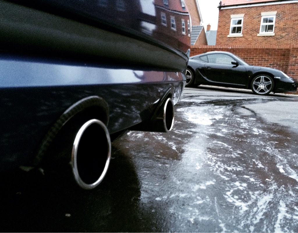

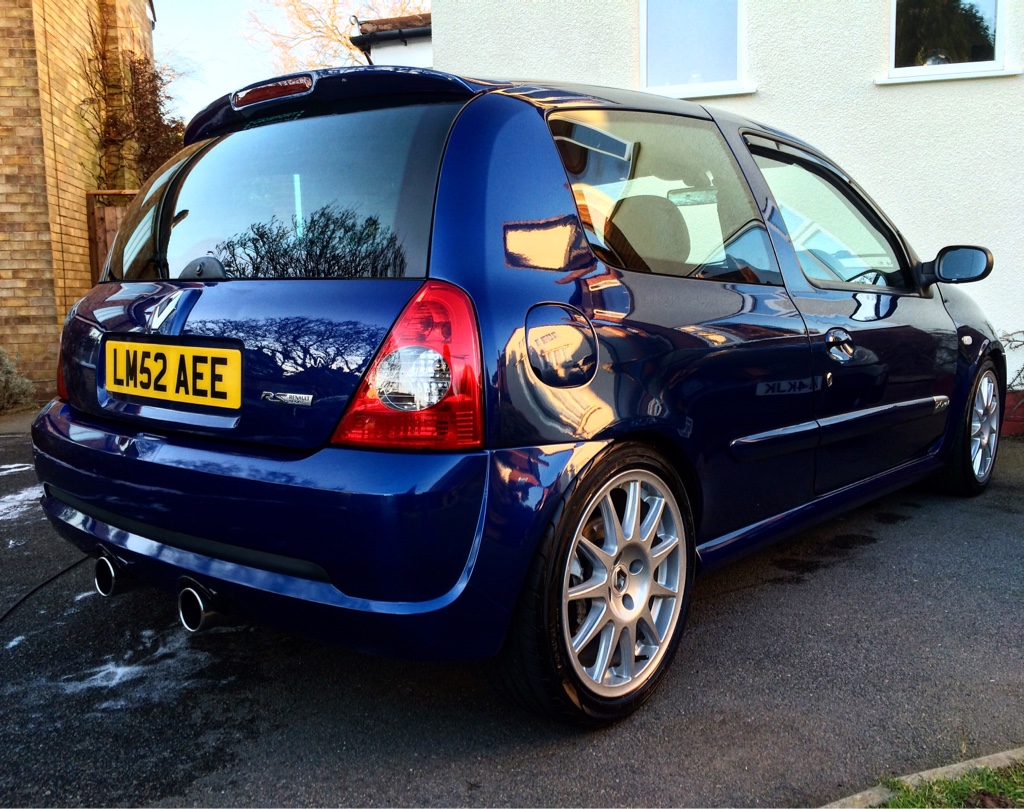

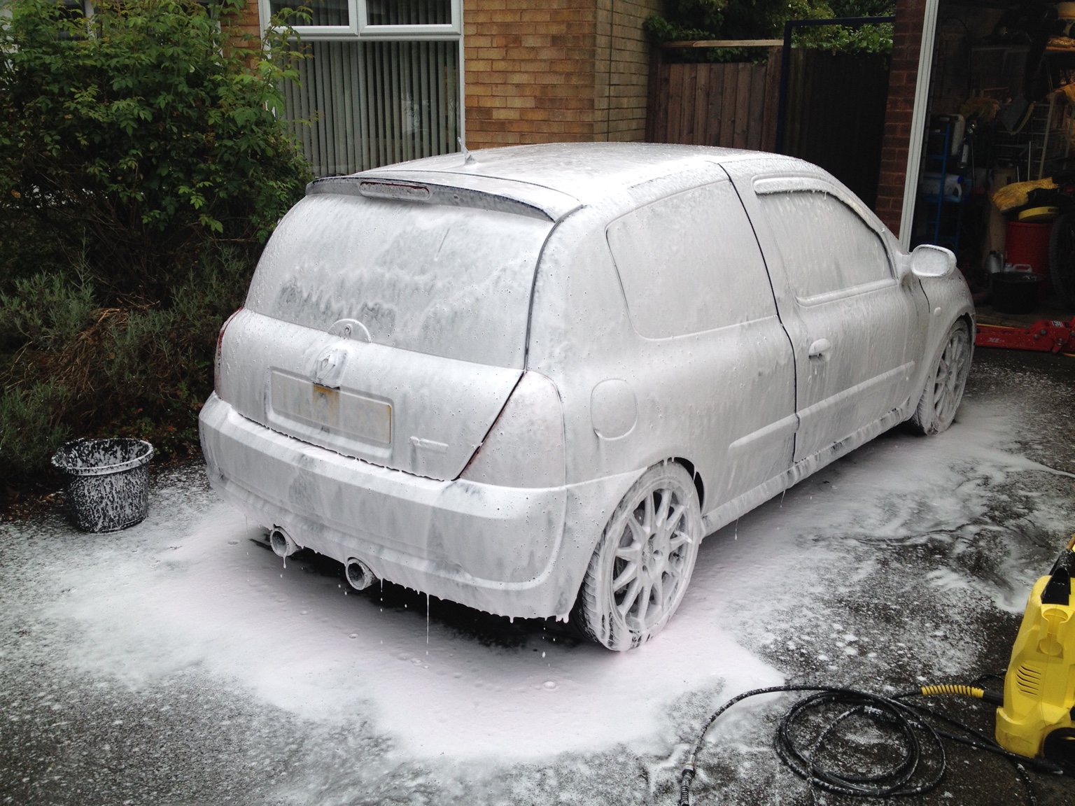

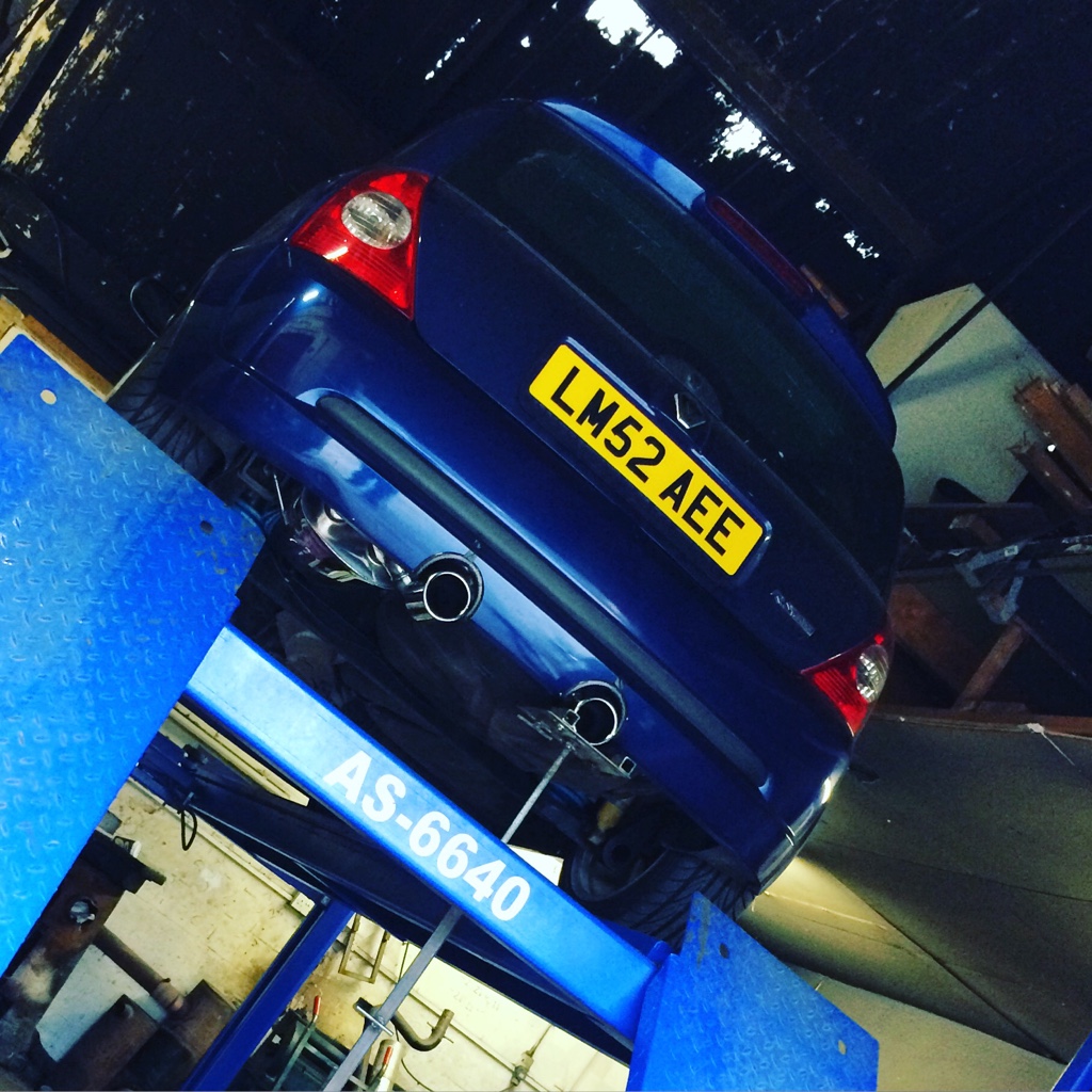

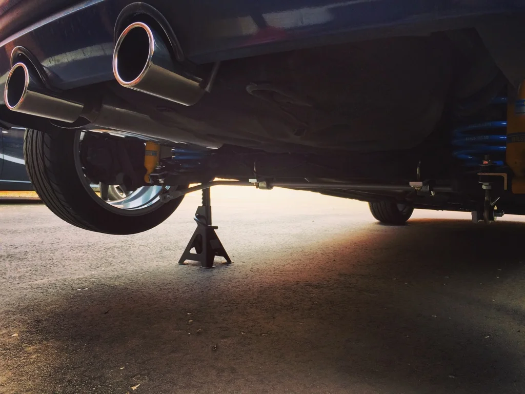

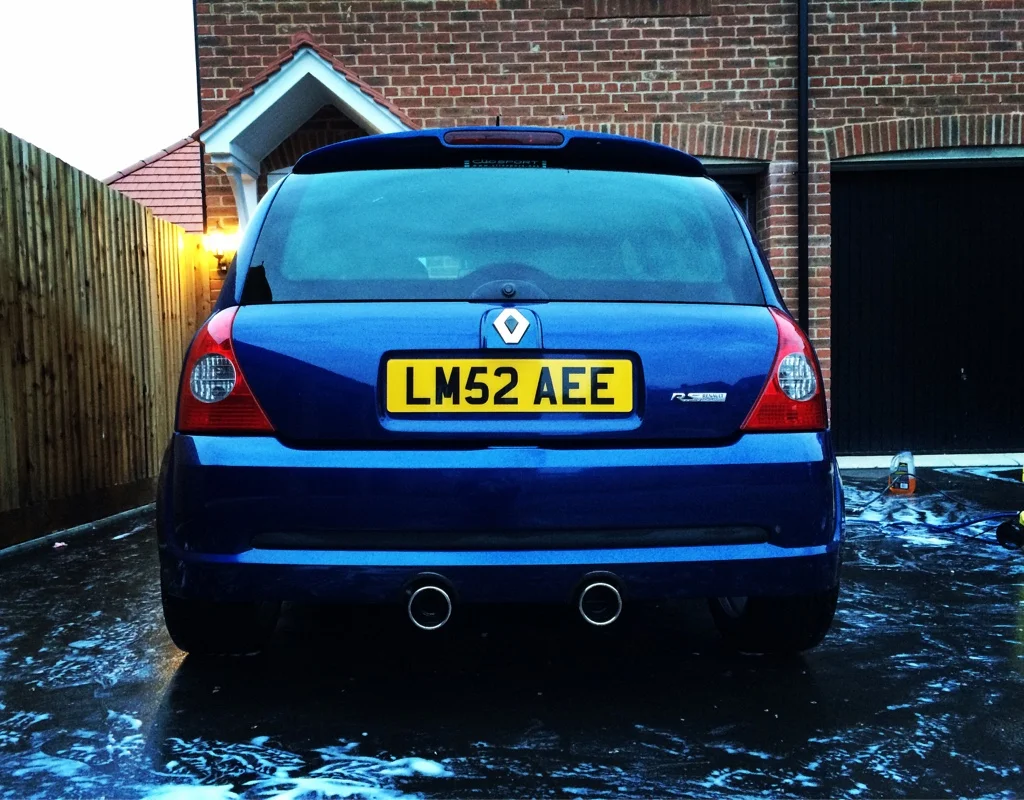

So it's on..! I very cautiously cut the holes with a Dremel after measuring a friends 182
Took ages with measuring and re-measuring about 10 times before finally making the cut

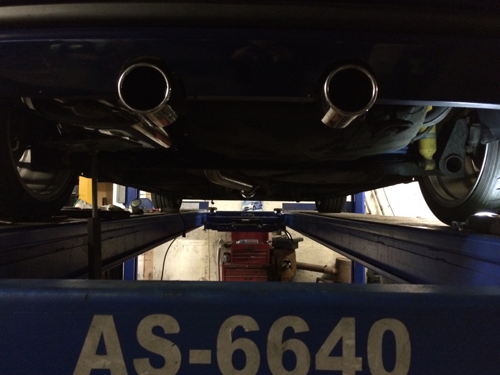

Got the twin pipes fitted by John Ashley Exhausts in Walsall who did a great job along with fitting a stainless decat at the same time!

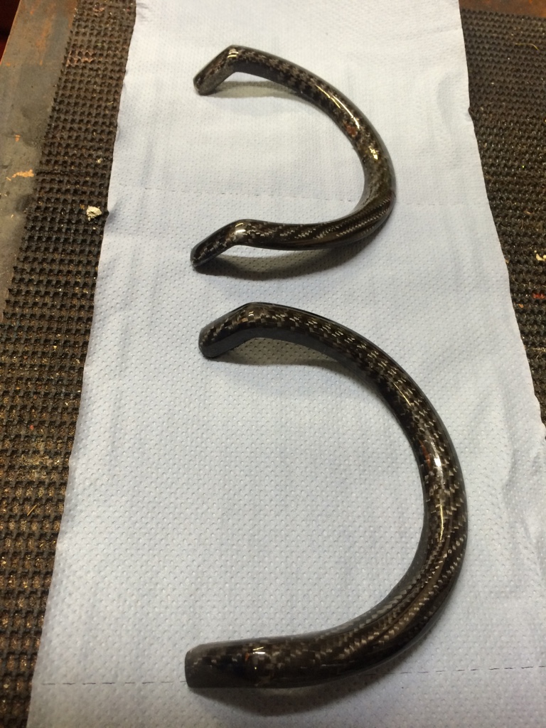

Fitted the carbon trims and cleaned :)

That looks amazing. Always wanted a twin exhaust on my flamer 172.
I always though that you needed to remove the spare wheel in the boot etc?
edit.. new ktec product, pricey though.
Fair play Rob that's lovely... Monaco and flamer are lovely colours on 172, the Monaco definitely looks smarter imo.
Twin pipes looking perfect! One thing I never liked on 172 is the back end as it looked a bit pants with no exhaust considering its a 2.0... A little underwhelming.
Silvers turini suit a Monaco perfect.

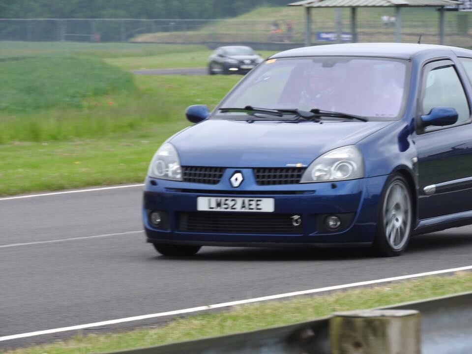

little update.. took it to FCS last weekend as managed to get a pass and track time for a bit of a bargain!
and....Was all going well up until this point...
Queuing up
Had a great little battle with an integra.. was my first outing on such a big track so definitely need to get some more practice in.. first few laps were very sloppy.. and the car took some getting used to with the new ARB fitted.. loved it though.. after a few laps it was clear my brakes were fading so brought it in to cool off..
back out again..

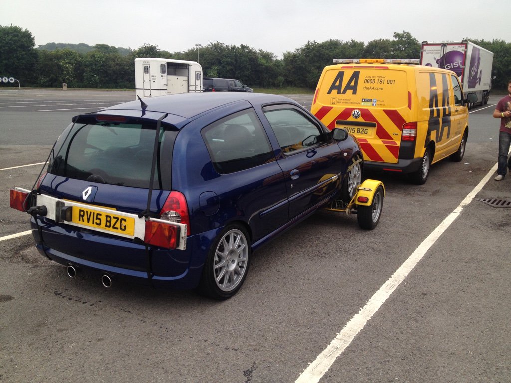

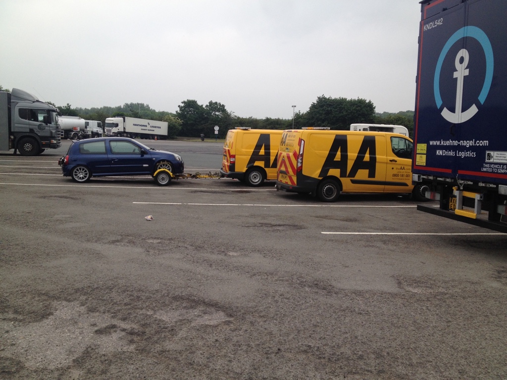

After some enthusiastic laps the car developed a slight vibration from my nearside left front wheel.. So decided to limp it back to the pits where I discovered a torn inner tie rod boot and a knackered looking joint..
Decided to get the AA to take it back to prevent any further wear or risk it letting go.. I guess its what i pay the relay part of my membership for so may as well use/abuse it!

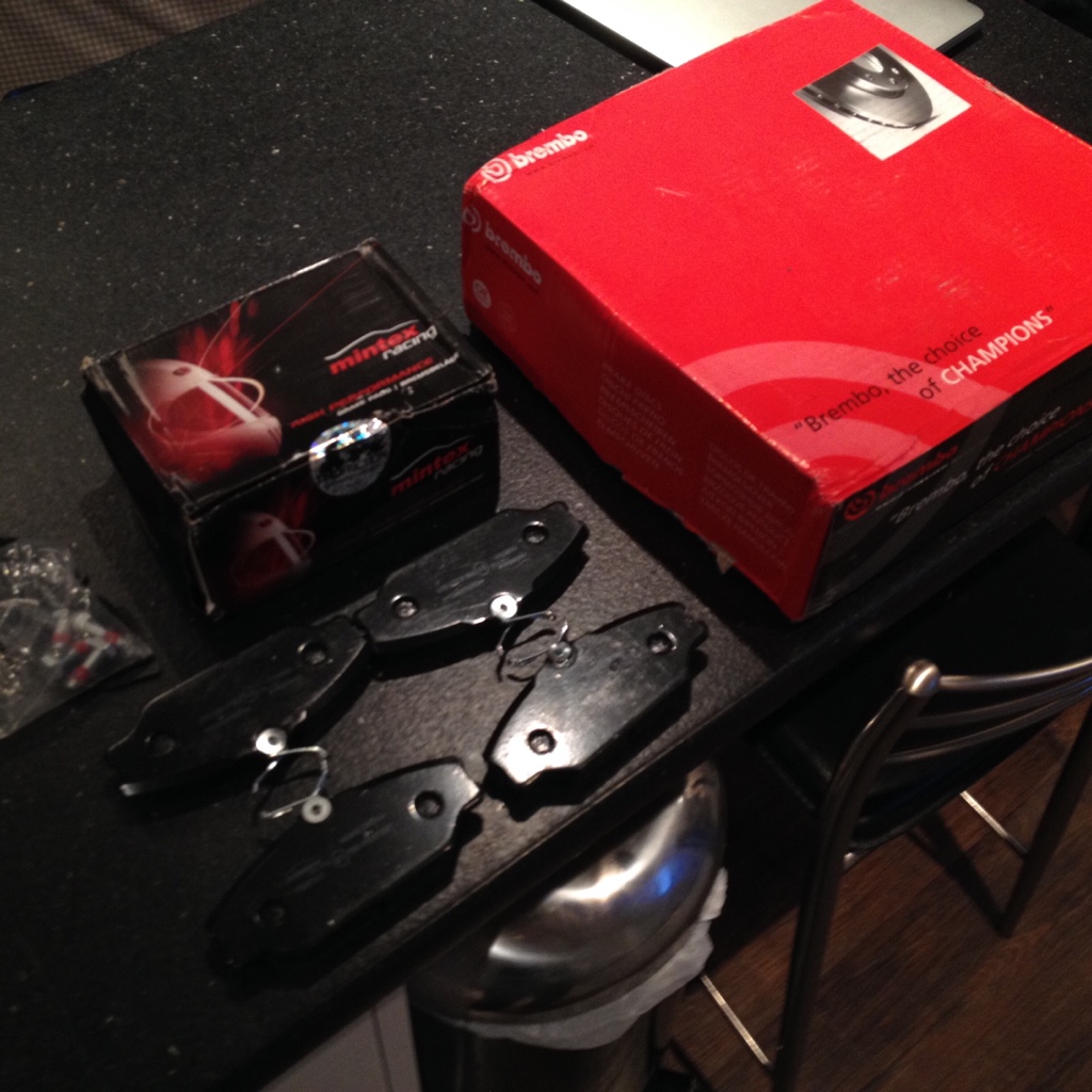

when i got back after checking the pads were looking a bit low i decided to order some new brembo high carbon discs and Mintex M1144 race pads.. (Thought I'd give them a go before maybe changing to the DS2500 as i know they are well rated on here)
im definitely going to be doing a few more track days in it and might be going to the ring very shortly so some new suspension bits were ordered on top of the bits i needed to fix the car.. New tie rods, boots, wishbones and balljoints should hopefully firm up the steering.. Think with the B14's, solid top mounts etc most of it will be brand new under there.. i plan on getting it set up/corner weighted by Total Control Racing at some stage soon after this has been done as they did a fantastic job of my last 182 and that made a massive difference to the handling.

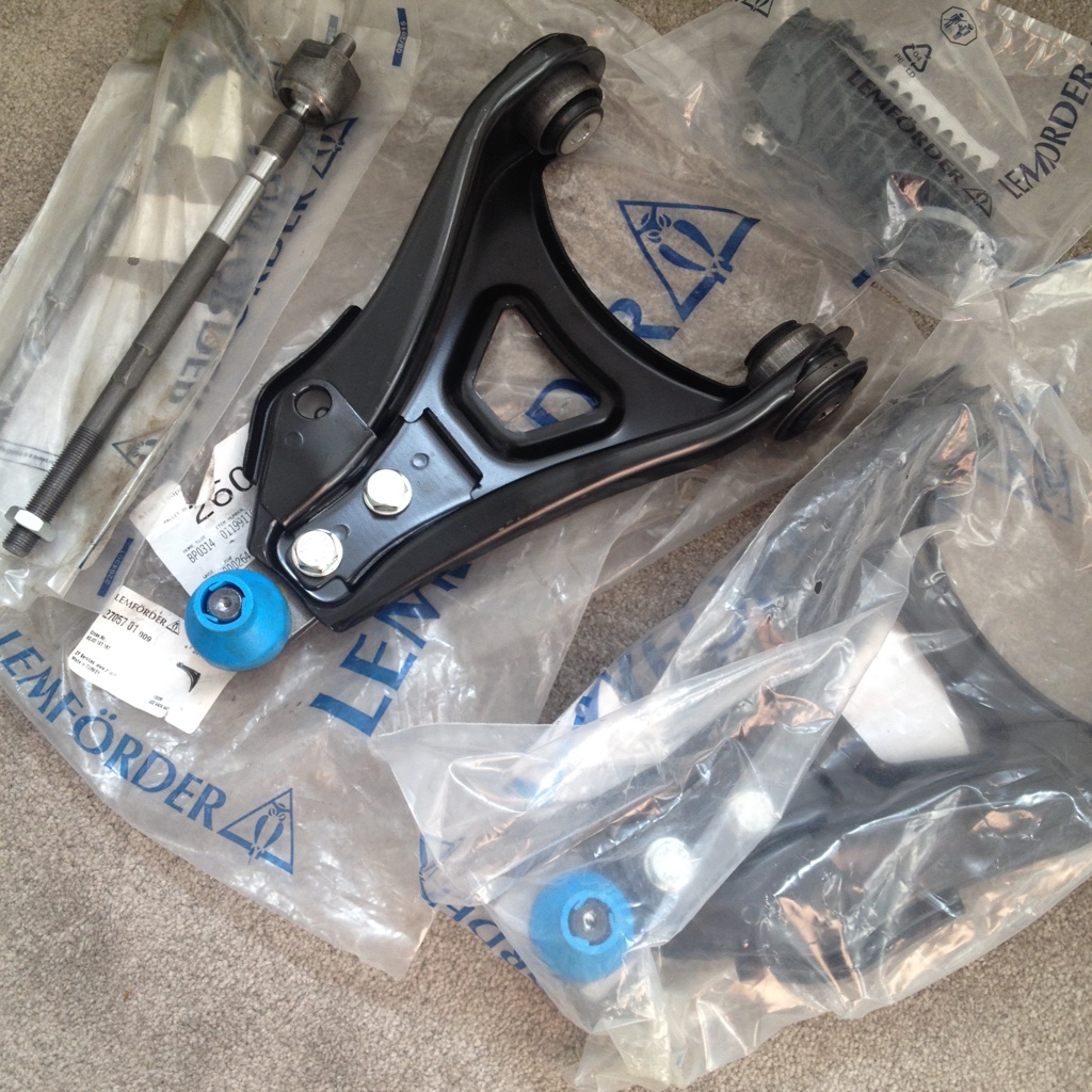

after alot of research i decided to go for all lemforder items as some people have said they are better quality than some of the OEM items for less money.. so il let you know how they go!
Going to start pulling it apart tomorrow and see...

update on the Lemforder parts... well they didnt fit.. the tie rods were too short and the wishbones were wrong! didnt have the ARB fixing points on!
so looks like OEM renault! still will be miles better when fitted and then I can get it down to Total Control Racing for corner weighting :D made such a massive difference..

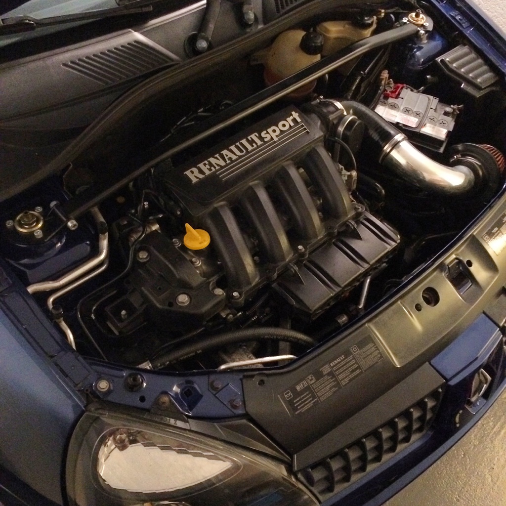

Ktec style induction kit
matched inlets
Belts/dephaser pulley changed
RS Tuner remap

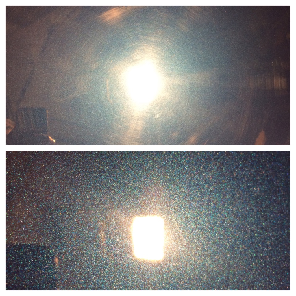

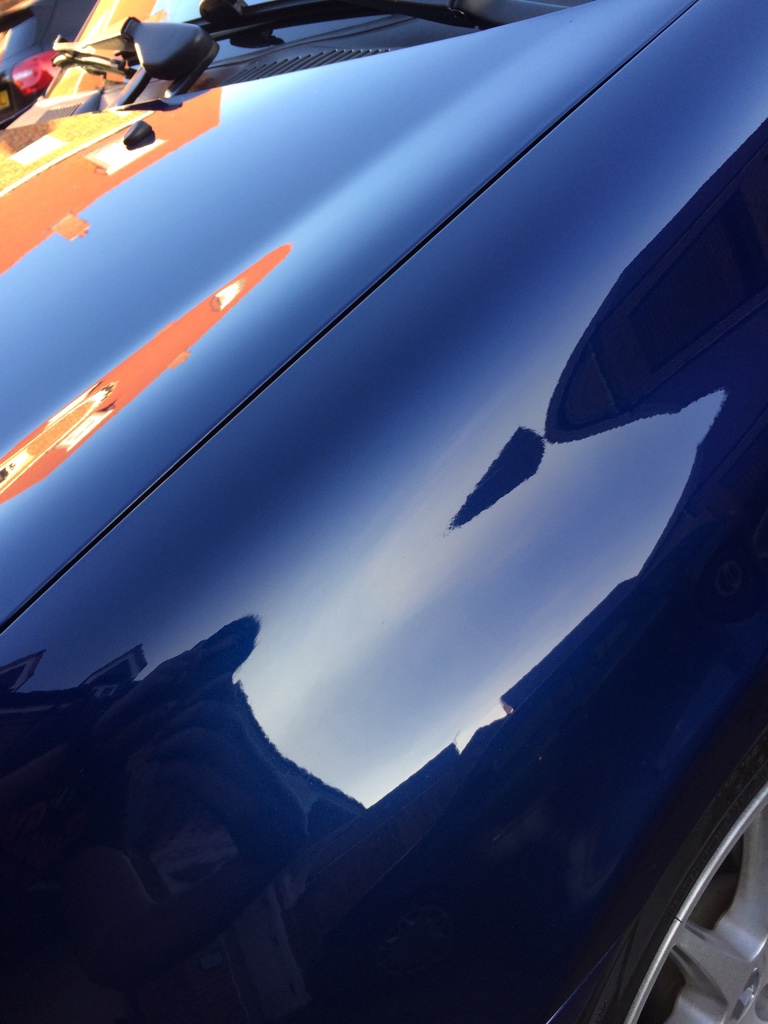

Full paint correction and detail

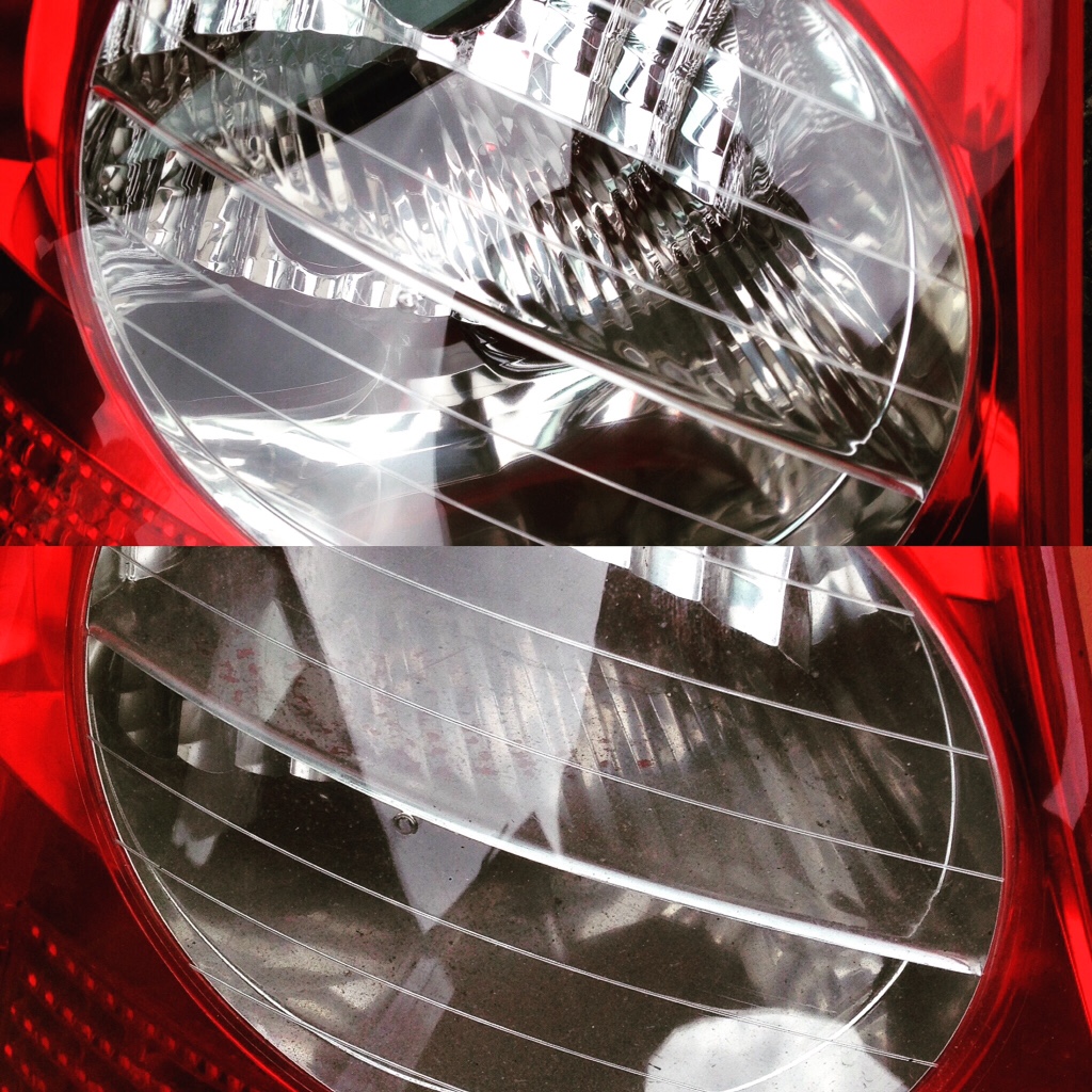

Headlights cleaned up

Anyways here is a couple of pics of the new lights

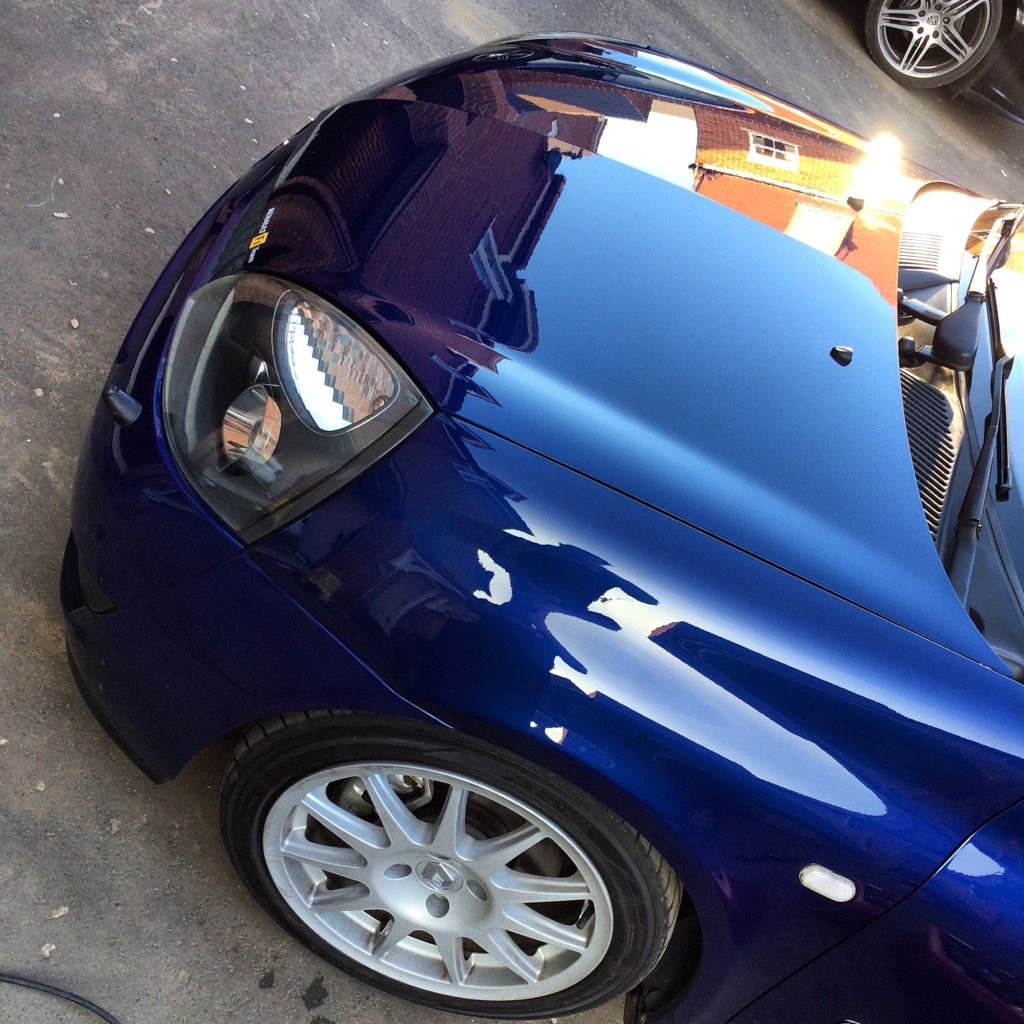

Still.. looking back through my camera roll I can see I gave it a good clean with the new lights in [emoji23]
Love Monaco in the sun! [emoji16] miss this weather!! Hopefully we will start getting the sun back soon

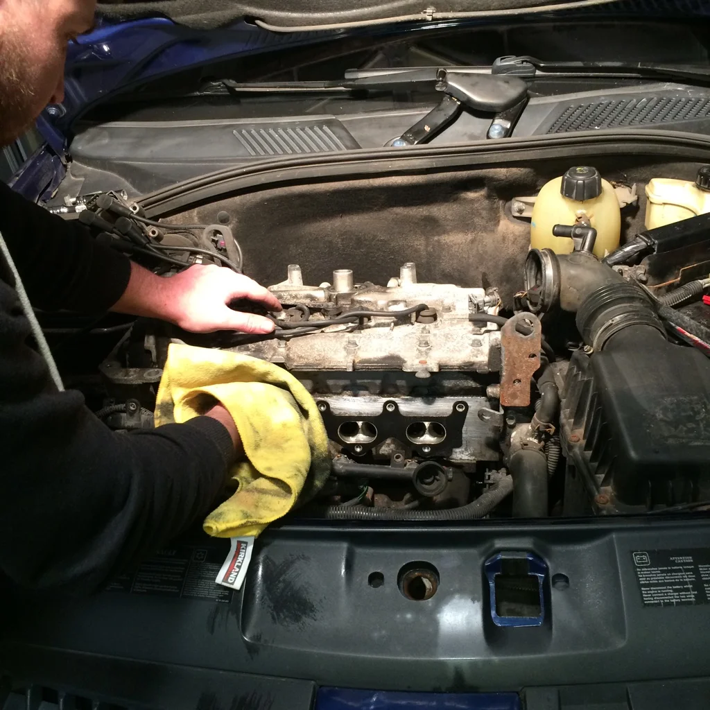

So after Christmas the MOT was due.. initially it failed on a torn steering rack boot
Plus had some advisories.. that the rear brakes were sticking
I'm told this is common in the cold weather but I decided to do a brake service, and free everything up a bit..
However..
When I took the rear discs off the near side wheel bearing fell apart despite only being sub 10k old! (Yes correct spacers etc were installed, think I just got a sh*t one!)
Unfortunately they were 13 months old and not covered under warranty [emoji22]
So new discs o'clock too.. great [emoji1303]

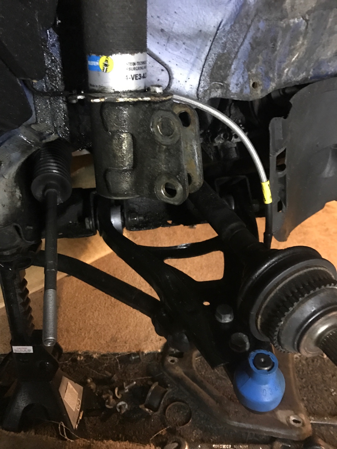

Whilst I was at Renault I asked for a quote on something I've been wanting to do for some time..
Full front end refresh to compliment the B14s, pure top mounts + brace and uprated engine mount and dogbone
Being as I needed to order a new steering rack boot and inner rods come with them it's how I justified it (in my head it works..[emoji848])
They (b*stards) managed to do me a very good price indeed and further convince me that spending circa £300 right after Christmas was a totally great idea

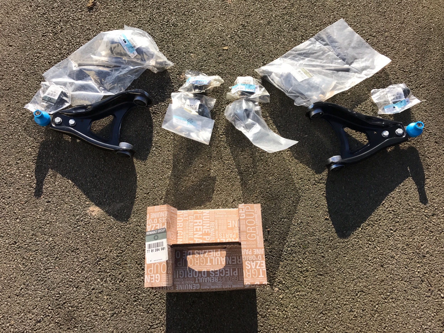

So I left with
2x Wishbones
2x balljoints
2x inner track rods
2x track rod ends
2x steering rack bushes
2x inner anti roll bar bushes
2x outer anti roll bar bushes
And a new hole in my underwear..

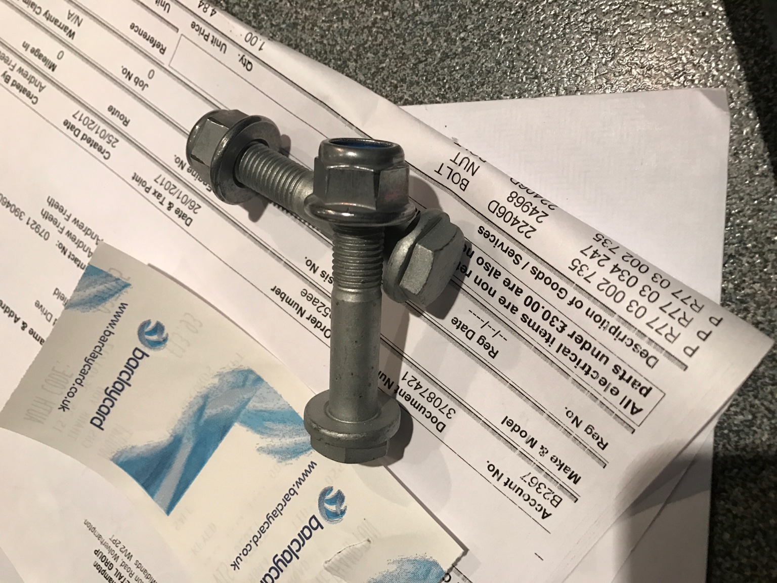

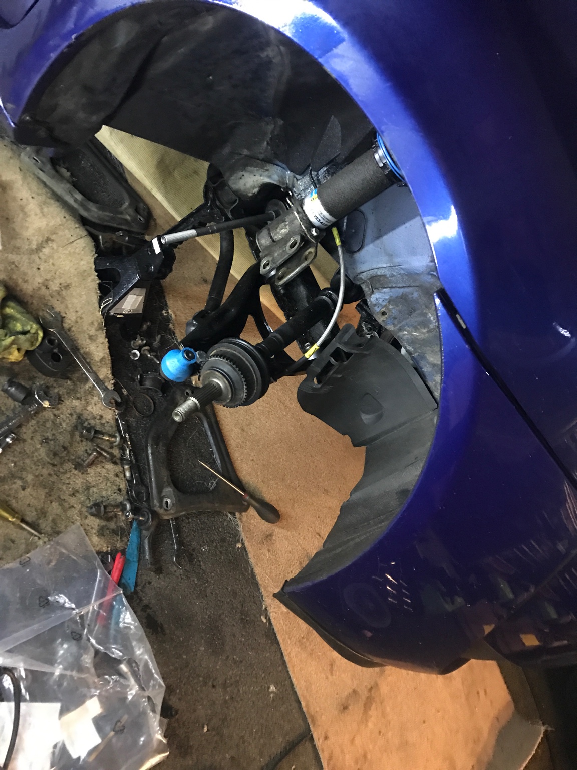

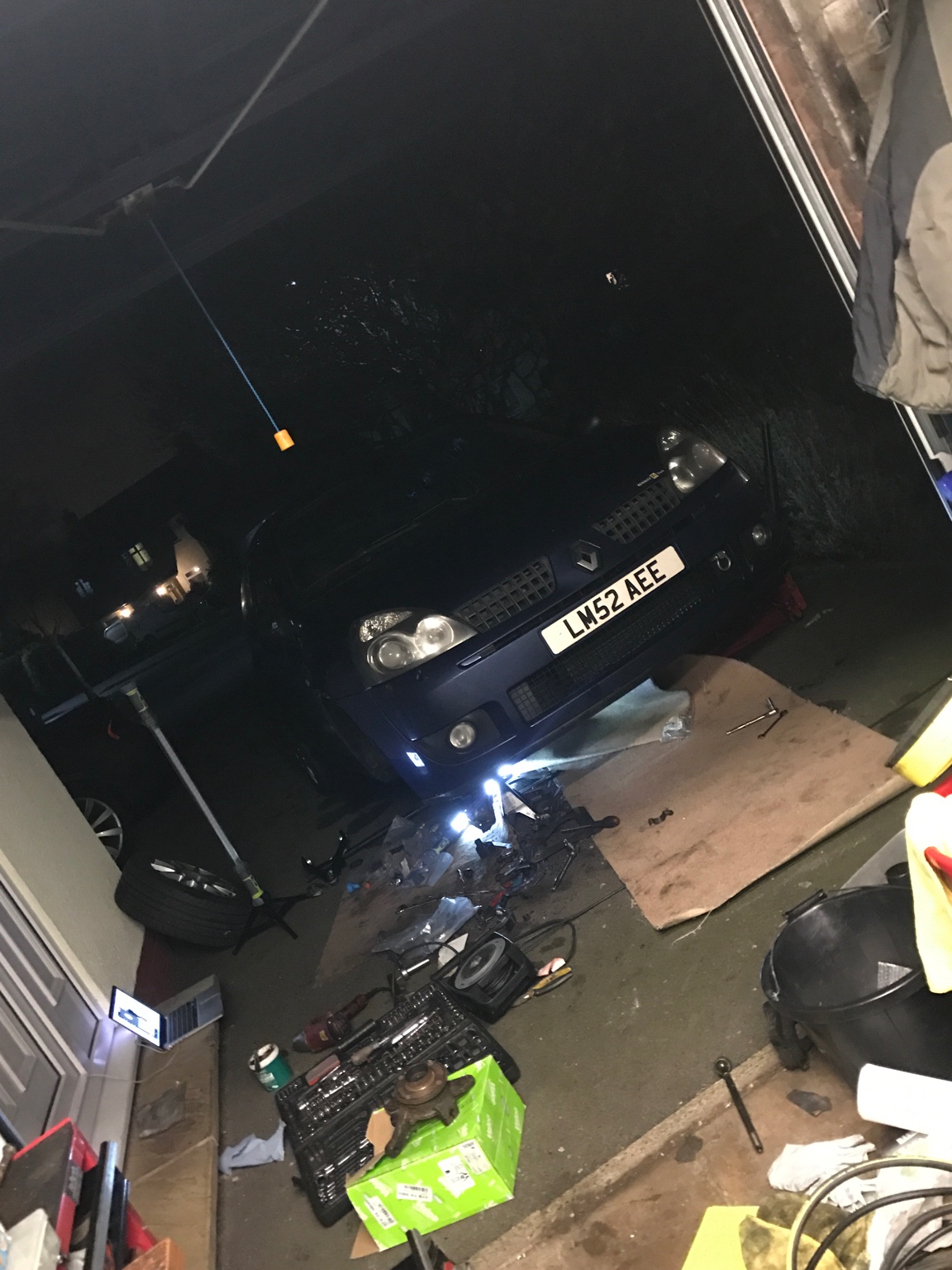

And then I returned for more "lovin'" in the form of two lower pinch bolts + nuts

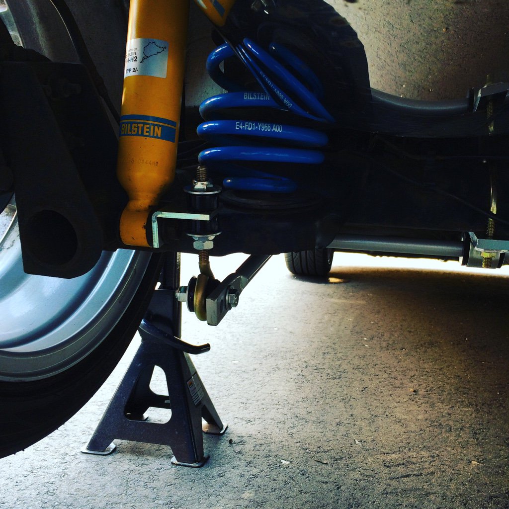

Due to the fact I was replacing all this I decided to invest in some eibach camber bolts because at this stage I was in full f**k it mode..
To be honest it made sense so I could get it set up perfectly after all this work was carried out
Collected them from Kam Racing who were very helpful

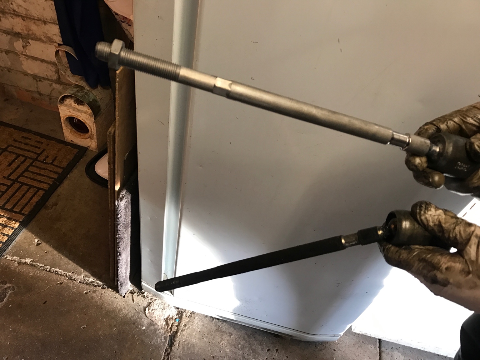

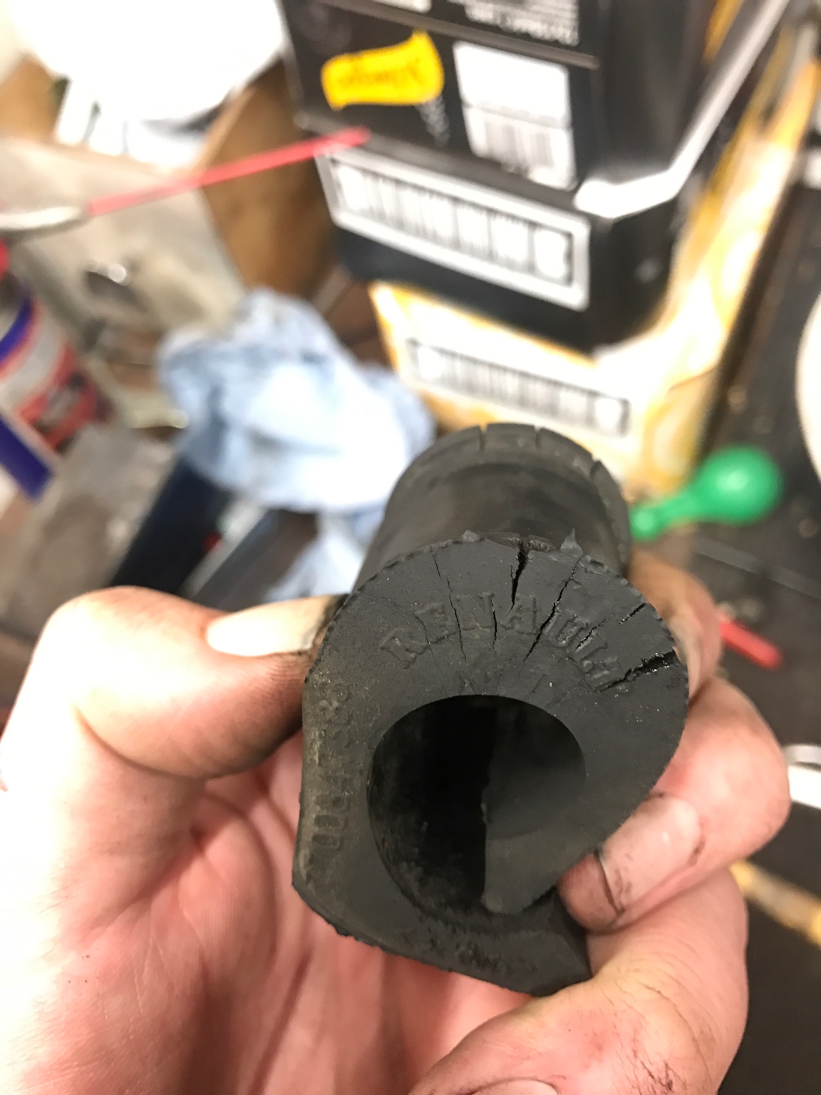

A lot of the parts that were replaced were tired and I'm glad I did this! Inner rods..
Yeah... kinda goosed..
There was absolutely no resistance in either of them, unsurprising really..

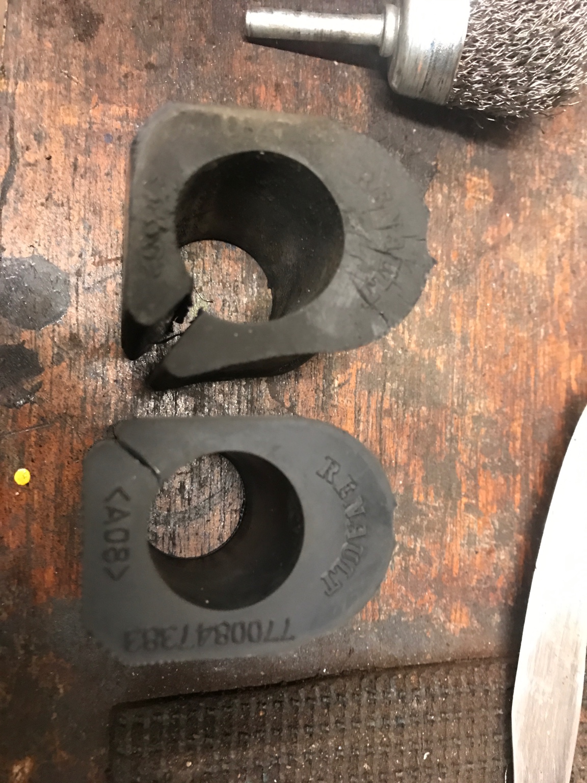

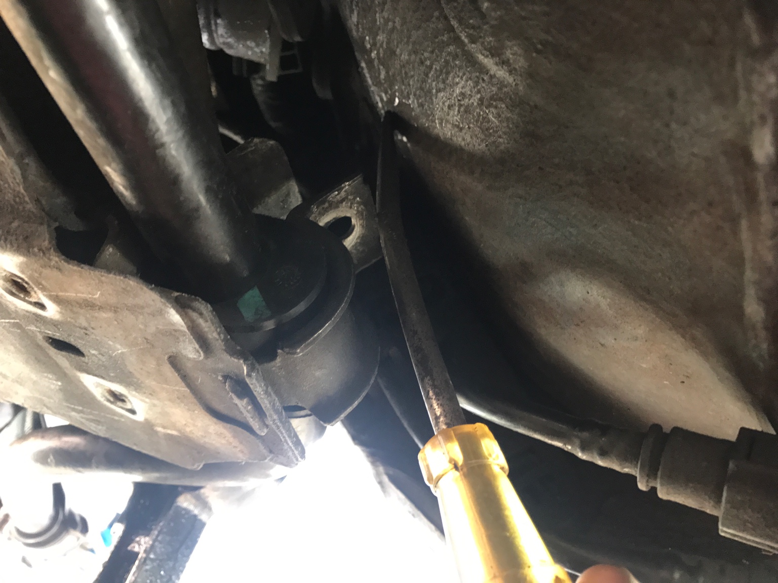

Old vs new inner ARB bushes

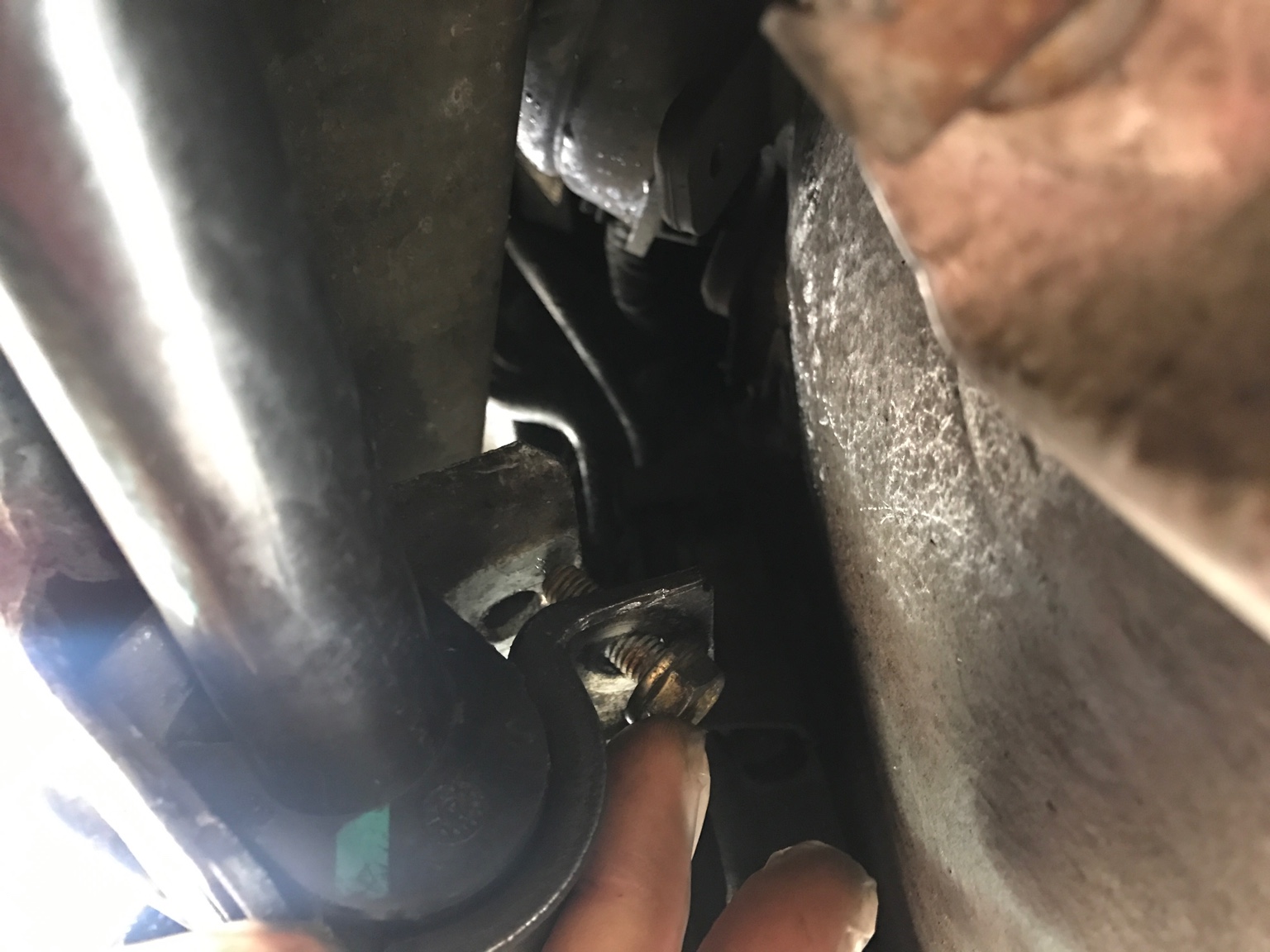

These were a bit of a pain in the ass but with some careful modification (bending) of a large screwdriver I managed to pry the clamps down on the new items
Using the clamp as a pivot against the bulkhead you can just about get enough purchase on them
Bolt in and heaaave!
Just enough to get a nut on the back and pull them tight!

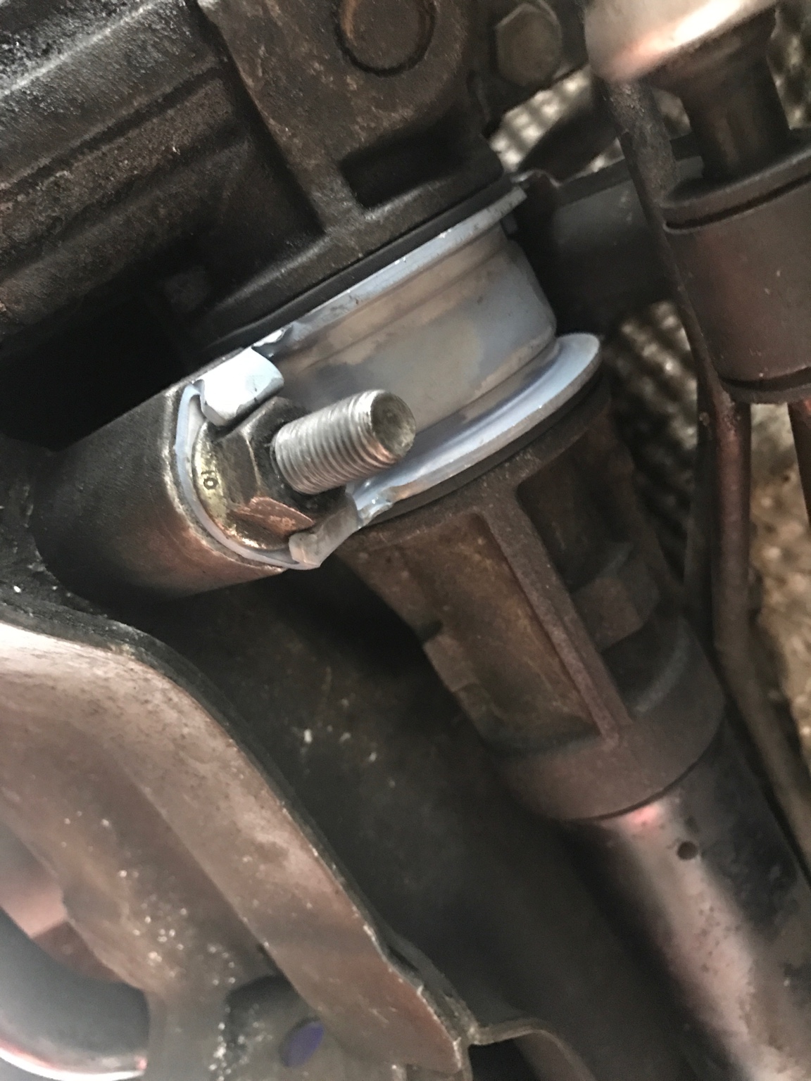

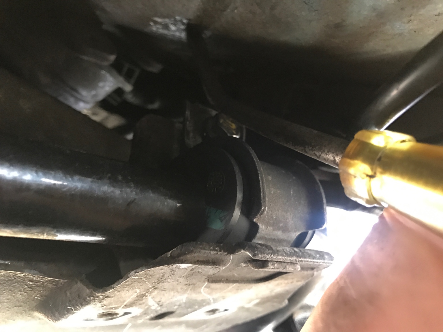

Steering rack bushes were next.. again.. fiddly.. frustrating..
but not tooooo bad
Took best part of two days messing around with all the fiddly little bits and doing it at the end of January probably wasn't the best call.. but hey oh!
It's dark and I seem to be missing a circular rubbery bit!
Fitted my goodridge braided lines too whilst I was there which are a nice addition to the mintex 1155's and brembo HC discs

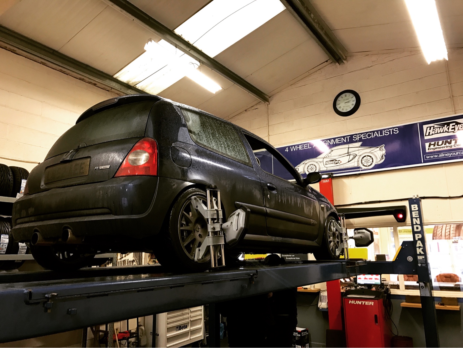

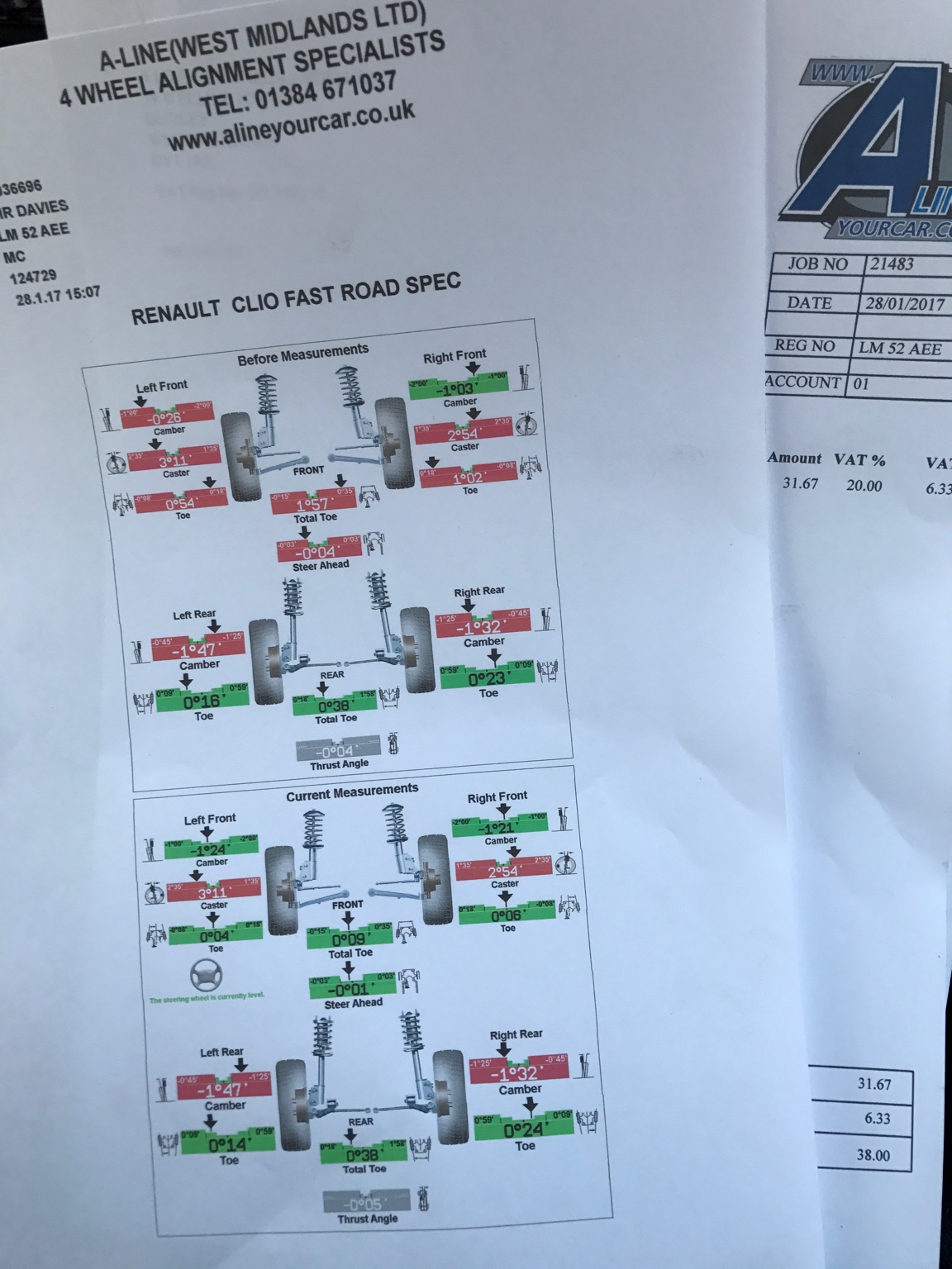

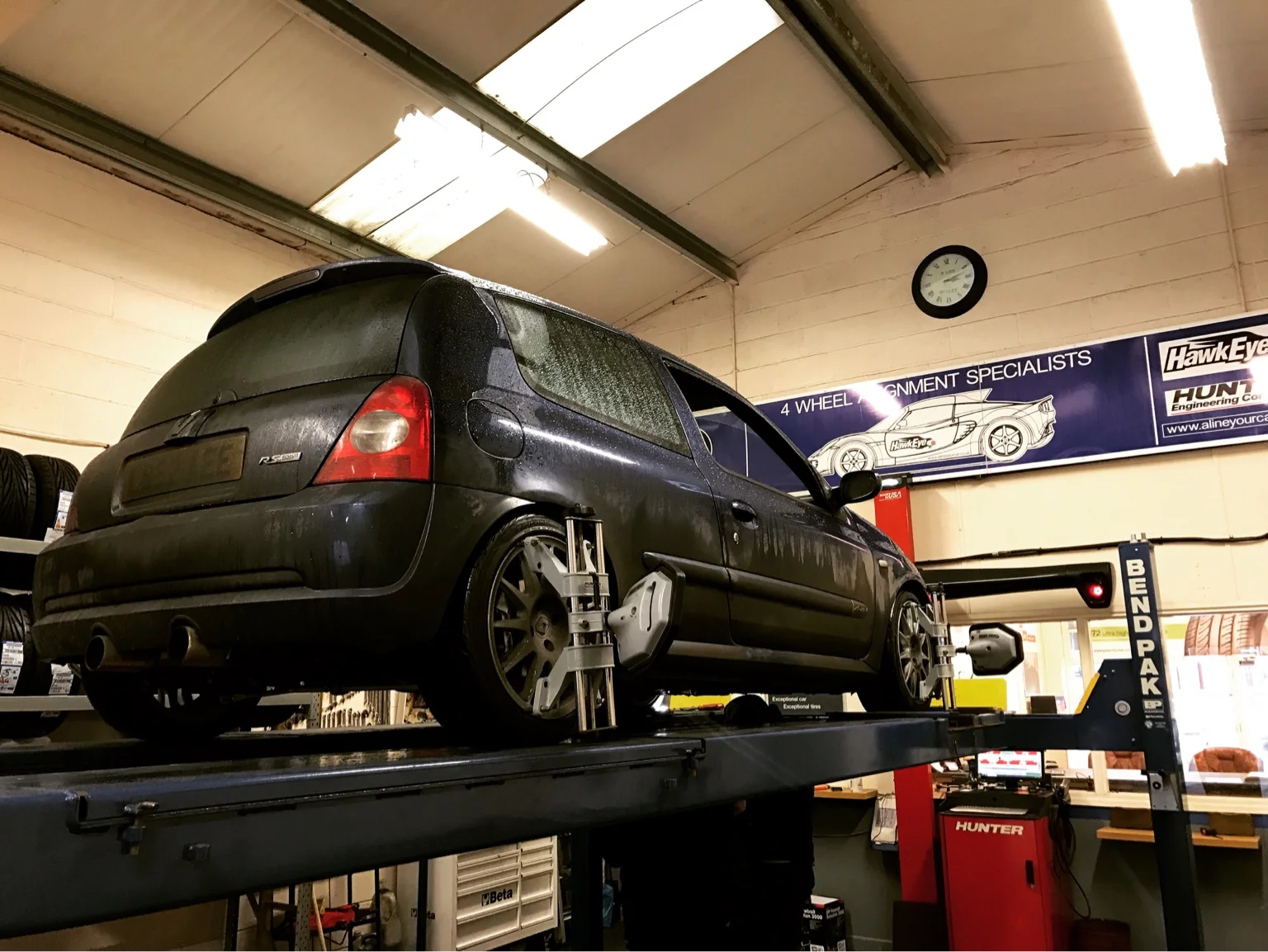

Off to A-Line the following day to get it all set up (I know it's filthy [emoji23][emoji22] I'm waiting for a weekend to spend a good few days deep cleaning it, wheels off, suspension arches etc and underside clean too)
Very reasonably priced £38.00 and set up with an 'even' fast road spec
Very happy with the way the car drives now, turns in beautifully and feels so much tighter!
Completely got rid of the vague steering I was living with before, none of the parts that came off were alarmingly bad or broken but they all showed signs of tiredness
In fairness it is a 52 plate French car with 124k on the clock!!!! [emoji23]
I think I've made a lot of excuses for this car in the 'driving feel' department since I expected it to be a lot more sloppy compared to my last 182 which was caged, cammed and generally a lot more modified
Turns out I think that this was exactly what it's needed! Really has 'sharpened' everything
Cannot wait to get it on the track again in the summer and really push it and see the difference but even driving on the road now the car feels way more planted and sure footed
Would recommend.. il be giving Renault auto world Willenhall a 5* on trip advisor [emoji23][emoji23]
