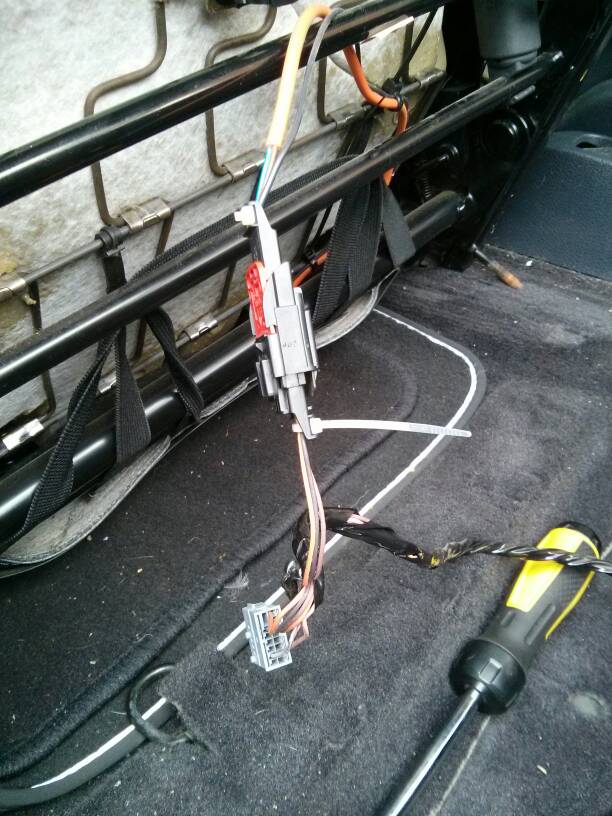

Removing seat airbag connector
  mk1 Octavia VRS
Does anyone have any tips for undoing it? Cheers!
  mk1 Octavia VRS
I wish it was that simple, is it supposed to just pull out then? It has a red clip thing on it but no matter what I tried it wouldn't budge.
  clio dci , ren8
You don't touch the red tab , there is a small black plastic tab stuck up on the black part push it and pull apart
