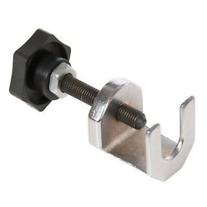

Their is tools specifically designed for removing the wiper arms as without them their a right pain. The tool is basically just a puller that pushes on the bolt and pulls the arm.
Years of doing it without the tool, until recently when I bought the tool, So bloody easy!

Buy the tool. It's less than a tenner. I've used mine at least a dozen times since buying it a couple of years ago.

By the tool. I almost smashed my windscreen in when getting mine off, such a fkn pain. I used a bearing puller I had at work, but the right tool makes it much easier.

That's the tool Tony.
Found that the little point on it broke off but it still functions fine. Has to be wound quite fight and then helped a little.

Or any ball joint puller like that one does it. Time and effort saved through using this is unbelievable!!
