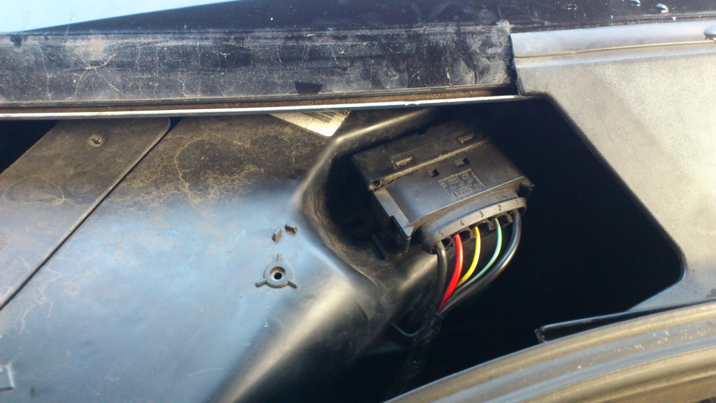

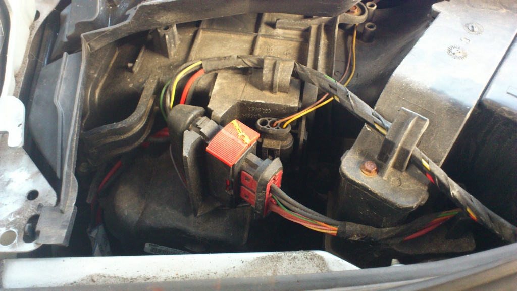

Argh, this has got the best of me, sent the resistor off to get refurbished, arrived today, fitted it and there's still no fans in the car??
Anyone got an idea what else could be wrong?? Was really hoping thats all it was....

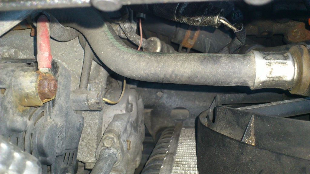

When im in the car, if i turn the AC button on and off, there's a loud clicking comes from the engine bay, thought it was coming from the Air Con area, but its more like the engine???
Resistor thats been refurbed
Unknown part?
Area that seems to be clicking

The clicking is probably the Clutch mech on the aircon pump engaging
