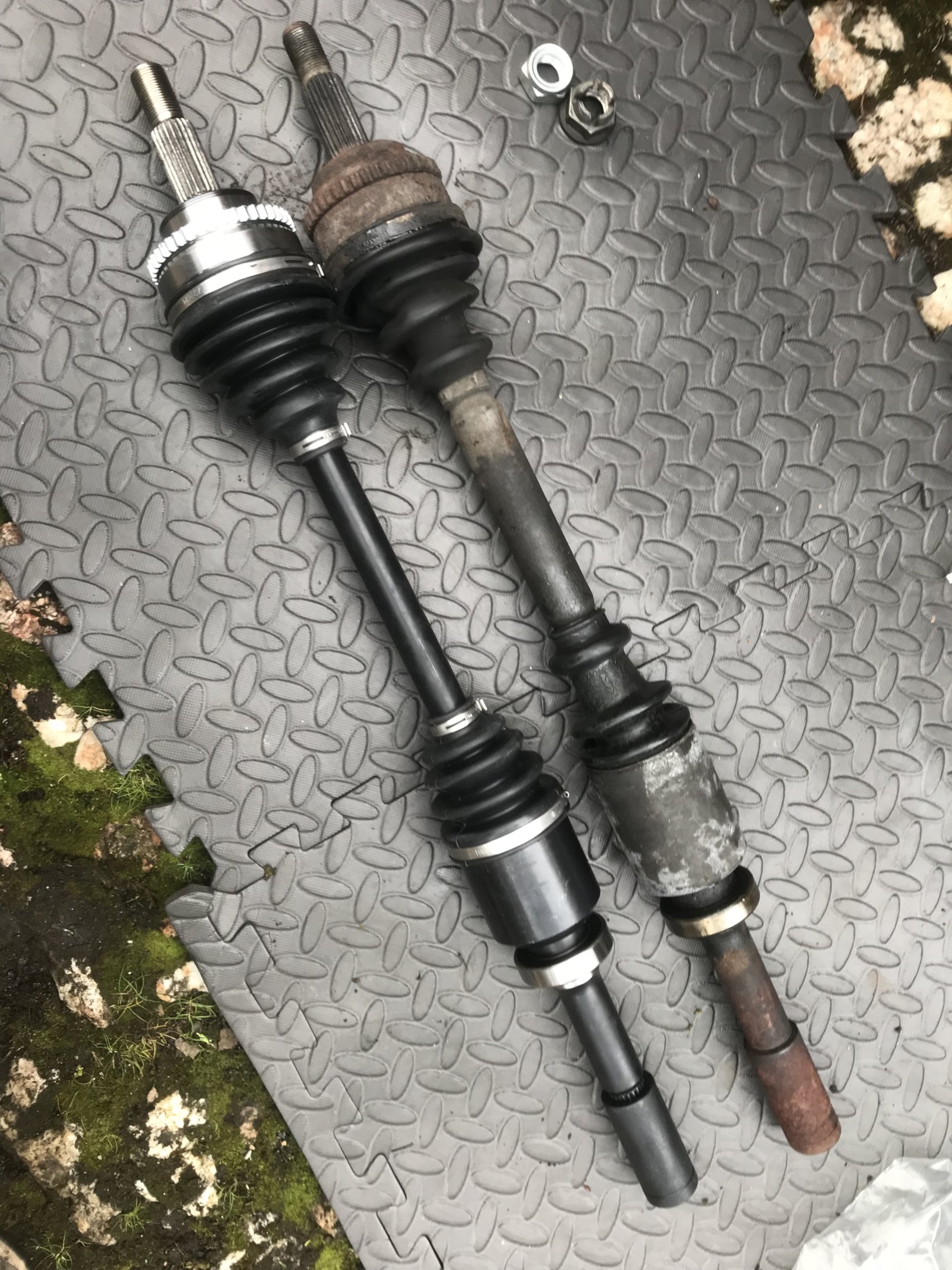

Could I ask a couple of questions before refitting my o/s J&R driveshaft?
Firstly, do they look similar enough :grimacing:?

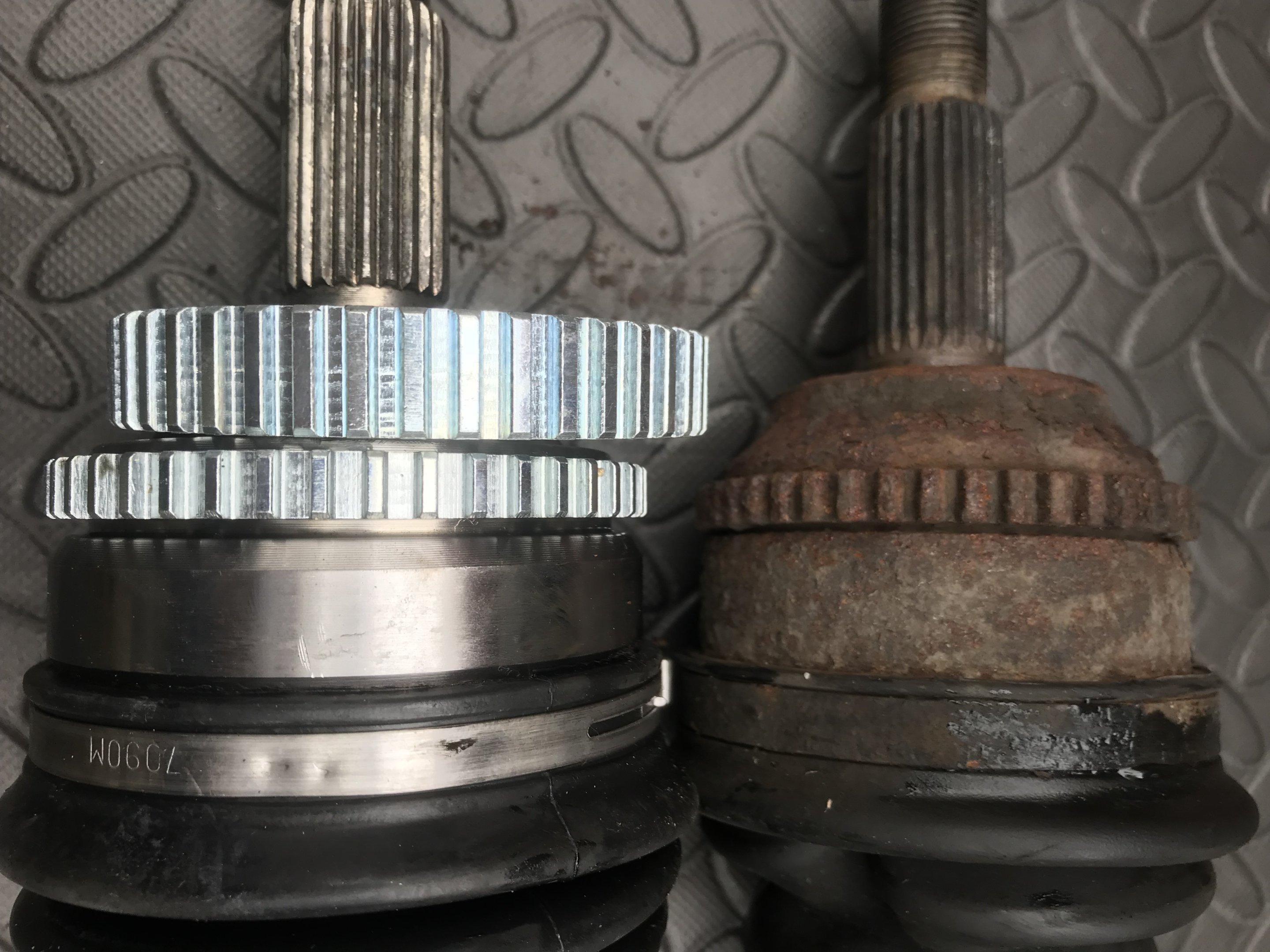

It comes with 2 ABS rings, but they seem to have the same number of teeth, does it matter which I use? The wider one in the picture seems to have smaller gaps between the teeth and looks similar to the original, but I fear the extra width might be a problem with fouling when refitted. Any ideas?

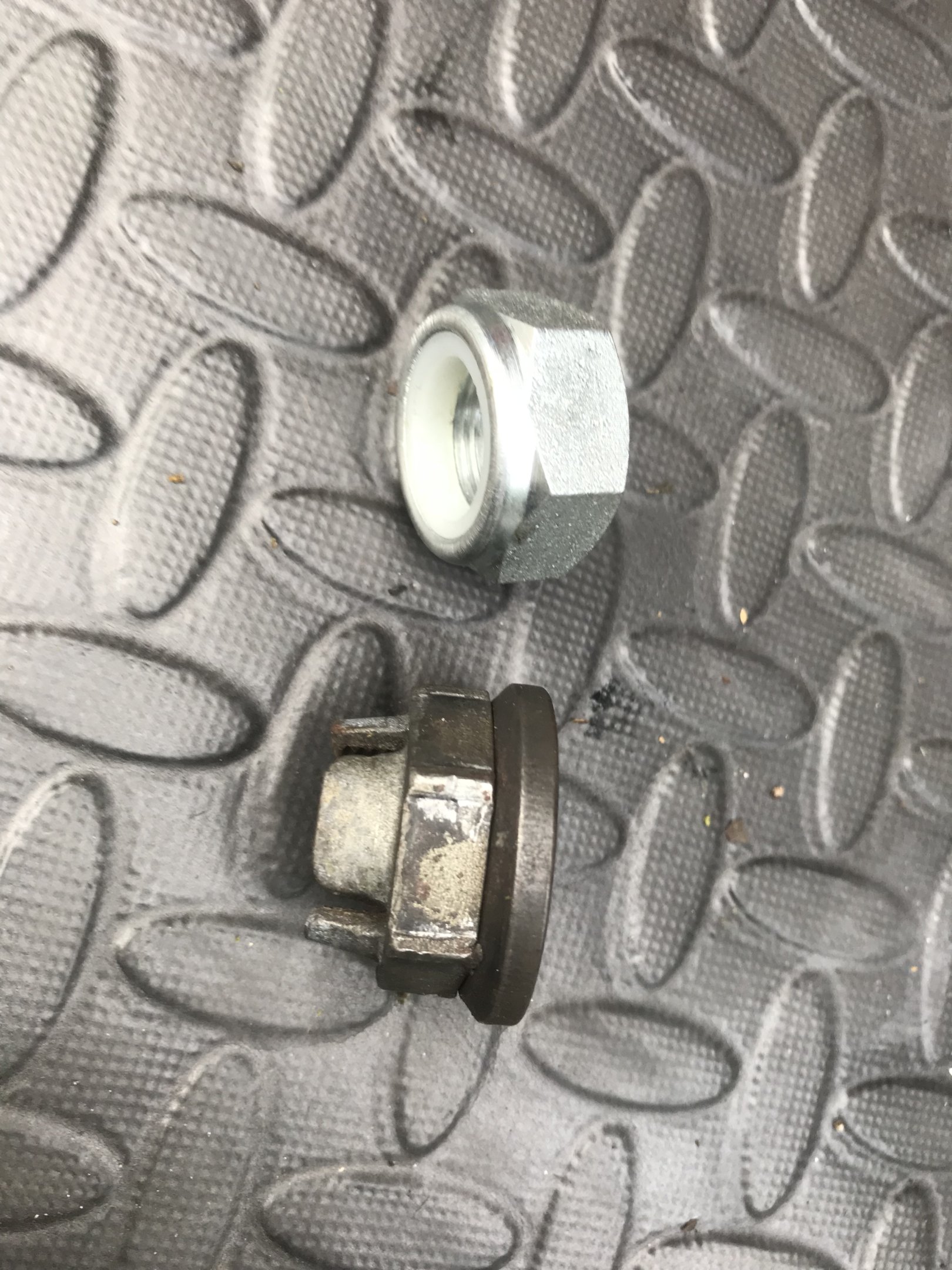

And should I use the old or new hubnut. It’s just the original has a nice collar/washer which the nut spins around, and it’s seems more substantial than the new one? Again, any advice will be greatly appreciated :up:.

They look/are the same. I would use the smaller one as it is the same as the original. I would probably use the old nut if I were doing it, although shiny is shiny so no harm using the new. Have no idea about the o-ring but if it fits then why not :up:

The wider abs ring is for cup and 182 cup pack.
New nut should be fine, but you could use the old one if not too battered.

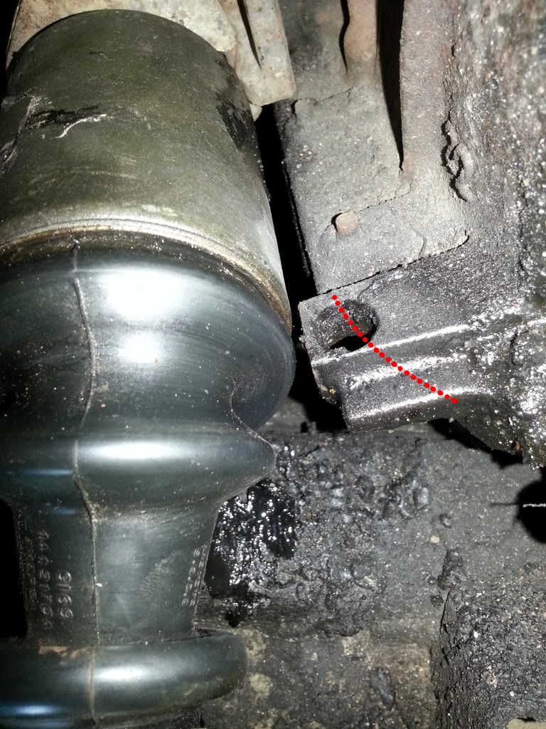

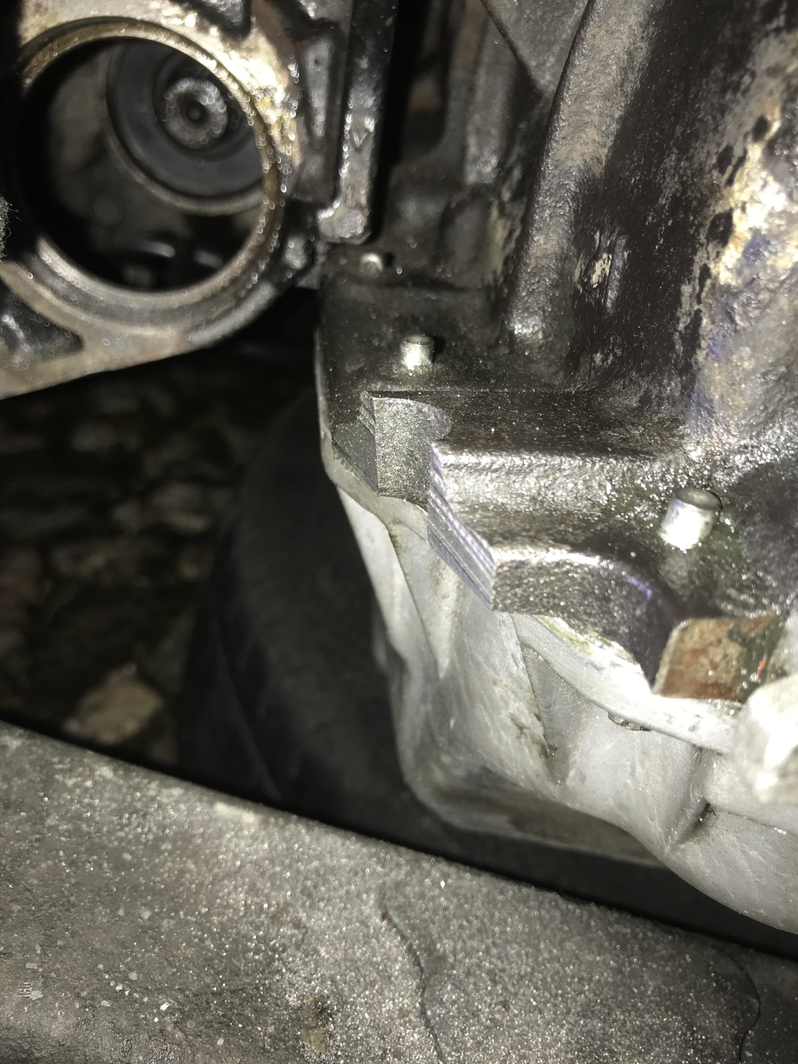

Modifying the back of the engine block to stop the inner boot fouling is a good idea with J&R rh shaft.

Yup, just trial fitted the shaft and it does foul.
Will a reciprocating saw do the job or will I need an angle grinder do you think?
Not having a saw to hand, I`d use the angle grinder that I have, but it`s up to you.

I figured the saw would give me better access. And I scare myself using an angle grinder :grinning:.
