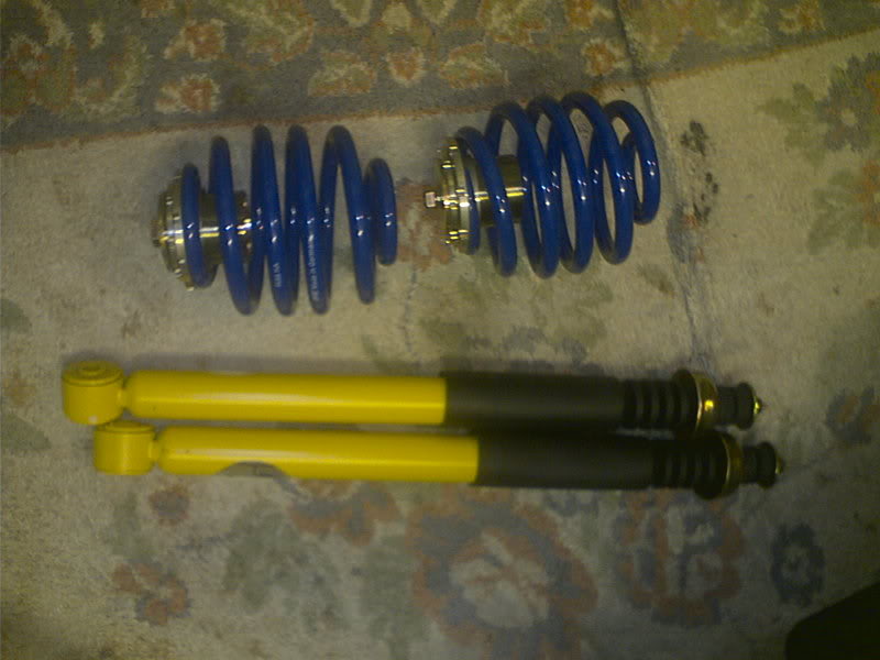

I've been told the knocking I get at the back could be from my springs touching as they compress, I have FK Highsport coilovers at the moment and have been looking for a type of spring cover to go around the coil at the back so hopefully stop the knocking.
Anyone know where I could get one from or what they are actually called?

The spring covers i've been told about I would presume would be rubber and would sit on each coil so that when they knock together they don't make a metalic noise i'm getting... This is how desperate im getting now to find out what it is!

If the ones your thinking of are the ones that go around the coils (like on the front) I mean a different sort where they go ontop of the all the coils on the back (as it's just a spring) It's abit like a rubber tube cut in half and then put over the entire coil from top to bottom.

The springs would be very soft it they are compressing that much, esp when you have less weight over rear. What lb are they?
I'm not entirely sure mate, they are the FK highsport ones (blue coated)

No, it's a metallic rattle. Asif th seat belt bolts are loose, but when you sit in the back and hold the tops of the damper, you can feel it.
I've taken the dampers off, swapped them back to standards and it still does it. Highered it, took the drums off (when you apply the handbrake, it goes away) and nothing is out of place. Stumped.

so far we have looked at:
Drums
Swapped dampers for standards
changed exhuast mounts (Backbox and 2 Centre Section)
Handbrake cable
we highered springs at the back by 10/15mm
Had the boot open
Nothing seemed to stop it apart from having the handbrake up abit, but I said to Dave after we tried it, maybe it's stopping it because the rear of the car wasn't moving as fast down to the floor when we went over the speedbumps as the handbrake was slowing down the back wheels.
