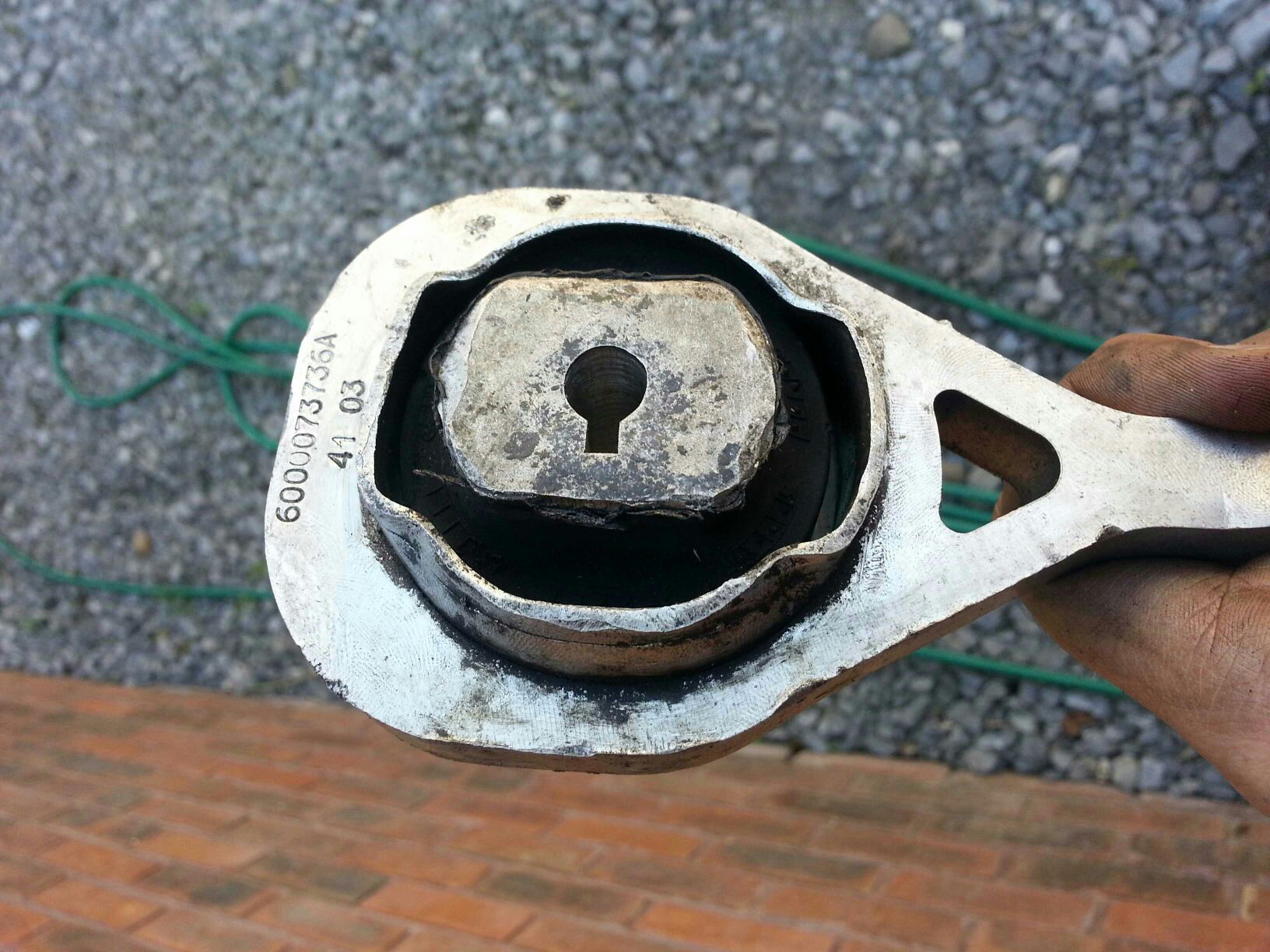

Hi, anyone have any tips for removing the original metal and rubber Bush from a dogbone from a 172 cup?
Hammer doesn't seem to budge it. Pretty limited on the tool front too.
Thanks
Ol’ Tarby
  Clio 220 Trophy
Use a drill to make a load of holes in the rubber bush, and keep hitting with a hammer. It will come out after a few decent wacks
  Suzuki Swift Sport
Brilliant worked a treat. Thanks for that.

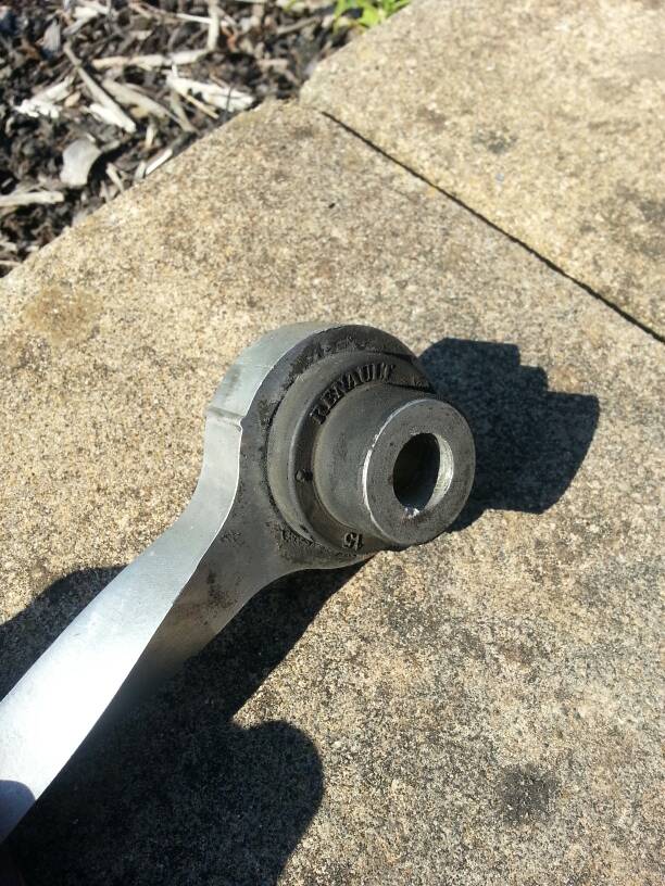

Any easy method for the gearbox end?
Does it split?
Ol’ Tarby
  Clio 220 Trophy
I think I just opened up a vice wide enough to support the frame around the bush, and then just hit it out
  Suzuki Swift Sport
All sorted now thanks for the help. Ended up having to saw some of the rubber as it had seized solid.
