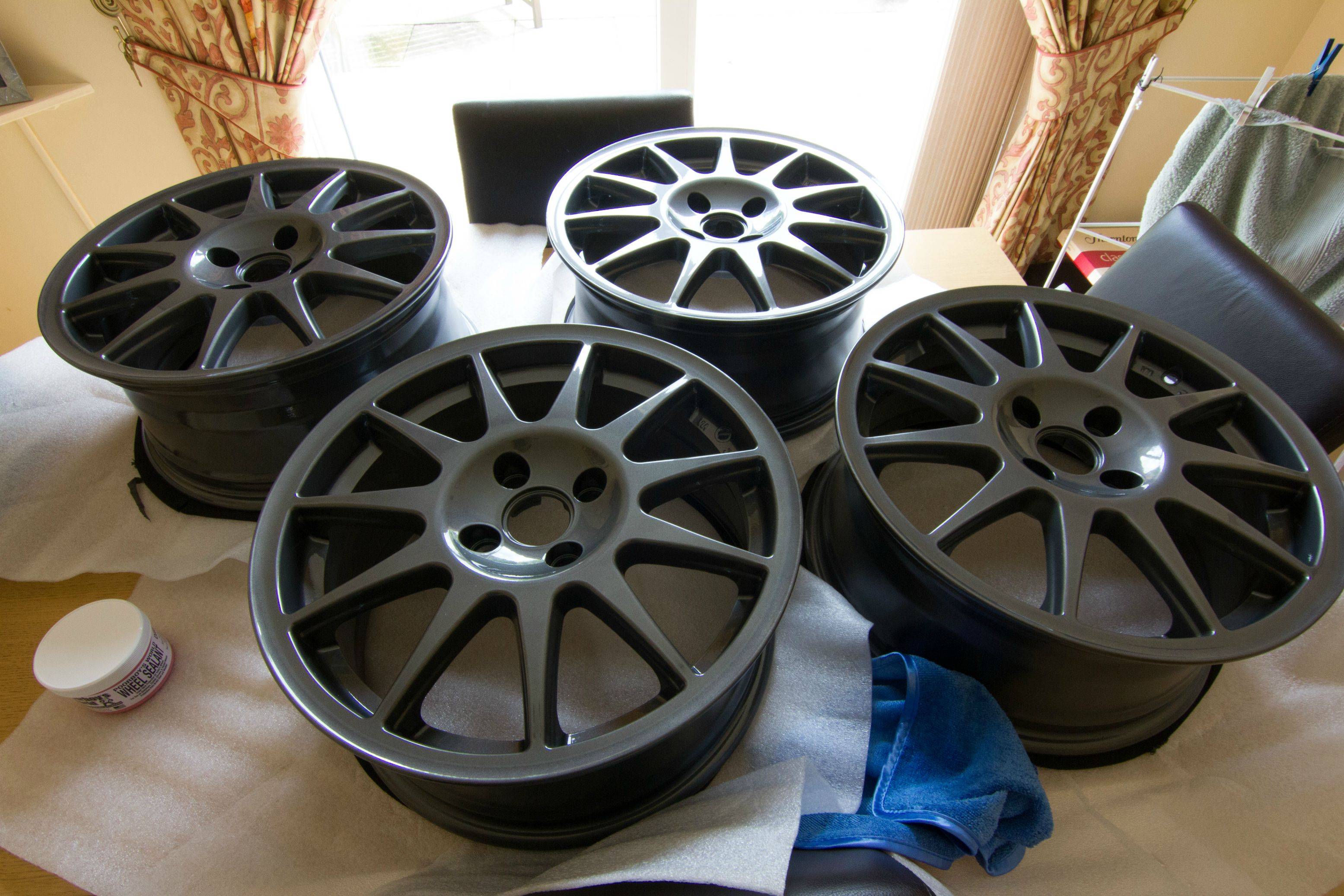

Said wheels:
Call me a sheep, I don't care - they're awesome :p

They are awesome. Of course put some poorboys on them but I would leave them off until I got the right sealant. So much easier to do and they'll be protected for so long!
