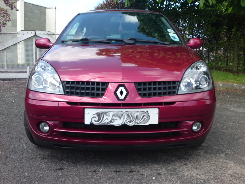

firstly, any help would be appreciated, does anyone know the job involved and even if its possible to put the xenon projector headlamps in to a car with standard headlamps, as i assume the block connectors are different on xenon/non-xenon cars, i arent to bothered about loosing the xenons as i can buy the xenon conversion sets and do it that way, i just want the look of the projectors lamps from the outside.

in a word, yes. i put xenons in my dynamique. just plug and play, same connectors, just the headlamp components themselves which are different
On my Dynamique, my manual adjuster plug wouldn't fit in the auto-adjuster so I just left it out and it's been fine (just can't adjust them!).
you just swap the adjuster motors over, then they work on a nonsport from the adjuster inside the car perfectly fine
