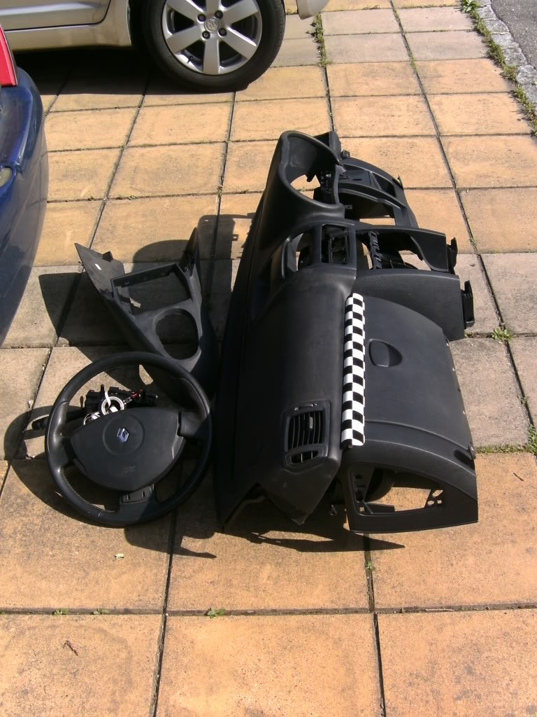

Picked up a ph2 172 dash and steering wheel for £60!

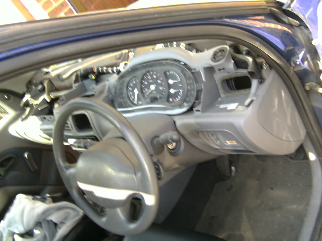

Ripped out my old dash and imediatly run into problems, first problem was that the 172 dash's heating instruments were all electronic, and mine is all cable pulleys, so I got a pully system heater pannel from a dynamic.
I also naively thought that all the buttons would be plug and play, how wrong I was lol, another problem was the sterring wheel storks regarding the wipers, it was a button which alows you to speed up the wipers, which doesn't work on mine lol, did they make a ph2 which didnt have this?
Painted the dash inserts checker style, although I'm not to sure on them myself.
A few bits will need chopping, mainly the center console as it appears the floor pan differs some how!
so at the moment my dash looks like this..

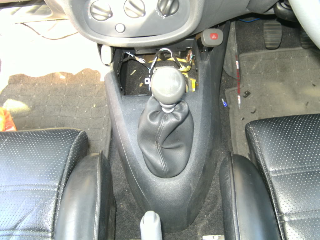

First bit in
when i have the bottom half of the other dash in i can put in the cupholders etc, although I think I may have clearence issuses with the diagnostics port I think it is?
need to also get the gear knob from a Ph2 now that I know they're only glued in, mine comes off in my hand now :(

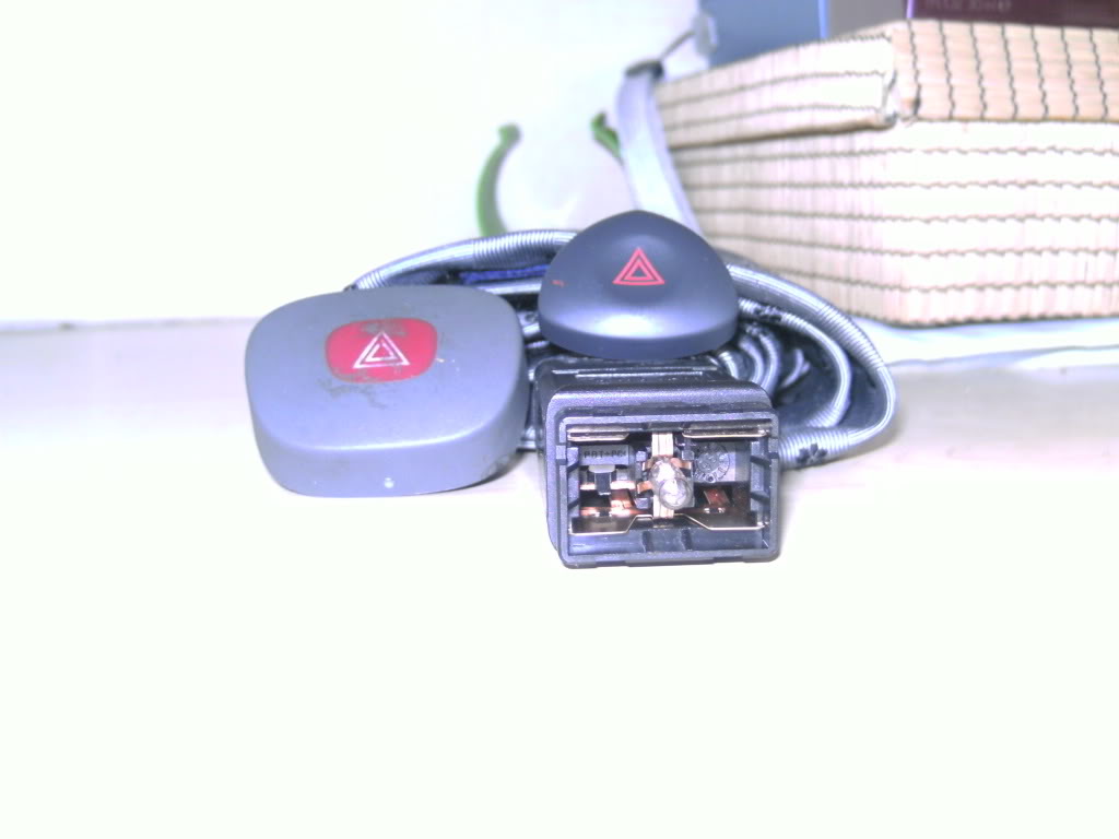

Update! as feared its too hard to attempt to rewire the hazzard switch :(, but can re-wire the door lock button and the rear screen heater button.
so onto the hazzard button, I have to make the back of the original button (on the left) fit the new hazzard button (on top) which is half the sodding size, hmmm wheres my dremel.....
