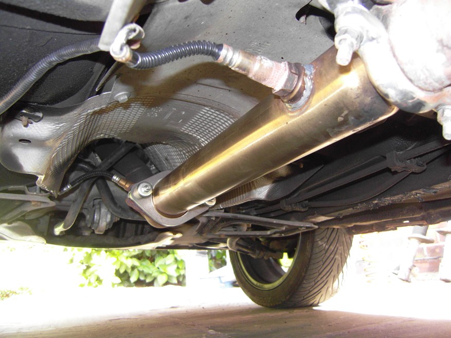

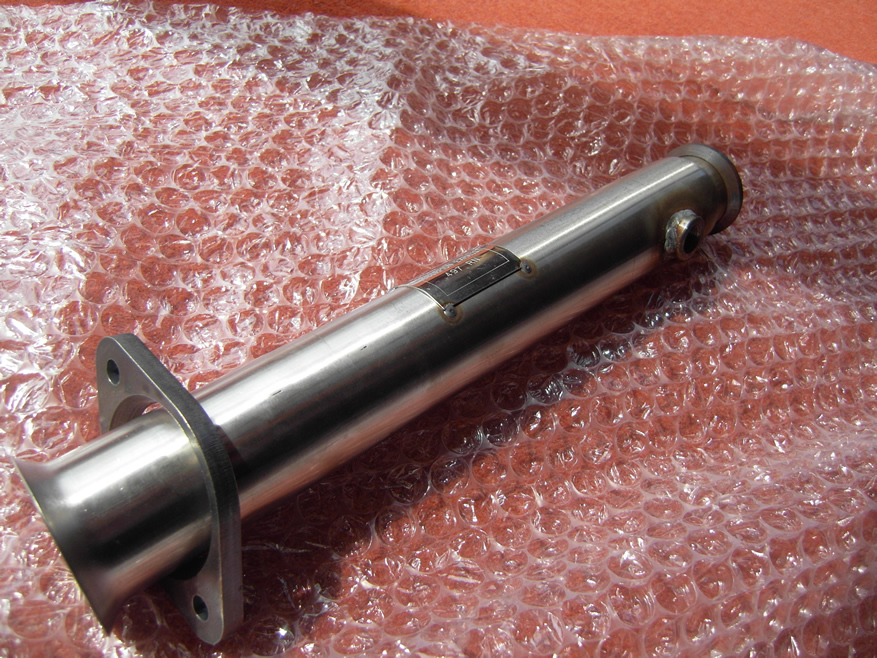

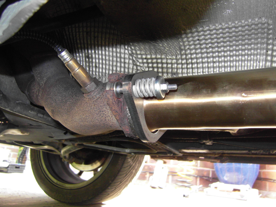

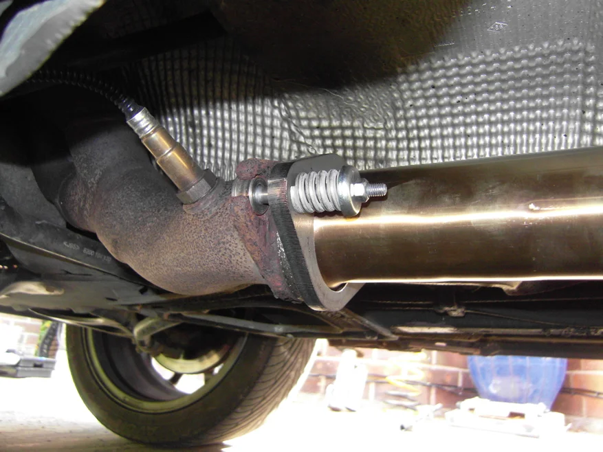

My exhaust has been annoying the hell out of me recently, I couldn't get the clamp in the right place to stop it blowing and suspected it was just down to the flange on the cat being awful. So after a quick think I purchased a Scorpion Decat. My reason I chose this is because I'm going to be buying the RS192 Cat-back system from them in the following months.
After spending a day under the car trying to get the cat out I gave in a declared it as a lost cause as one of the bolts was f**ked. Booked into TopGear Stockport and £20 later my decat was fitted. As the bolts were shot I also bought a new fitting kit direct from Renault. Which includes new spring bolts and a new fire ring.
Looks very tidy and has an great sound to it now. As you may notice the lambda sensor is plugged in, however I have had no emission's light on as of yet.

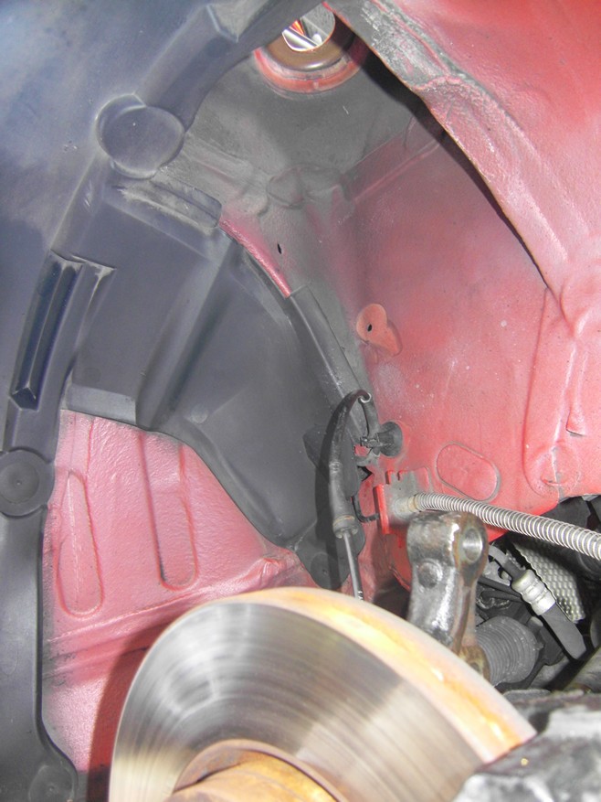

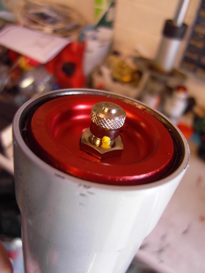

I've now got the dampers booked into BG Motorsport for the 5th August, so I started to make arrangements for some temporary suspension. After a week of asking people and thinking about buying some OE 182 cup dampers, I remembered that Chris had recently put coilovers on his BG 182. After speaking to him I set about borrowing them and getting the dampers changed.

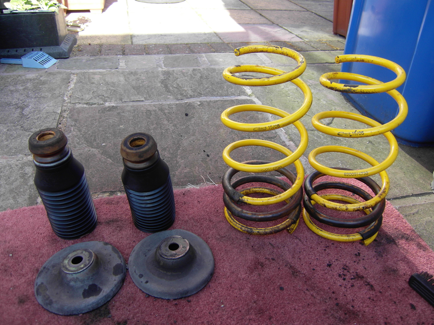

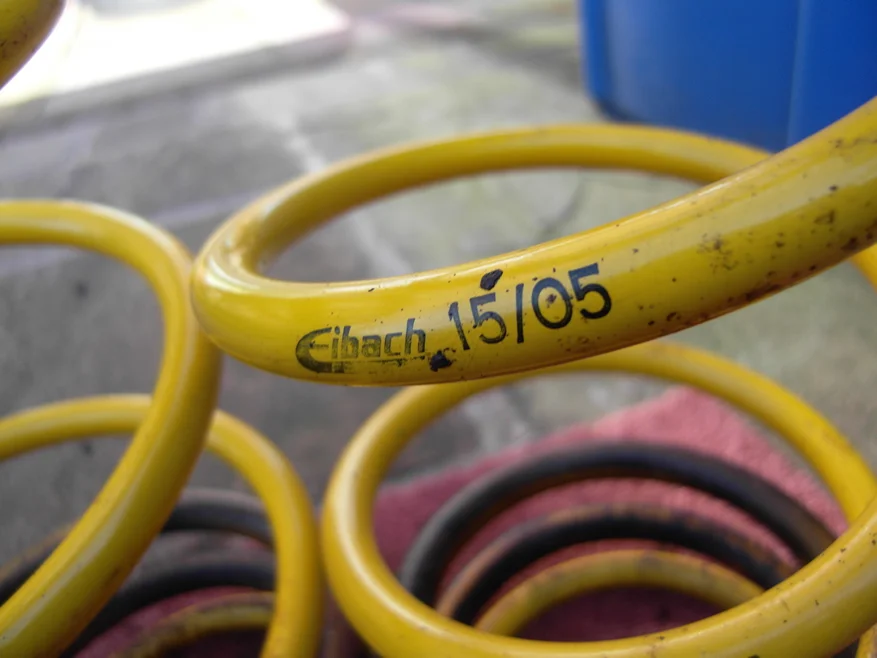

After reading many threads on here about removing the dampers I decided to get some spring compressors just for safe measure. I'd read that a 21mm offset ring spanner would be needed to remove the top mounts, however one side came undone with a breaker bar and 21mm deep socket. On the other hand the passenger side was a completely different story. Socket wouldnt budge it, nor would the 21mm offset spanner and a 6mm allen key. This resulted in 2 broken tools:

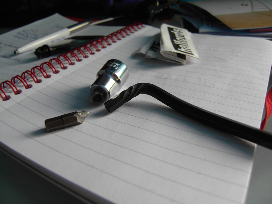

As you can see the halfords socket was so weak it just shattered, needless to say I got my money back for buying that. The allen key that is pictured just twisted and twisted. As it was a sunday nowhere was open, so just left everything for the day. Popped to a garage today (monday) and got them to crack it off with an airgun free of charge. So set about with the removal and refit of the cup suspension.

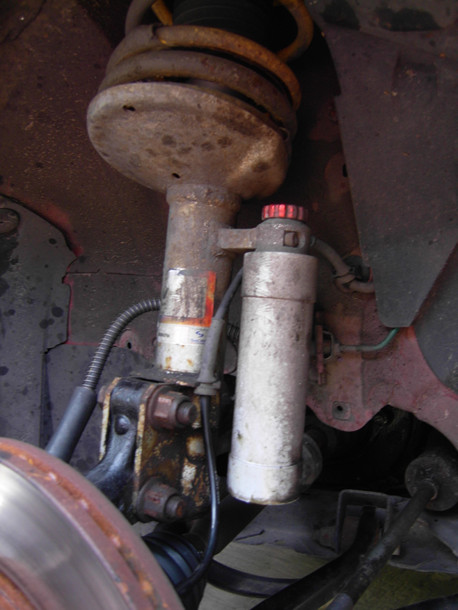

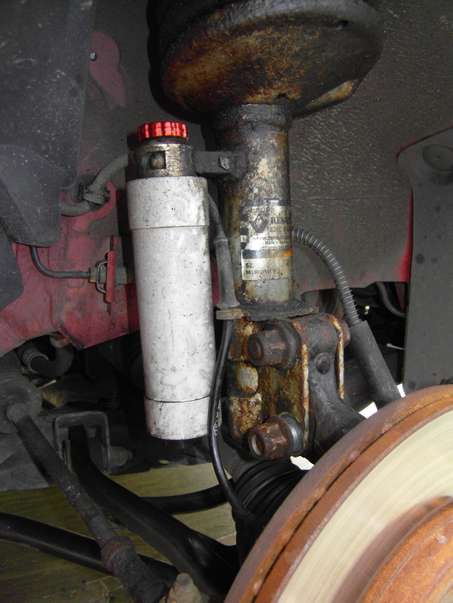

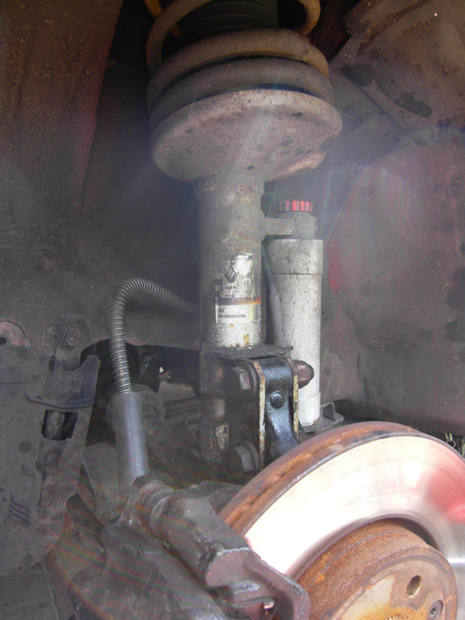

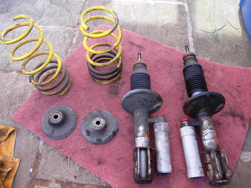

Driver side damper before (Looking a bit worse for wear):

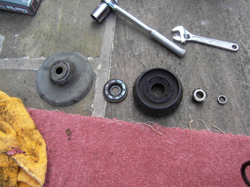

Order the bearing goes on:
Passenger side (Looking better):

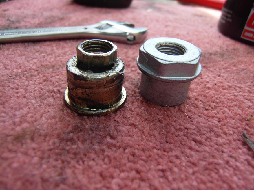

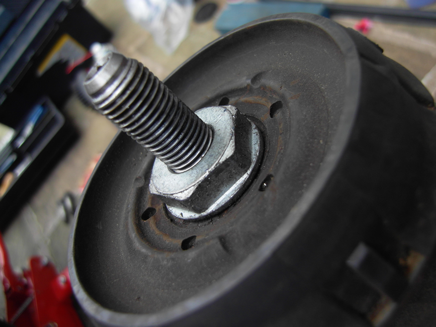

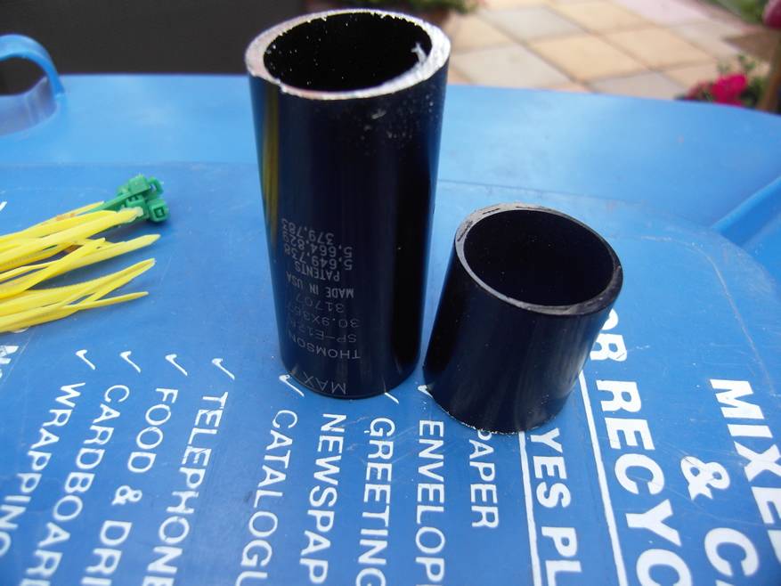

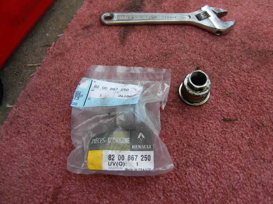

As I've been having some knocking coming from this side of the suspension from when I bought it I bought the new insert from renault :
(Old on the left (bottom bit upside down), New on the right)
As can be seen its now a single piece item, however when installing the new insert there was still lots of up/down movement in the bearing so left it off and put the original one on which still had play. So I am assuming this is where the knocking is coming from. I'll order a new bearing kit from renault in the week for when my dampers come back.

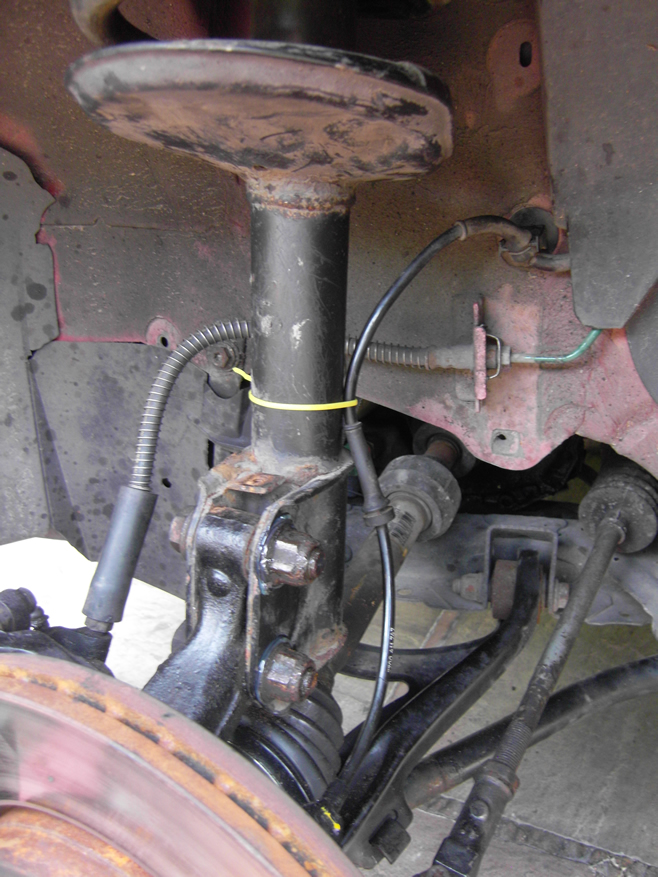

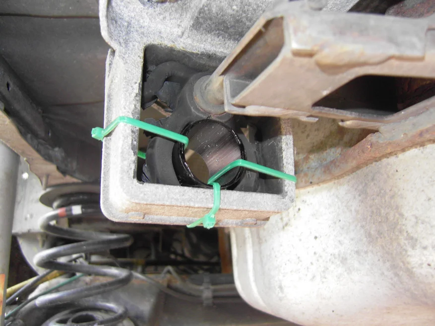

After I had driven the car with both cup dampers on, I noticed I had no knocking noise from the passenger side. I'll be keeping an eye on it to see if it creeps back.
Cup damper in place (cable tie use as there is no abs clip, as it was taken off, and the one of the sach is built in)

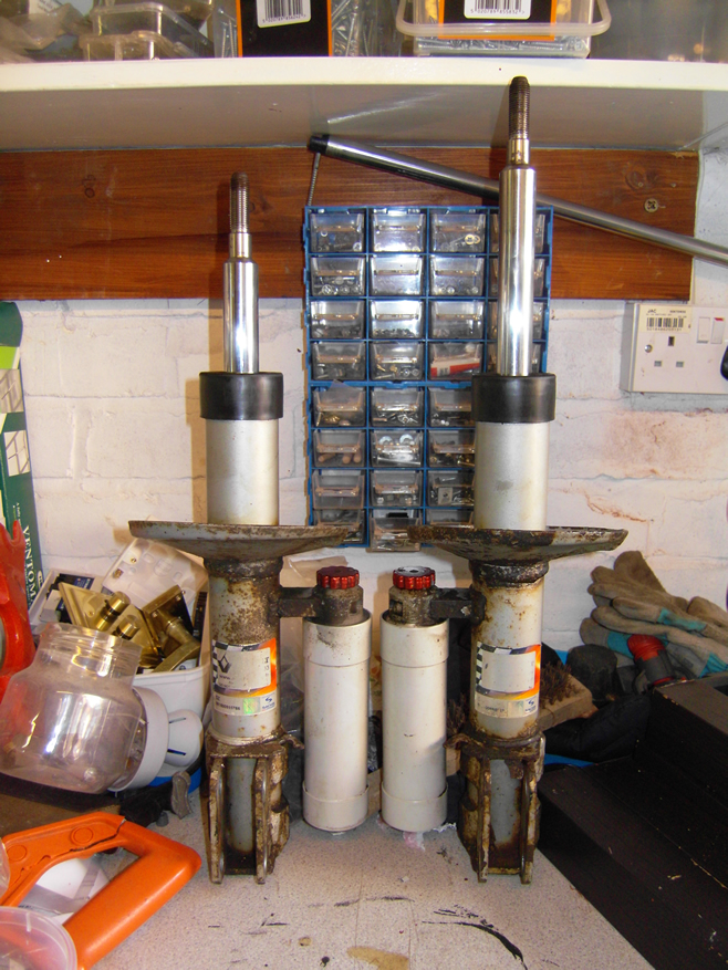

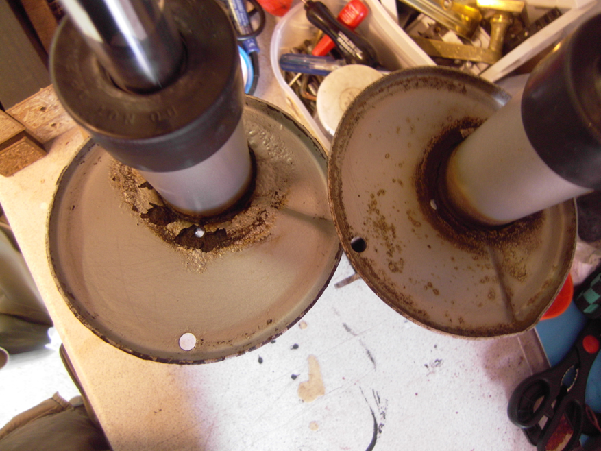

Now time to get them clean, ready to be sent to BGMotorsport
Before:
After:

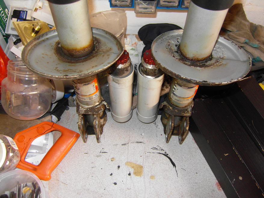

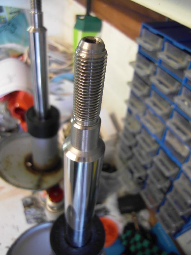

As can be seen above the left hand damper has pulled the piston in, and can be pulled out by hand (how it should be iirc) Whereas the right hand damper is pretty much stuck solid in place. I'm unsure of why this would be, but all will be told when sent off. As can be seen below they have not lost any gas: (There should be a space between the 'bridge' and chamber ~5mm)

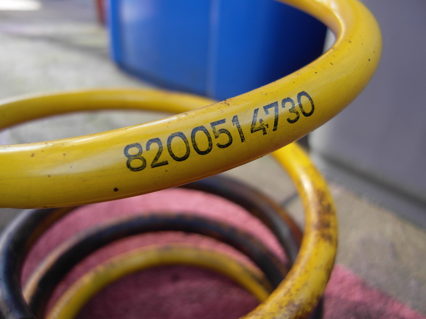

Springs after:
Part # for reference

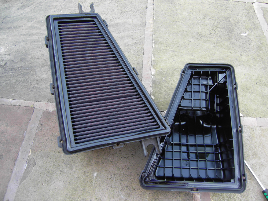

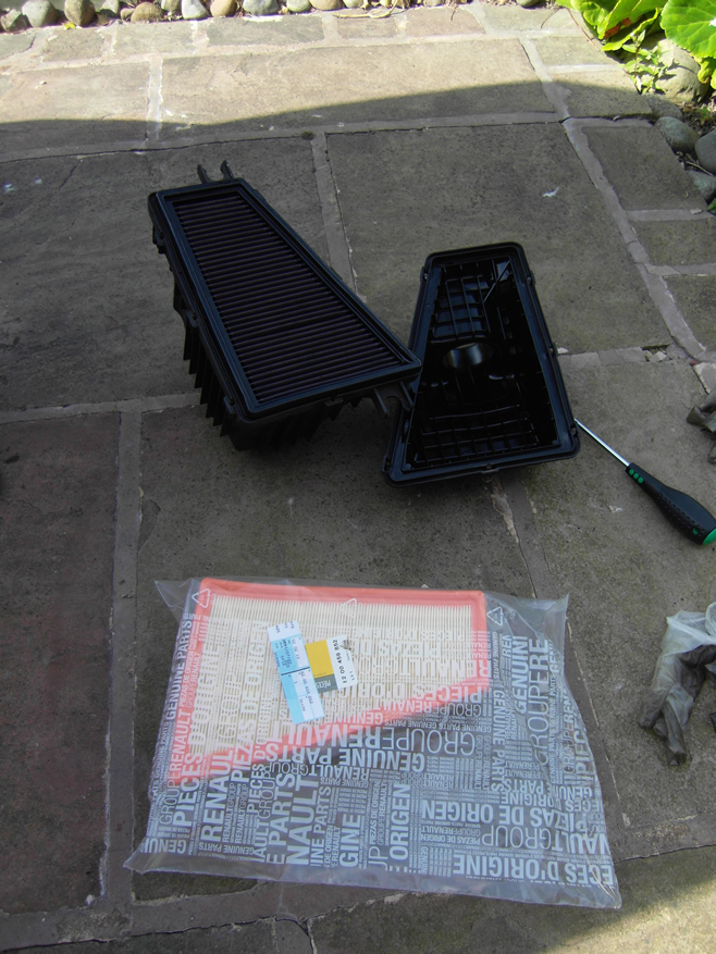

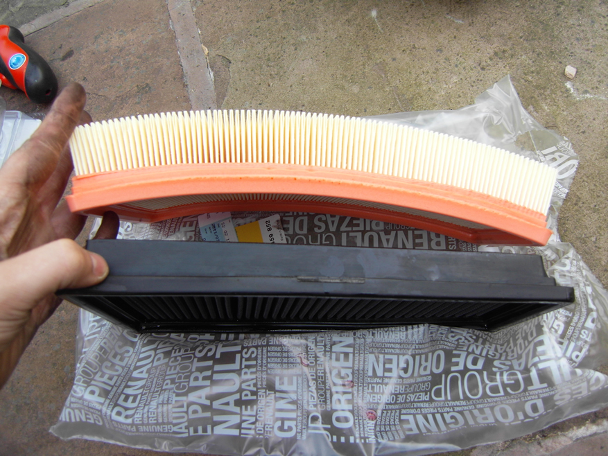

After that was done I replaced the air filter, as it was only £13 I decided to change it to a clean one. However upon opening up the airbox there was an aftermarket filter in there, which to me looks like an K&N one. I decided to scrap the K&N and pop the standard one in as I had read that a standard setup is just as good if not the best setup to have. It was strange to see such a huge difference in thinkness between the filters though.
K&N:
New Filter:
Thinkness:

Those dampers were in a bit of a state, you shouldn't actually be able to move the piston by hand so the left hand one was def fubar'd which is strange as the right hand one was the oilyer.
That would no doubt explain what the knocking is then. As that side, you could push it down and spring it back up whilst the damper was on the car, the other side was firm like the cup suspension that is on now.
I too was supprised at the other side being cleaner. I guess it must of been cleaned off by the prev owner.
  5 GTT & Orb'd Trophy
Yeah it would have been fairly bouncey and was probably handling like an old barge.:D
Judging by the oil all over the other I suspect that was well on its way out as well, it will be a completely different car when you get them back on. Are you over on ClioTrophy as well?

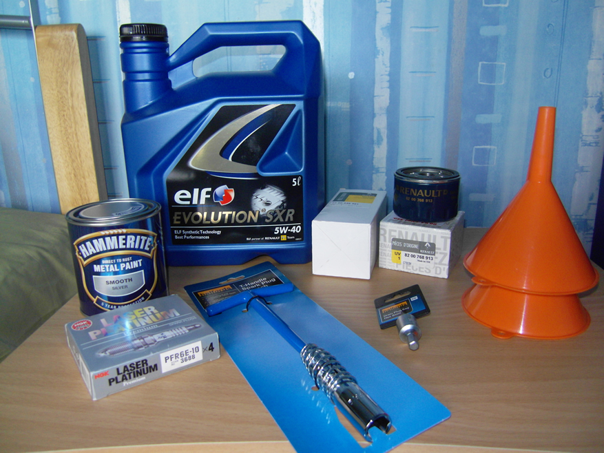

Picked up some bits from Tom @ Wests Renault and Halfords to complete my summer 6k service:

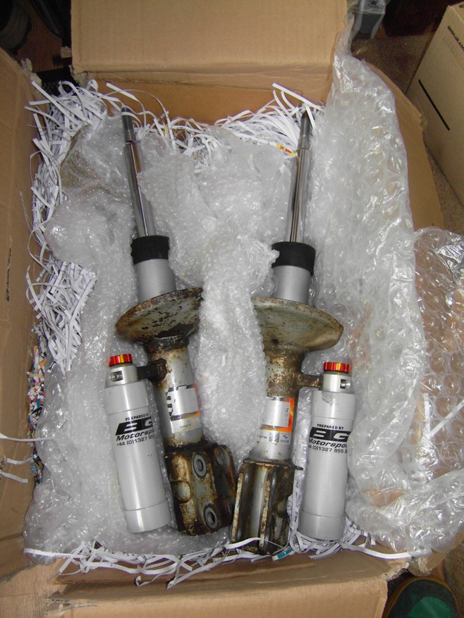

Dampers were packaged up and booked via citylink to be sent to BG Motorsport on the Monday. I was looking all over the internet for somewhere that would insure a heavy package (13kgs) for more than £500. I finally found somewhere that would insure them for a price I was happy with. £3000 sound ok ;)
Cheap as well :D
I had booked them in for the friday (5th) and was told I would get them back Monday/Tuesday (8th/9th). However as I sent them early as it was the only day I could wait in for them to be collected Ben got them turned around ASAP. After a phone call on Tuesday to say the piston shafts had been in the lath, I was informed one was badly scored so had that replaced. Wednesday I had another phone call saying they were ready to be payed for and shipped the same day. Thursday I received them back!

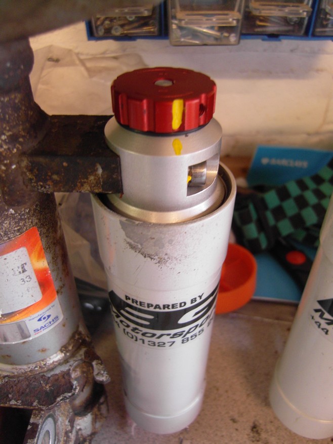

At this point I just want to say that BG Motorsport/Ben Fricker did a fantastic job to turn them around as fast as they did and get me on my way!

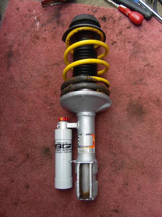

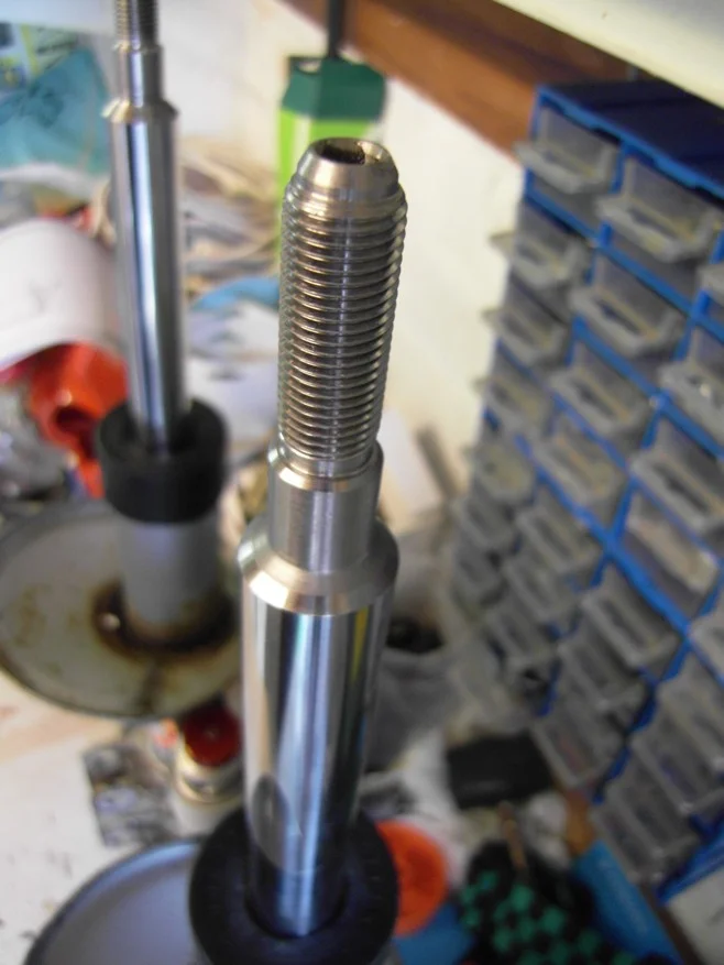

You may see that they have now got BG Stickers on them, Drivers side piston shaft replaced and new adjusters for the gas chambers top and bottom. Very nice and clean anodised pieces!

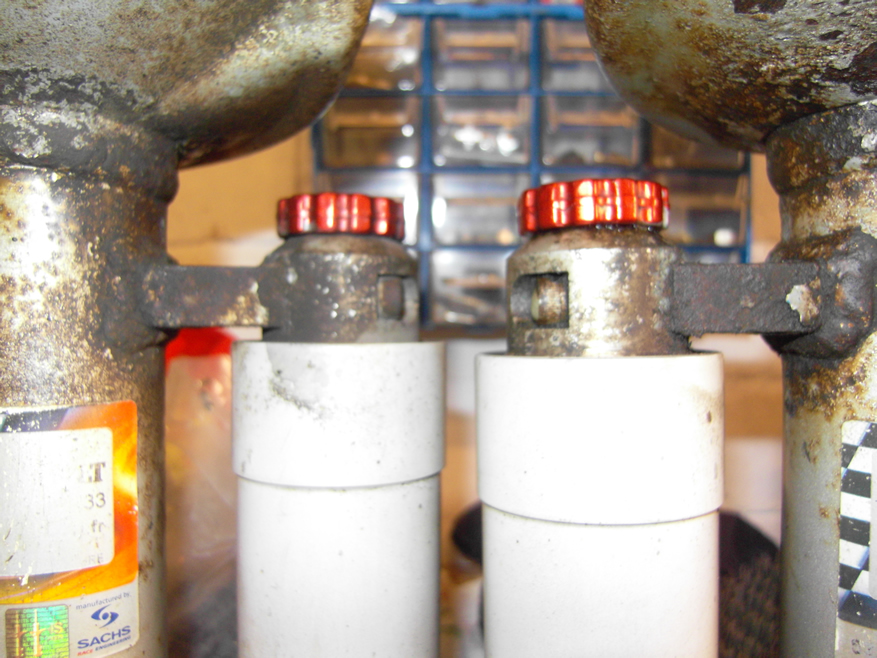

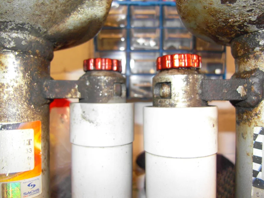

Dampers marked with the standard Renault setting (22clicks from soft iirc):

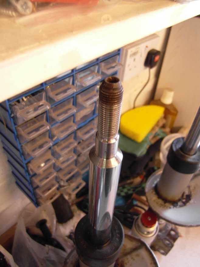

New piston rod:
vs old:

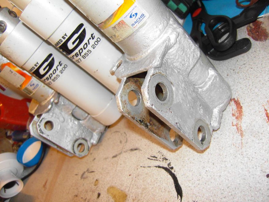

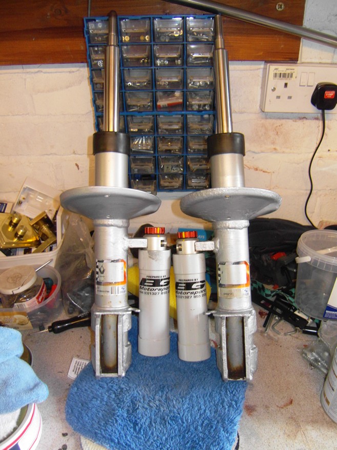

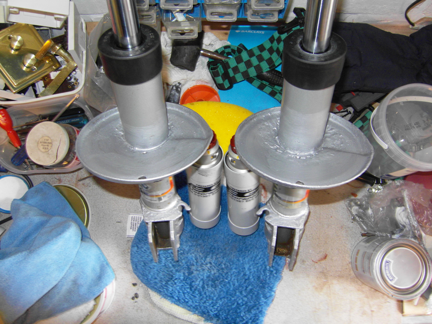

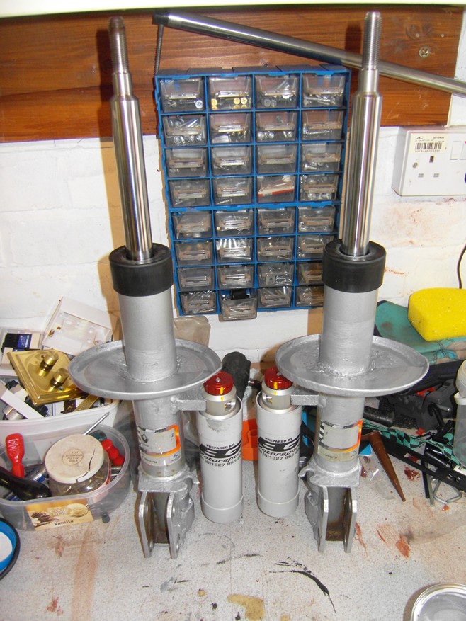

Next up was to paint and seal the dampers. Mainly to prevent any more rust to the dampers over the coming winter months. Some may say that painting the dampers would be crazy, considering how much they are but TBH, they look miles better with the rust covered and I know that they will be protected for a while. I used Hammerite Smooth Silver for the paint, and FK1000P as a sealant (High temperature sealant which will restrain most of the braking heat).
A quick before shot:
After the painting is done:
2nd coat applied and left to dry overnight, the waxed:

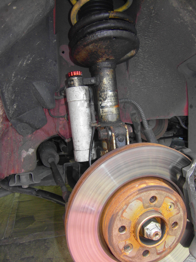

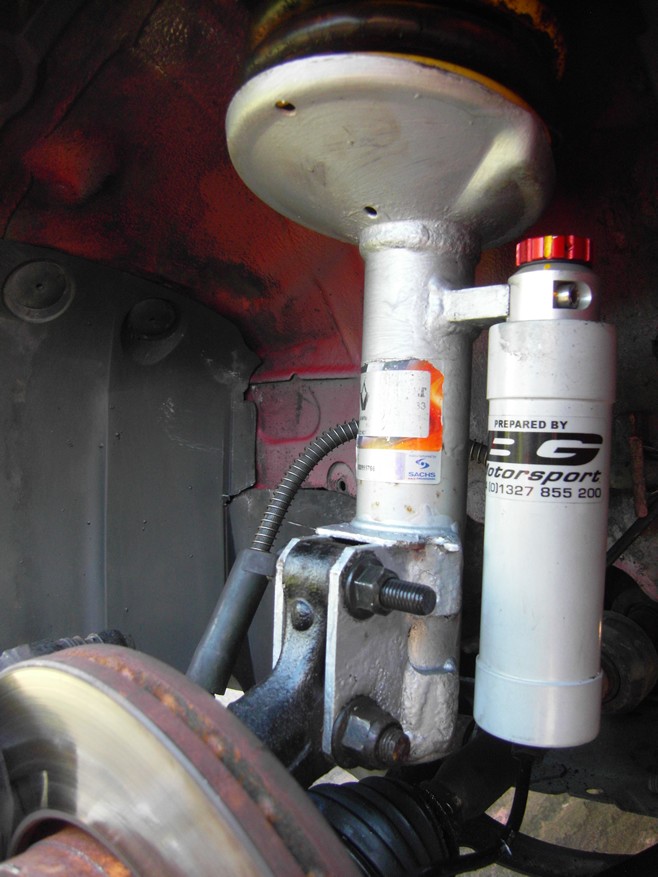

Drivers side built up and ready to go back on.
I ended up using the new inserts that are suppose to stop the knocking etc which fitted like so:
However I was very unhappy how they sat, more on this shortly.

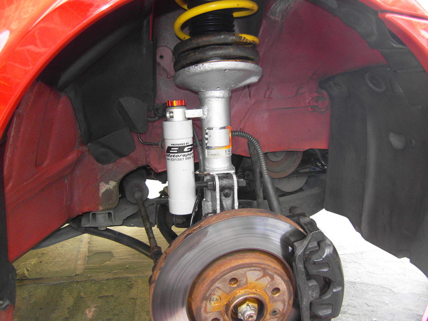

In it goes, with the new camber bolts in.
Didn't take many pictures from now, as time was running short. But the Passenger damper went in and arch was cleaned and waxed like the other.

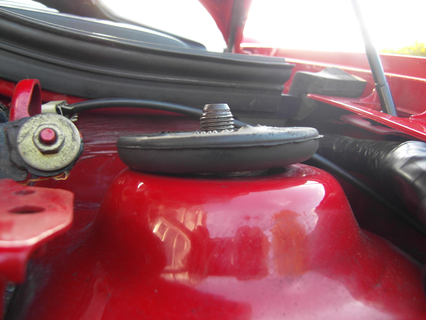

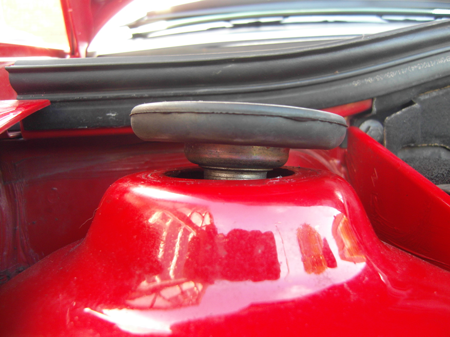

Going back to the new insert problem, this is how the top mount sat when the car was on the ground:
As you can see it is stupidly high, and when the car is jacked up, you can move the whole suspension unit up/down/side to side. After spending ages fitting the new inserts etc I decided to take everything back apart and fit the old type insert, which fits snug like so:
It's slightly tappy every now and then, so I'm going to try the washer fix. If that doesn't work, I'll buy new bearings and the new style top mounts as well.

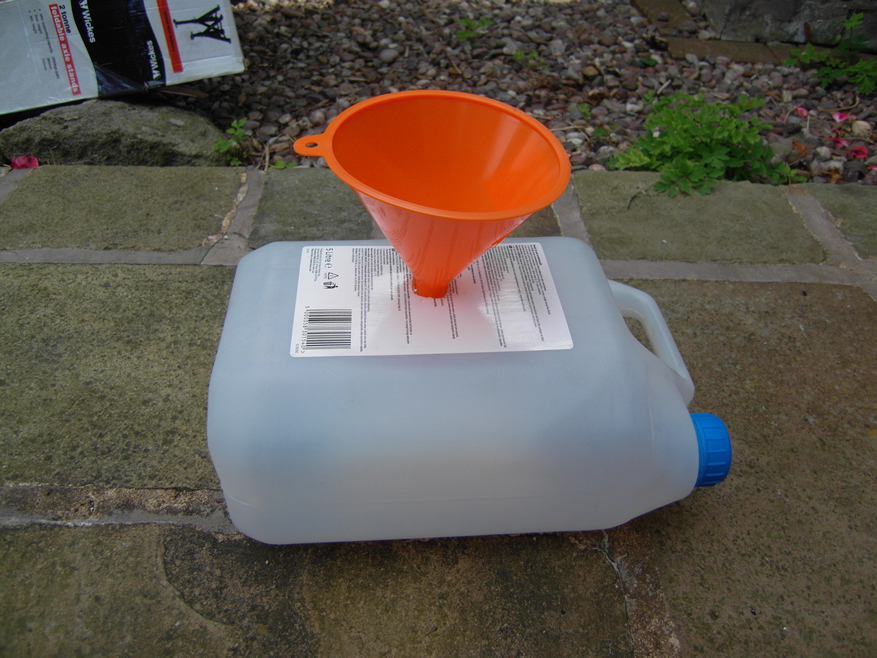

When changing the oil I realised the container I had would probably end up falling over with the funnel in it, so made something slightly clever (in my eyes):
Screenwash bottle with a funnel cut in the side. Perfect hight for the sump as well :D

Why dont BG offer to repaint the boddies at the same time ? I think most people would opt for it.
Awesome car :) looks like your dampers needed the same amount of TLC as mine needed.
Yep, pretty much exactly the same! Drives much much better now, and thats with the tracking and camber being out!
Not sure, never bothered to ask either. I think turn around times would be more and possibly a lot more hassle as more would need to be stripped to fully paint them.

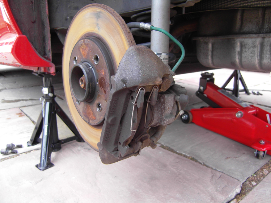

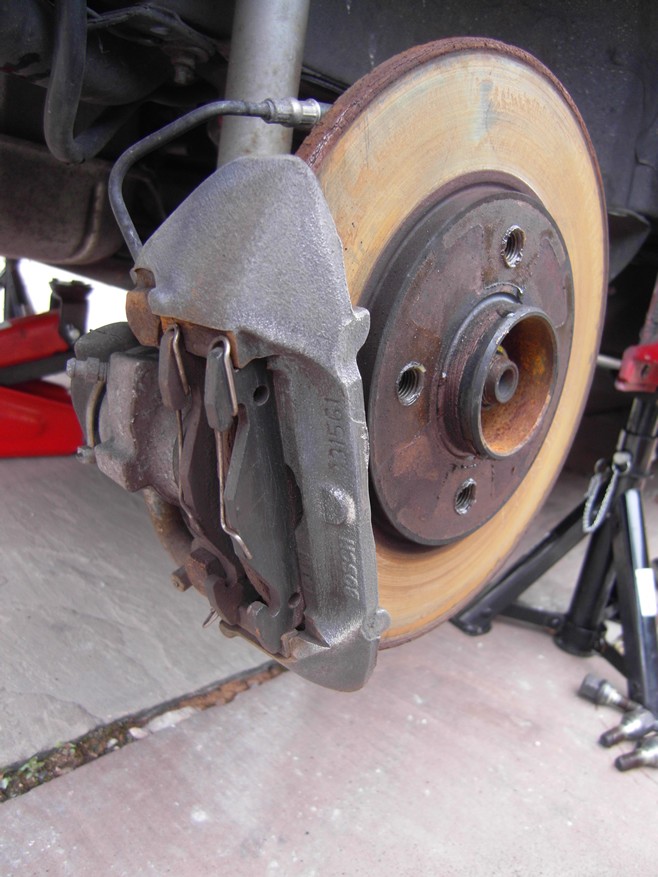

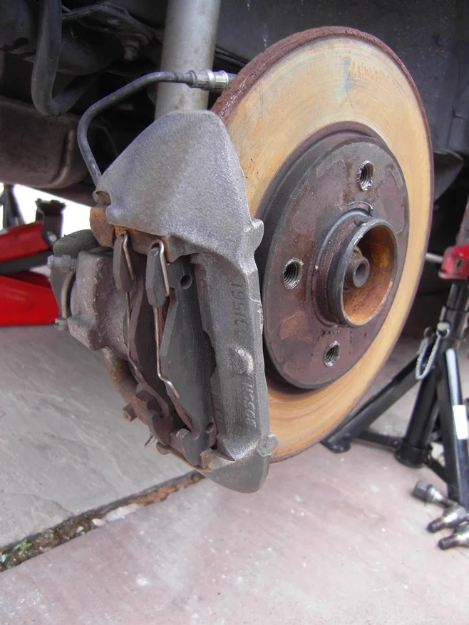

Due to the CV boot splitting and the clip failing on the other side the front wheels were covered in grease, however I had swapped them to the backs as a temporary measure to eliminate the awful tramlining I got from the cheapo tyres.

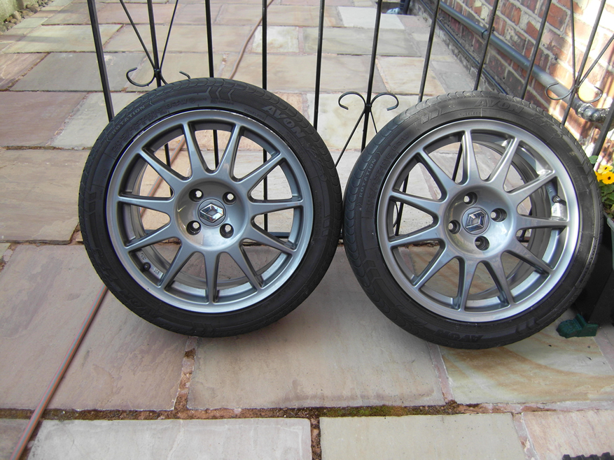

So I had the back wheels off, grease removed (which took forever!), gave them the deironizer treatment and then SRP'd and applied two coats of FK1000p to give them some good protection. The wheels look to have had the grease cooked on them and nothing will budge it! They're going to be powder-coated early next year anyway so not too fussed about this.

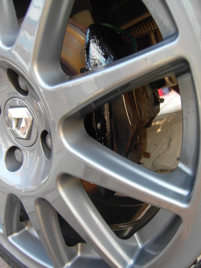

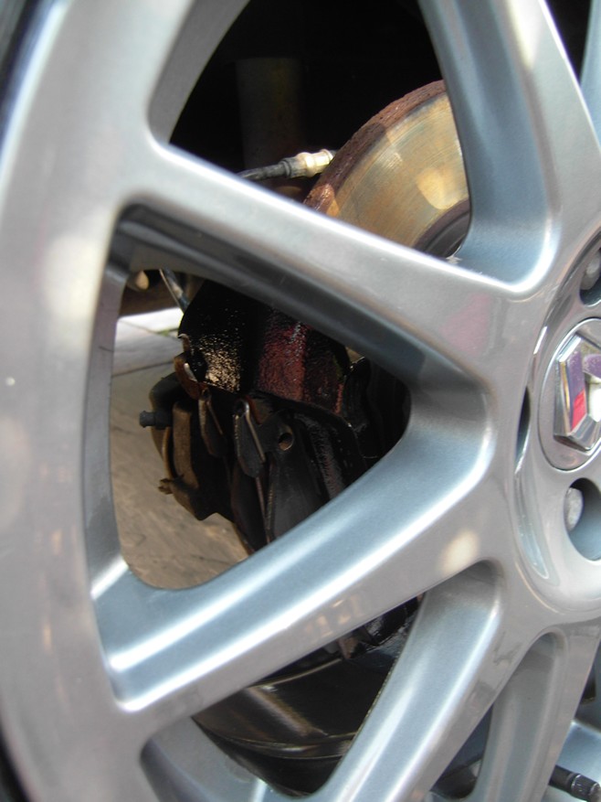

While the wheels were off I cleaned and painted the rear calipers with hammerite smooth black.
Before:
After:

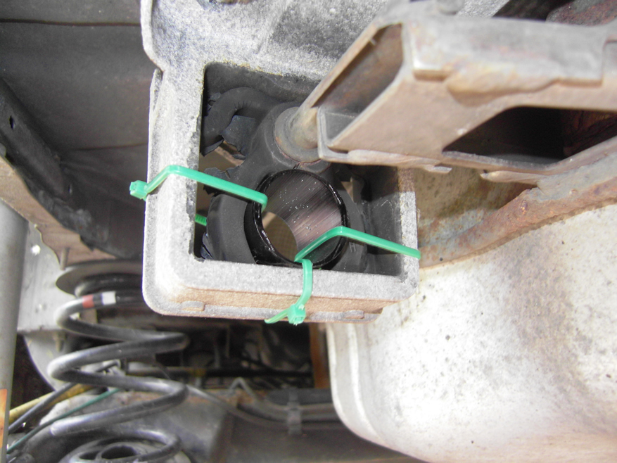

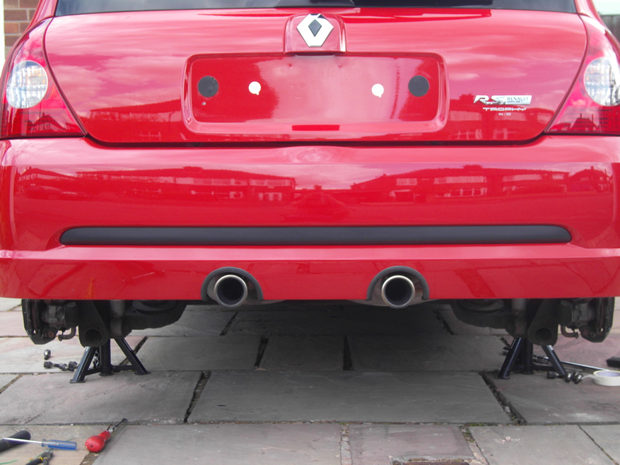

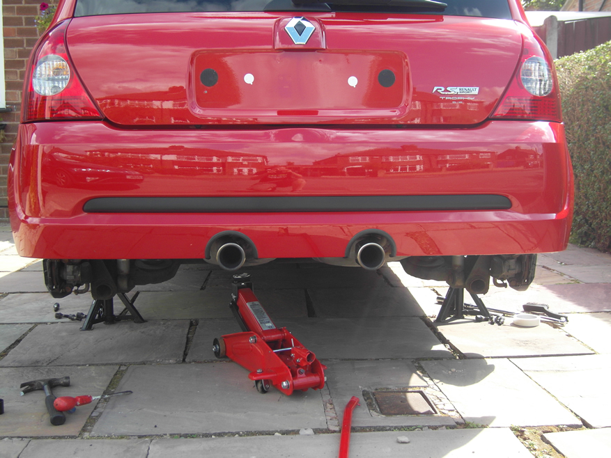

The exhaust has been hanging a bit low since buying the car and as the mounts were new before buying (have receipts) the just needed a bit of support. After seeing people putting old sockets in I decided to use an Thomson seat post from my old DH mountain bike. The section worked well and had good alignment so zip-tied it up.
Section used:
Exhaust hanging before:
Section in place:
Exhaust after section was put in both mounts:
Sit's possibly a little too high on the left side and also you can tell there is a bit more resonance within the cabin.
Though that i'd never got a vid of my decat/exhaust so got a quick one.
Standard back boxes, with centre silencer section chopped + scorpion decat:

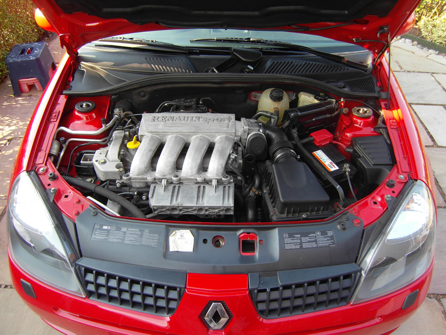

Engine bay cleaned and plastics were dressed with Gtechniq C4:
