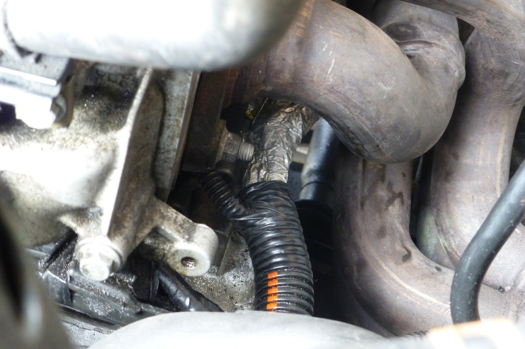

i have changed my gearbox a few weeks ago and for reasons i have no idea i removed the starter more than i normally do then had to remove the wiring to get everything back on.. since then it started clicking like the battery was flat but this was not the case after a look and a fiddle moving the heat shield on the starter motor seemed to do the trick this lead me to believe this was the problem.... it has been fine for ages but today drove it for 20 min and no problem got to work turned the car off to get in the gate and nothing click click click forgot about the heat shield for a few mins and just kept trying and nothing but when moved the shield it started firing but the imob light was on with no fuel pump priming recently went outside and tried it and its all fine and working??? however i have left the heat shield un-clipped. firstly can somebody explain how the wiring should be as mine is so close to the manifold it worries me however has been fine for months and the imob i'm hoping its just due to the issue with the starter.
so can somebody either get a picture of the starter wiring or does anybody know if its something else my gbox earth is fine aswell

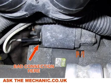

have a check of that connecter, they are prone to rusting and creating bad connections

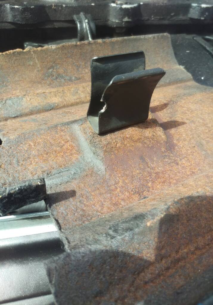

Yes it can i had this hold it on the starter for too long and it will get very hot i cut the metal retaining clips off mine so i didnt have to take the manifold off to refit the shield. Its now held on with a jublie clip and has been fine for 4 years.
  Nimbus Grey 197
ok so cut the clips off and just a masive jub clip ??

Yeah so found this today safe to say it was shorting
Insulated it up and popped it back on will see what happens now..
