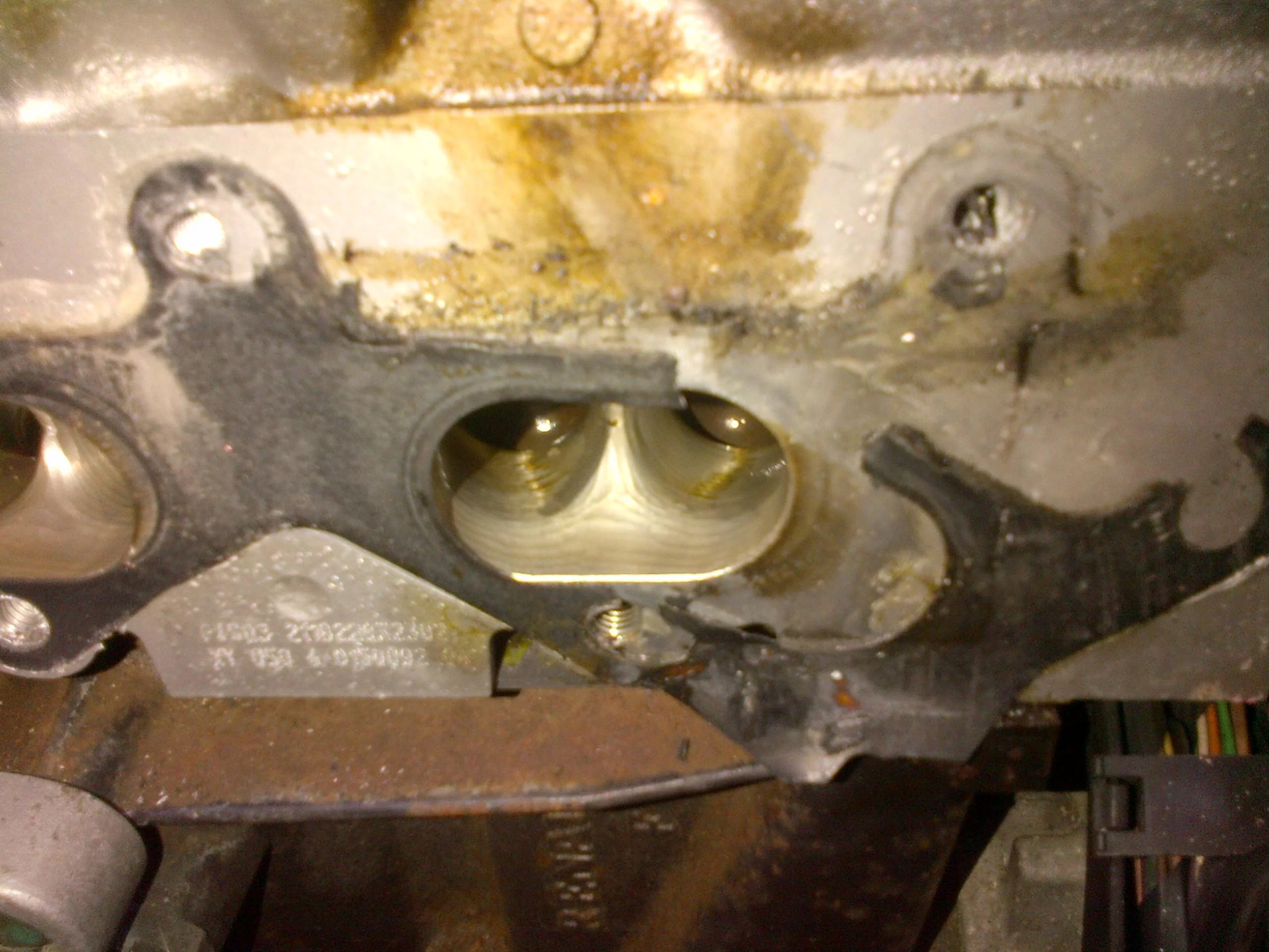

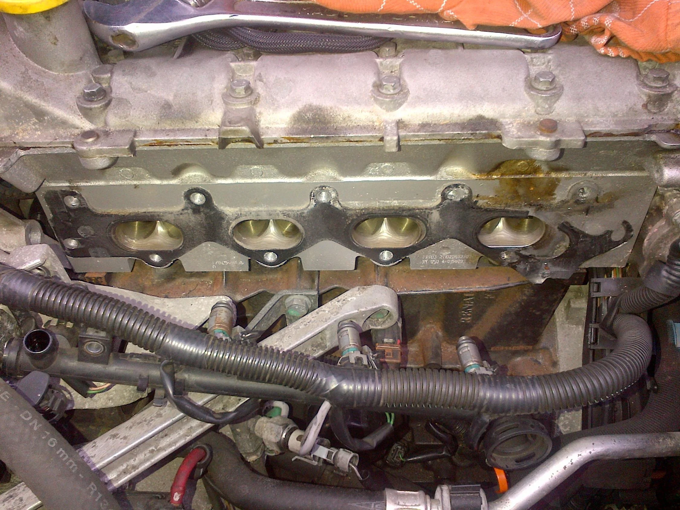

Had misfire number 1 cylinder error on my Clio 182 for a while now and finally found out what i think is the problem. I think the problem was a leaking lower inlet gasket on cylinder 1 it had a massive gap and the gasket was half hanging out on cylinder 1! I today changed the gasket and it seems to idling better but still the MIL light is on.

This is the gasket haha!
