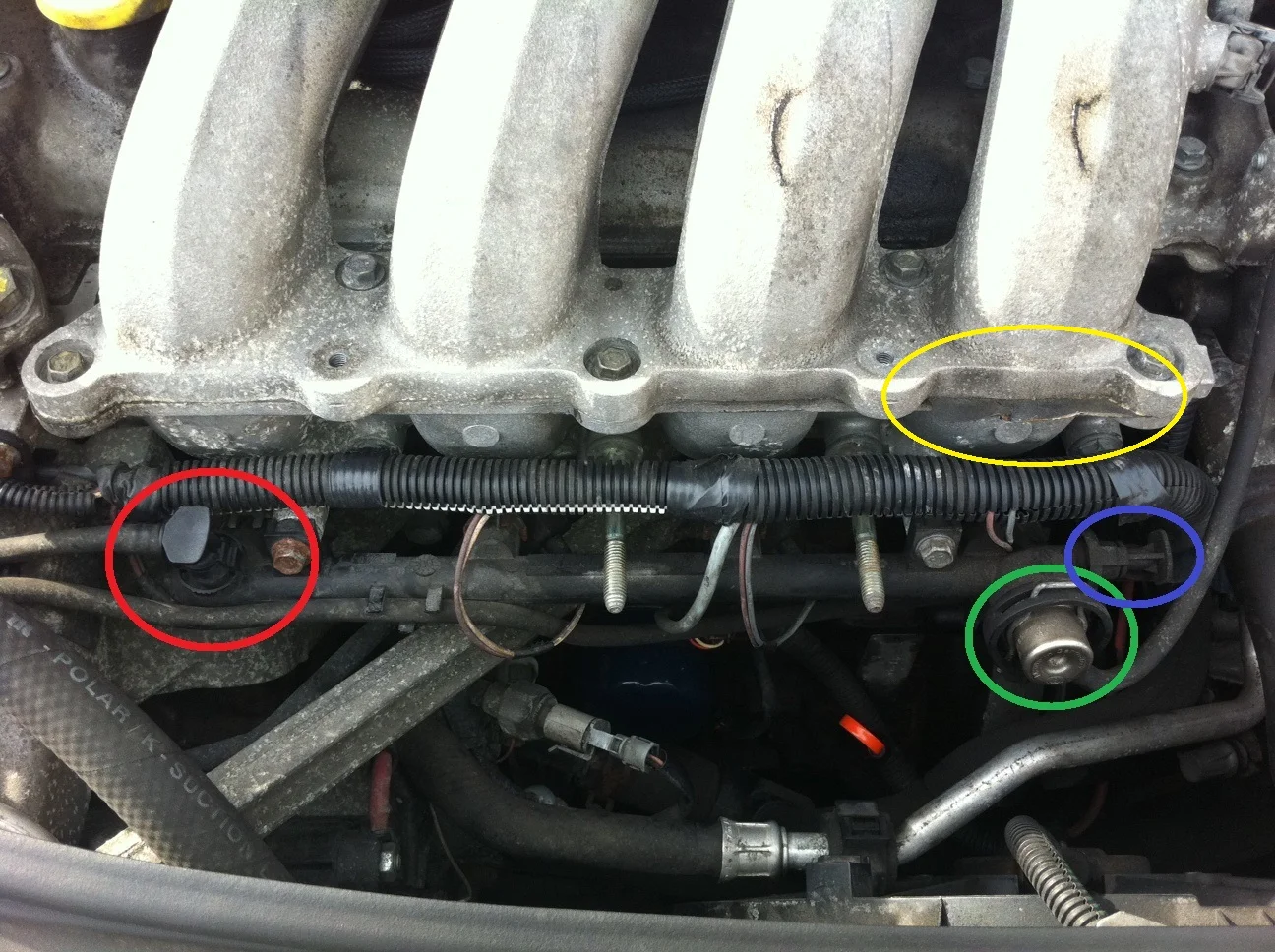

Right after looking at this again I don't think I was talking about the right part at all
In the picture I have circled the problem area in RED. This is the thing that popped open.
I believe the fuel pressure regulator is the part circled in GREEN? If so then this is fine *touch wood* and no fuel has come from here.
The part in circled in BLUE is similar to the part circled in RED but sits the other end of the fuel rail
What are the parts circled in RED & BLUE?
Why did the RED part open? Inspecting this more closely it just looks like a plug that just pops in and nothing appears to be broken.
Another thing that I noticed is the piece sticking out of my inlet....circled YELLOW....what is this?

Red is your fuel line into the rail. Blue is the return, green the regulator. Yellow is a bit of gasket, it's normal.
Sounds like you need a new connector on the fuel in line - I'm not sure whether it's a std connector or renault only.

No need for the pipe as that is fine, just need to sort out why that fuel rail connection opened and what stops it from opening i.e. a clip broken cheers though

Bit confused though, my fuel rail connection looks exactly the same as the above with no parts missing/broken, so if I replace it, what stops it from popping open again i.e. what part on my connector is missing/broken?
Thanks for your help
When I went out to check the car, I started it up and all was fine. I even drove home for 26 miles after it happened and all I did was popped the connector back in.... what holds them in place?
If you squeeze the ring around it in the right place it will pop off. Then you can have a look at it to see how it works - it is fairly straight forward, it has probably just lost its springyness due to age - if you take it off you should be able to see if there is anything else wrong with it.

The guy was here for over an hour and could not get the fuel hose off the clip, which means now I need to take it to a garage to have a new hose fitted along with the new clip :(
  PH1 172
Popped into a specialist and they are going to sort it during the week along with a couple of other bits while I am there
