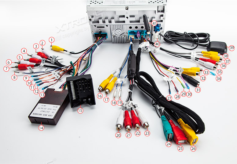

I have a a mk2 TTS, I hate aftermarket looking units that don't fit in or need fascias, so rather than getting a Pioneer or Kenwood etc, I bought an Android unit designed for the car. The unit however has a problem interfacing with Bose and gets some annoying interference noises that can't be solved with a filter or ground loop isolators. The unit is great as a display and being Android does everything, but audio components aren't up to scratch.
I want to use said Android unit as my display in the dash, but then have a Spotify Connect receiver in the glovebox, so I can use the headunit as the screen to select songs etc, but have them sent to the device in the glovebox, which will be a higher quality unit like a Pioneer and will interface with the Bose without the same issues.
Basically, bypassing the Android unit by sending the audio to the unit in the glovebox. I can't use bluetooth though because the Android unit can only receive bluetooth and not send via it, so I need to use Spotify Connect/Wifi.

Isn't your Bose problem going to be caused by pushing speaker-level signal into the BOSE amp?
Splice the RCA outputs into the speaker connectors on the ISO loom and that should fix it.

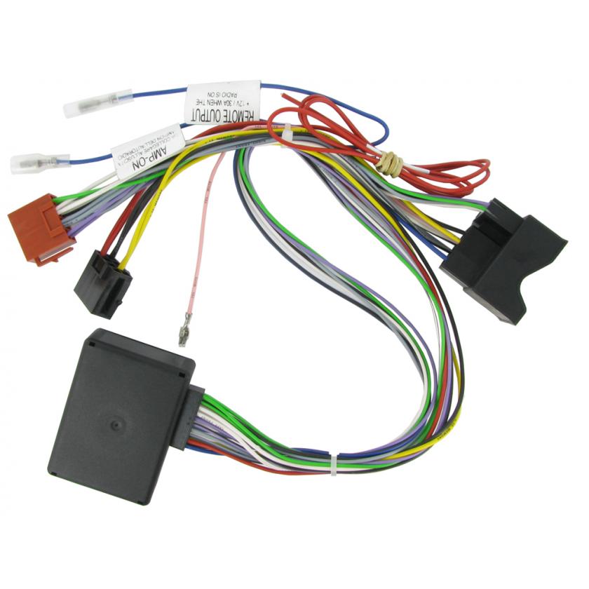

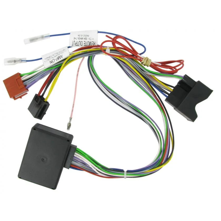

I think the adapter I've got arriving today does that without needing to splice wires? It doesn't have RCA's, so I assume rather than taking low level to high level like the RCA style one does, this is going to use low level like the original RNSE does?
Unfortunately, the brown and black adapters will fit the Pioneer unit, but the Xtrons unit uses a different style of plugs, so I'll need to see if they do an adapter.
  Listerine & Poledo

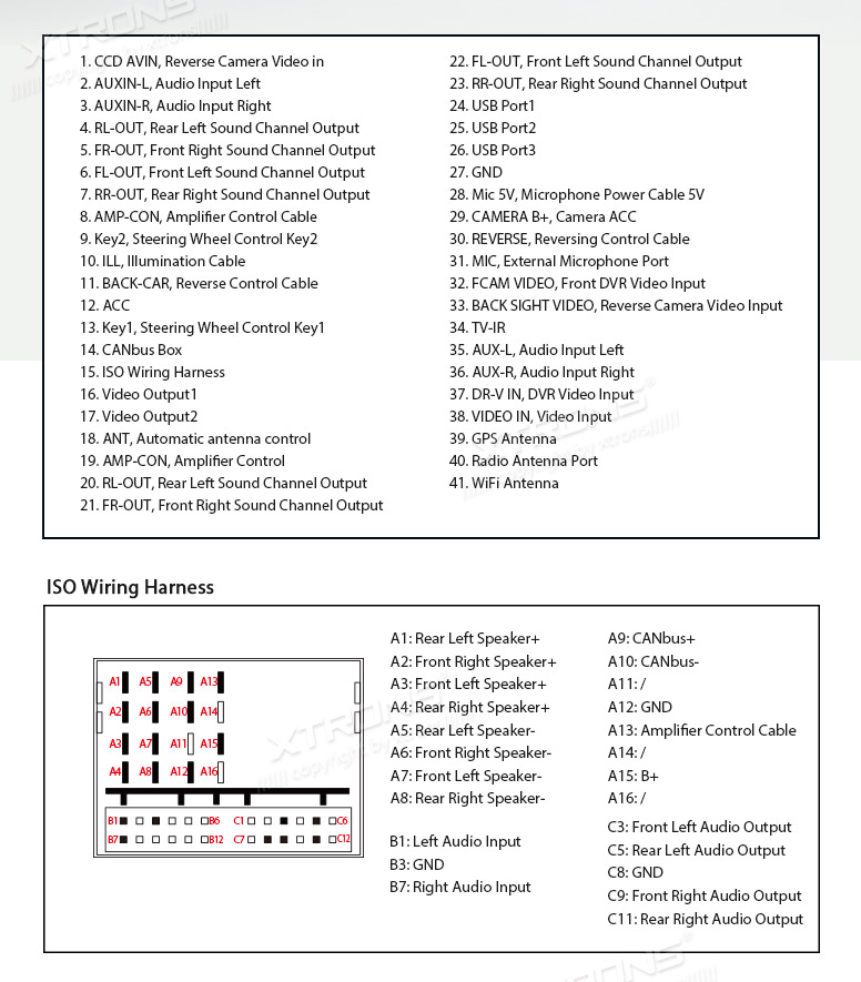

Outputs 20-23 will be your RCA outputs. That adapter looks like the kind of thing that will convert a speaker-level to line-out level. That may well work just fine.
I've seen ISO leads which have RCA's part of them, if I was trying to make aftermarket work with a BOSE, that's what I'd be looking at.
