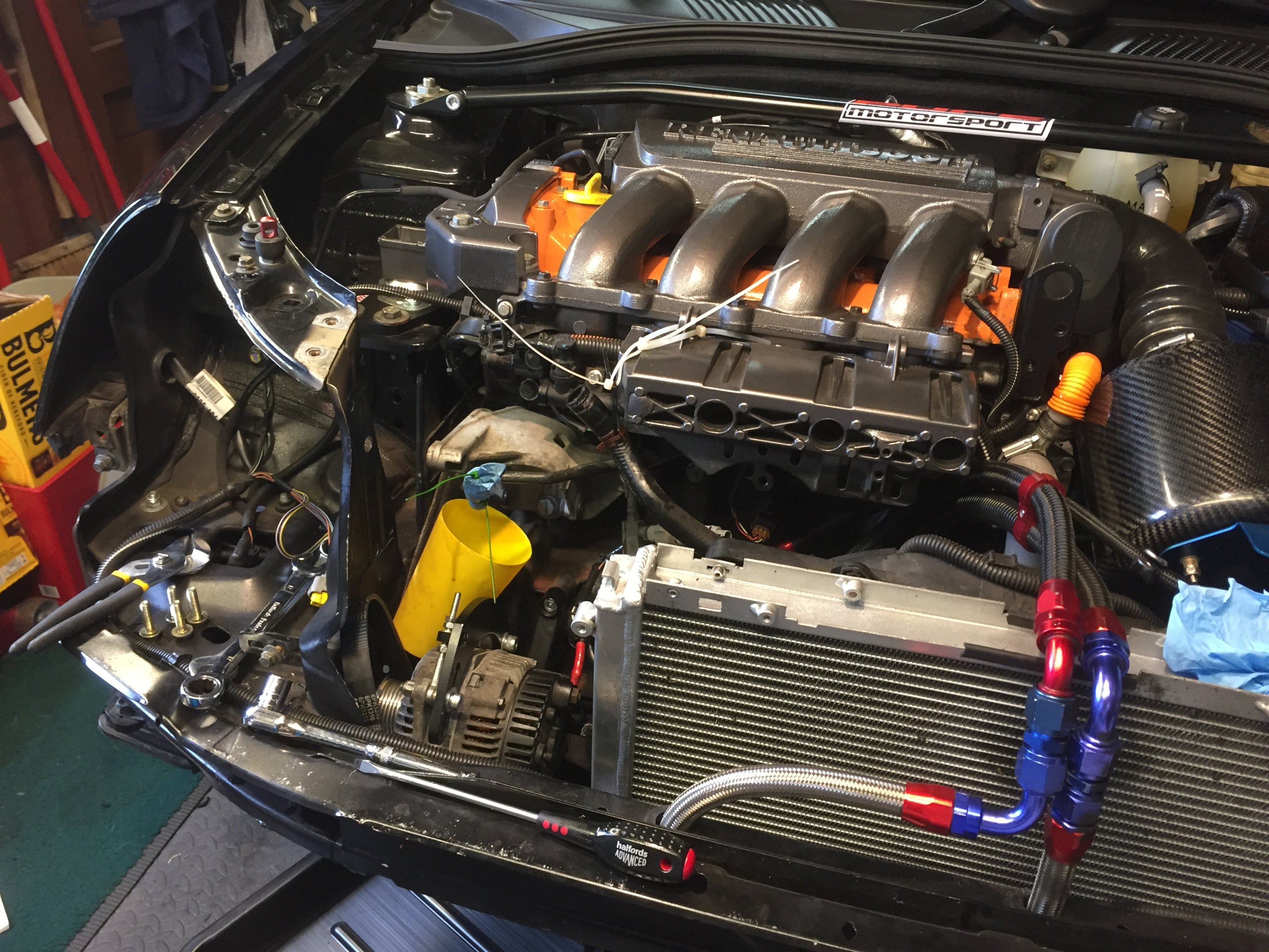

I have taken the pump off today and it rotates fine but there is about 0.5mm end float so don’t know if that is causing the problem.
It’s a pita to get to
I have found some reconditioned pumps on eBay for about £80 not many options as Renault have stopped selling them.
Also found a TRW one a bit more expensive but it says for cars without AC so not sure if the mounting points are different.
I will probably order one on Monday and get it fitted next week so should have a update then.
