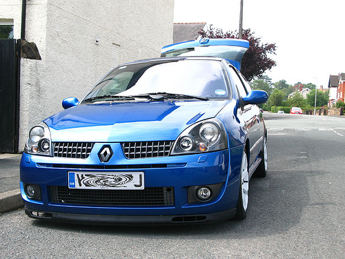

Hey guys, had my 182 for a few weeks now so I've started to push it a little more. Thing is the front wheels rub like a biatch somewhere, you don't even need to load it up in the corner that much.
Seems pretty useless having a fast car if you can't find the limit of grip due to the wheel rubbing.
I've had the wheels off and there's nowhere obvious where they're rubbing inside. They have spacers too. I can only conclude they must be rubbing on the lip of the arch.
Is this a common problem? How can I get it fixed? I want to be able to corner hard and find the level, not crap myself thinking the tyre's about to blow-out.
Any help appreciated.

find out the et of the wheel, the 182 ran an et45 so even putting on wheels that are et37 (commonly sold for the clio, aftermarket) then this would push the wheel 8mm further out towards the lip of the arch, then if you've also added spacers, they'll be even further out.
et37's add 16mm to the track of 182
all the above is assuming the wheel width is the same, if you've gone for a wider/narrower wheel then it changes too

the spacers *may* of been added for a wider track but sounds unlikely, the spacers were probably added for aestetic purposes, possibly because the former owner thought the wheels sat too far into the archs, either that OR, they scrubbed on the inside before the spacers were added, because the wheels are the incorrect offset! take them off and see how you get on.

Bit of a minefield this atm. Wheels are aftermarket with 15mm spacers on, lowered on coilovers. As it's a conversion I'm not 100% on the other bits such as the front hubs.
I've been reading up on these spacers, hubcentric seem to be essential. But I can't find any clear info on what the difference is. When I took the wheel off before the spacer still sat on the hub (didn't just slide off, if that makes sense). Went to remove it but I'll need shorter wheel nuts now.

hubcentric are essential. They mount on the centre-bore of the hub, then the wheel mounts on the centre bore of the spacer.
if you don't have the centre bore, then the wheel will bolt on just off centre and VIBRATE really badly. It's a wonder they are allowed to be sold tbh.

wind the coils upa bit? i know that sound like the opposite from what every one does (most seem to put them on the last thread coz it looks wikid innit). but perhaps its a bit too low for drive ability. although i'm sure some one will say take the arch lines out coz if its not rubbing its not low enough or something to that effect.
could find that they have bodged normal 172/182 stuff to fit the 182 cup as they have different clearances apparently and suspension parts and there arent as many options for them.
