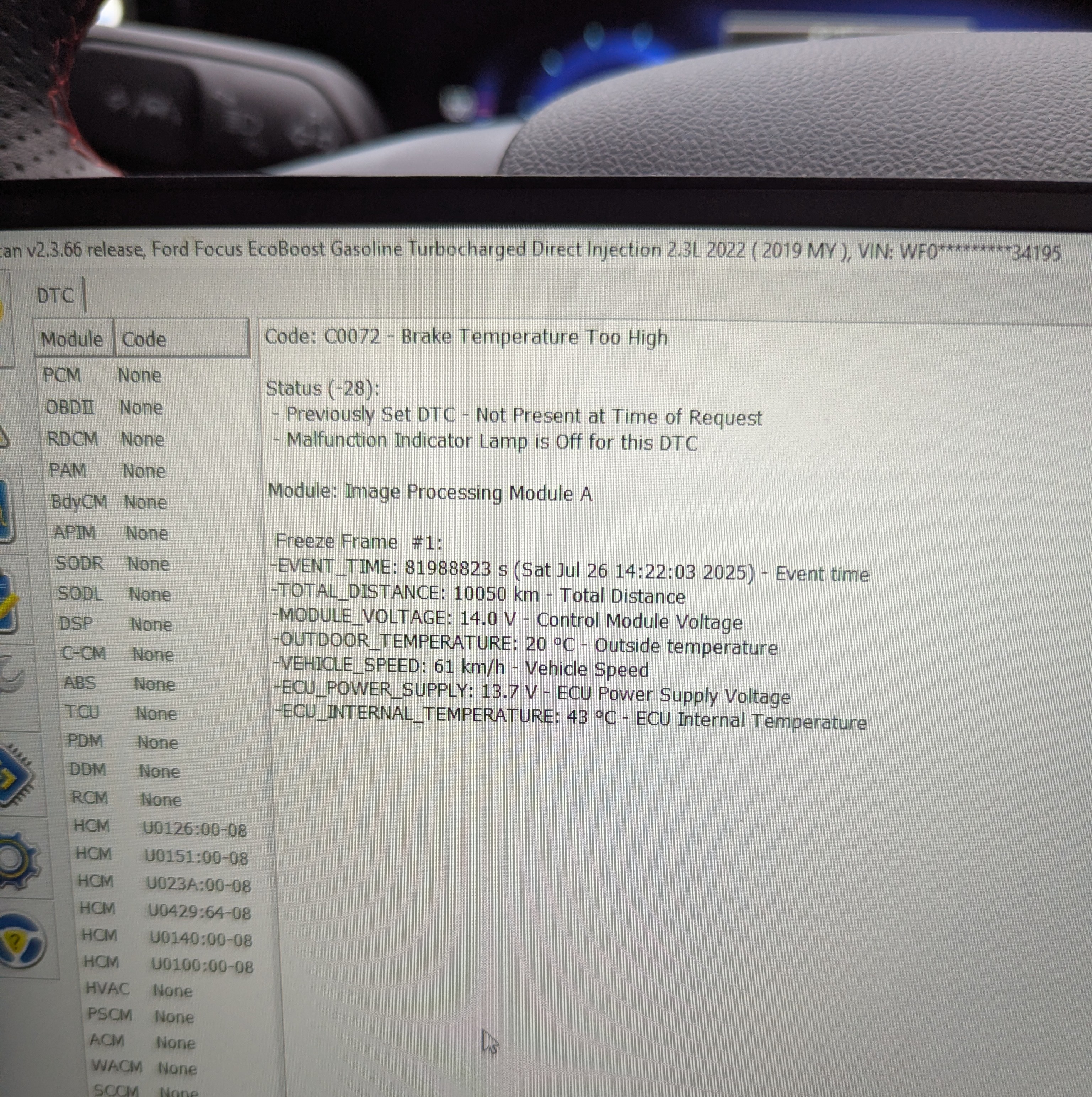

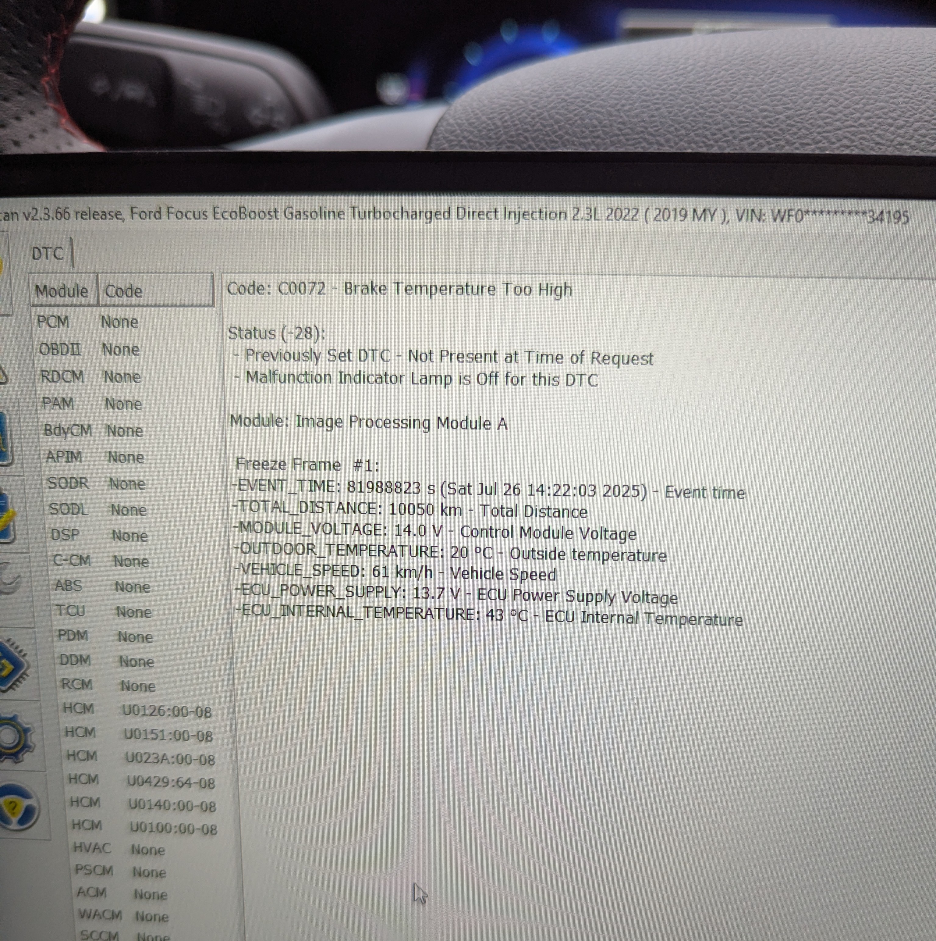

Doing the regular battery % check and charge and noticed a bunch of DTCs. Some relating to adapative headlight issues that I'll ask Ford to look at next time it's in with them (think it's a known issue with a software fix), but also spotted this one. Gave me a brief panic until I noticed the date and time....
I had exactly the same on the ST last year 🤣

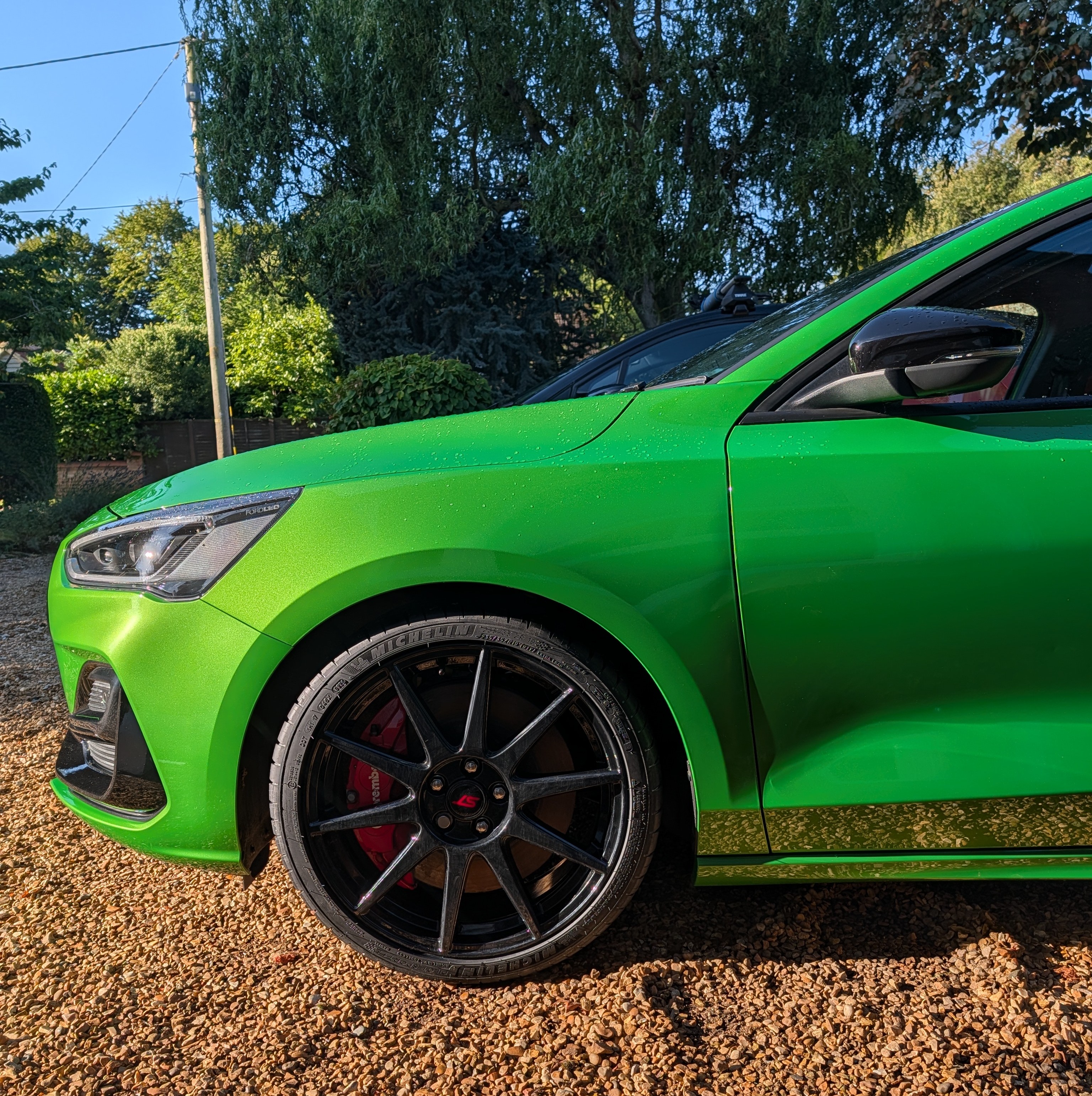

Still, the green's looking good in the morning light today:

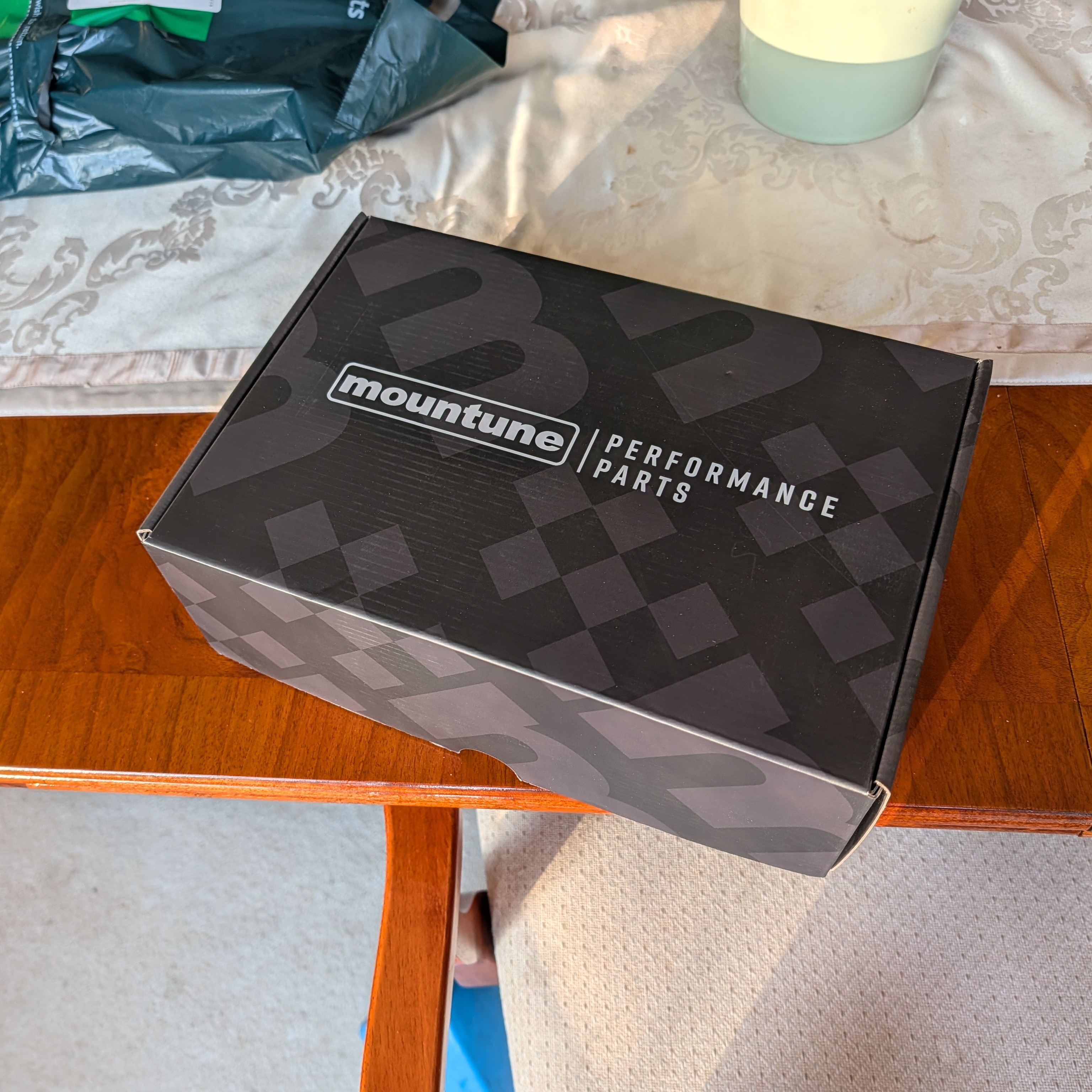

...and the rest of the goodies today. Not going crazy with this so it's just:
- Mountune M330 remap
- Airtec secondary intercooler
- K&N panel filter
- Iridium spark plugs
Mountune only mandate a panel filter for the remap but stock cooling isn't great, hence the intercooler. Had thought about a bigger FMIC but that involves some cutting and I'd like to keep things easily reversible. The secondary intercooler fits under the car in the same place as the oil cooler in the automatic version so it just bolts in no fuss.
All told should be good for 330bhp and 380lbft which seems like a reasonable amount for a year-round road car. Mountune's next level up pushes it to 365bhp and 410lbft but you're looking at £1,200 in sport cat and GPF and I figure that's going to be increasingly difficult to get the power down in anything other than ideal conditions.
The Psychedelic Socialist
330bhp is plenty.
My Megane at 315bhp spins up in 3rd, sometimes 4th if it's really wet on Pilot Sport 5.
My old Fiesta was pretty good at 315bhp but it made that quite high up (7,200rpm IIRC) so torque wasn't crazy. This thing makes peak power at something like 5,500rpm so a lot torquier, but I'm hoping bigger / better contact patches will help to offset that.
