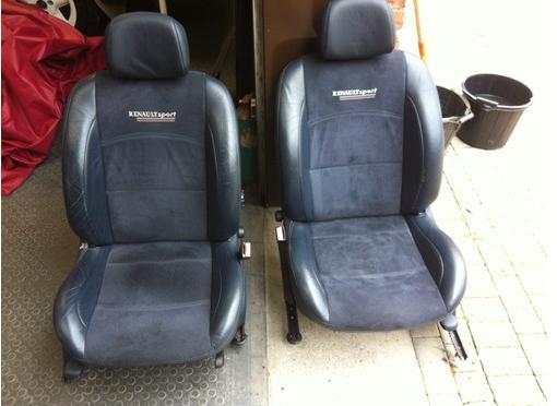

I need some help. I'm replacing the front seats in my 172 phaze 2 and have won some seats on ebay. To be honest i didn't really do any research before buying them and now think i may have made a mistake?
Could anyone help me out.
Can these seats me fitted in a 172 phase 2? I believe the only difference is they are blue leather insead of black? Is that going to be a massive difference? Is there any other differences... do they even fit?
The seats and the car they need to go into are below.
Please help!
  172/1.2/E30
Wiring is a tad different, slider are the same. Airbag wires need crimoing/soldering, that's it. Alomost plug&play. Will look w**k with the ph2 rear bench though.

Bit late now. It I fitted ph1 seats in a ph2 a few years back. They were easily fitted but the wiring was different. At the time I didn't wire them up so had the airbag light on, but as is said above a simple crimping would fix that.
