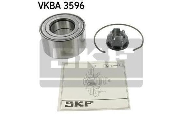

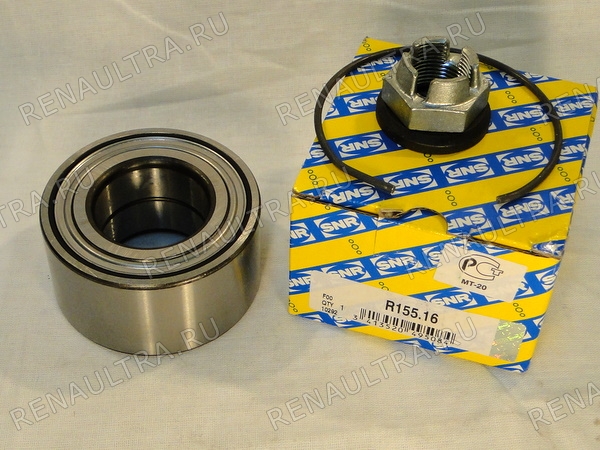

One of my wheel bearings died this morning.
Now i normally would go to the dealer but the price difference in bearings is EXTREMELY high.
I want to buy some decent bearings so am thinking of going for some SNR (OEM renault afaik) and SKF.
But i need to know the right type/size for the fase 1 because is know its different then the ph2/3/cup.
Can you guys confirm that this is the correct size part ?
SKF : Part nr. VKBA 3596
SNR : Part nr. r155.16
Both have these dimensions.
Width : 37
Inner diameter : 37
Outer diameter : 72
  182/RS2/ Turbo/Mk1
The only difference is the trophy/182 cup ones.
All 172 ph1/ph2/cup are the same.(and non cup 182)
  MX5 NC 2.0 Sport
Thanks ! Im realy carefull with those sites as 99% of the stuff doesn't actually fit on the car.
Its fine if you have a regular Clio though.
But to be fair they had it right this time :D
Ordered some SKF VKBA 3596's.
Was able to get them for a VERY good price :cool: (€26 each -> 20 pounds) from germany.

Noticed the 182 cup ones are allot les interesting to buy then the "normal" ones.
  Fiesta ST-2
I'd have gone with the brand that invented the active sensor bearing technology personally. No bias of course.
  Fiesta ST-2
Both are good quality, so whichever you find cheaper. Renault did own SNR, so most of the ranges they were the OEM.
