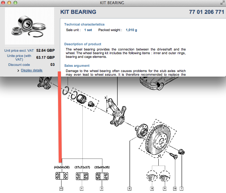

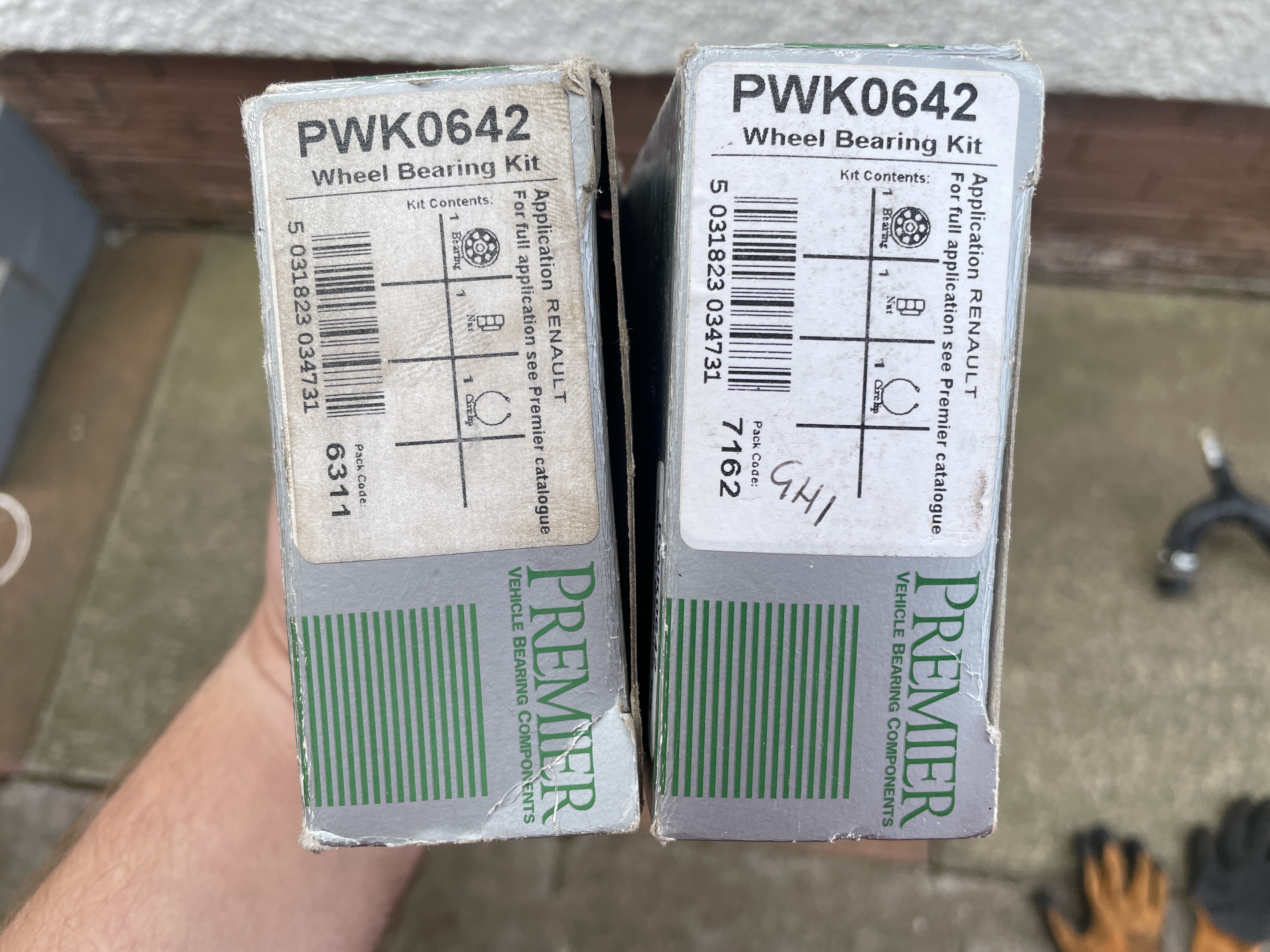

60mm Wheel bearing for Cup / Trophy.
Inside the box is genuine SNR bearings for the BRT Bearings , The BRT Part number is PWK 0642
I have added the OE part number also.
