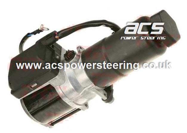

A class merc pump or a berlingo one @ZachB ;)
Like this one?
  Renault Clio RS 182
My pump's very noisy... sounds like I have a supercharger... I'm not using the car on track and just wondered if anyone had gotten a decent standard pump off eBay or elsewhere they'd recommend ?
did you write down the fitting sizes, would help a deal not having to reinvent the wheel.
Merc pump is quite heavy btw....
