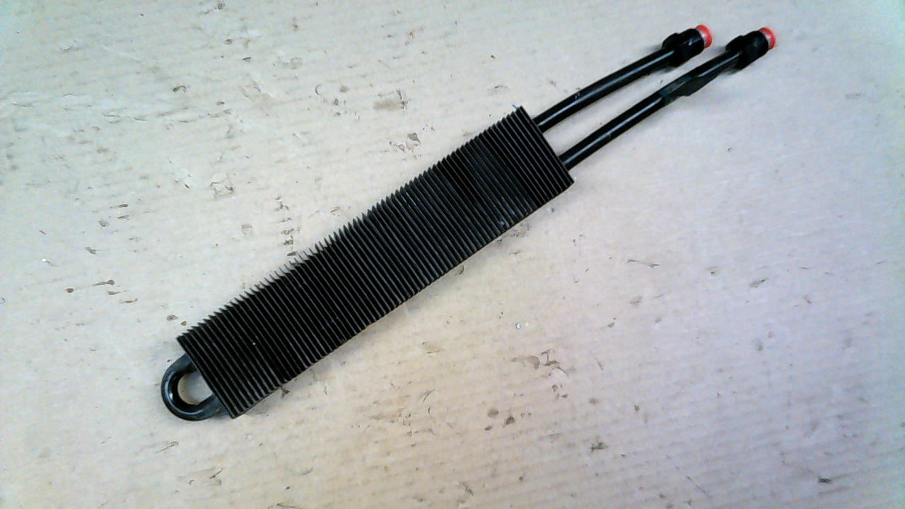

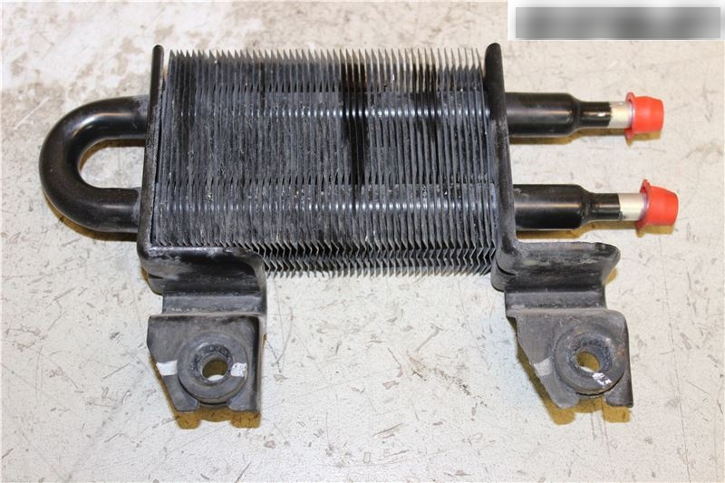

I have a PAS quickrack on order from Pure, might aswell add in a cooler while I'm messing around down there...
what have people used?
Just a loop at the front, or a proper radiator?
I was thinking of something like this (from a KIA)
or this (from an Alfa Romeo)
Can this be overcooled?
also all the PAS lines will be given a heat resisting jacket.

Ha, I thought you might say that! I'm not aware of the system getting particularly hot so that Kia one would probably be fine. I guess it will mount just in front of the rad near the pump to reduce pipe runs. These systems are very prone to leaking so just be thorough when making all the connections. I found that out the hard way after a leak sprayed fluid all over one back wheel at Donington and before I knew it I was upside down in the gravel at the bottom of Craners!

Only small issue is you're hard pushed to fit a cooler partly due to the hose location. One option would be use extra hosing to fit the Kia one.
Another option I've been looking at is buying an oil cooler and plumbing it in.
However, I've fitted mine without a cooler for now and its been faultless. The steering feel is amazing and minimal input is required to get the car turning in.
