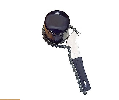

So I'm servicing the car tomorrow and I'm wondering if anyone has used this particular tool for the removal of the oil filter before.
It's only £4.49 from Halfrauds, so I'm not too worried if it's not brilliant, but is it suffice to use? Also am I correct in thinking a general 8mm square socket is the correct one to drain the oil?

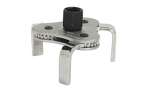

8mm square for the sump plug and that tool will work but I found them to be a right nightmare, the chain kept slipping and just ground the paint off, I bought one of these claw things that I found easy to use.
http://www.halfords.com/workshop-to...h-claw-type-63-103mm-capacity-3-8-1-2sq-drive

I've heard good and bad stories with that one! I've also been out of the gym for a year, so I maybe a little too feeble hahaha.

Tbh any tool is better than nothing, you'll never get it off by hand.

I thought I could just He-Man it off with my hand, but despite having put the old one on by hand, it had formed an incredibly tight seal that I thought even the tool wasn't going to move, i've also tried the screwdriver technique in the past and all that happened was the metal gave way before the seal did and tore a massive gaping hole in it and the remaining oil in the filter went all over the place.

There is no f*cking way any of you benders would have been able to remove my filter, the claw thing damn near crushed it in to a cube before it even moved an inch, if you can undo your filter by hand then it wasn't tight enough in the first place.
