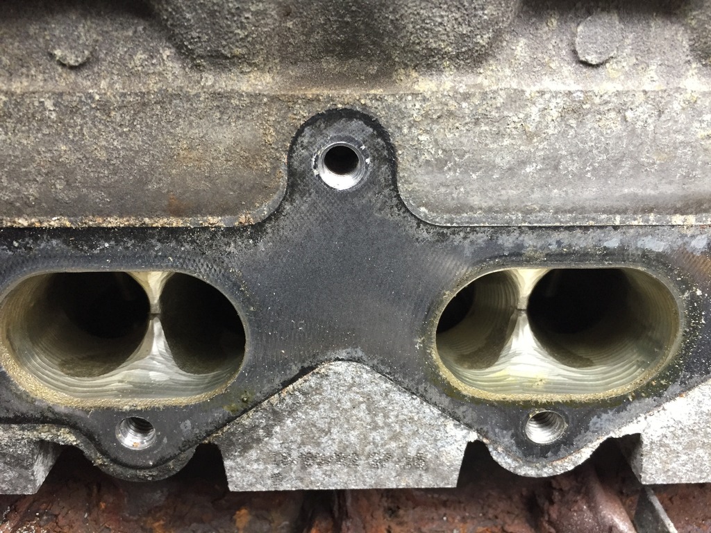

Normal or has someone been porting??
Found this today and wondered if it was standard, doesn't look it but I've not seen another

Gas flow on heads is 10% finish 90% shape, you could spend all day getting a smooth finish for very little gains. these mk2 heads are s**t even with renaults port work

If your engine has CNC'd ports, 4-1 manifold, sports catalyst and a pretty decent airbox setup from the factory, making under 180bhp from a 2.0l engine is pretty s**t.
I genuinely thought they were made with a dremel. I'm a cnc machinist and couldn't believe they'd have left the factory like that
It's all about cost, isn't it really? Building one of these for <£14k means as little expensive machining/head as possible!

I recall reading many years ago a very smooth surface can be detrimental to flow, as a smooth surface can create drag - obviously the standard finish is beyond just being rough for flow purposes, but still a valid argument.

This is true, polished ports, although pleasing to the eye, do very little to improve gas flow through the ports, as a slightly rougher surface can help reduce drag and also can help improve the air fuel mix. The trick in head work is to modify the ports to improve gas flow / speed through the ports and hence get more mixture into the cylinder for a given period of time. Even with the tooling marks left in, the std 172 head actually works very well - the 172 is not slow by any means! That's not saying the head cant be improved though.
