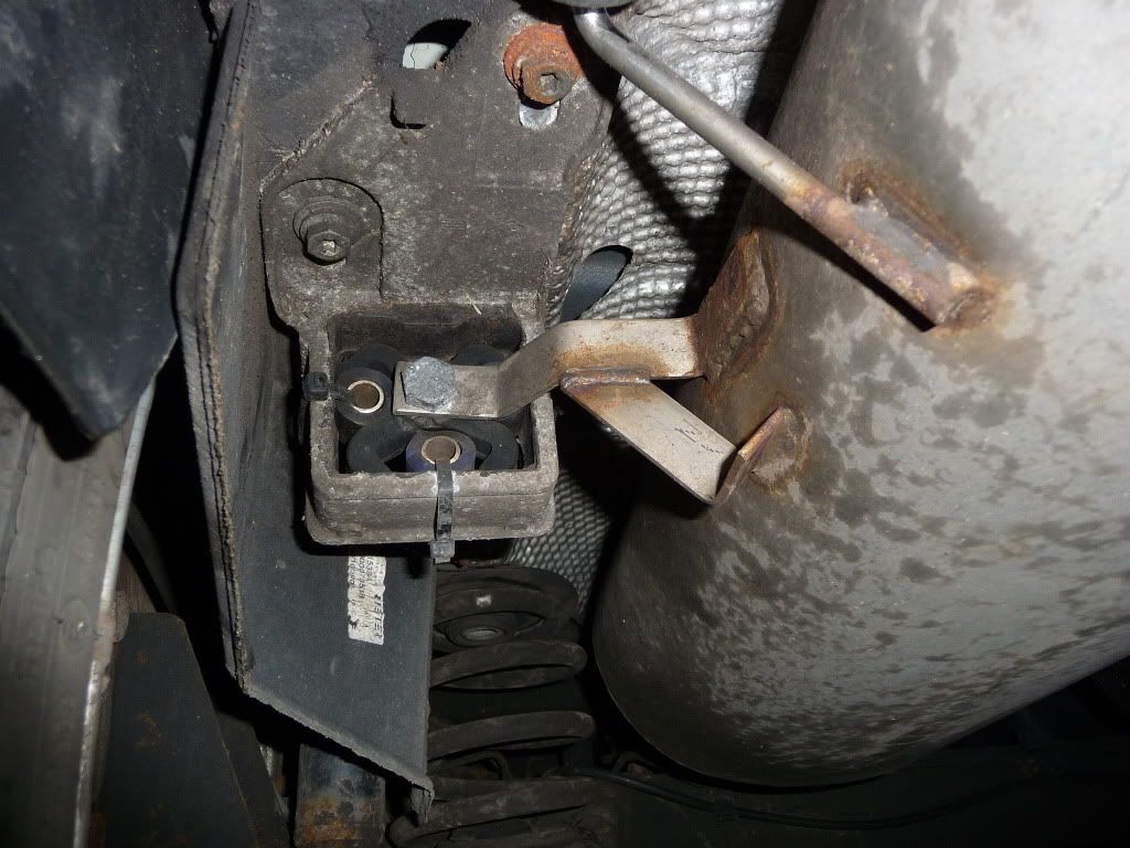

Next pic shows again 2 rear hangers and only really space for one in my existing mount? So I put a screw/nut through the hole and fitted it to my existing DIY'd mount. Was that the right thing to do? lol. Also, theres only 1 hanger on my center section whereas my original exhaust had 2. Im not too confident that the exhaust is secure? especially since one rear hanger is unused?

what's going on with that backbox? is it supposed to fit the car?
the hanger's the wrong way around? getting a decent fit for the backbox is going to revolve around what you can do with the hanger - i guess your welder would have considered it, but removing the original hanger (if possible - risk of damaging the box by the looks of it) and welding it back on the other way around after having trial fitted it should work. or have an exhaust fabricator cut the existing hanger off and use a new one
you need a new rear mount as well (get one before you have it rewelded)

re-read that you've lost one of the hangers - it just looks odd with that one that's pointing rearwards, as there's no use for it with the standard mount?
anyway, it shouldn't be too big a job to sort it. would have thought most exhaust fitters/fabricators will deal with Bosal and they've a pattern mount (part number 255151, £10ish) that should help make sure it's done properly:)
the rubber looks nackered on the car, probably why its sagging down even with the wedges in....
dave had the additional mount/bar put on to get a better positioning on the bumper and to hold it in place better, so you wont have the mount there for that from standard....you have to ask him what he used to mount it to

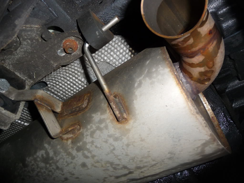

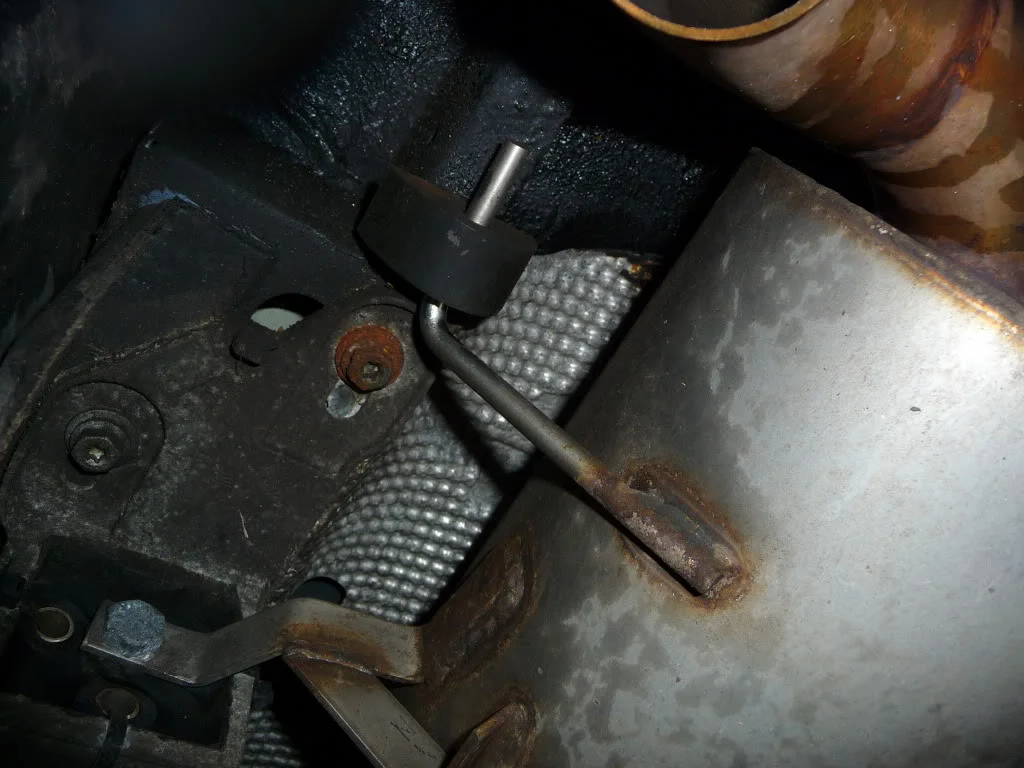

I've taken a few pics of my exhaust as it's a Prospeed too, just to show you what the hangers are like. Hope it helps.
Sorry about the crap photos, and no comments about my dirty car please. :eek:

Thats how my prospeed was (as in marby's pics)
As daft as the two hangers look, they make the exhaust sit so much more solidly.
  It's A Reno
As Dan said, that's how Prospeed hang their exhausts.
It's bolted or screwed into the beam. I'm sure a motor factors shop etc will carry them.
