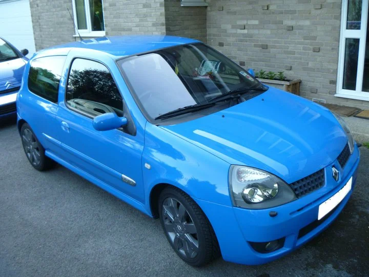

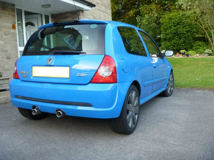

247074_10150621318850154_768045153_19351118_7951994_n.jpg254999_10150621322465154_768045153_19351134_2731596_n.jpgsome pics....
  RS 182 CUP
loving the colour. you need to change the wheels as ive been told 182 wheels give poor brake cooling.
