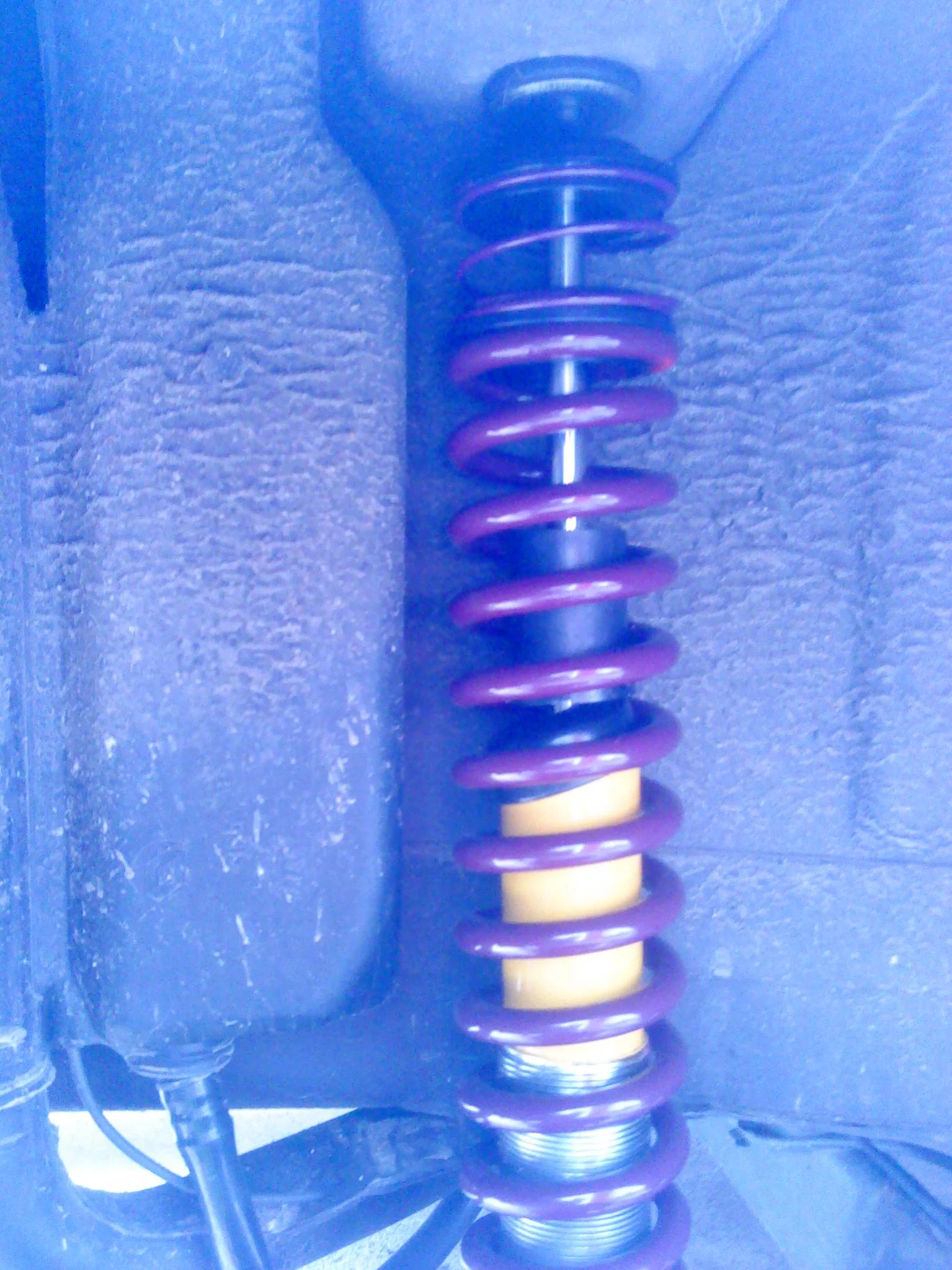

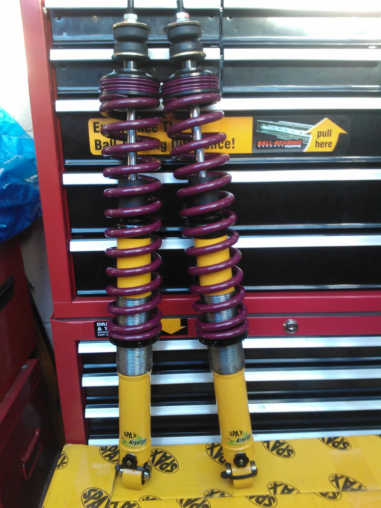

Anyway heres the spax WP_000106.jpgView attachment 72868View attachment 72869so asoon as i get the dephaser sorted out , then i'll get the front spax, but i will be fitting them maybe next weekend, because the
rear vmaxx are to much to put up with,

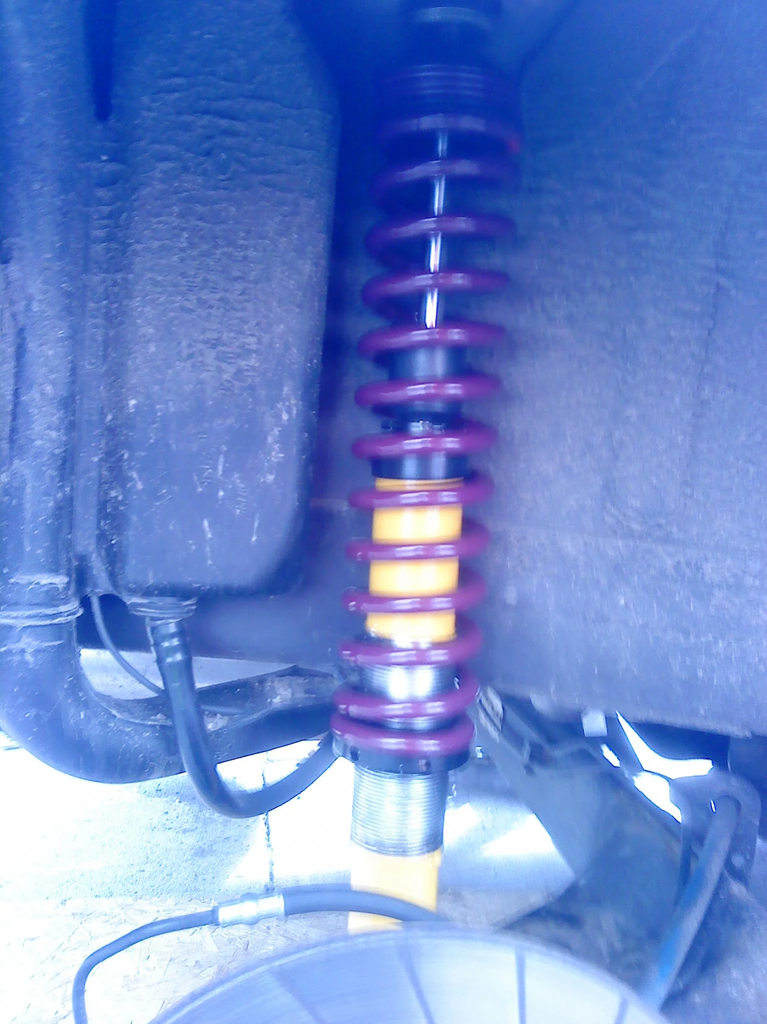

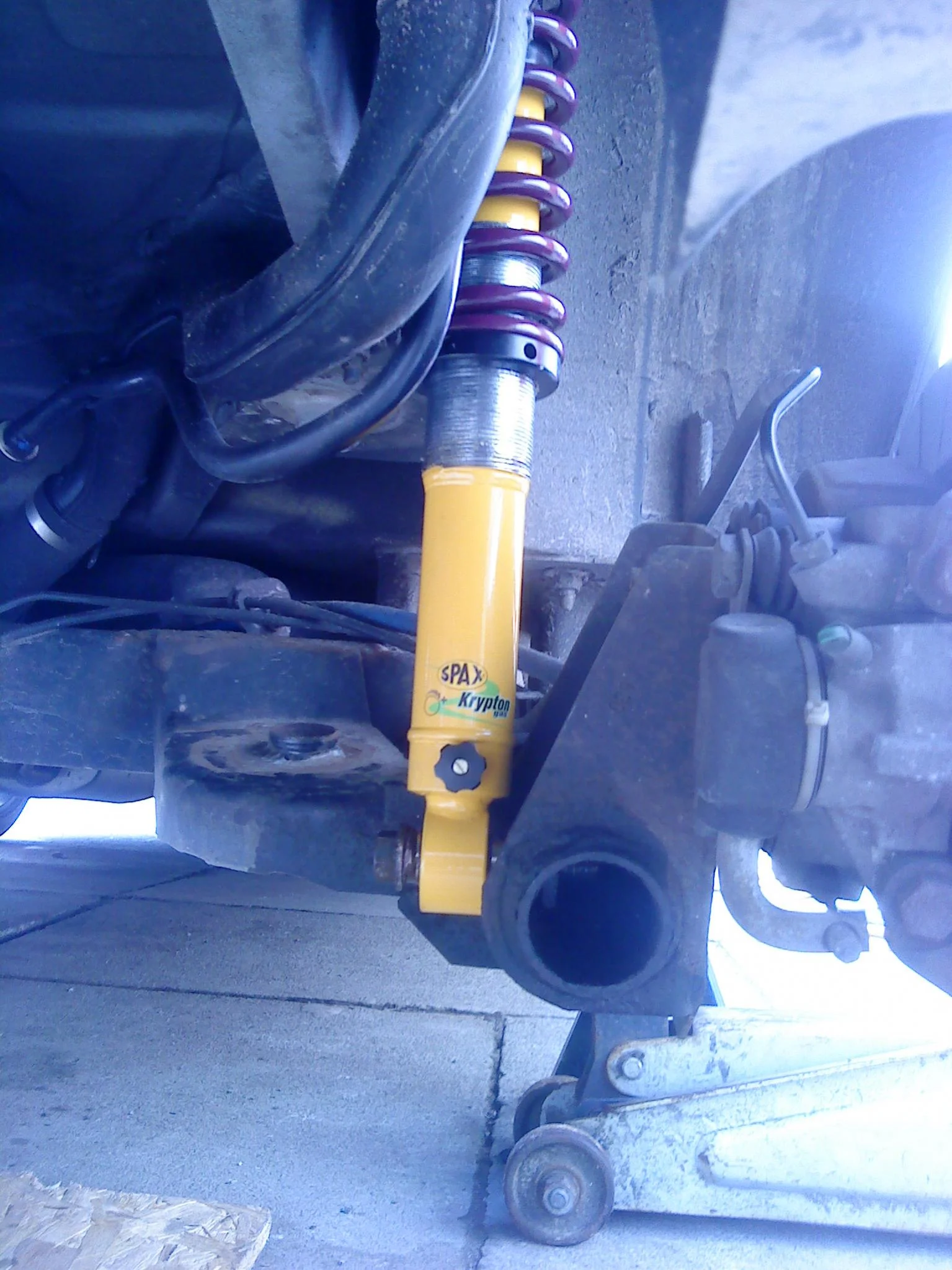

well i got around to fitting the spax rears today, and i must say what a ''MASSIVE'' improvment they are over the vmaxx ,
its great to just drive the clio without hearing and feeling knocking+banging.
ive not sat them as low as the vmaxx were , i'm gonna tweek them up abit tomorrow, so it'll have the same stance,
but yes i'm really happy with these, the clio is so good and quite to drive now,

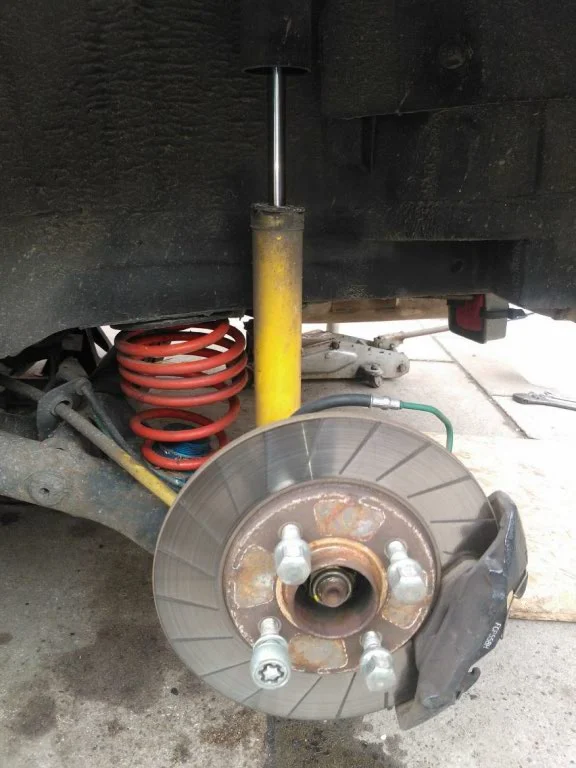

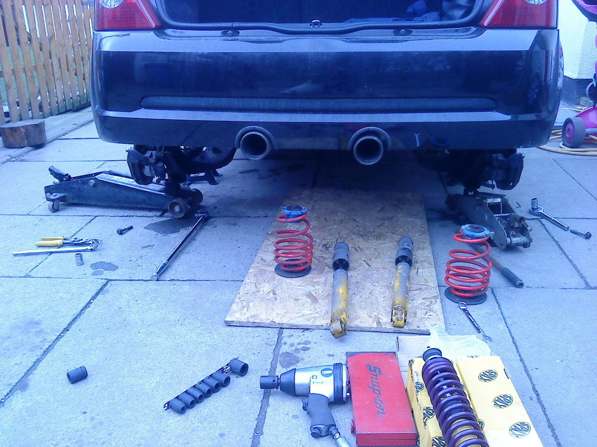

exhaust rubbers upgraded (14).jpg View attachment 73788 exhaust rubbers upgraded (7).jpg exhaust rubbers upgraded (8).jpg exhaust rubbers upgraded (13).jpg
View attachment 73791 exhaust rubbers upgraded (9).jpg just a few pici's taking the rear vmaxx off, and i few picis of the old girl on the bench, and would like to say thanks to danny(519automotive) for the rear spax,will be getting front set soon mate.
