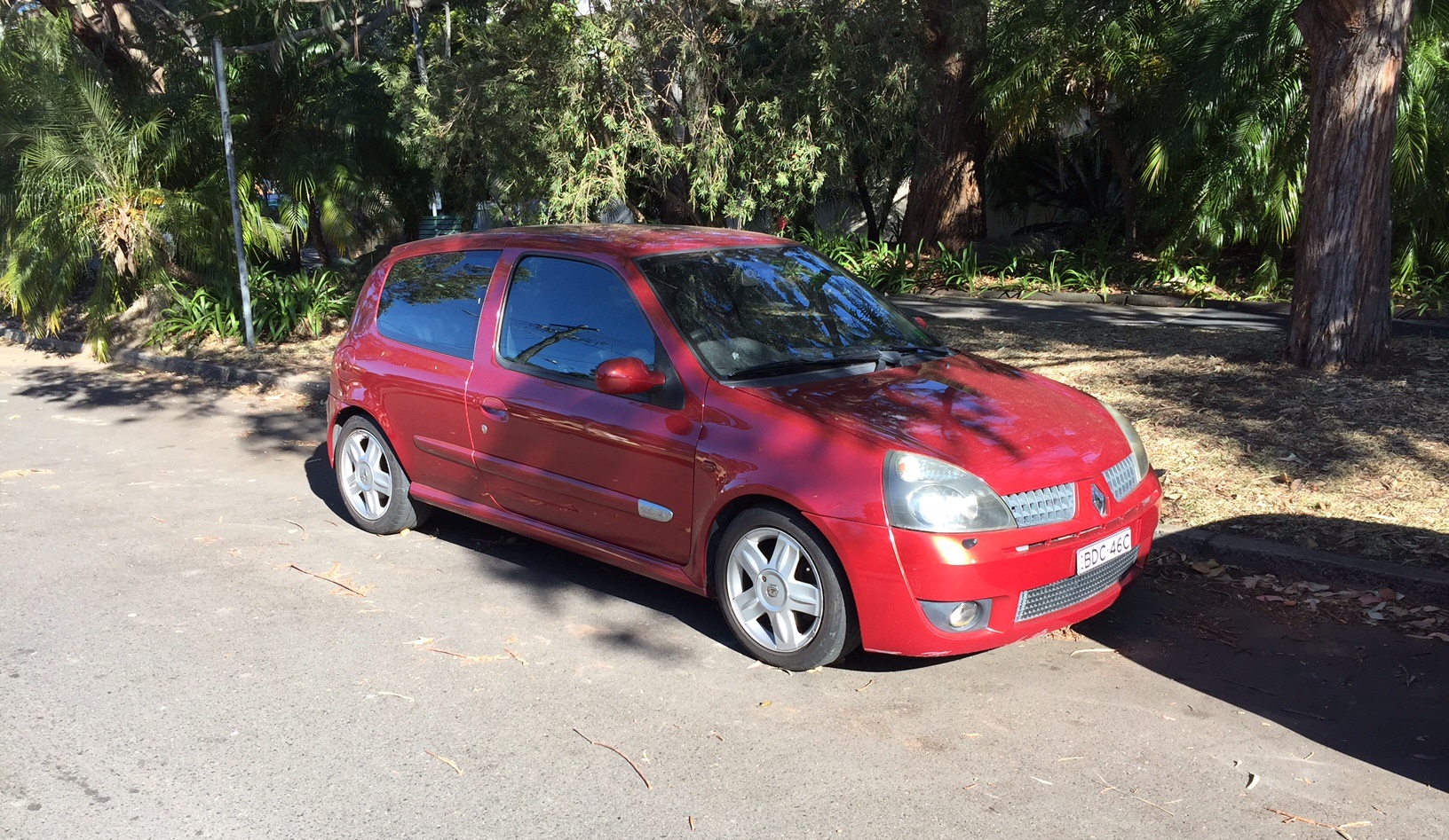

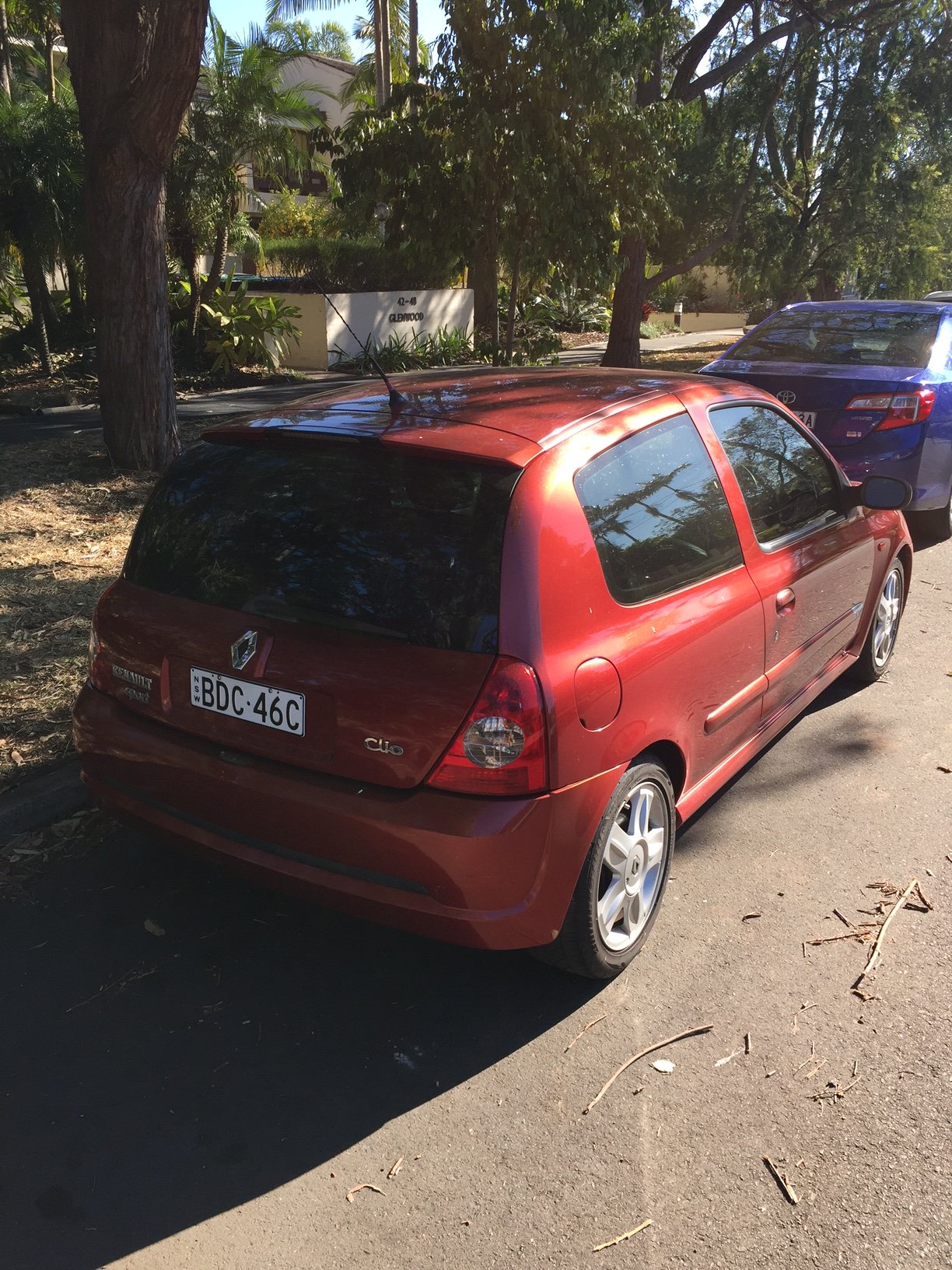

Pics of the car:

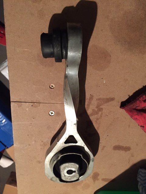

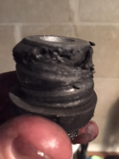

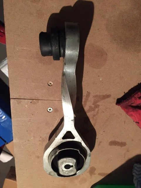

Today I did my first mod, dogbone bushes. I'm glad I did considering the state of the original:
The smaller bush was toast!

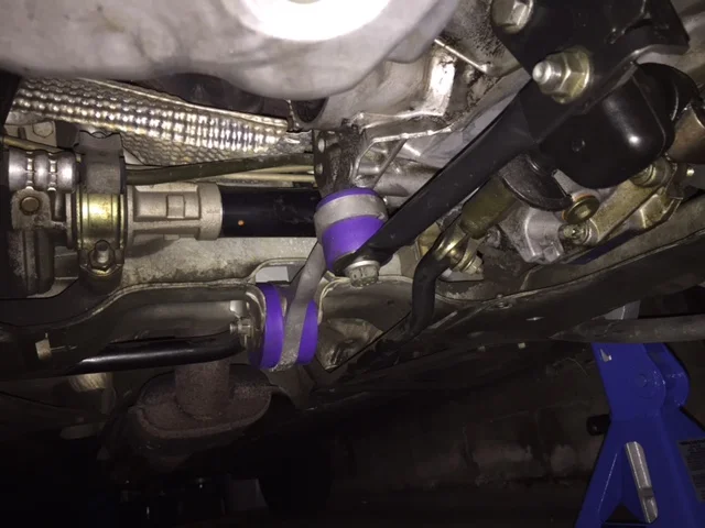

Nice new powerflex goodies:
The gear linkage all feels pretty solid so nothing needed there. I want to do the steering rack bushes at some point but it looks like the sticker is long gone, does this look like an SMI rack to anyone?

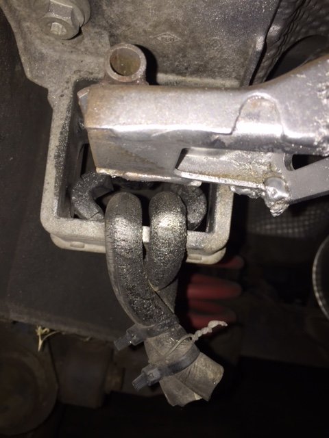

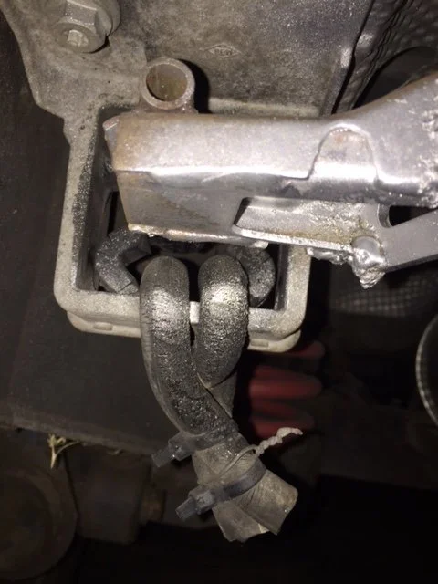

I had a new cat back exhaust made since the original had rusted through, the mechanic said the rear muffler sounded like a maraca, lol!
I had a look at his handy work today for the first time and I did have a good laugh when I saw how he "fixed" the rear muffler mount:
Just a bit of rubber hose wrapped around a couple of times and cable tied together!
The original bush is completely collapsed (I'm holding the muffler up in the pic), never mind Powerflex will come to the rescue!

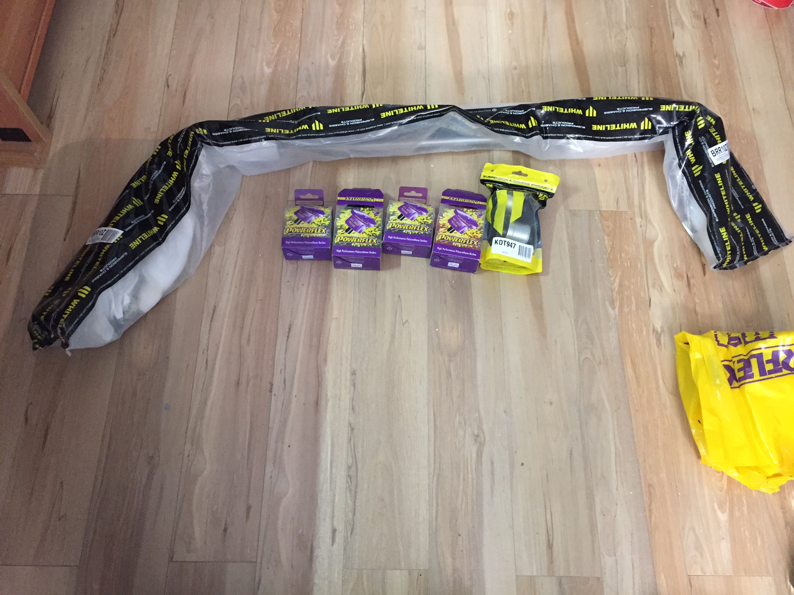

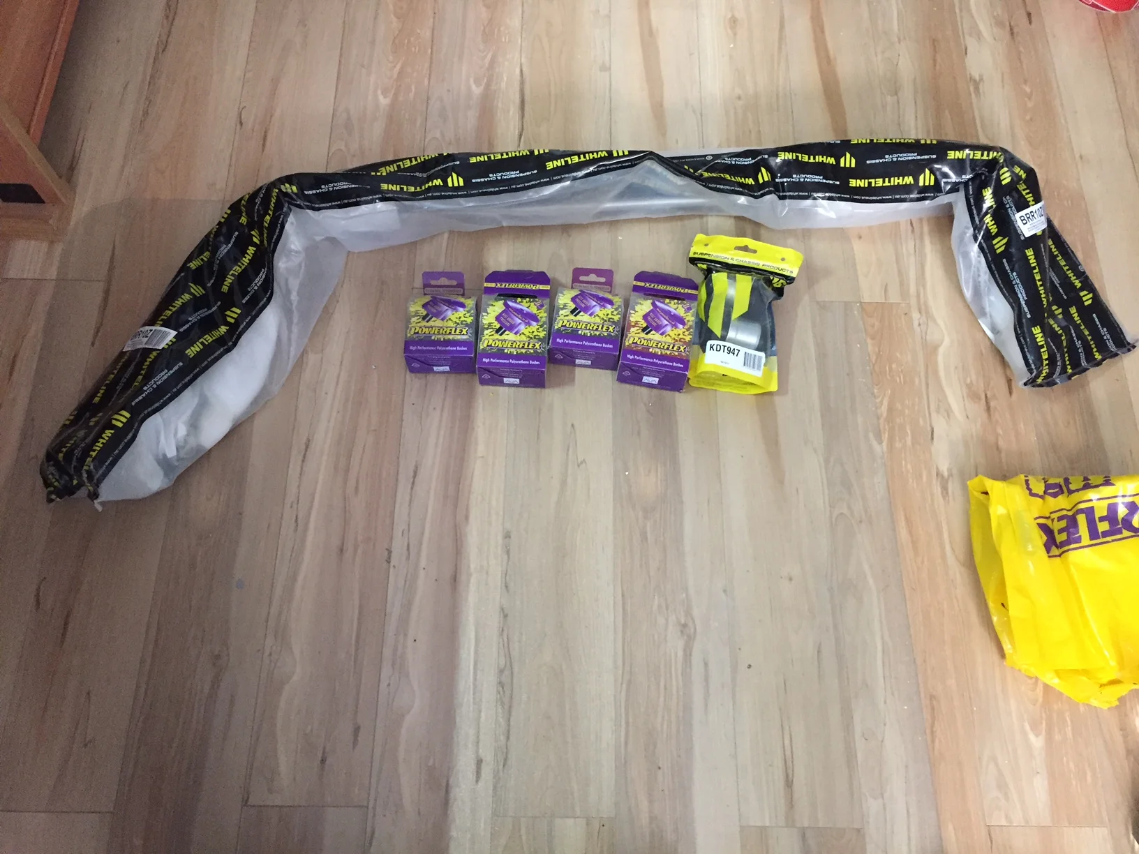

Postman Pat delivered some goodies today!
Whiteline swaybar & beam bushes.
Powerflex front ARB bushes (inner & outer), steering rack bushes and exhaust hanger bush.
Excited to get this lot onto the car!

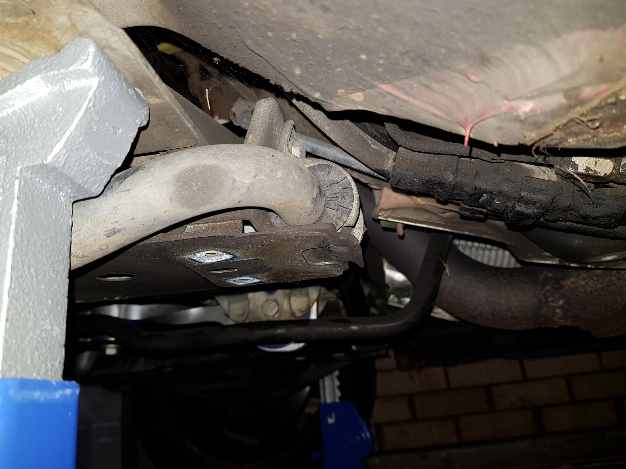

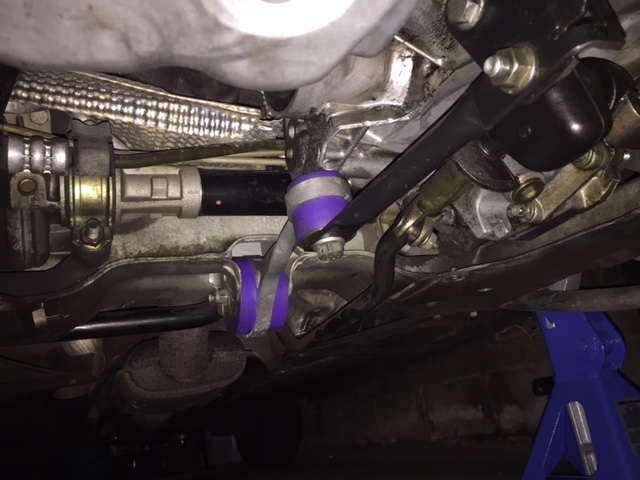

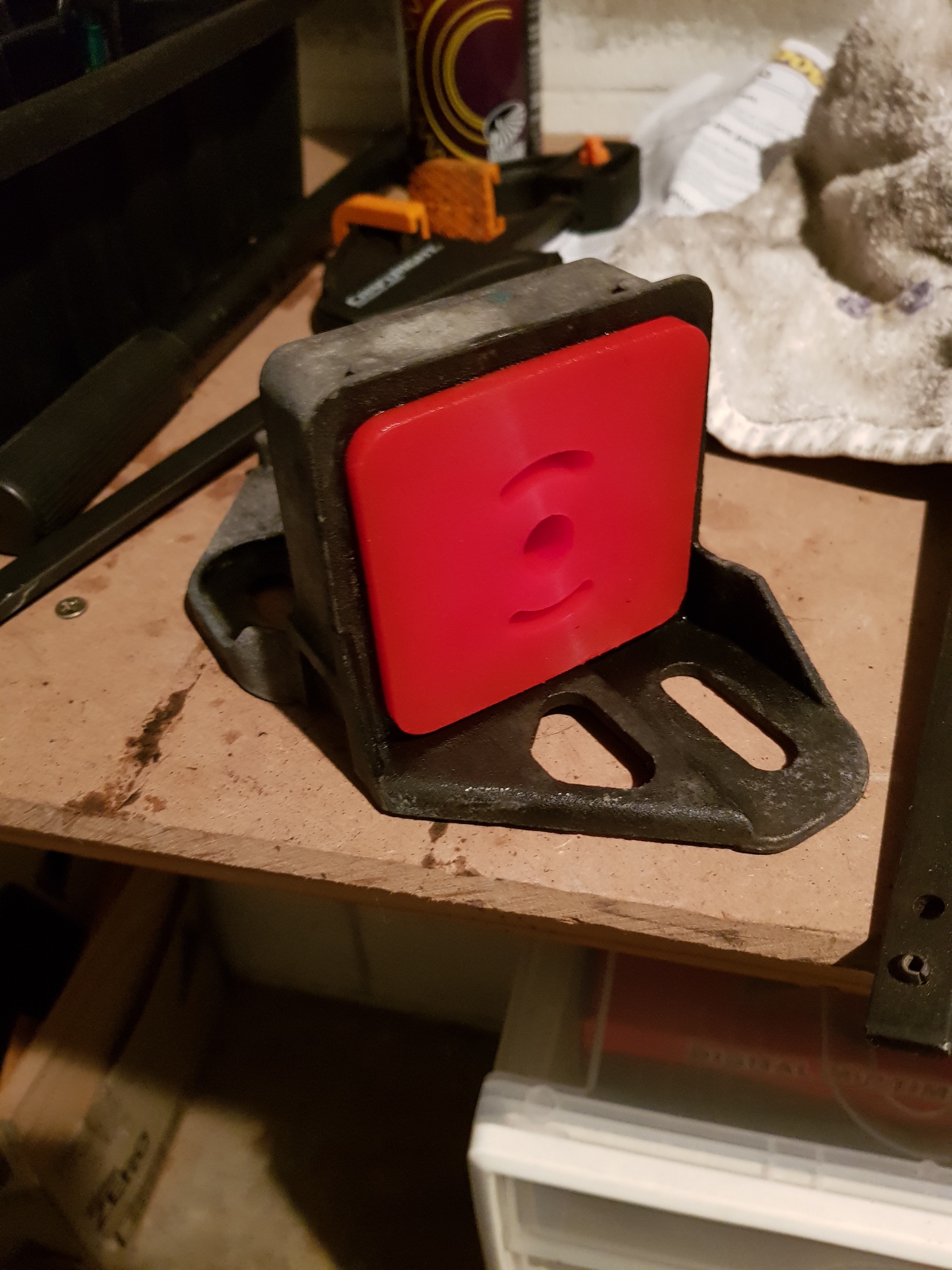

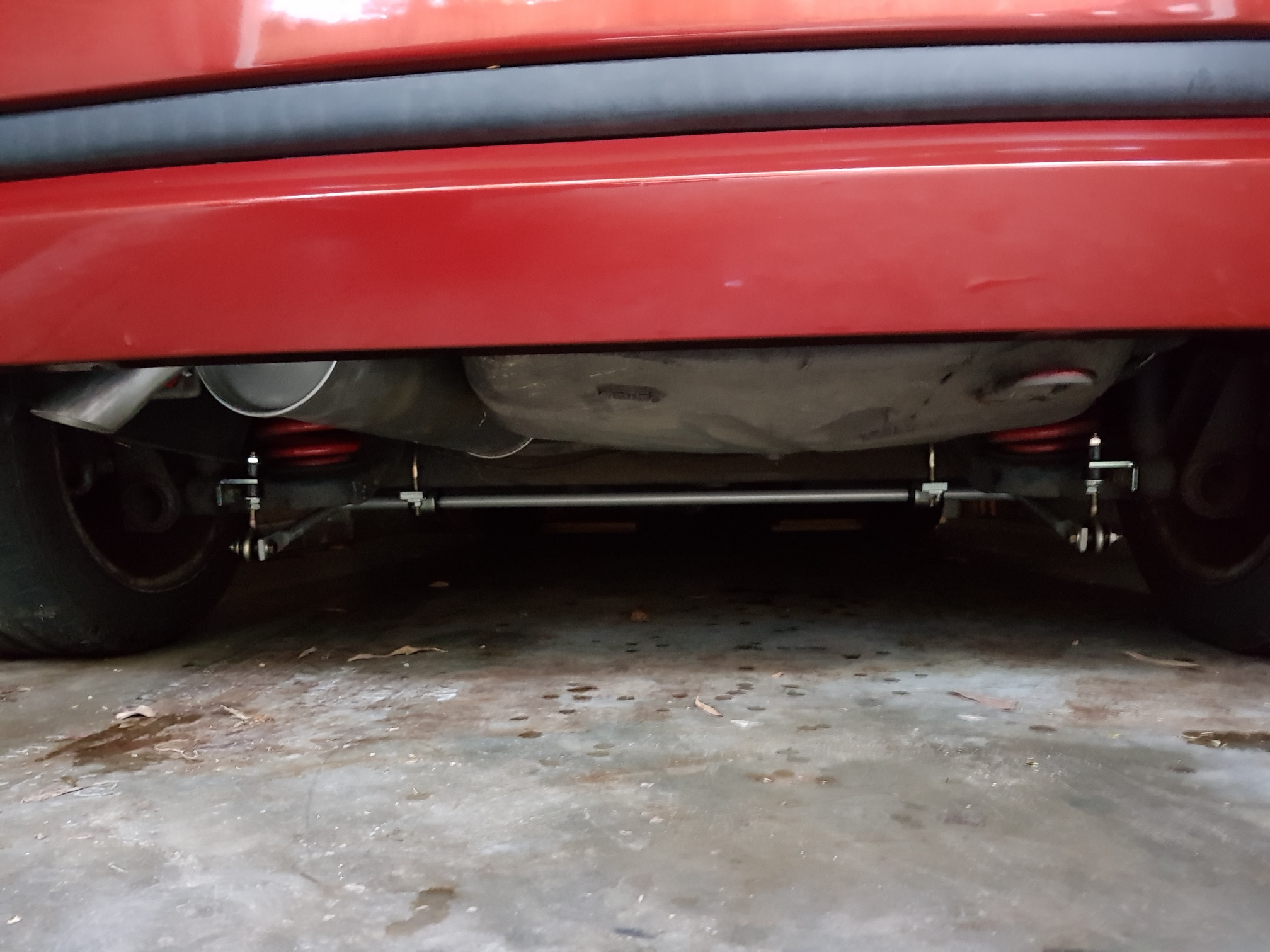

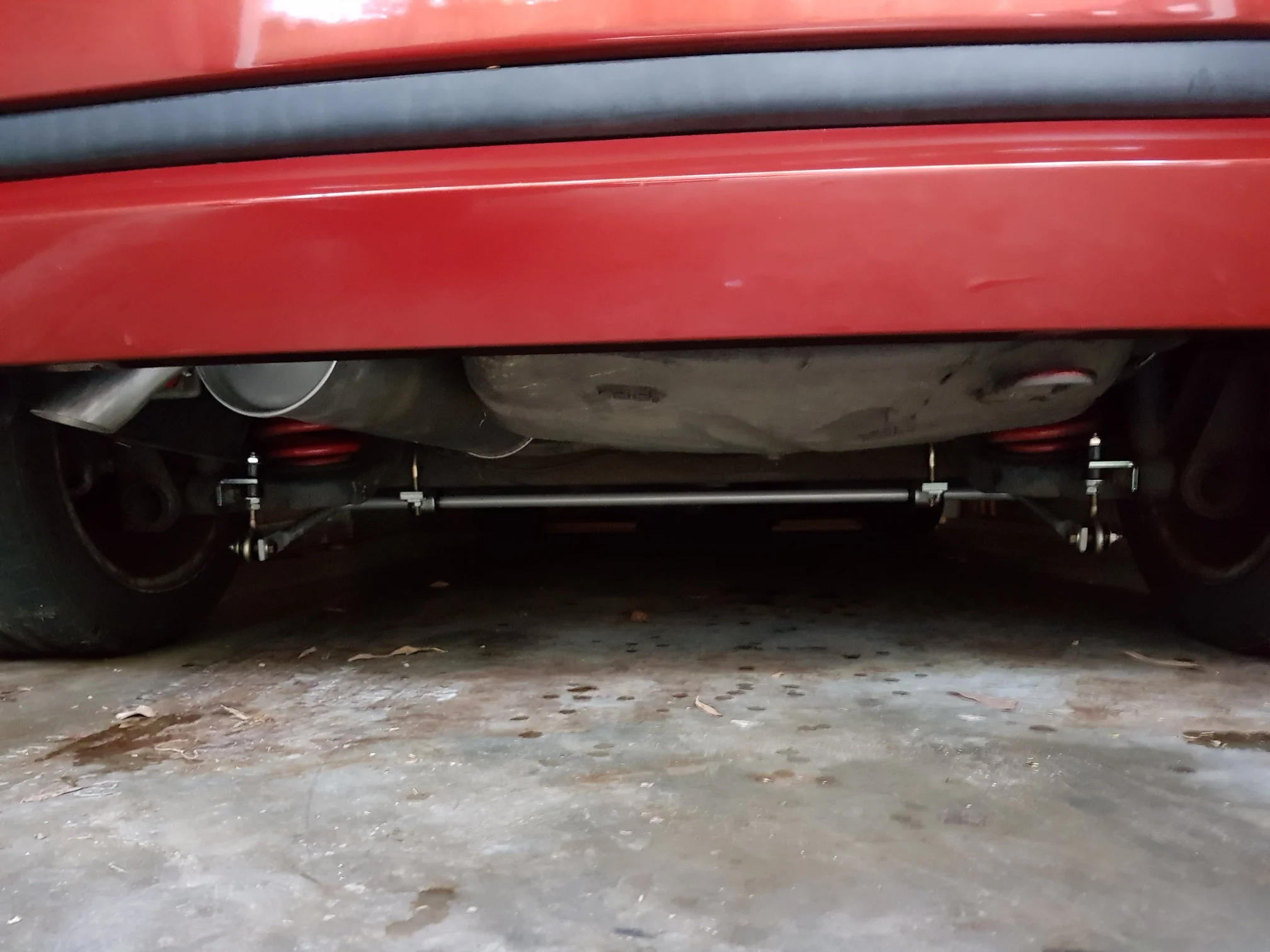

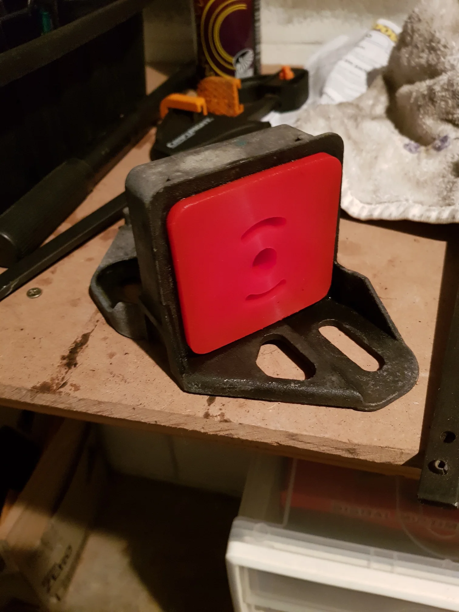

Put the car up on stands on the weekend and fitted a few goodies. Firstly these two were fitted on Saturday:
Did attempt to replace the rear beam bushes but after wrestling with the beam bolts (drivers side won't come out because of the fuel tank) I decided the whole beam really needs to come out of the car to change them which also means disconnecting brakes, a job for another day.
Drove it a little after this and the difference was quite amazing! Definitely corners flatter and the front holds line much better!

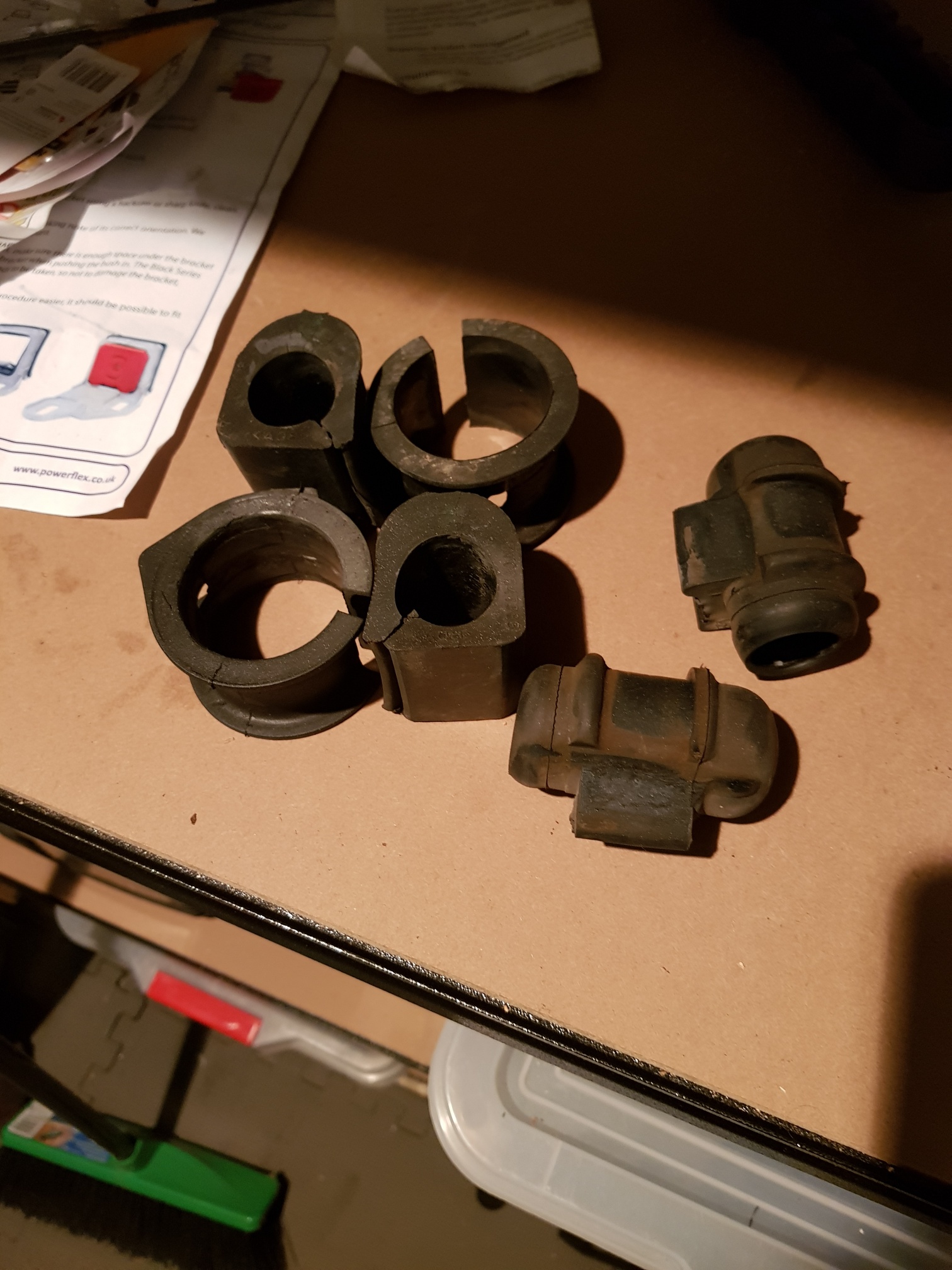

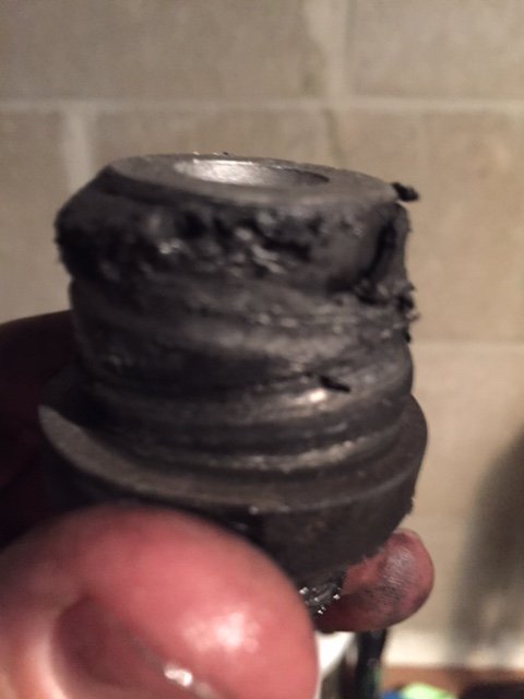

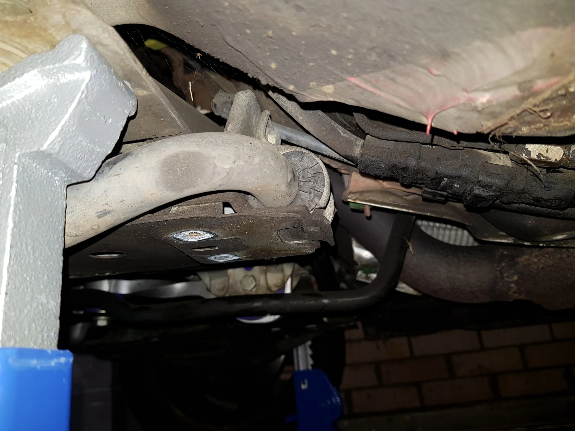

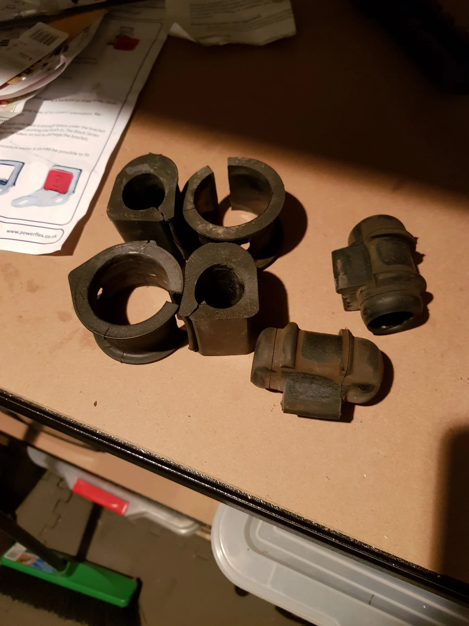

Sunday the car was back in the air to replace these guys:
The swaybar bushes were starting to crack:
All I can say is what an absolute ball ache!!! Spent about 8 hours under the car with very minimal clearance to move ratchets and spanners for the steering rack and super human strength needed to get the swaybar brackets back on! Renault really did not design these things to be changed with the subframe still in the car. But I got there in the end, no pics of that since my hands were black as anything and I really didn't want to handle my phone.
I did notice significant oil on the under tray. The bigger patch was on the gearbox side which is guess is the normal shift selector leak. There was also a decent amount on the other side of the tray, seems to be coming from where the sump bolts on to the block and is dripping down over the drivers side axle where it meets the gearbox. I'll try to get some pics of this but is this kind of oil leak normal?
Next job will be gearbox oil and spark plugs!
