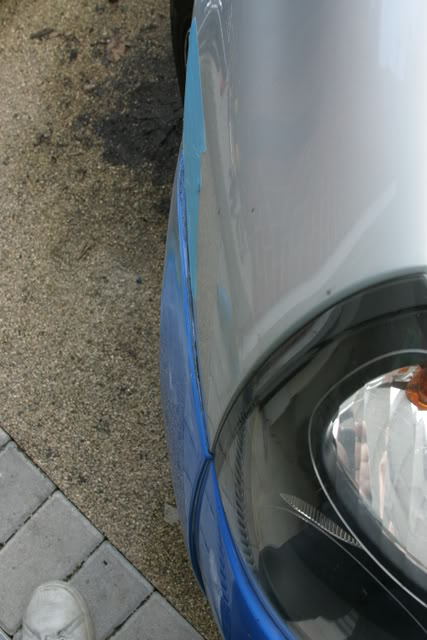

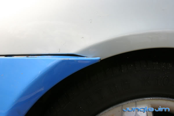

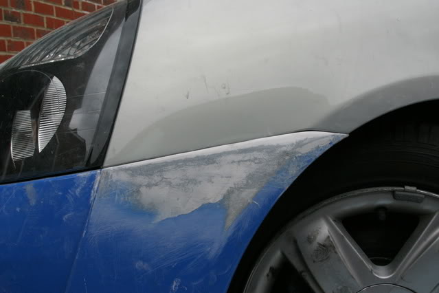

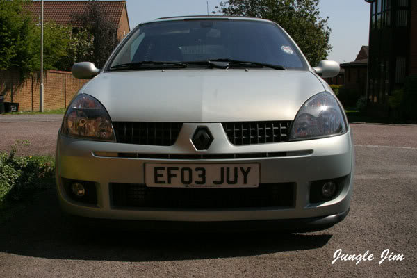

the other option is to modify the 172 front bumper to fit the standard wings mate, and then it means you can get replica sideskirts which are only £60 new. its what i am doing
  Stagecoach Ticket
looks mint m8 , iam good freinds with a body shop owner is it just a case of cutting and a little filler?
  1.2 Dynamique billabong

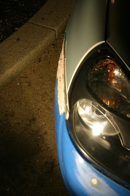

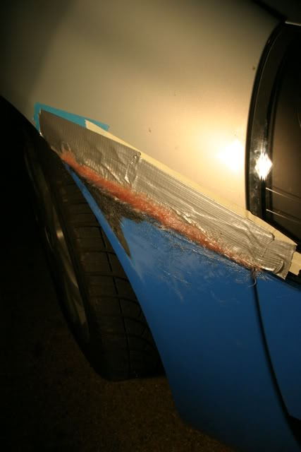

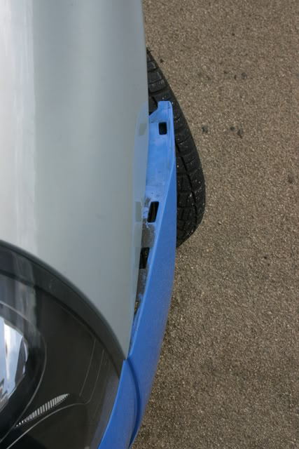

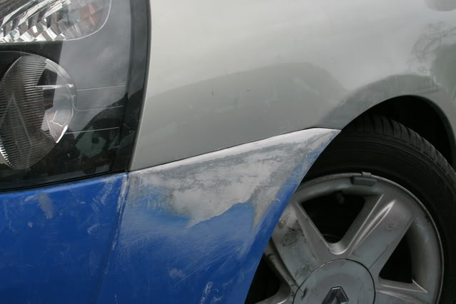

first you have to sand a load off the corner of the bumper then modify the bumper brackets to pull it in further, then you need to apply fibreglass to fill the gap and smooth it out with filler
before adjusting bumper brackets
after adjustment

cheers guys, yup i did all the work myself including painting it. i used p40 fibreglass mix and then p38 filler on top mate both are available from halfords
i cant really do it on another car as it involves taking the bumper on and off about 10 times to check the fit, have a go yourself mate its not that hard to do
