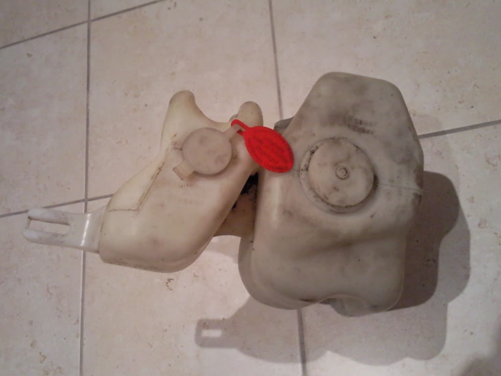

What im planing to use for my charge cooler + header tank:

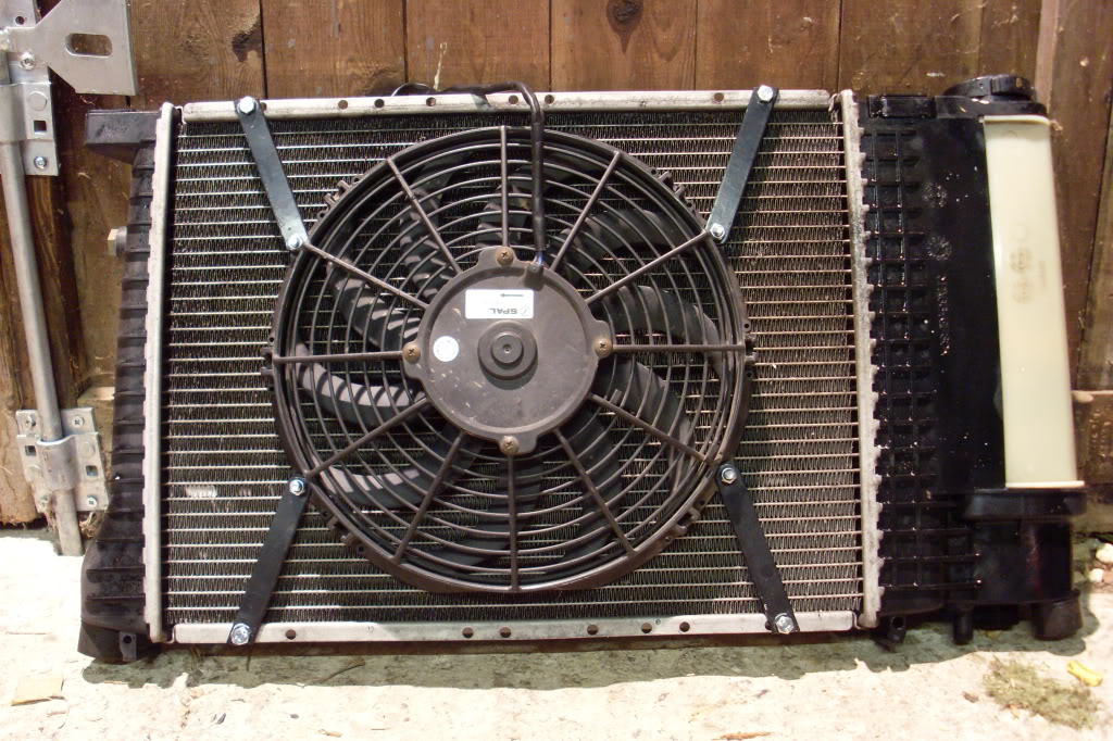

I got a bargain 11inch electric Spal fan from my local scrap yard for £5 and it works :D

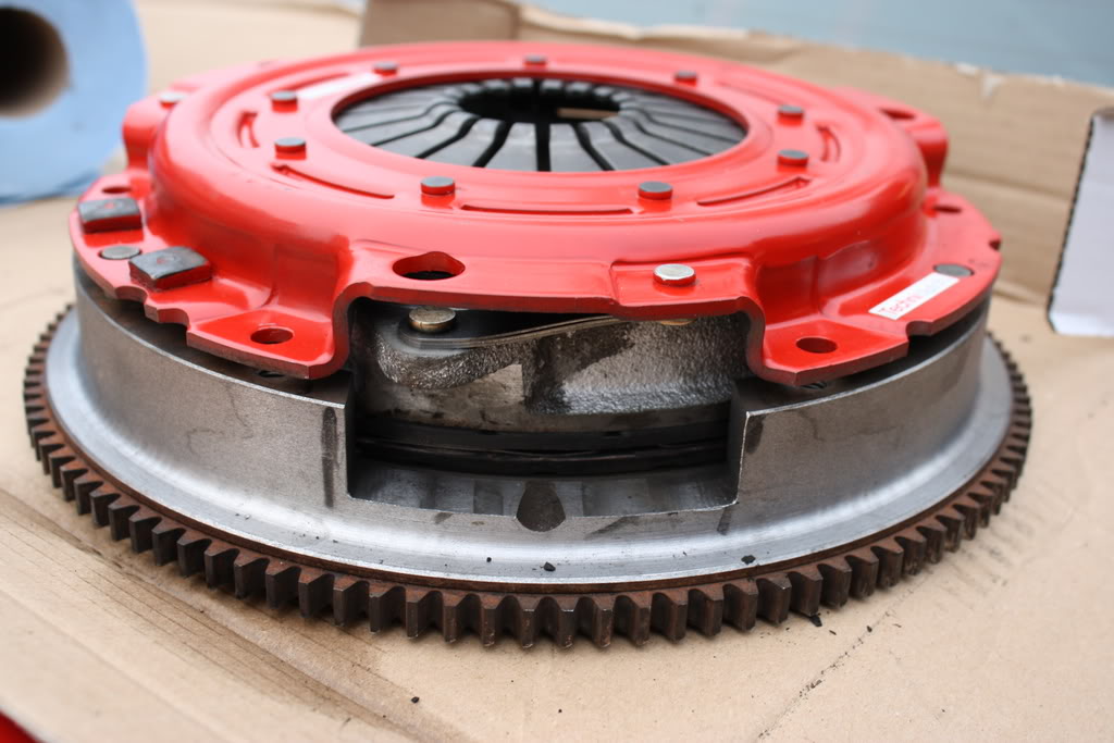

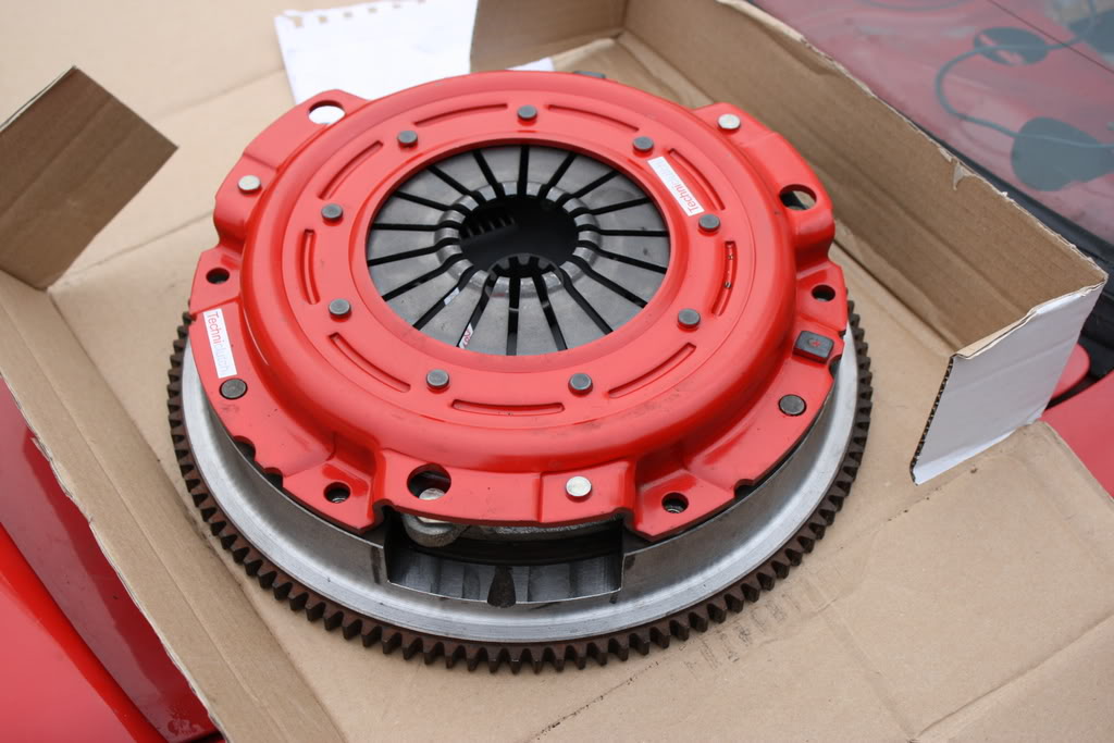

Next month I'll be ugrading the clutch to an organic stage one set up, fitting Powerflex bushes to the front end (already has rears) and getting more bits for the cooling like electric fans and water pumps.

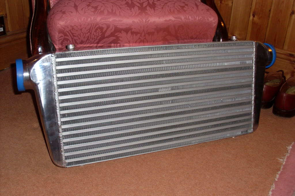

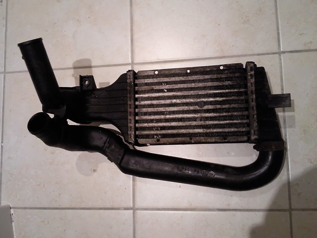

Are you really going to use that intercooler (and it is an intercooler not a charge cooler)
Pretty sure you could pick up something better dead cheap.
  E30 318iS x2
The cooler was cheap any way and just a little dirty not bashed in and doesn't leak, so going to see what I can do with it for now or just bung it in the back of the garage lol.

How about clutch :)
  E90
well mine is standard clutch, I'd say with that power and if you have the money I'd lash out some money on a good one, quaife lsd would be good too, and if your budgets endless a lightened flywheel too, std 318is flywheel is a heavy mofo, 325 one is alot lighter and fits when modified but a custom one if about 700 usd I think. Makes the world of differnce to accelleration. I have a 4,27 lsd on mine from a 316, hits the limter in top, but makes it go like a fcuker LOL

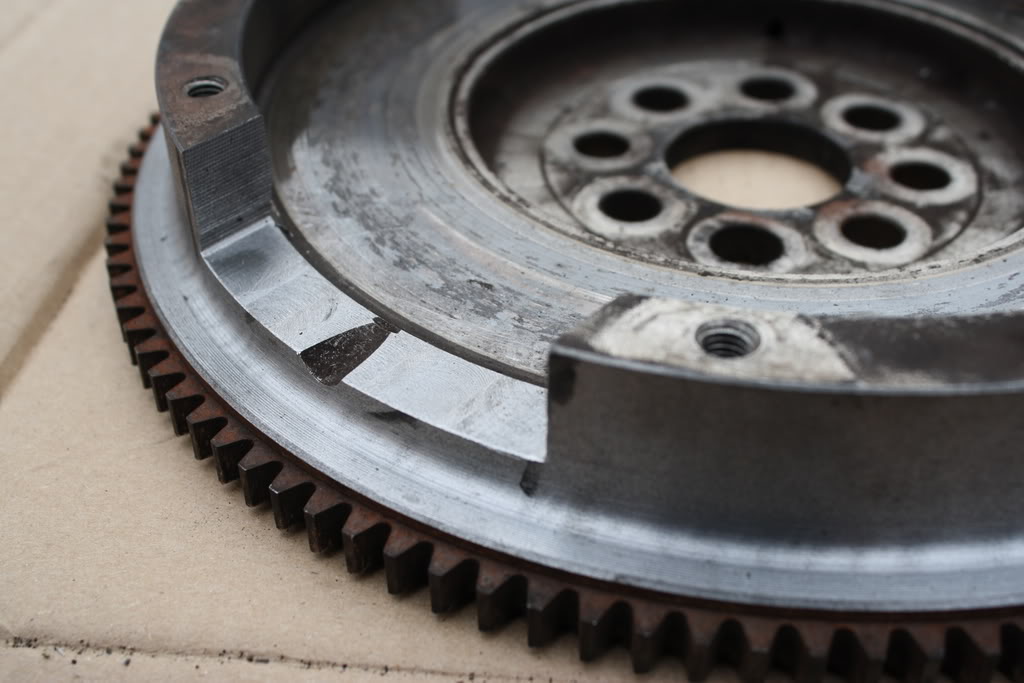

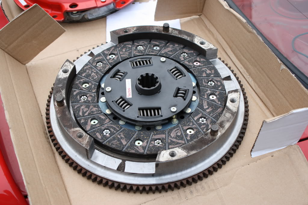

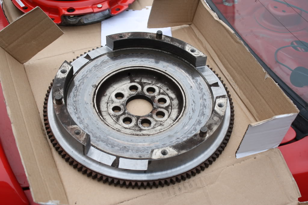

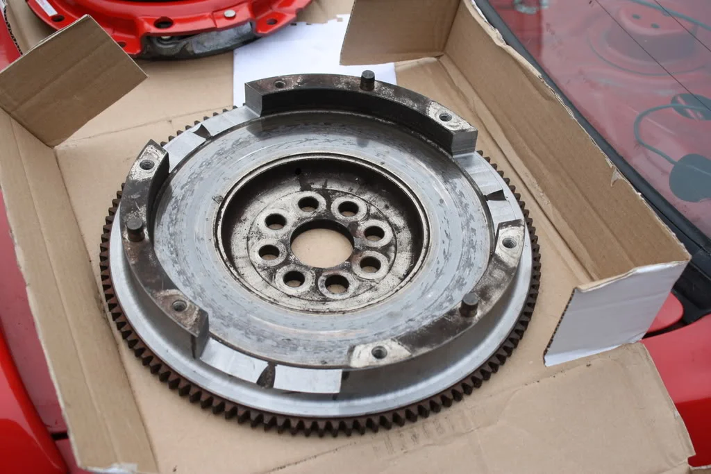

Had my fly wheel machined down to save some weight:
20mm was skimmed off of the diameter with 1 or 2mm left at the bottum to retain some strength on the ring gear. The side walls were cut down to 1mm above the face of the wheel.
The machining cost me £40 and I've yet to get a quote for getting it rebalanced.
The wheel before machining was just over 12.5 kilos. Plonked it on the scales today and it now weights 9 kilos which I'm pretty chuffed with in regards with how much it has cost. It'll also help the cooling of the clutch as it'll be getting pretty hot under competition conditions.

Also doing an electric fan conversion. Got a new rad from ebay for £5 and it was in perfect nik. Quite on the handy side it came with a threaded boss which meant I could the OEM BMW temperature switch to switch the fan.

Will you be running a dual TB set up? A lot of throttle'd volume with that cooler.
  E30 318iS x2
The cooler was puchased from ebay but I am going to sell it if any ones interested as I'm wanting a shorter longer one now for various reasons £80 plus postage :).

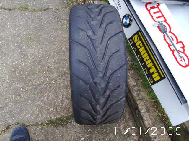

Swapping the 14inch wheels for some 15inch ones and got some toyo R888's:

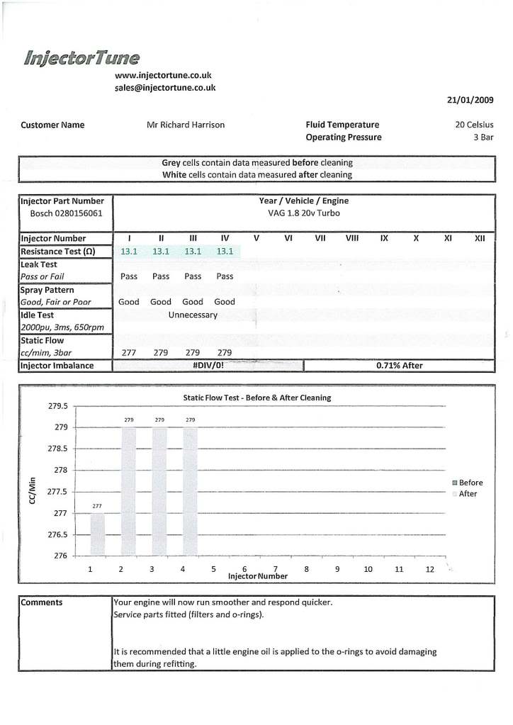

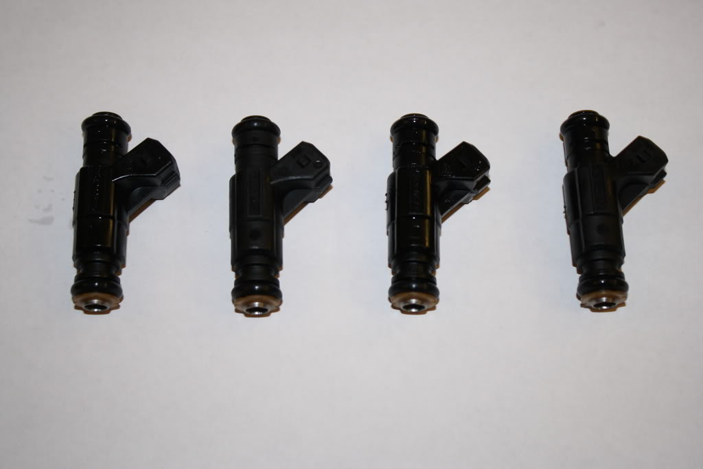

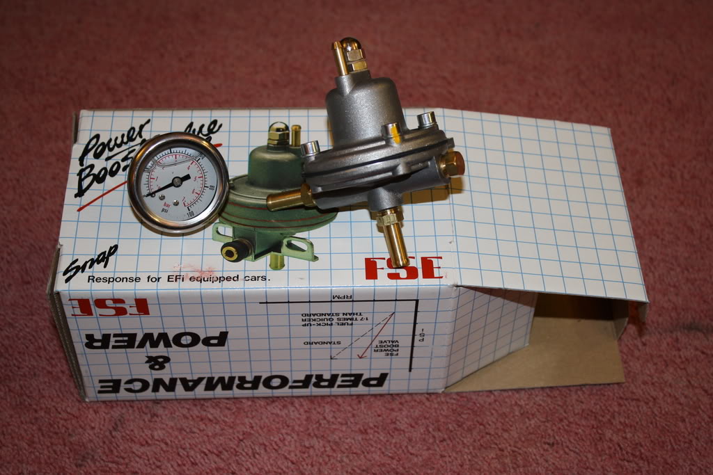

I've got some injectors from an Audi TT Turbo good for 225BHP. Flow rate is 279cc/min @ 3bar, I had them ultrasonicaly cleaned and reconditioned :)
Test result sheet:
Also got an FSE adjustable regulator and also a gauge for setup.

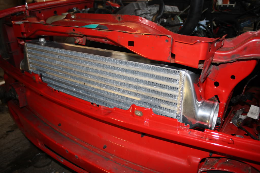

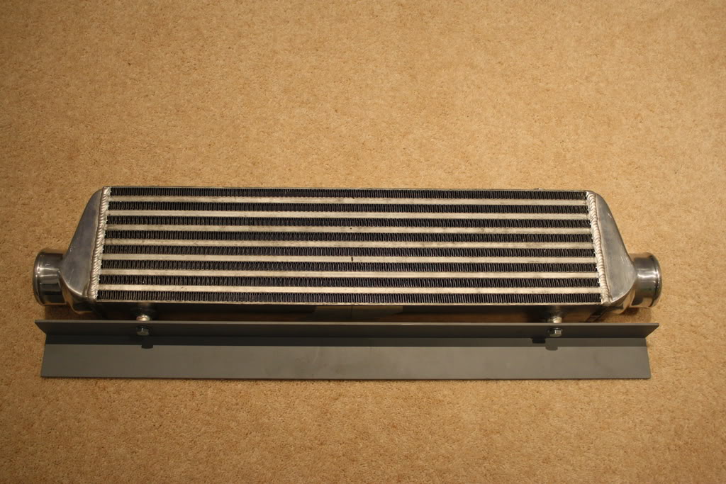

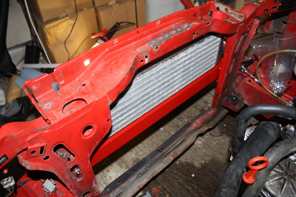

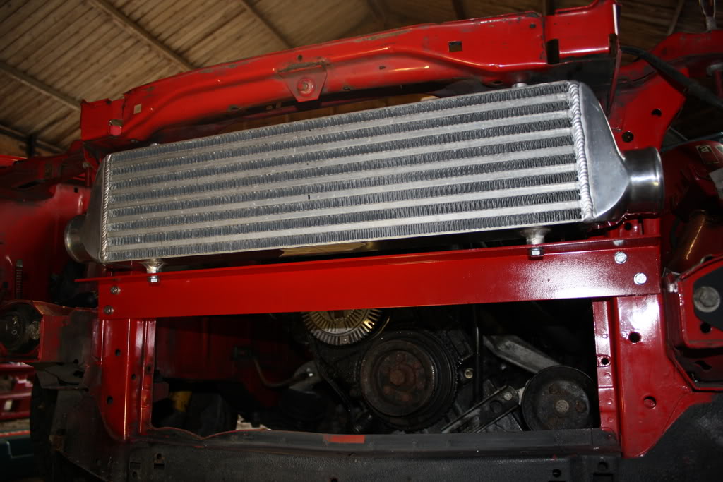

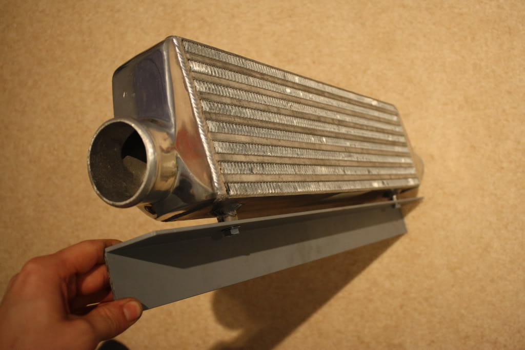

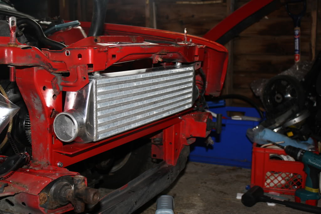

Had a pretty good day today, the main aim was just to get the interooler bolted in and very happy with how it worked:
New cooler
Simple L shaped bracket to bolt onto the chassis

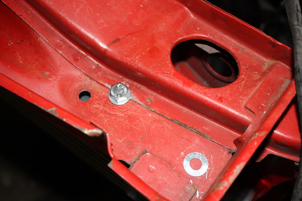

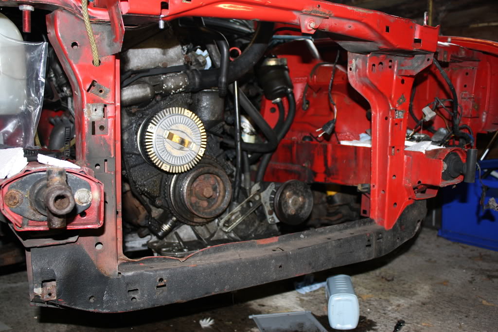

Managed to get a stuck bolt out and removed the front end

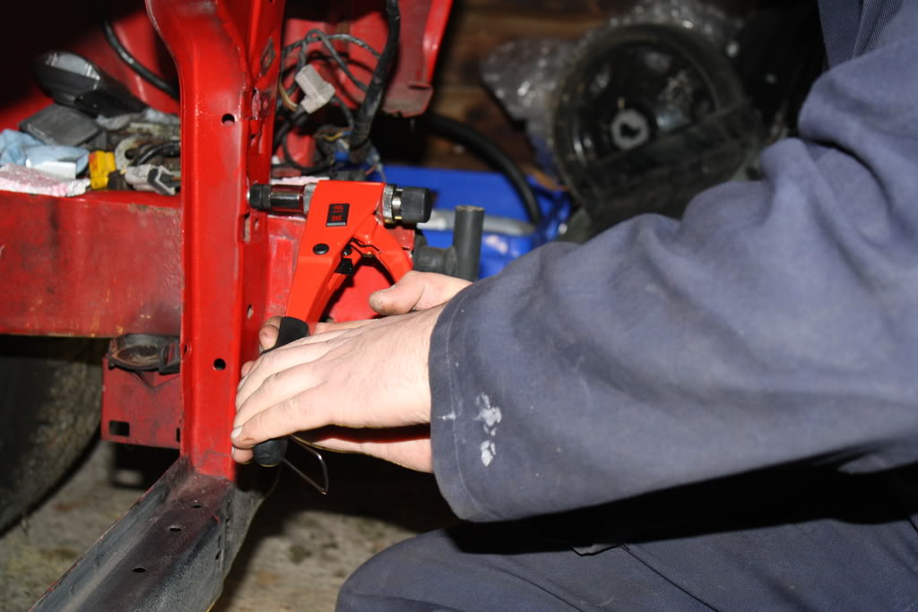

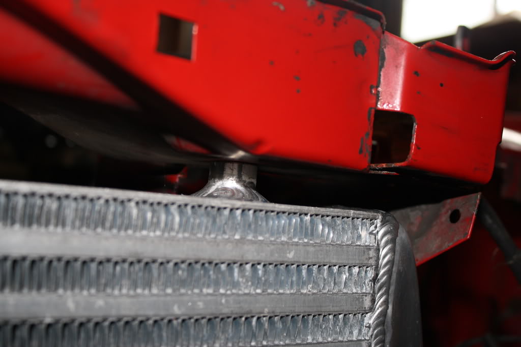

Bolted the cooler to the bracket, offered it up and checked it with a spirit level, then drilled holes for the Rivnuts to go into.
Checked it then drilled a second set of holes to make it secure and painted it brilliant red.
It was still abit wobly as expected so had to pretty much guesstimate where the top mount would line up with but got it smack on :) Put a bolt through it and now it's rock 'ard.
Put the front end back on althought will probably come off for a new one as the lower part is bend and out of shape where some one has probably driven it into a kurb.
Whats also really good it my fan and radiator setup fits in perfectly behind it so nice neat little arrangement for cooling. I will need to trim some small bits out of the bumper to allow for the hoses to clear it but appart from that it's brilliant.

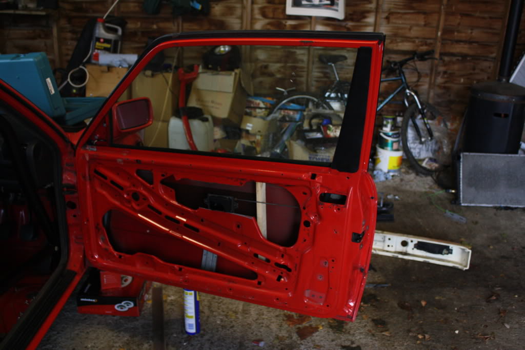

I also took the ali door cards off and to my shock I found the windows where held up with two bits of wood :eek:
I had been planning to fit some manual window mechanisms so bought a set of them but was a bit worried that the center sections of the doors had been removed previously for weight saving, thankfuly when I got the cards off the middles where still in so that saved me a job (althought the handle parts were removed to add to the door cards).
