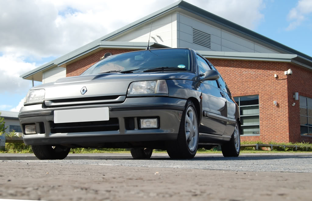

I posted a few pics the other week, but thought I would start a thread on this in here...!

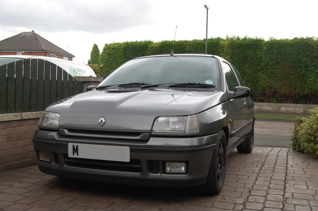

Fancied another clio (6th one now) to tinkle with and for some fun, but also a sleeper/weapon on the road/track.
Was looking to possibly buy some crazy tuned up/engine converted car, or even a westfield or similar, but then thought why not get another clio, seen as I know them inside out (ish) and get back in the Renault game!
Anyway found this clio 16v, which was in surprisingly in VGC condition. No rusty arches (on original arches too AFAIK), wax oiled underneath from new by the looks, lots of wax on the paint, very tidy car and well worth the trip to Essex to collect it.

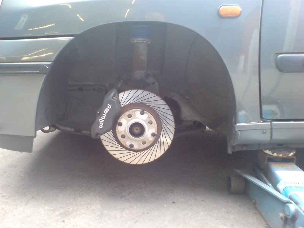

The added bonus was that it came with Willwood 4 pots, and FK coilovers which I was planning on purchasing anyway!
As you can see it came with some M3 style mirrors, which actually don't look 'that' bad, but not my thing, a horrid fake CF and chrome gear gator and surround which was removed straight away, and also factory leather interior.
Seems a shame to rip apart such a nice condition standard looking clio 16v....not many left really! Ah well, a 270bhp turbo charged, wide tracked clio sounds more fun to me!:evil:

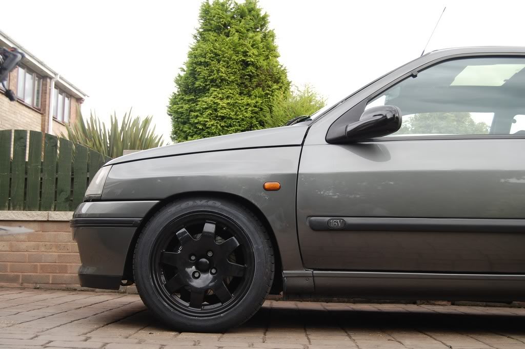

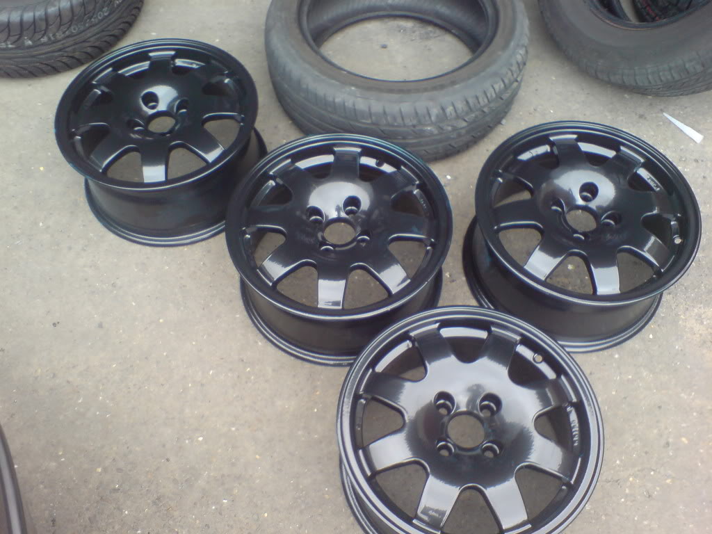

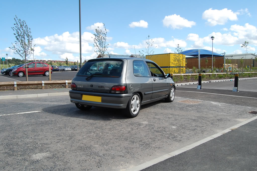

I was on the hunt for some williams alloys. I like the standard 16v ones, but not really keen enough to keep them on.
Figured black and grey would look well together so managed to pick up a set on ebay local, and took them for powdercoating. ( I asked for satin but they look a bit shiny...they have dulled a bit since though)

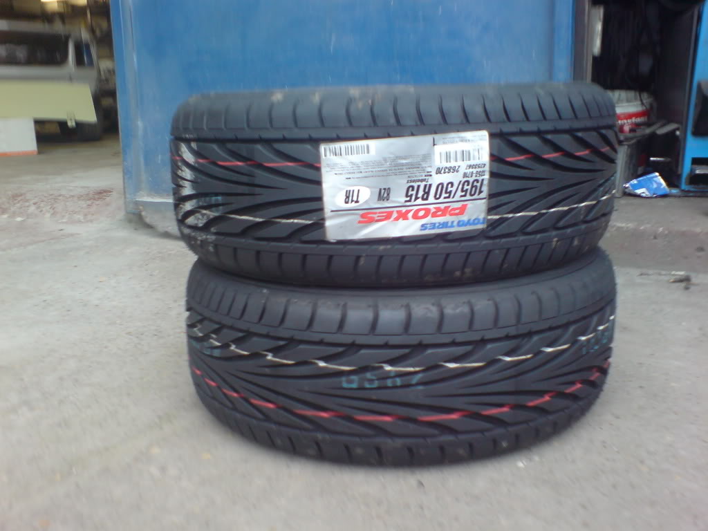

Needed fresh rubber, and was tempted with some R888's, but went for Toyo T1-R's for now.
Probably should have left wheels to the last, but i've always been impatient! lol

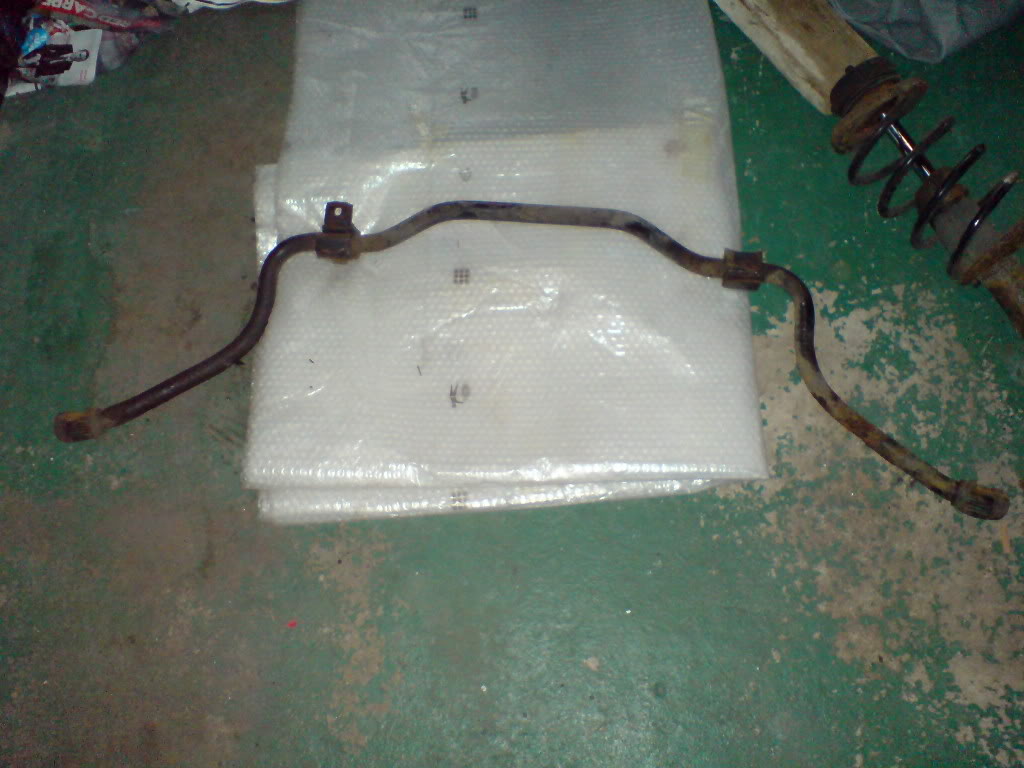

Next I was itching to get them mirrors off and sort a few niggly bits out. Was also on the hunt for a few wide track parts for it.

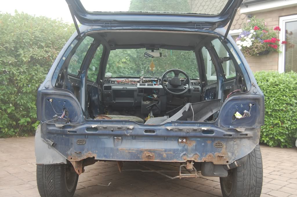

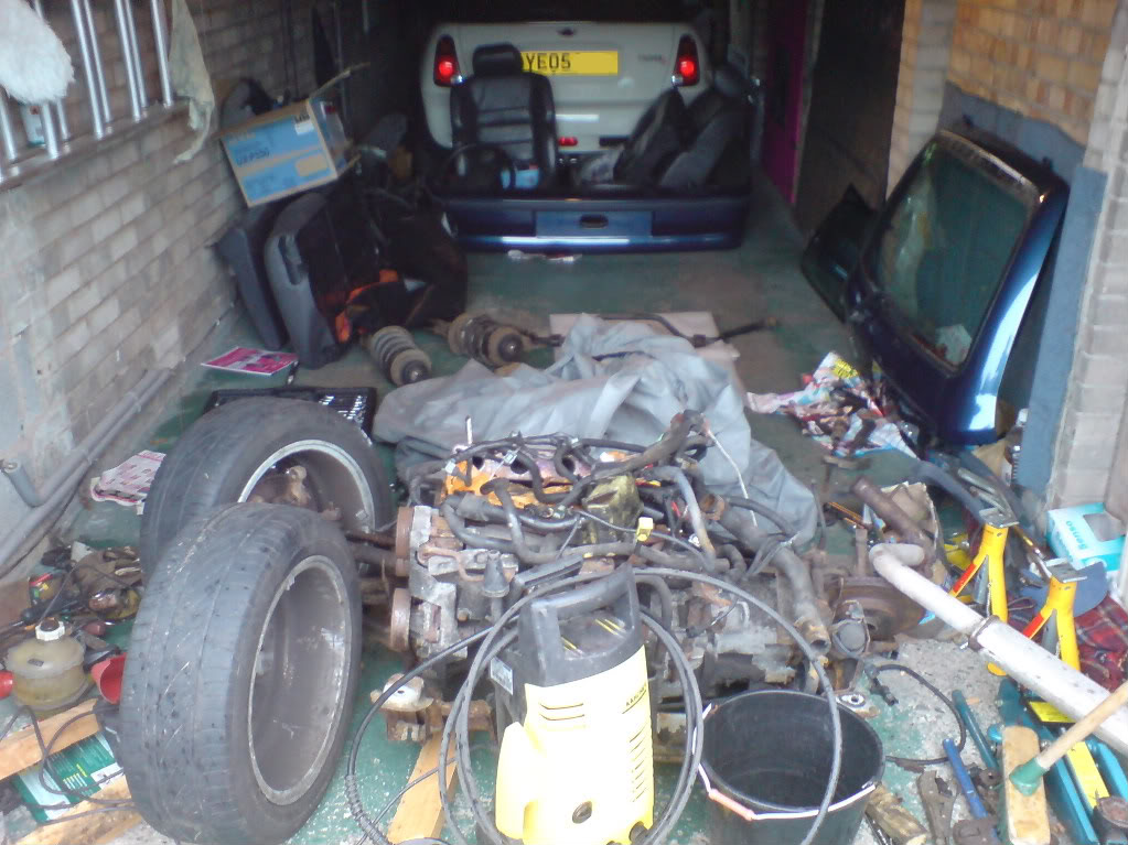

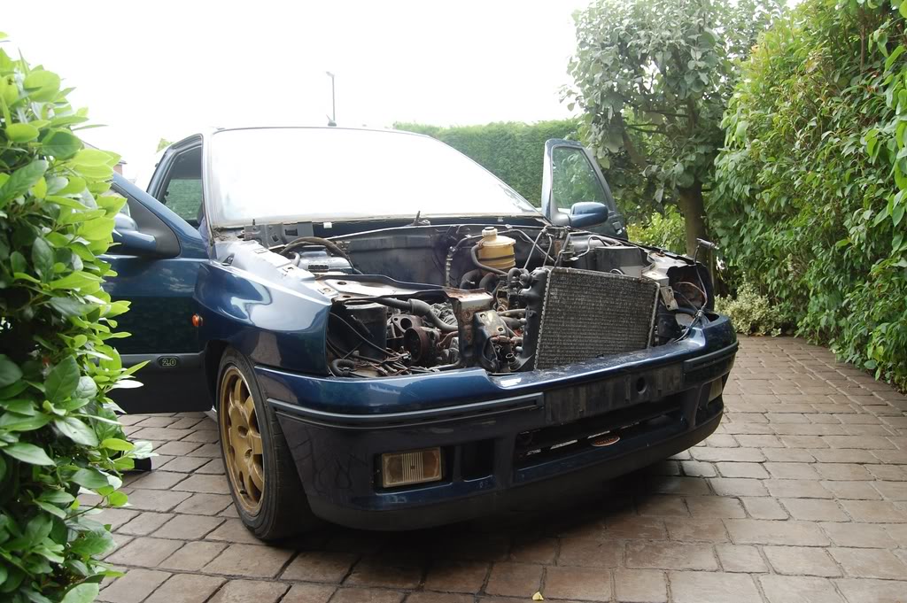

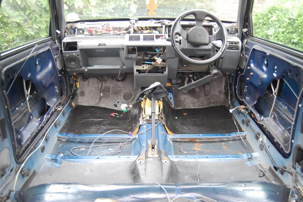

Purchased a williams with a friend and decided to break it for parts as it was a non runner, and had been stood for a while.
Spent 4 days stripping the whole thing ( parts still available ;) )
The shell has now gone, and my garage is solid with parts!
I've nicked a few parts for my car including wing mirrors (woohoo), ARB and driveshafts for the wide track, interior and a few other bits and pieces.
Williams ARB needs painting, and 19 wishones on order along with powerflex bushes etc.

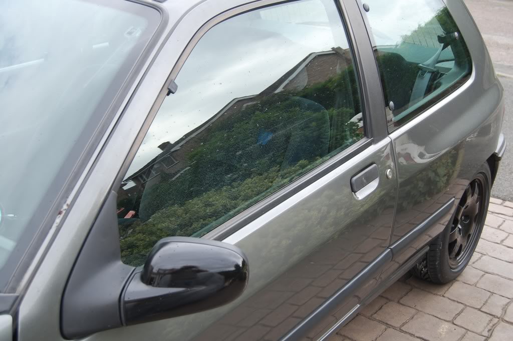

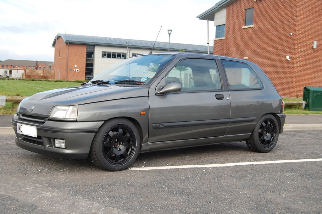

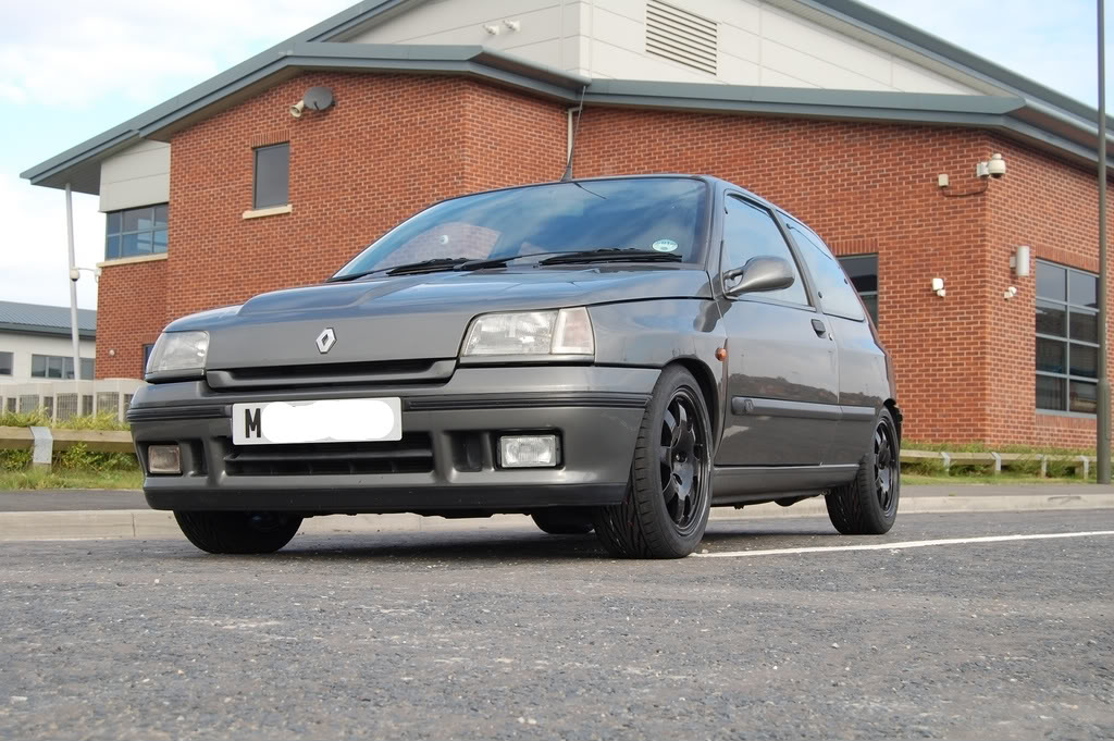

Once the Williams was gone, I painted the mirrors, and wheel centre caps, and got them on the car...Decided to match the wheels and do the mirrors black for something a bit different.

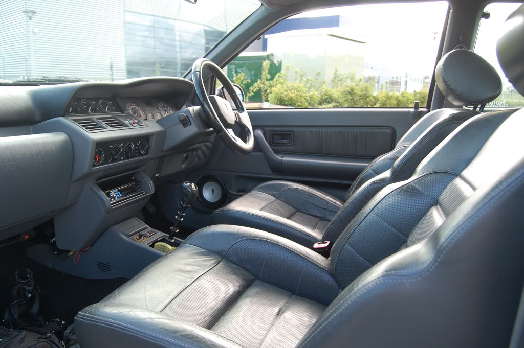

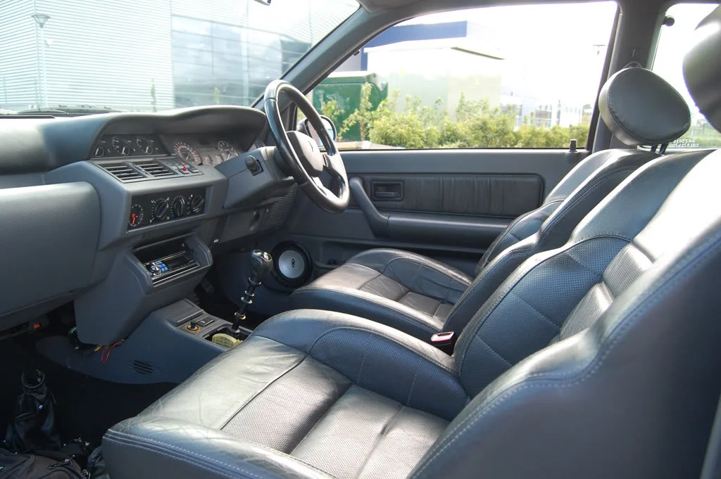

Also swapped the leathers for williams interior, which I know it aint a williams, but the interior is very comfy!
I am going to fit the williams spoiler also and paint that to match the mirrors and wheels.

Hopefully next week once these williams bits are gone and I have more room, the engine is being removed from the valver ready for the engine bay clean up and paint, and the new engine fitted with the custom mounts, etc. Watch this space!

Go back to the leathers. They suited the car better imho, and I prefer the way the look.

It looks wider because it has wheel spacers on at the mo...the standard 16v wheels didnt fit over the 4 pots so had to have spacers on...I wanted them off when trhe williams wheels were fitted (which do fit over them), but didnt have any shorter wheel bolts at the time!

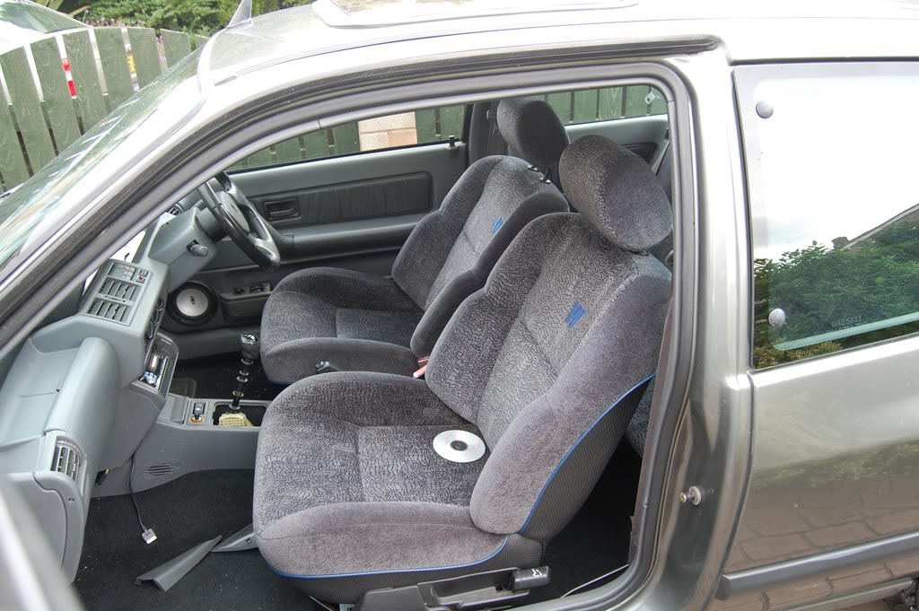

haggis, comes complete with door cards, etc (the leather bits not the whole plastic, although i do have that too I think)
It is up for £180 at the mo, but I would take £150 for it :)
I'd give you the £150 for it mate. What would be the chances of getting me a price for delivery up to scotland to postcode PH1?

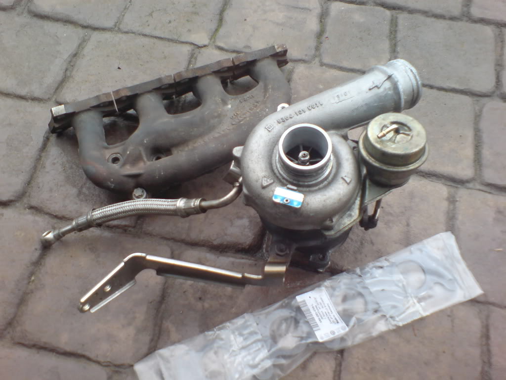

Not much of an update, but have been to fetch the Ko4 turbo and manifold upgrade. I spent a lot of time looking into turbo's and decided this one would be the best for what I want in terms of power, reliability and driveablility. Good for 280hp or maybe a bit more, and 300 ft/lbs. (I've seen people running a few hp under 300 from this turbo setup. More than I need for a FWD clio (for the time being).

for a 20v, Get emerald management. Speak to dave walker, what he doesent know about 20vTs and mapping them isnt worth knowing.
How much did you pay for your K04 upgrade package if you don't mind me asking? where from?

I purchased the Ko4 and manifold 2nd hand (from a 23k TT) and paid £270 for the lot.
