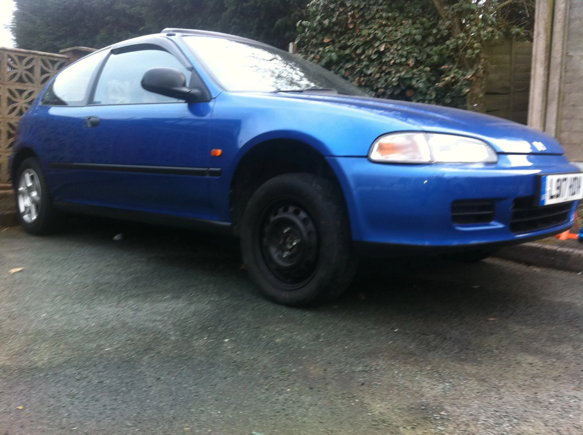

Got this little fella around a month ago, off an old chap that's given up driving.

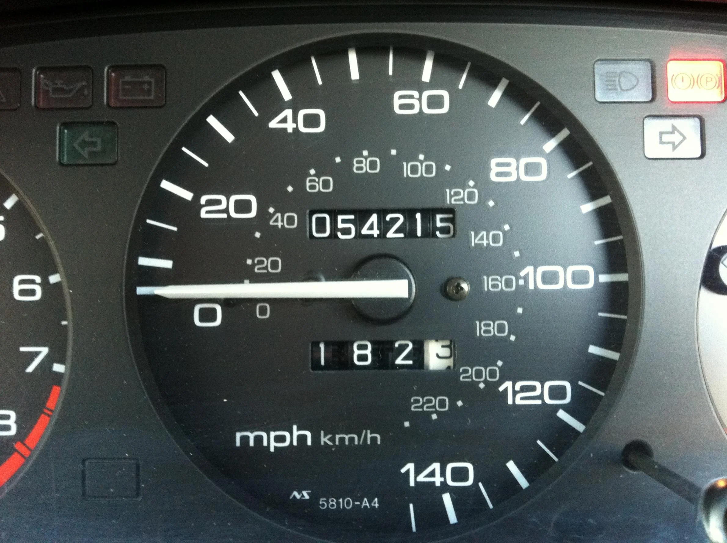

54k 1.6 auto with air con, prinstripes, gash OEM window and sunroof wind deflectors and gash wheels but still very tidy for an old civic.

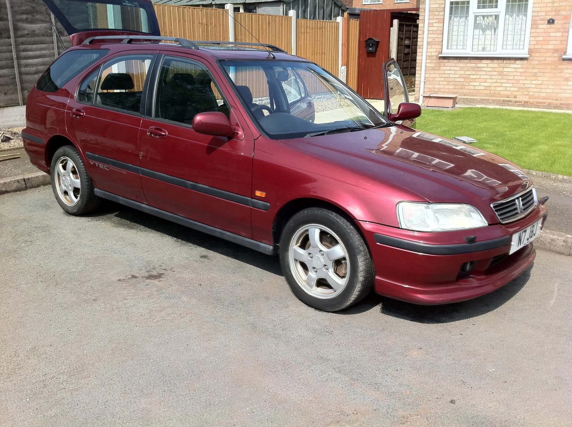

So far, I've taken out the 1.6 and sold it. I have a deposit down on the donor car, a lovely 1.8 civic aerodeck, just need to go and pick it up now.

I'd finally got the Aerodeck picked up and delivered (£70 for a 75mile trip, not too bad)

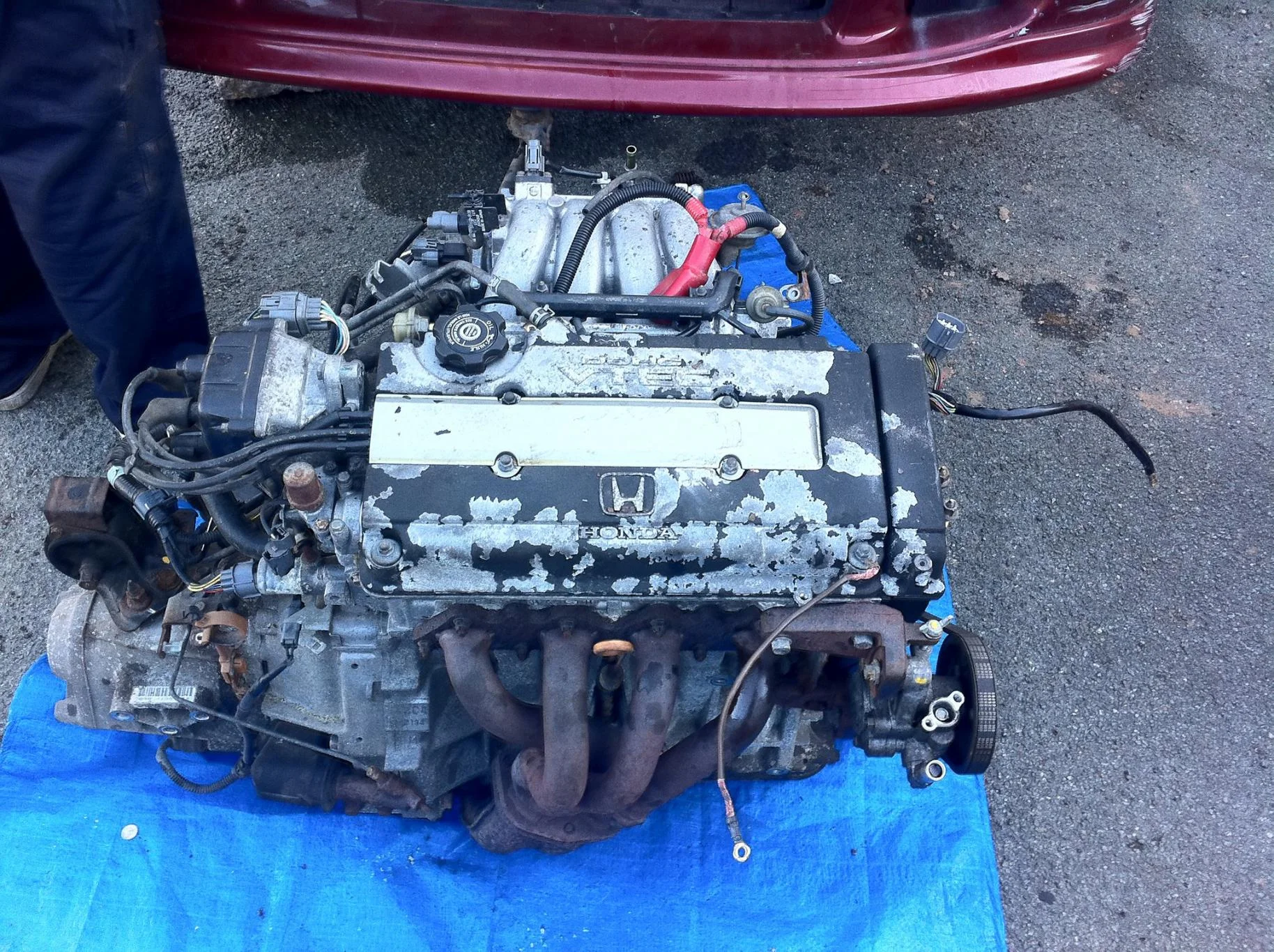

Got the engine out the weekend following it's arrival..

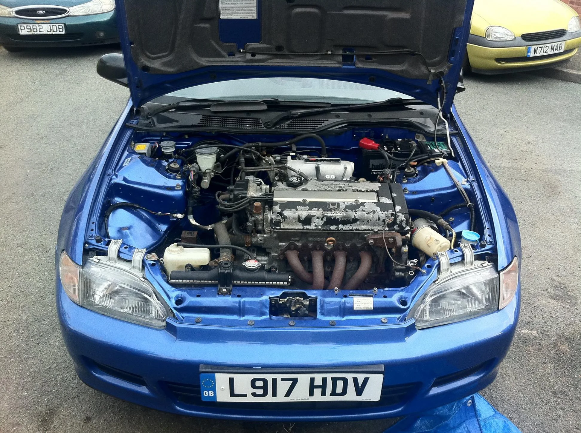

About 3 weeks later, after waiting for my new intake manifold, we dropped the C4 into the EG. I'd had to change the gearbox mount over which was a chore - required cutting / welding / grinding and so on but it's bolted up nicely now.

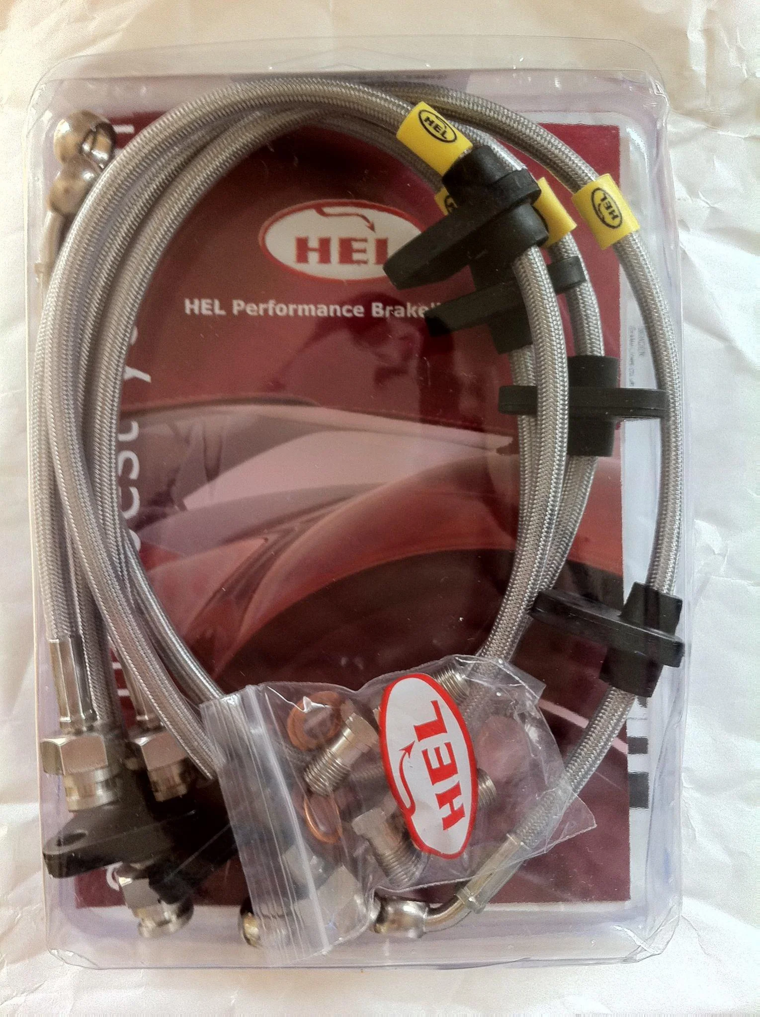

Got some braided lines ready for the hub swap - need to make sure all of the calipers off the aerodeck are in good working order yet though.

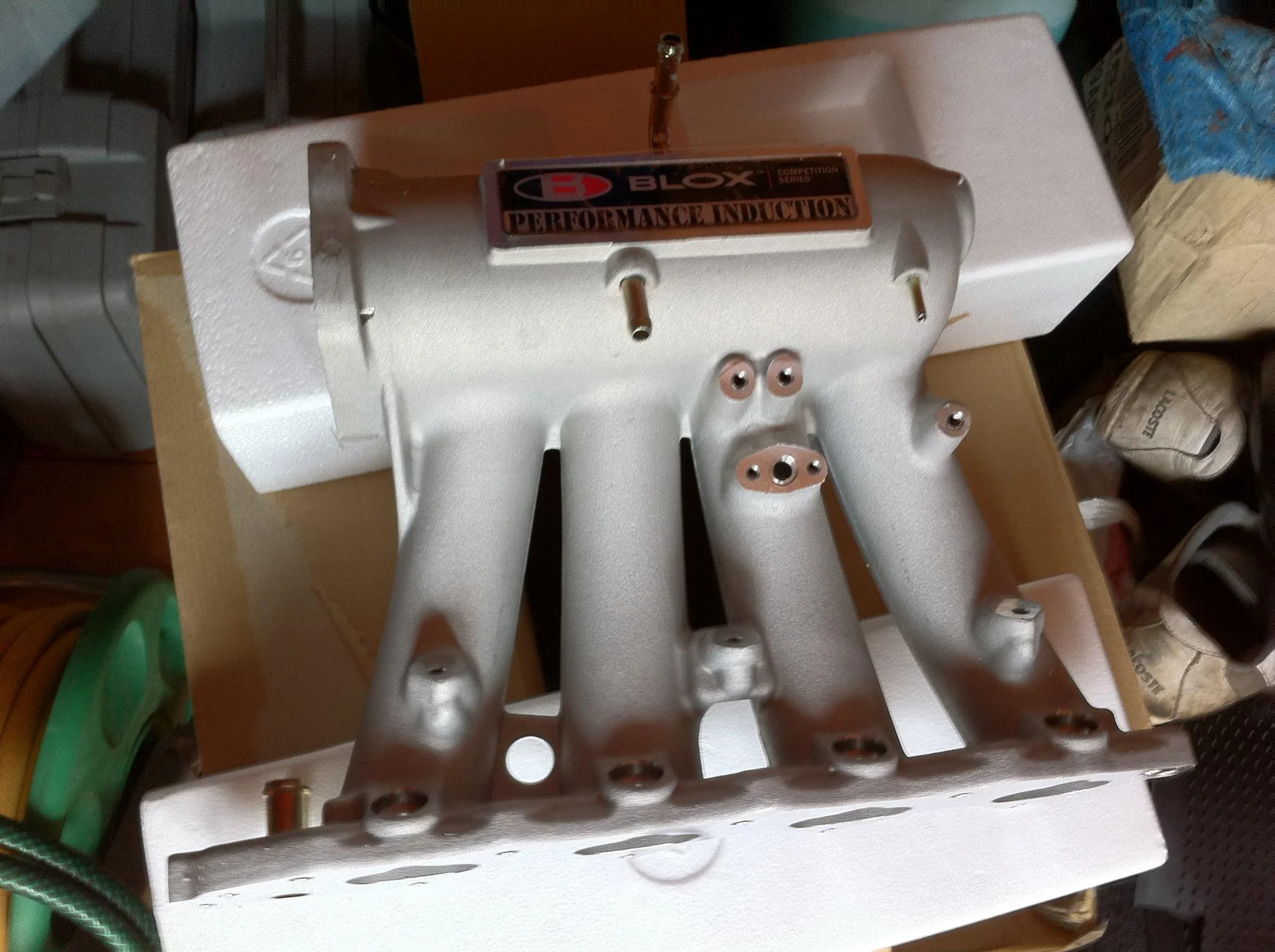

The blox intake before I fitted it - very happy with the quality of it for what I paid.

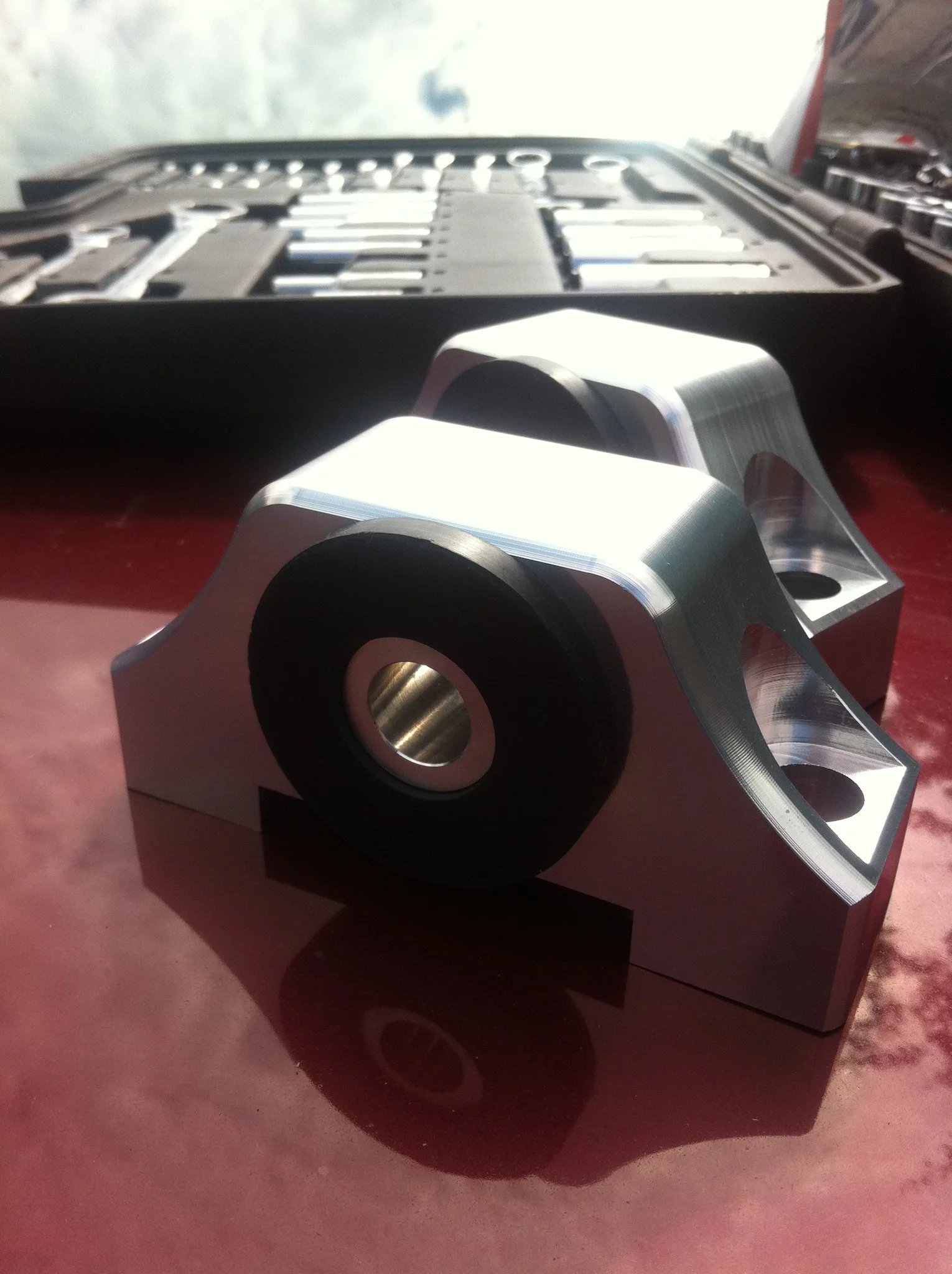

And one last pic, of my new torque mounts. A lot of people neglect these and the oem items are useless.
They introduce loads of cabin shake but the engine is solidly held now.

Time to start tidying the engine up and painting the rocker.

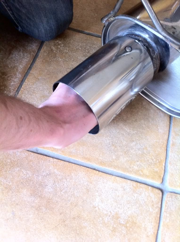

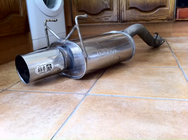

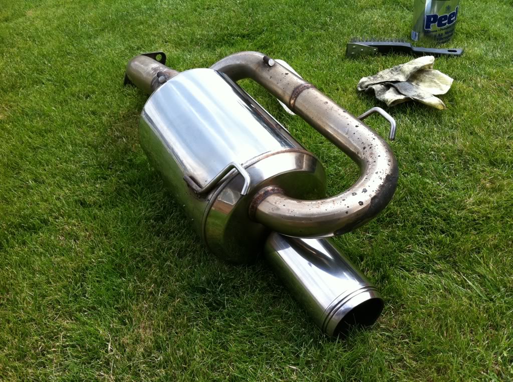

Picked my kakimoto up on saturday, it's safe to say I won't be fitting it to the car. See below evidence.
I didn't realise it was so big :(

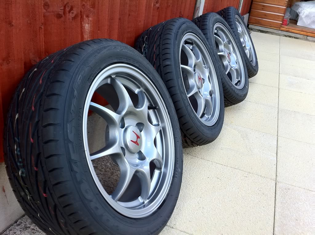

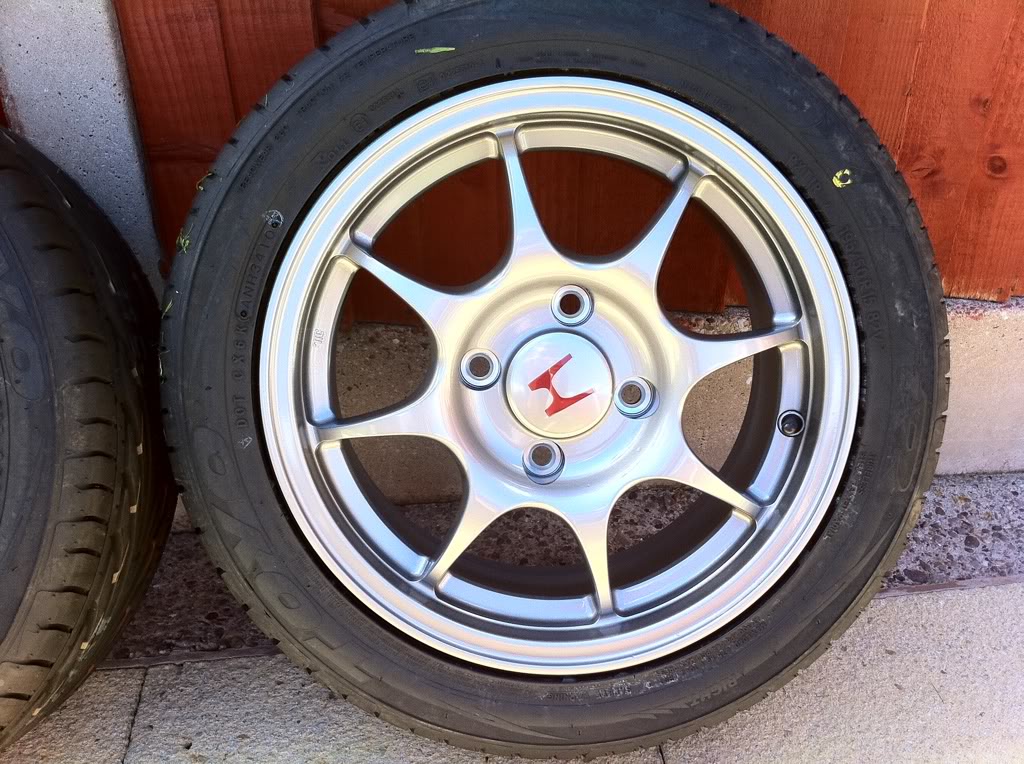

Picked up some new wheels at the weekend, they're exactly what I was after. Sprint SW96 with T1R's :)
Not fitting those 'till it's on the road though.

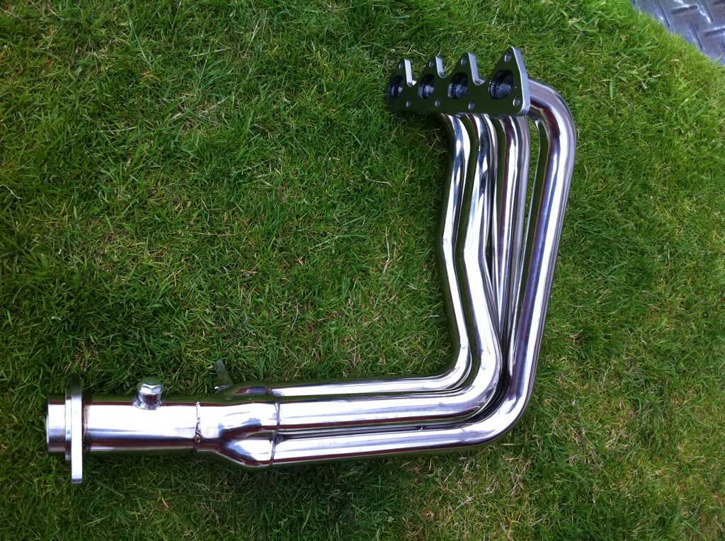

Also fitted my 4-1 2.5" manifold.

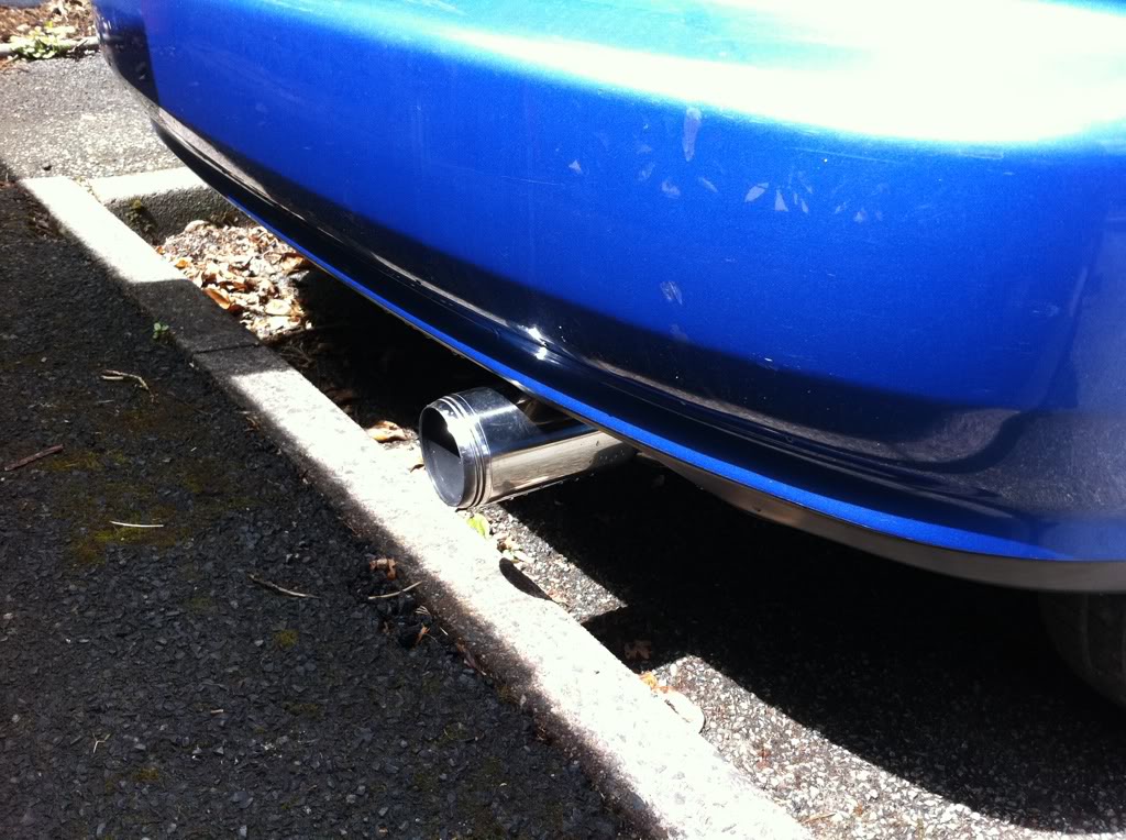

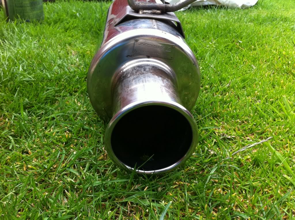

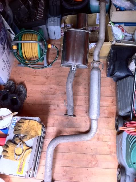

After trying a twin loop on the car and deciding I don't like it, I swapped it with a civiclife member for an N1 as it was too loud for him.
I can't get over how light the N1 is compared to the other systems I've tried. It's a nice fit, but not quite as nice as the twin loop..
Twinloop cleaned and fitted..

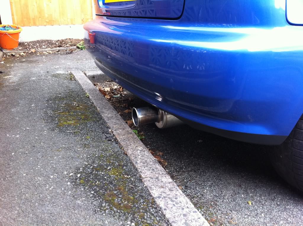

N1 cleaned and fitted - much happier with the tailpipe.

Great choice of box. Kakimotos are dogsh*t.
It seemed decent quality but I had no idea that it was going to be a 10" exit from the pic's. That HAD to go haha.

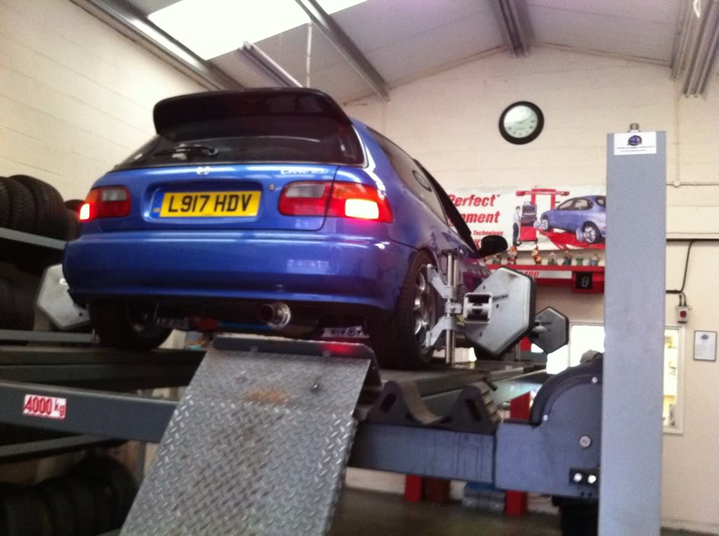

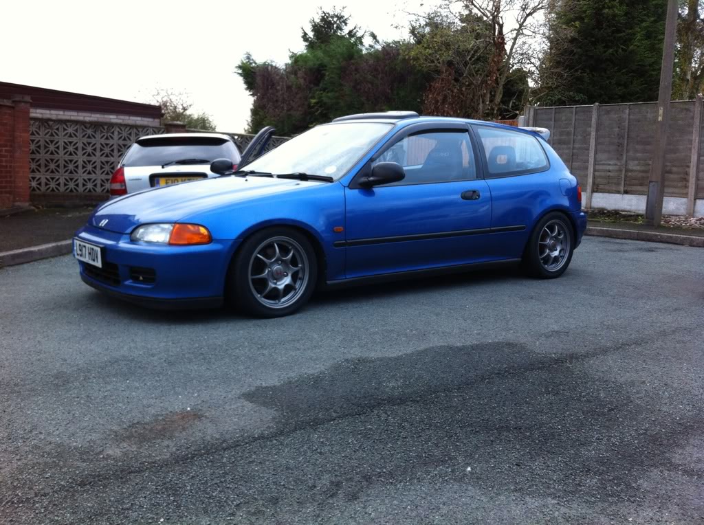

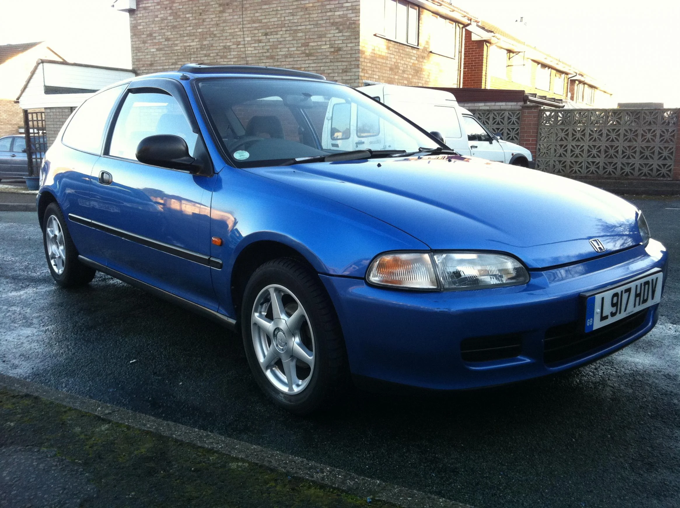

It's finally on the road. Time to start saving for a blower and bodywork.
Ghetto rolled my rear arches to clear the rear wheels.
Even been and had the front and rear camber and toe set up
