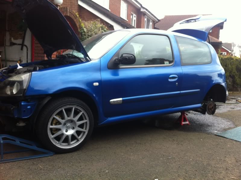

So here we go, glad I got some work done Fri/Sat before the rain =/

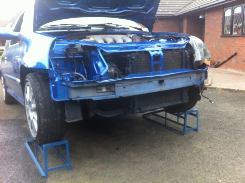

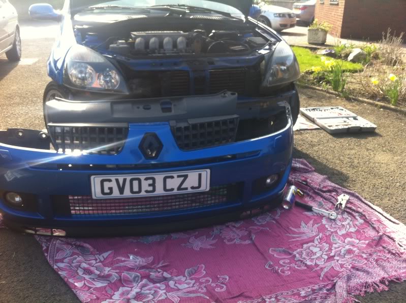

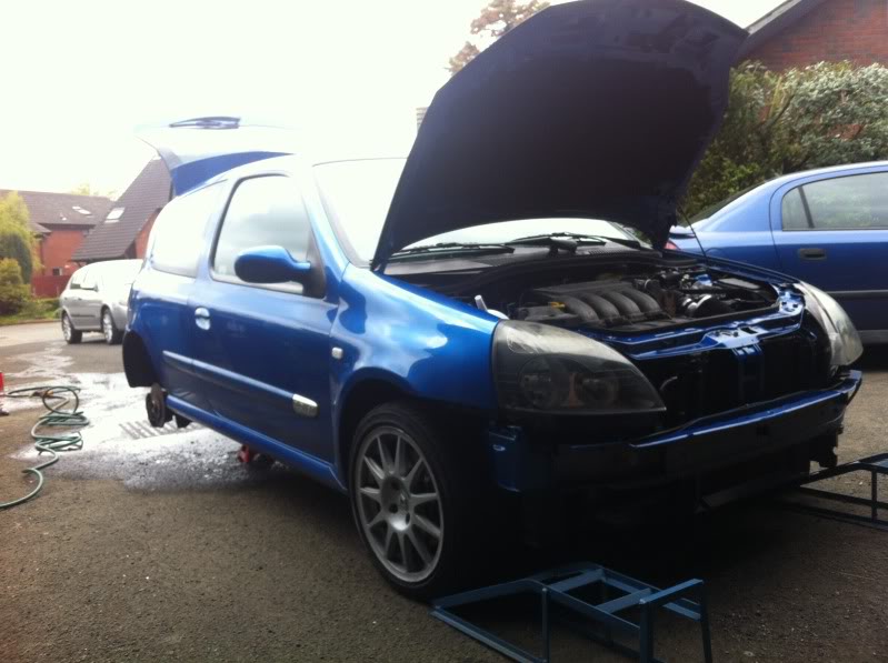

Bumper off

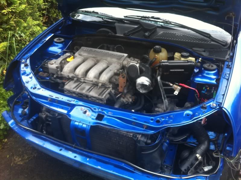

GUNK engine Clean out ( car was in a sorry state when I picked it up)
More cleaning up on ramps - power steering fluid leaking onto belts.

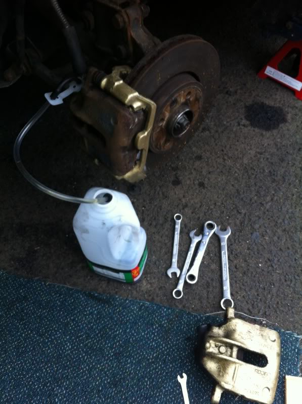

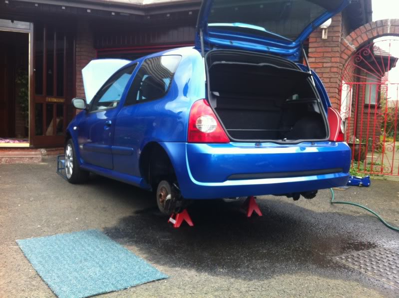

Bleeding brakes DOT 5.1

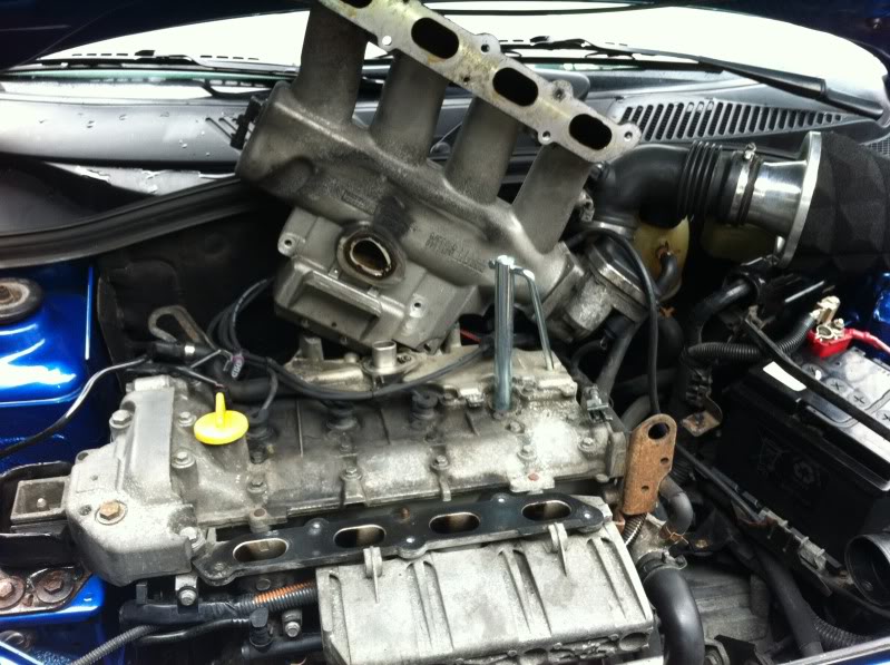

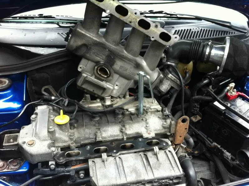

Forte Engine Flush, Oil change, inlet manifold gasket & NGK spark plugs

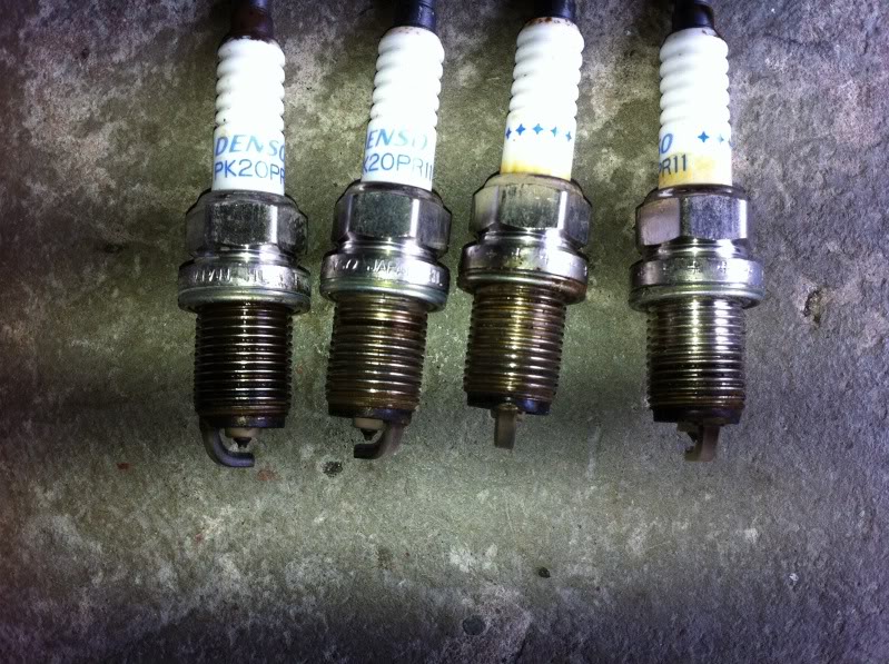

Old plugs out - not tooo bad I think?
Wanted to put the discs and pads on but couldn't get the bas***d disc bolts off. Going for an MOT tomorrow and i'll get the mechanic to impact em off.
