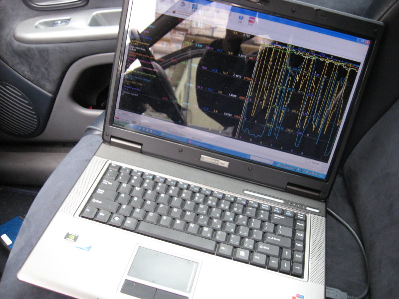

Since all engine mods were finished (for now ;) ) I asked Henk for his help
As always, fast response time, and excellent service.
Took us a few days of loging and testing :)

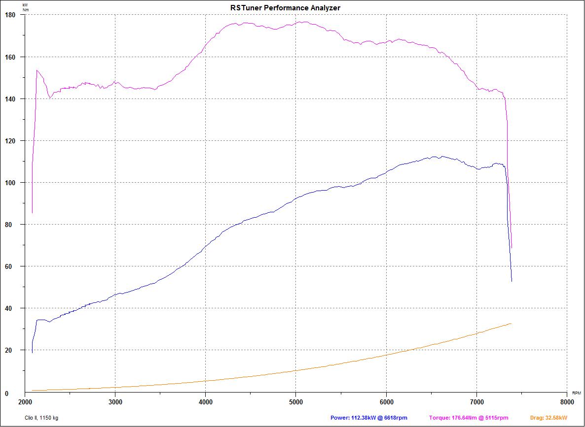

We are currently testing v.7 of ECU calibration and this is what came up :)
And I hope this is not all ;).
Vehicle weight is set to 1150 instead of 1100 but this is not random. Previous readouts were taken with car prept for drag racing, this one is for normal day to day use.
Soon I'll be fiting new exhaust including 4-2-1 mani from 182 + and I plan to spend some extra time on perfecting the air flow.
Hope to be close to this 200+ break we all dream about ;) Henk what do You say ?? Can We do it ? :)

178BHP tested on RR some time last year (cams inlet panel filter decat RS Tuner map by Henk)
That's the last log:

Seems to me the standard cams pull alot better from bottom to mid range, and not a great behind the 421's on top end?
Also thought the rev limiter was taken to 7,500 rpm

Good progress and well thought out mods! I hope the 182 manifold balances out the minor loss in the midrange of the 421 cams and doesn't affect the top end too much.
I would be interested to see if the top end continues to rise all the way to the limiter bhp wise. As I think standard cams drop after about 6500rpm or something like that.
Are 421 catcams more agressive than 428 at the top end?
Please post the results when you have them...Good luck mate :)

I myself was hoping for at least 185BHP
Never the less it was a 10BHP increase for me. Stock car only with de-cat gave 168BHP result at RR.
I hope the exhaust will solve most of the problems, since it was the only restriction left.

10hp from 421's? Thats a shocking result.....
Standard ECU just isn't adaptable enough to run that amount of lift properly IMO.
