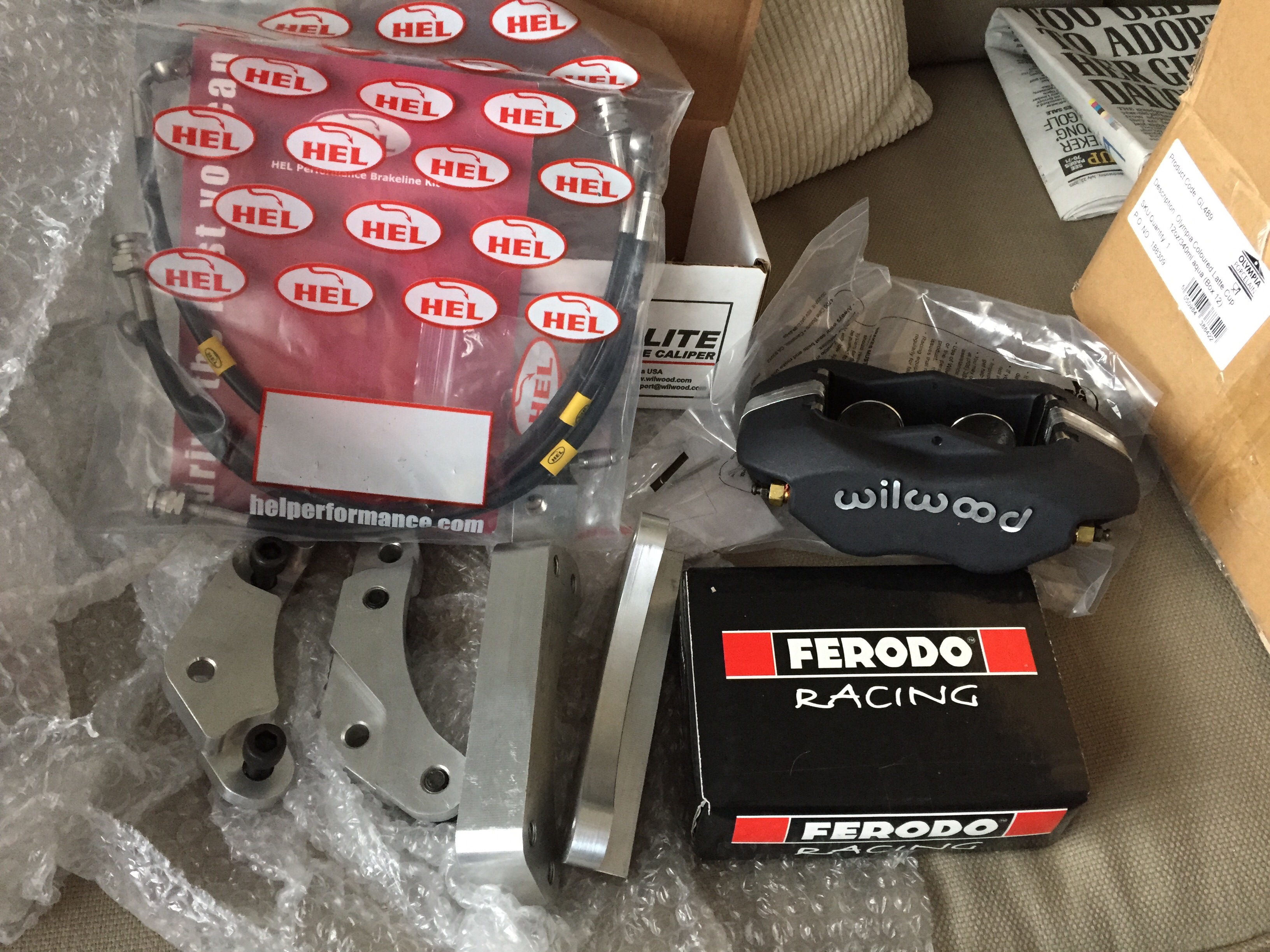

Rest of the bits arrived today, having them fitted next Tuesday. Then the brakes should be as good as I'll ever need. Wilwood 4 pots with ds2500 pads up front, rear discs from the sport mx5 model with mintex pads and braided lines all round.
Just awaiting spacers now

Wow, just wow. Those Wilwoods look incredible dont they and with the DS2500 you will have crazy stopping power. Are the discs larger than the ones you had before. You will have to take me out in your car once its done.

Cheers for the heads up on the ds2500's, I wasn't sure what pads to go for as I haven't really got much experience with them. They seem to be quite a personal thing as to what people like so I just bought I'd give them a try as they seem quite popular.
I did plan to do the brakes in stages but then I realised the money from selling my old car would pay for the brakes and it sort of spiralled. Only problem being that I haven't sold the old car yet!

Was it just the rear discs you needed from a 2.5 sport? I thought you'd have needed the calipers too?
Euan94
  Volvo C30
I only need the discs as I've bought some brackets to sit my 1.8 calipers further out to fit the discs. I think if you went the whole hog you'd change the calipers to the sport ones but I don't think I need that. Hopefully not anyway!
I'm still debating a proper proportioning valve as well so I can adjust the bias but I decided to try the brakes first to decide if I need one.

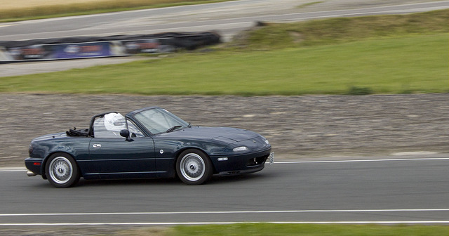

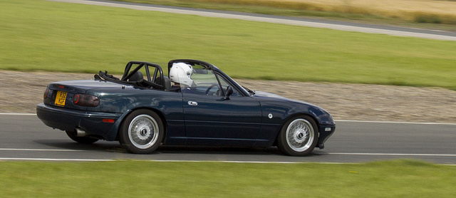

Did my first track time with this car at CSS ( the whole of which was awesome fun) last weekend.
The new brakes were fitted and almost bed in, I finished that off in my first outing on the track which seemed to do the trick.
I'm really impressed with the Wilwoods, very confidence inspiring, not a hint of any fade all afternoon, although I wasn't pushing too hard. They just stop really bloody well.

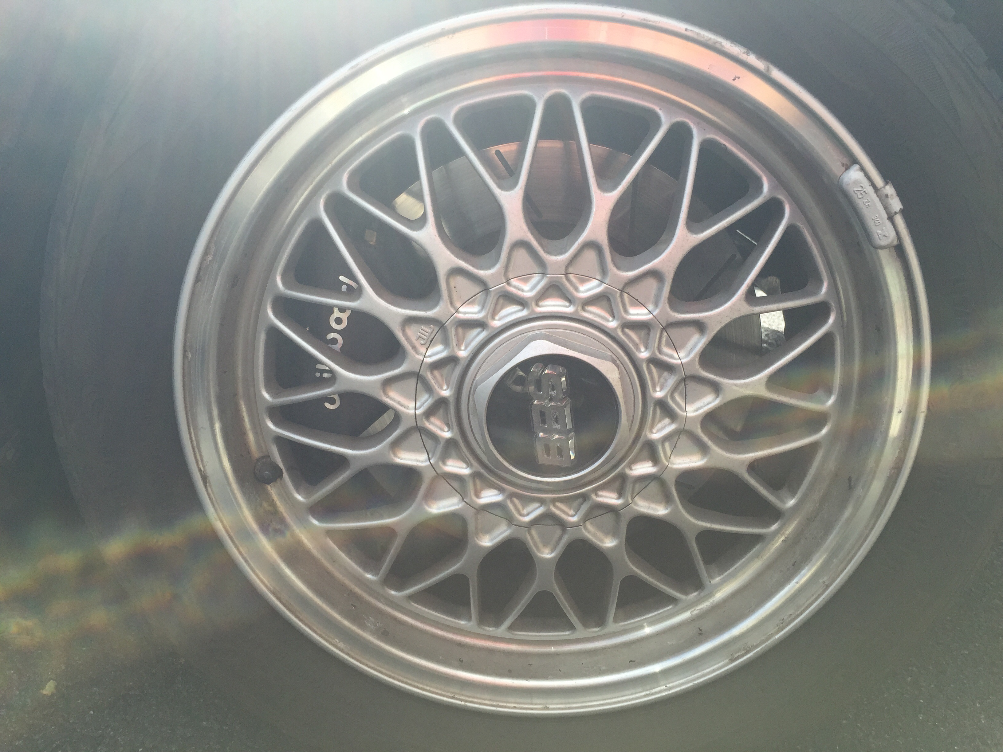

The spacers are spot on as well IMO not quite flush with the arches but any further out would give me rubbing on the arches I'm pretty sure, I had the tiniest bit on one spot on the track anyway, and i dont want to raise the car up if i can help it
Quick couple of photos courtesy of @Paul.M , cheers!
