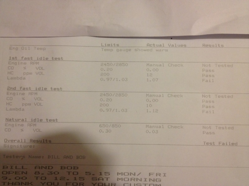

They didn't mention is was leaking? The report say 1st idle test 1.07 2nd idle test 1.12 and the limit is 0.97.

Air filters not been changed for a while however it was checked over today and 'looked' clean. Here's the results from the emissions test a couple of days ago, not a lot has changed since.
  mk2ph1 rsi 106rallye
how come they didnt connect up the rpm probe? dose look like its genuinely running lean i would try a coolant temp sensor.

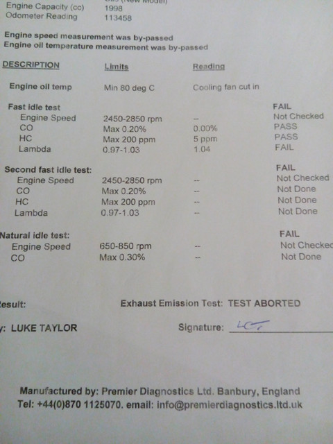

So my car (172 ph2) drives fine with no problems, good economy etc. but has just failed MOT for Lambda reading (exactly the same results as Matt posted above)
I worry it wasn't fully up to temp, however after it failed the first emissions test the mechanic wedge the peddle and held it at 3k rpm for some time, and then it still failed. (So should have been hot by then)
After that the dash lights up, Lamba and coolant light on, revs all over the place.
I told him to get on with the rest of the test, although in hindsight, i should have just turned the ignition off and re tried. As since then, the car has been fine.
He started it, moved it out and i drive home with no problems. (miserable git wouldn't retest emissions at the end)
So after researching, it could well be the front Lambda sensor, but the fact it drives fine, and only went crazy when he wedge the peddle open for ten minutes makes me wonder.
Ive got a standard exhaust, and a tiny leak where the back box joins the centre pipe. (Pretty hard to seal metal to metal with just a clamp)
I havent got an OBD reader,but is there any reason it drives fine, but spazzed out at the MOT?
Anything else to try before buying a new sensor?
Or any OBD owners in near Suffolk/Essex border feeling kind.. :smile:

I would get any leak sorted as best you can, do you have a print out of the emissions failure info? As the exact part it failed in will tell you what part you need to address. :)
Sitting at idle revving the engine won't get the engine hot enough, it needs a good hard drive, maybe even add in some redex, it's old school and often joked about, but can work well especially come MOT time. For peace of mind, if you can afford it, just replace the front lambda if you think it's faulty but again, the test results will give a clearer indication of what you need to change etc for the retest.
  172 Ph2
Thanks Boost, results above.
Just noticed he didnt actually do a second test..
Another thing to note, the car has been sat for three months, and oil was not changed (planned to do it after the MOT).
However, this, or exhaust leaks, dont explain why the dash lights and revs went ape whilst he was revving it.
Think i will change oil, sort that little leak, and deliver it red hot for a retest.
